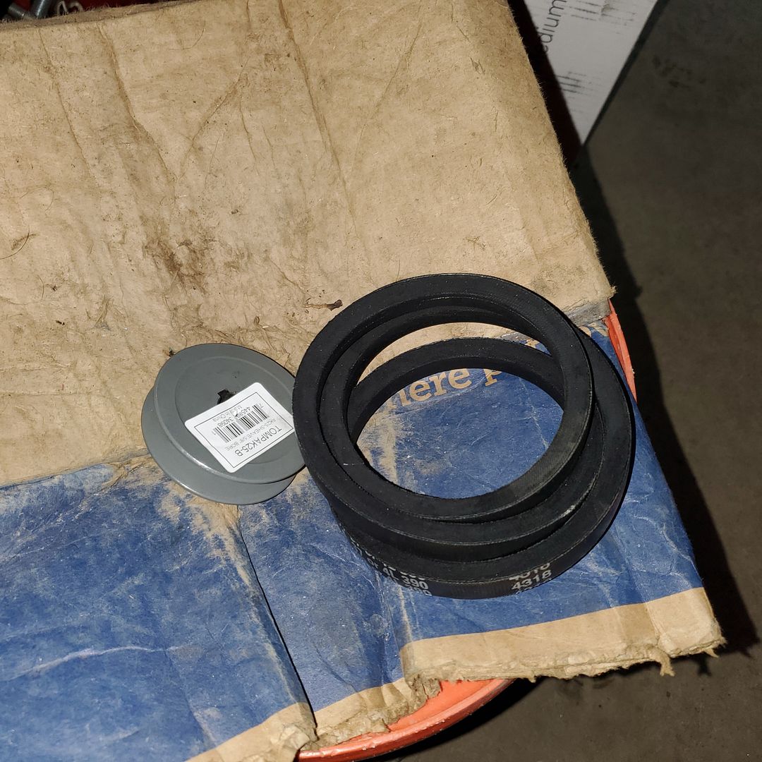

I started off trying to decide what I was going to do on the Jeep today and decided that I would mount 2 of new tires so I had them to use when I was flexing the axles to check for clearance. As I was getting things ready FedEx dropped off the parts I was waiting on to finish the install of the new pump for my compressor.
The compressor is back up and running. Makes a little more noise than it did before but it is working and I'm cooking with air now..... Whoot whoot Yahoo.....
Will see how it does for the next few days.

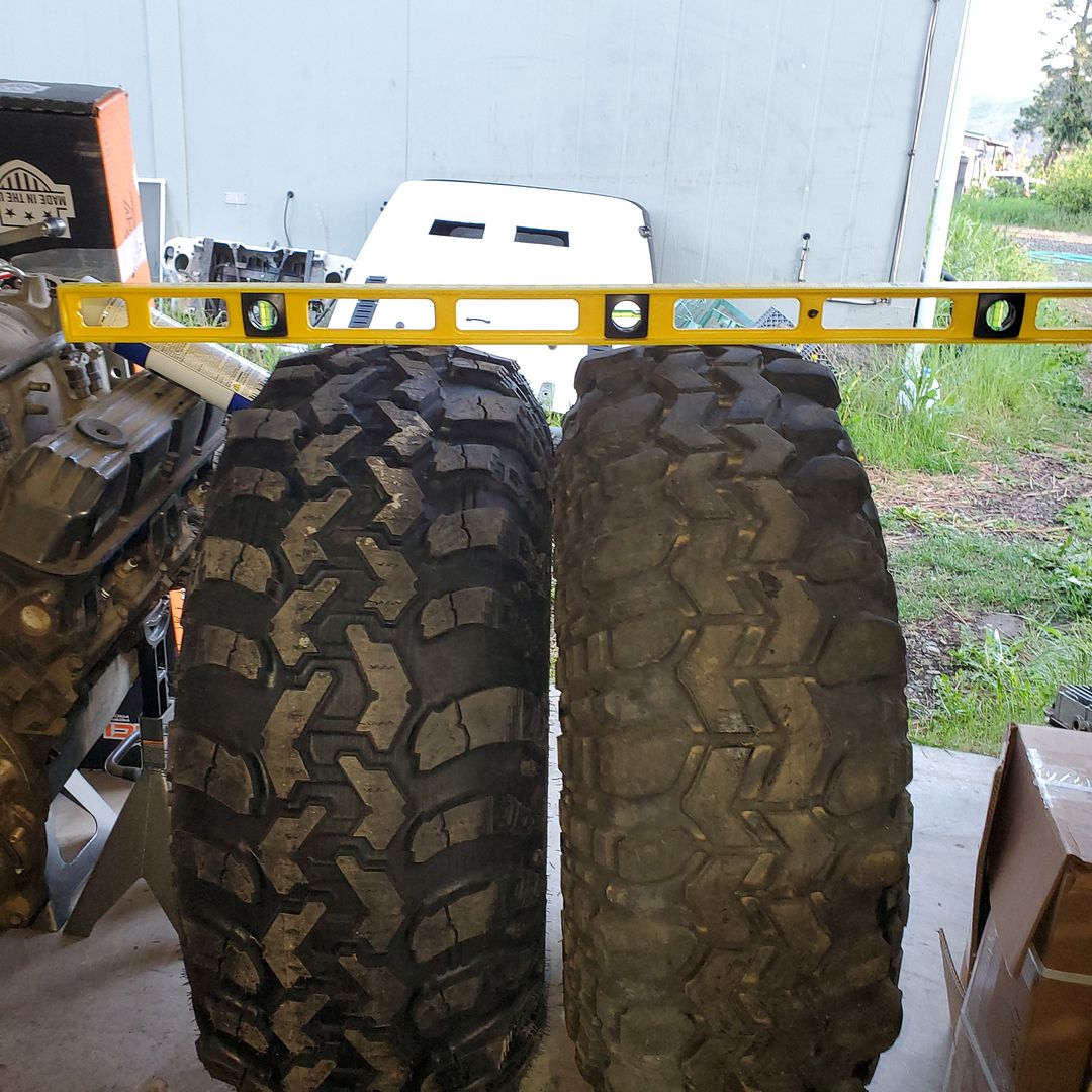

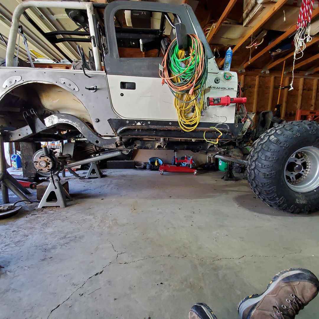

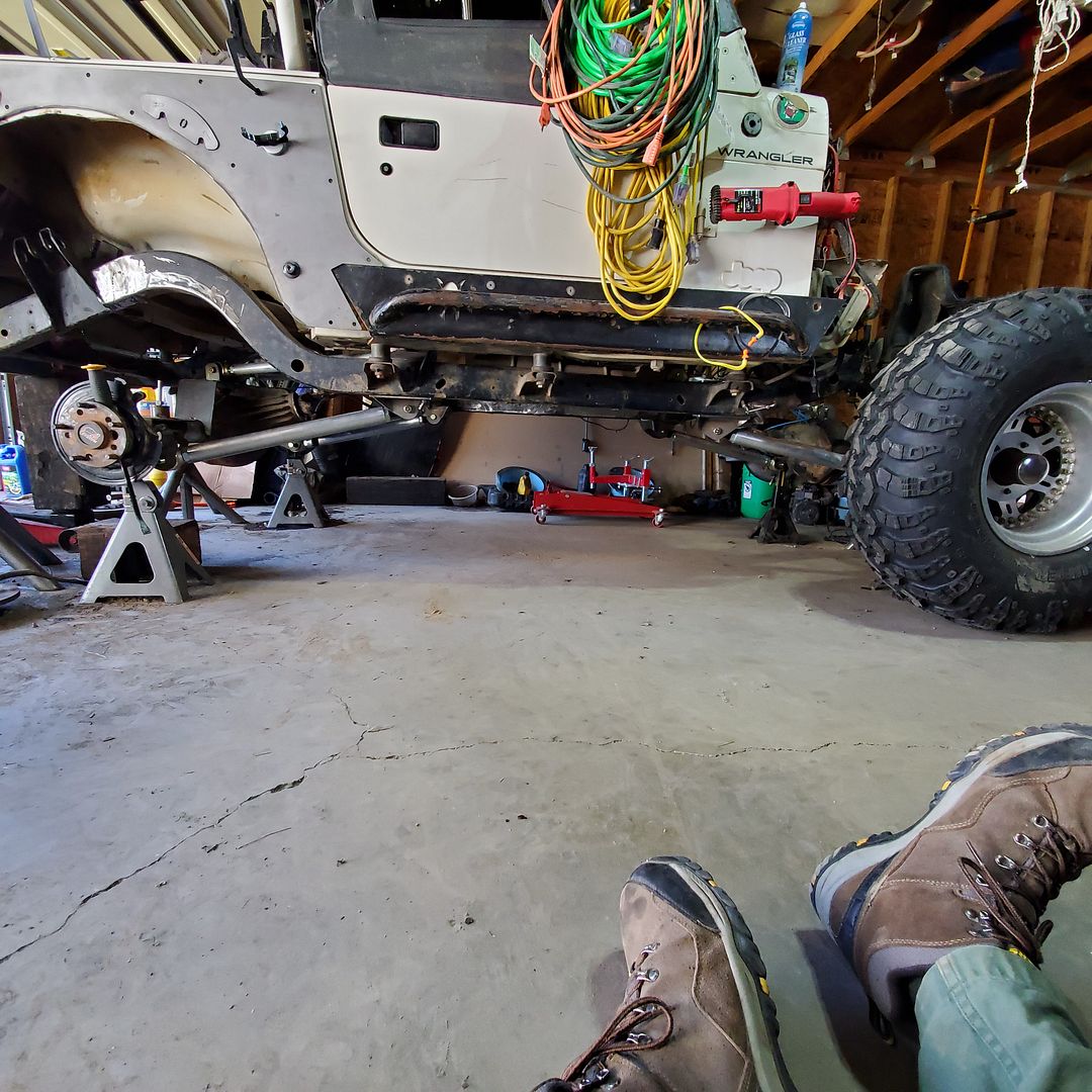

Did I ever tell you I was getting OLD? Dang Nab doing one tire KICKED my butt BAD. But I got the first one mounted. For those of you who have never dealt with a dual beadlock wheel let me tell you they are a lot of work but worth it.
So here is my new 36x13.5x16.5 IROCK compared to the old 38x12.5x16.5 TSL SX both tires are mounted on a rim.

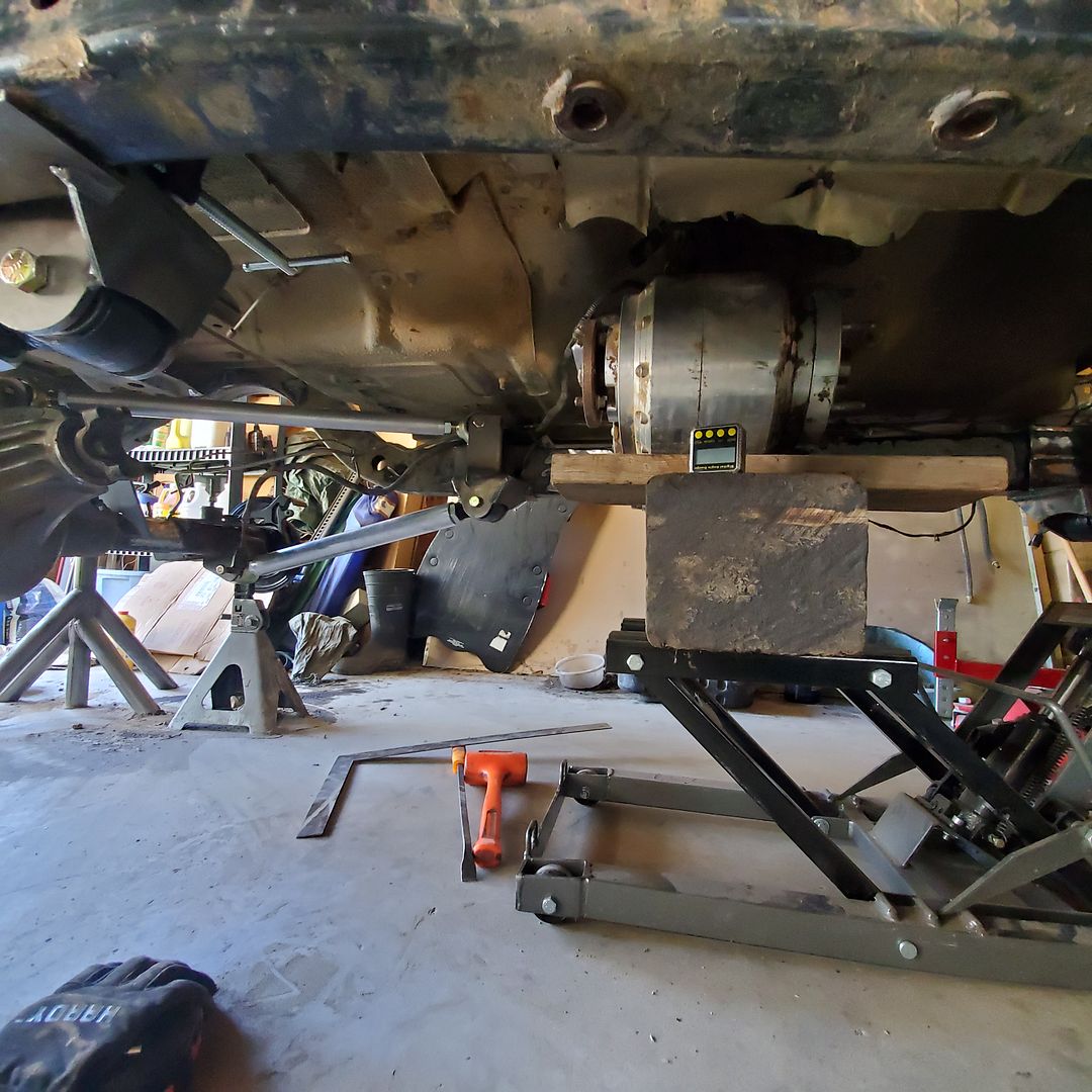

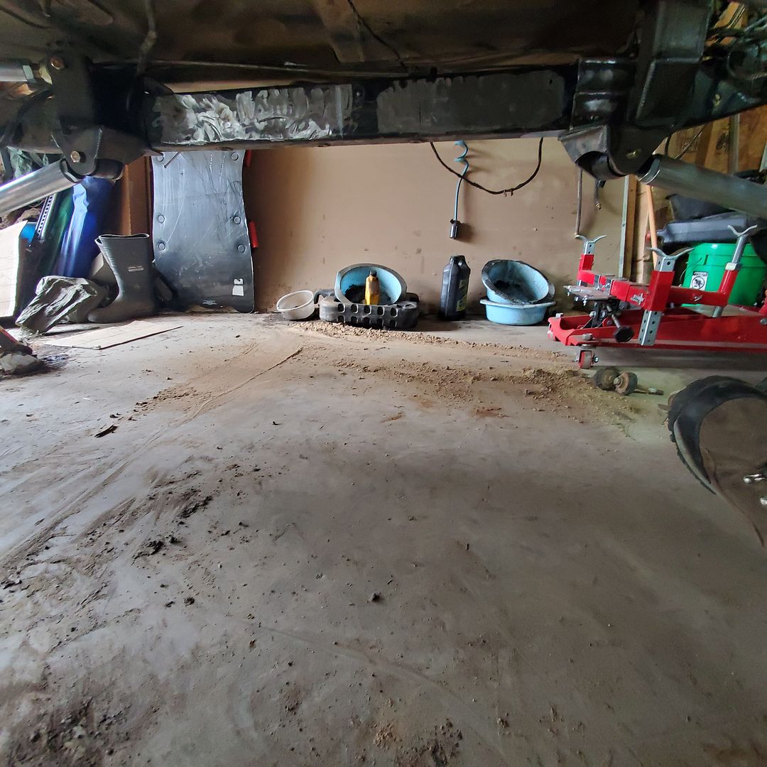

Yesterday I got the Jeep set at my approximate ride height and the axles sitting where they would be sitting. Then I started flexing the Jeep and taking measurements to see where I'm at and how much travel I'll have.

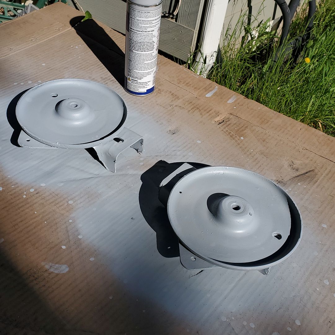

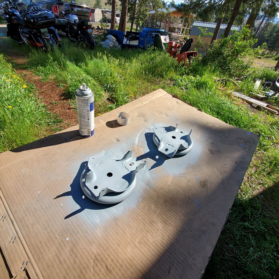

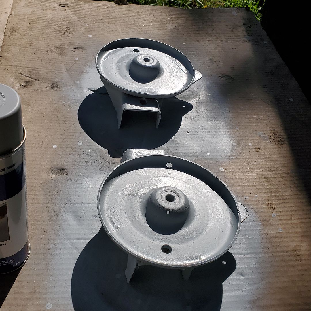

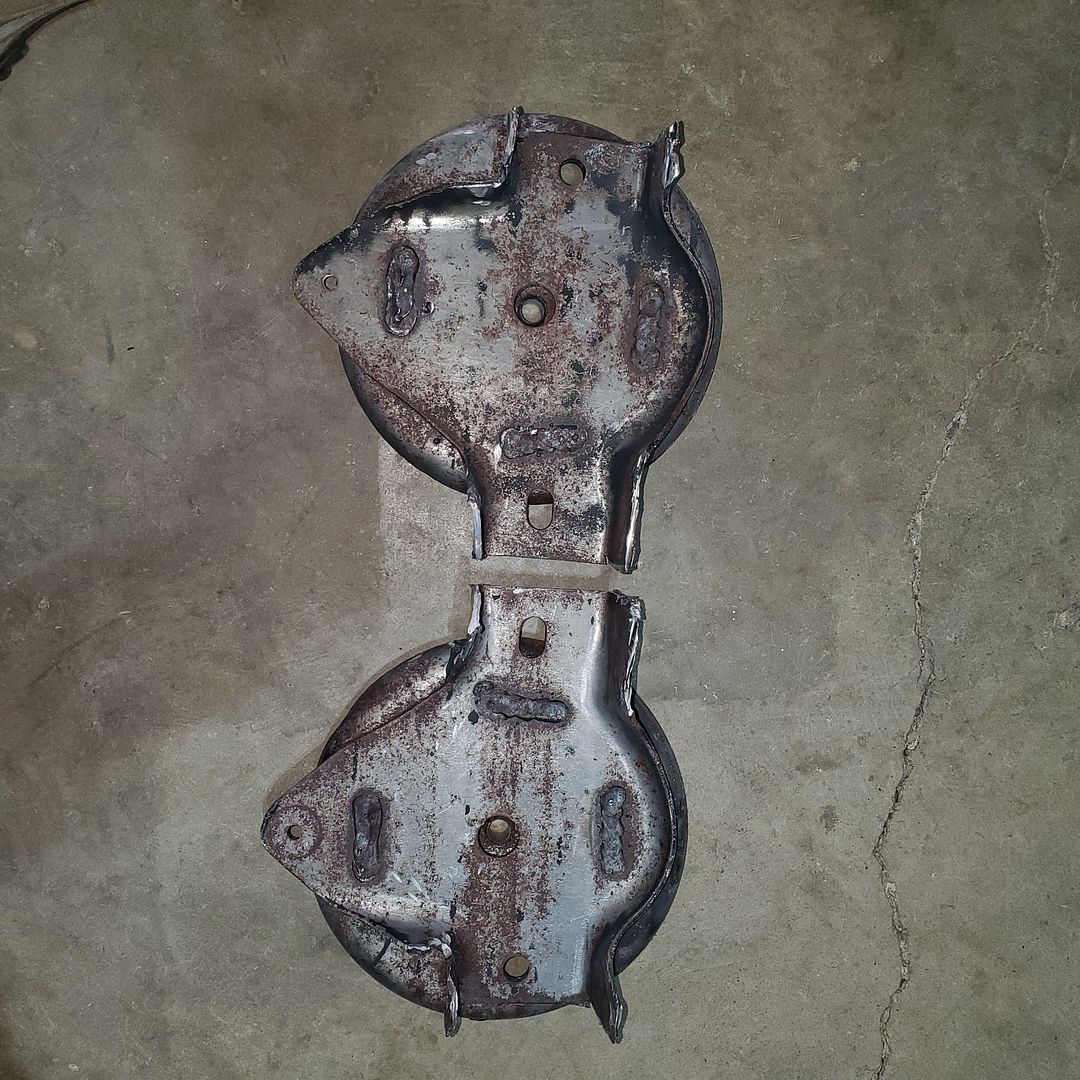

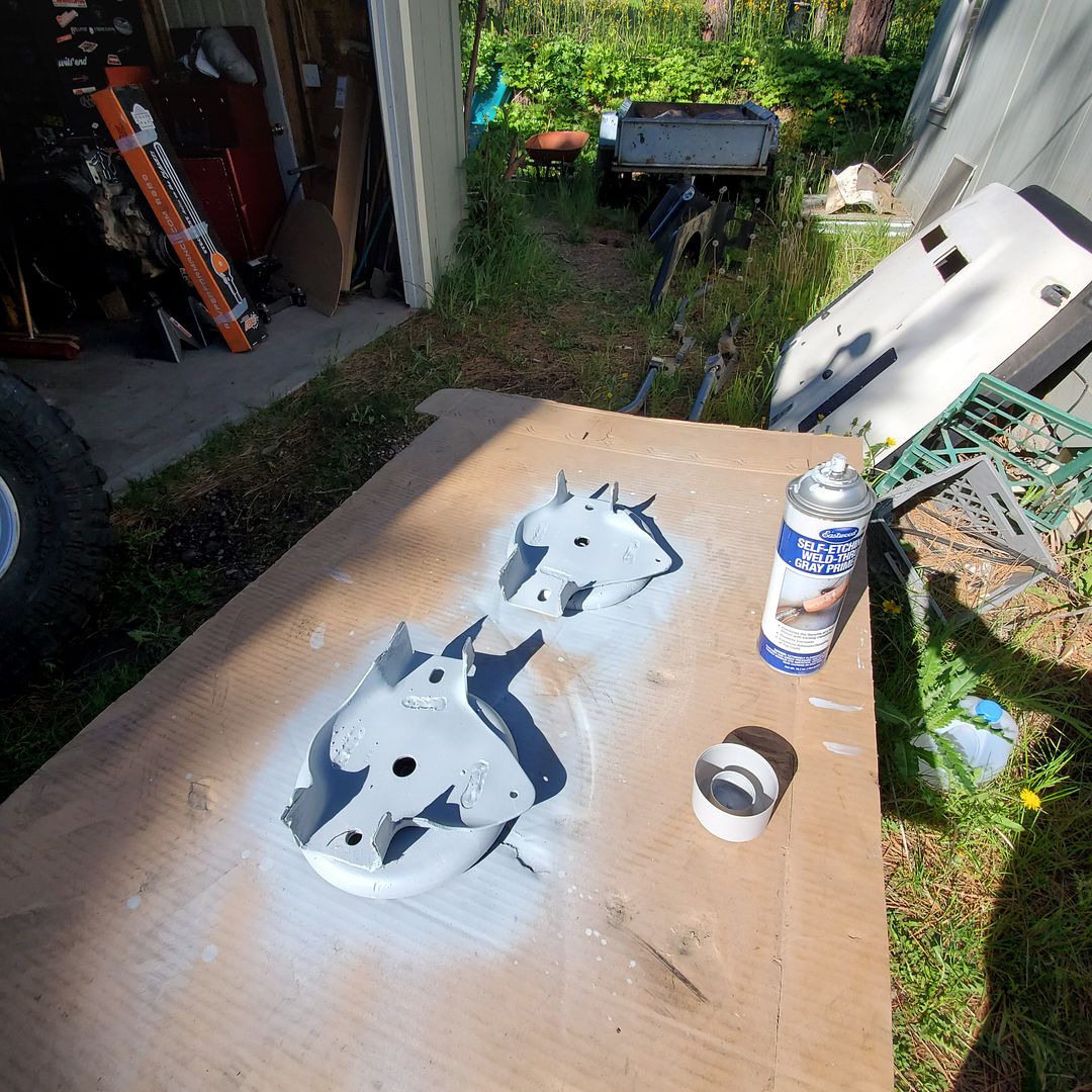

Also bead blasted the rear upper spring pads. I don't think I got an abrasive enough media.
Still better than if I had wire wheeled them. Then it was time for some paint.
This is weld thru primer of course so I can weld them back onto the frame

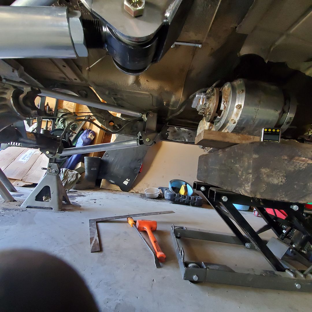

Then slid the transfer case under to see what it looks like under there and get an approximation of my rear driveline angle.
It looks like I'll be sitting at about 15* and it'll be 26 3/8" long.
I did run into a clearance issue with the crossmember for the gas tank. The JJ mounts on the truss hit the crossmember and as keeping me from about 2" of up travel.
So I need to look at what I want to do about that.

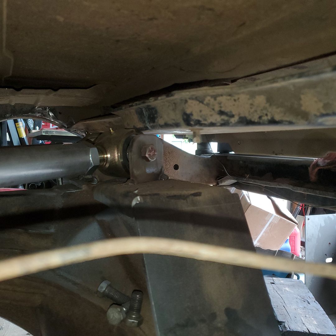

Here it is with the rear driveshaft temp bolted in.

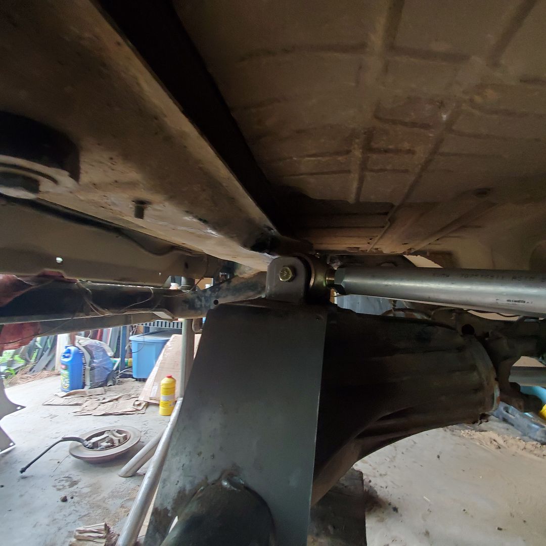

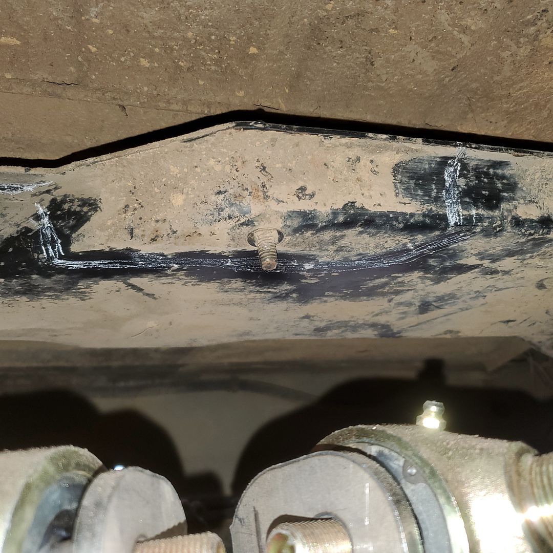

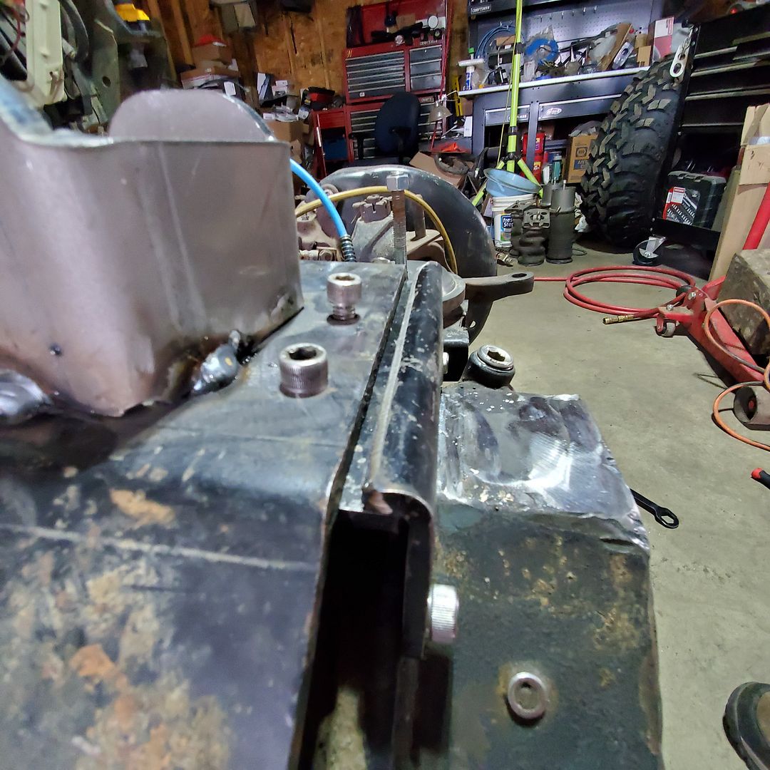

So here is where the rear axle upper JJ mounts are hitting the crossmember.
This is how much I will have to cut out of the crossmember.

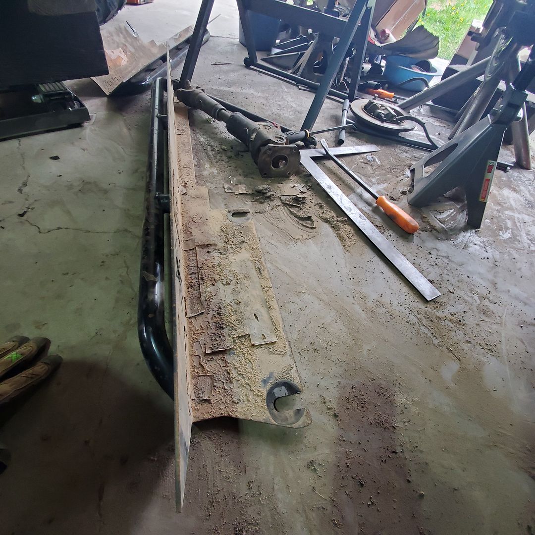

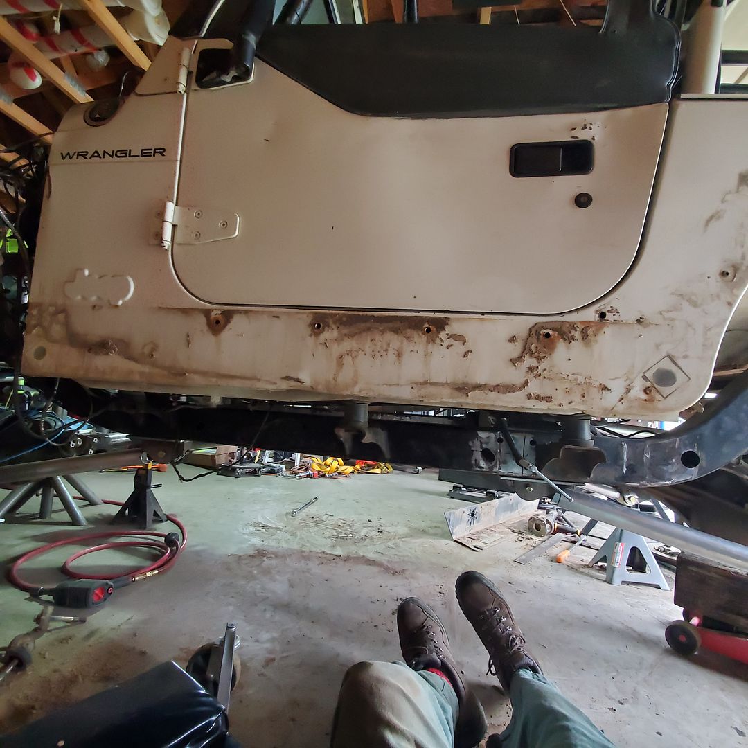

I also took the Poison Spyder Rocker Knockers off today. This was the first mod I ever did to my Jeep when I bought it. I bought the Jeep in Sept 2002 and I think it was spring of 2003 when I installed them.
The tub on the Jeep looks just fine even after them being on there for 13 years but DANG NAB they hold a ton of mud under them.

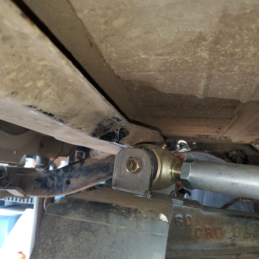

I had the same interference with the cross member. I cut out what I needed to and added a piece of angle iron across the back to retain the strength.

Thinking about if I am just going to notch the frame or if I'll move the frame back. You cut the frame just after where it bends in back and move the hump back and trim the end of the frame off. This isn't mine but here is a picture of one.

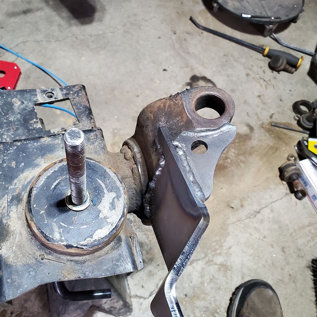

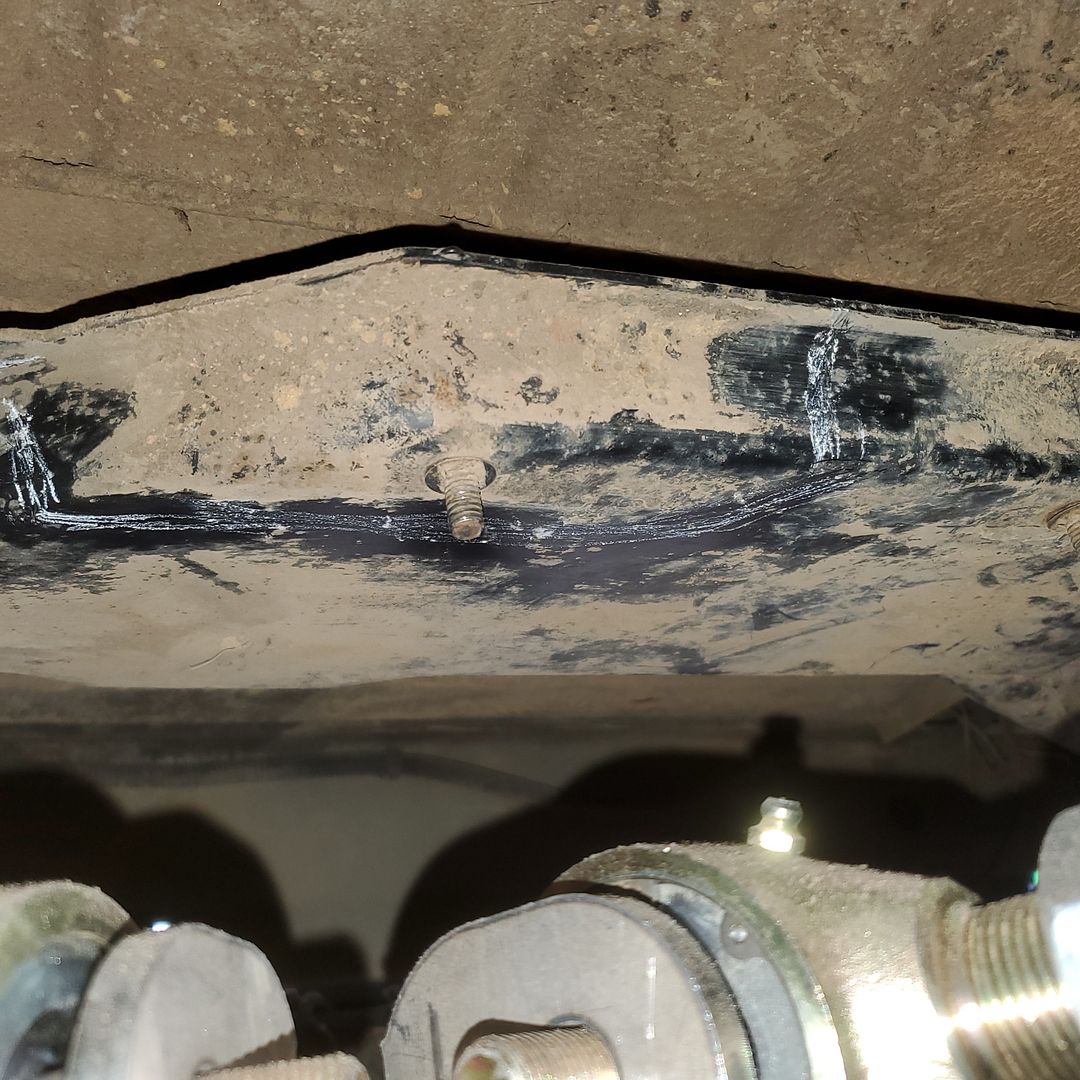

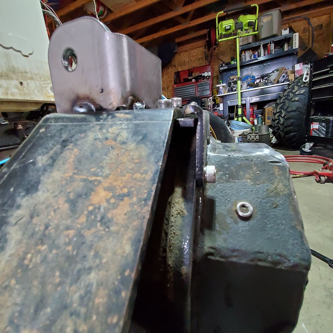

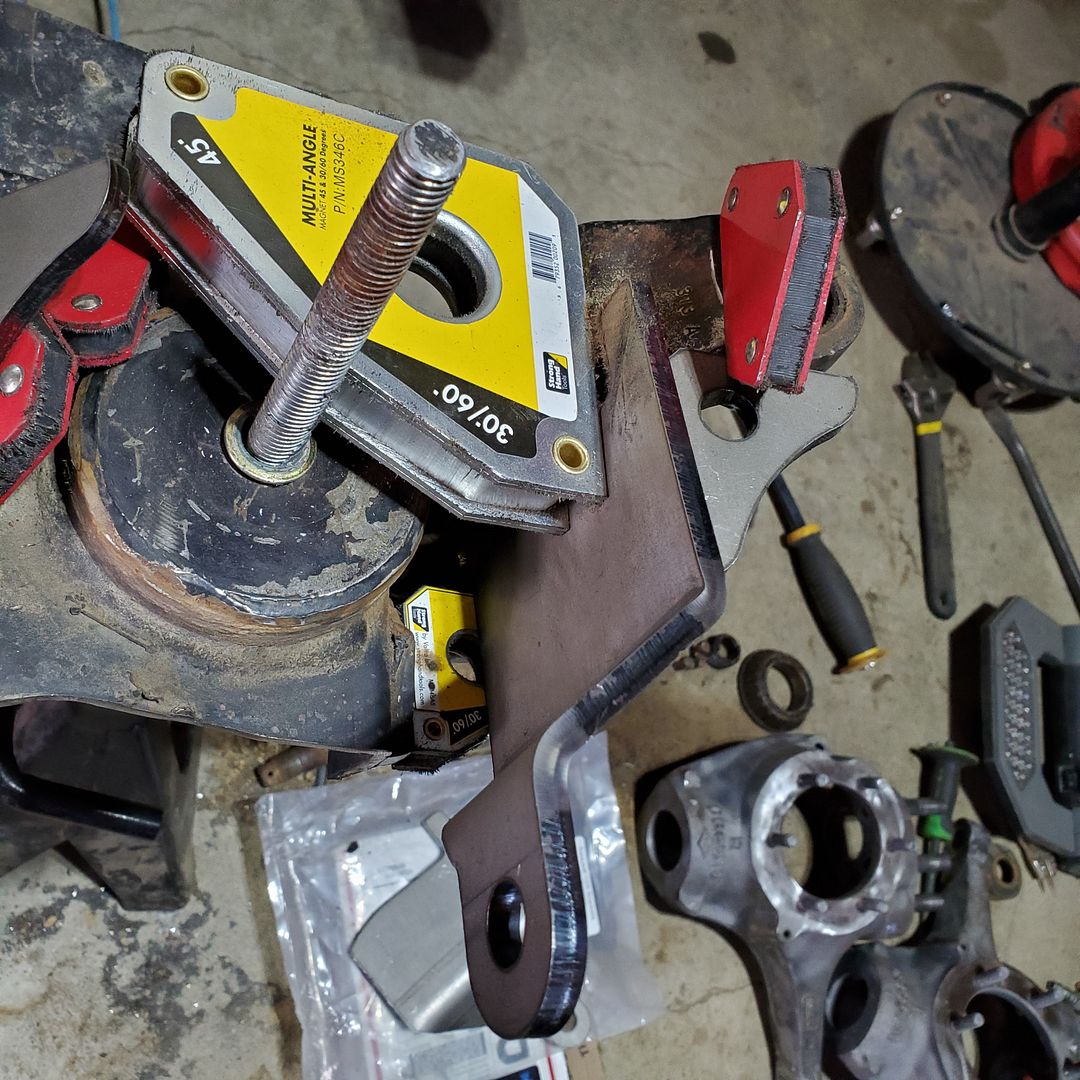

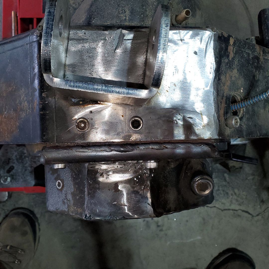

Yesterday was a slow day but one of those days where I didn't think I got anything done but really did. Started off the day sweeping the floors and cleaning up. Then I moved the rear upper mounts forward about an inch because the upper arms were adjusted to long when I was trying to get the lover spring pads level.

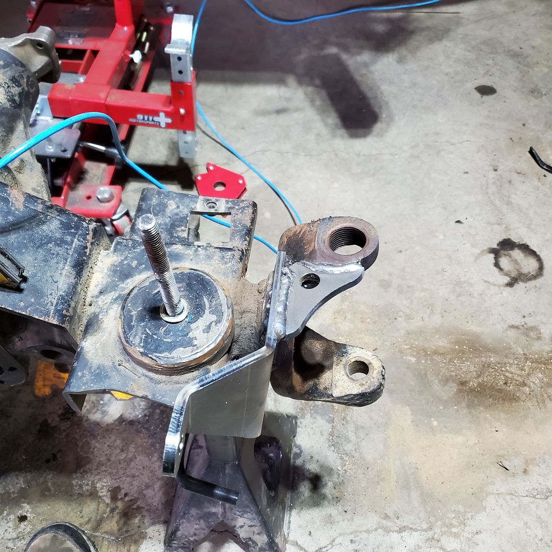

Got the rear axle back under the Jeep and pulled the front axle back out. Had a bunch of little stuff to do to it. The big thing I needed to do was fix the tie in bracket between the truss and front diff cover. Need this to help strengthen the truss as the 3 link adds more stress to it.
Of course I forgot to take any pictures before I started to modify it. I cut the bracket in half and then bolted it up to the truss to see how it would fit/work.
You can see how it wouldn't work in original form but cutting it and mounting it worked great.
I tacked the ends together and pulled it back off then took it to the table and welded it together. Can't weld too far on the inside as there isn't much clearance on the inside of the bracket.
On the top side I ran a bead the full length.
Bolted it back to the truss to check fitment on the axle.

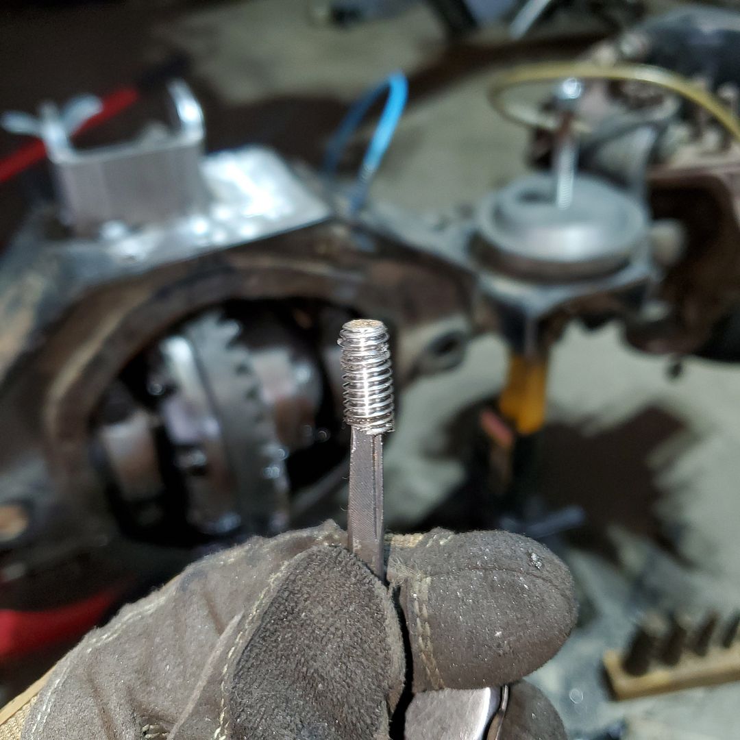

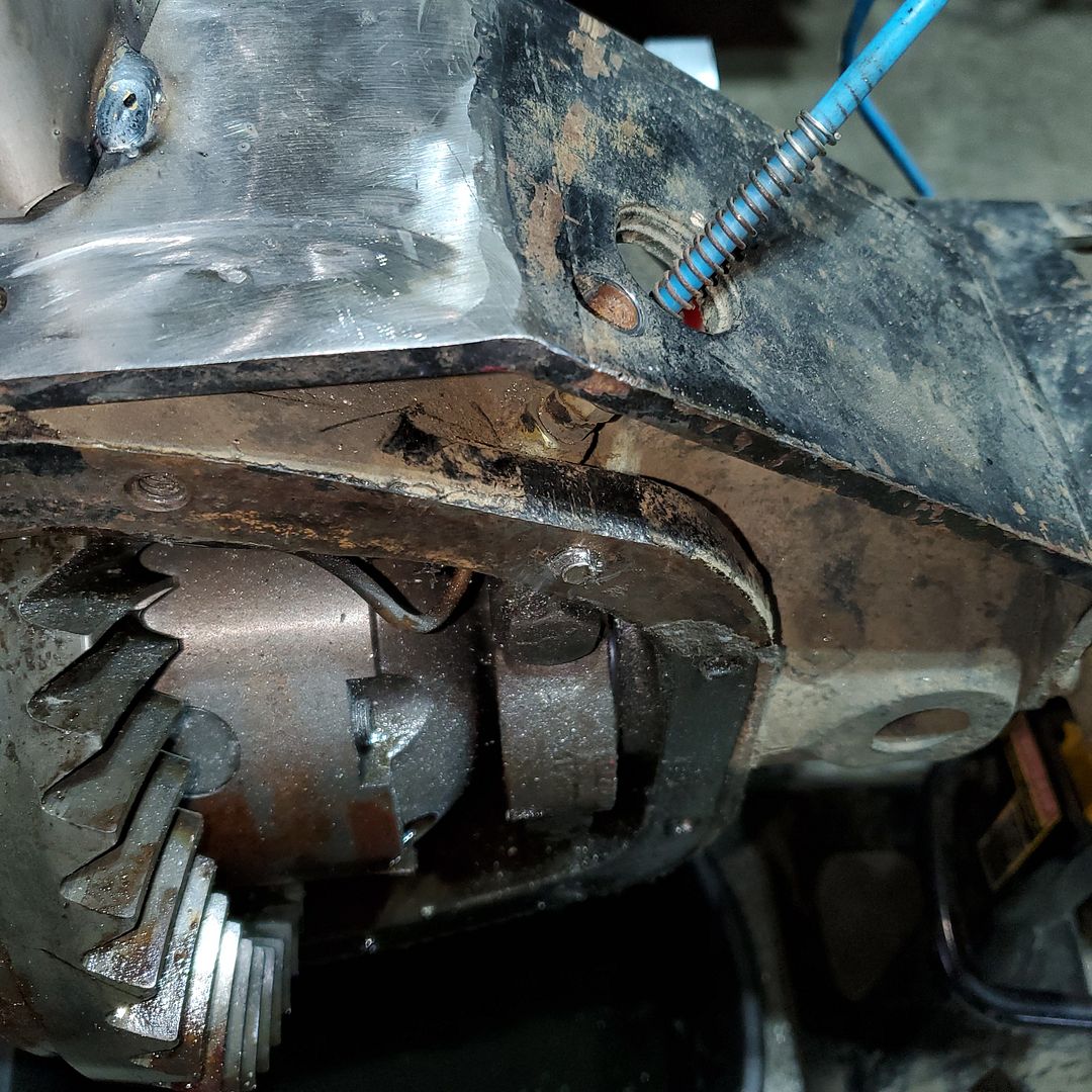

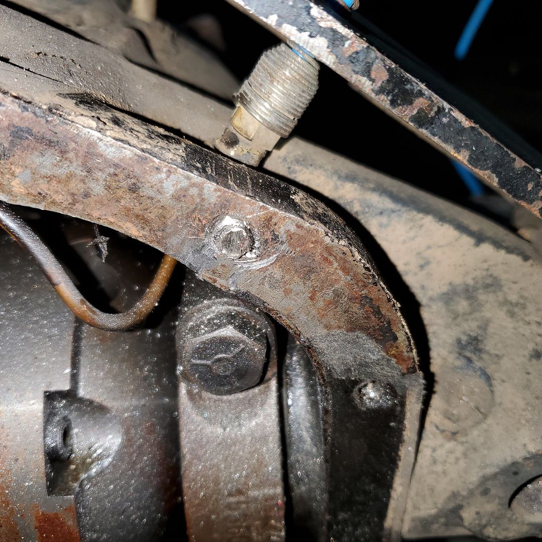

Nothing exciting for today. Was test fitting the tie in bracket some more and broke a bolt off in the diff. And of course I did something stupid two days ago after I was welding. I forgot to close the valve on my oxy/argon bottle. This is a new welder and I haven't gone thru the lines to make sure everything is tight with no leaks. So my newly filled bottle that I picked up 2 weeks ago and used twice is EMPTY..... DANG NAB I hate wasting money.
So I got out the drill bits and easy out with my fingers crossed I didn't bugger up the threads.
Took me a while but I did it and managed NOT to ruin the threads or anything else.

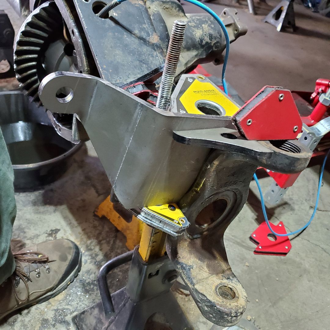

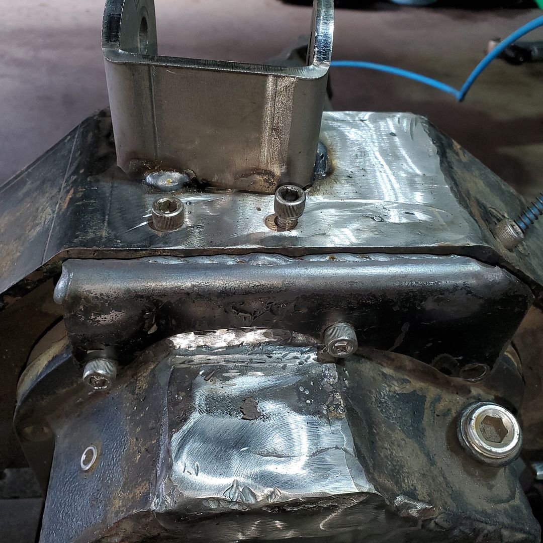

Been busy the past couple of days. Got the swaybar mounts welded to the axle. These came from Black Magic Brakes and moves them up onto the inner "C".
Welded on and ready for paint.

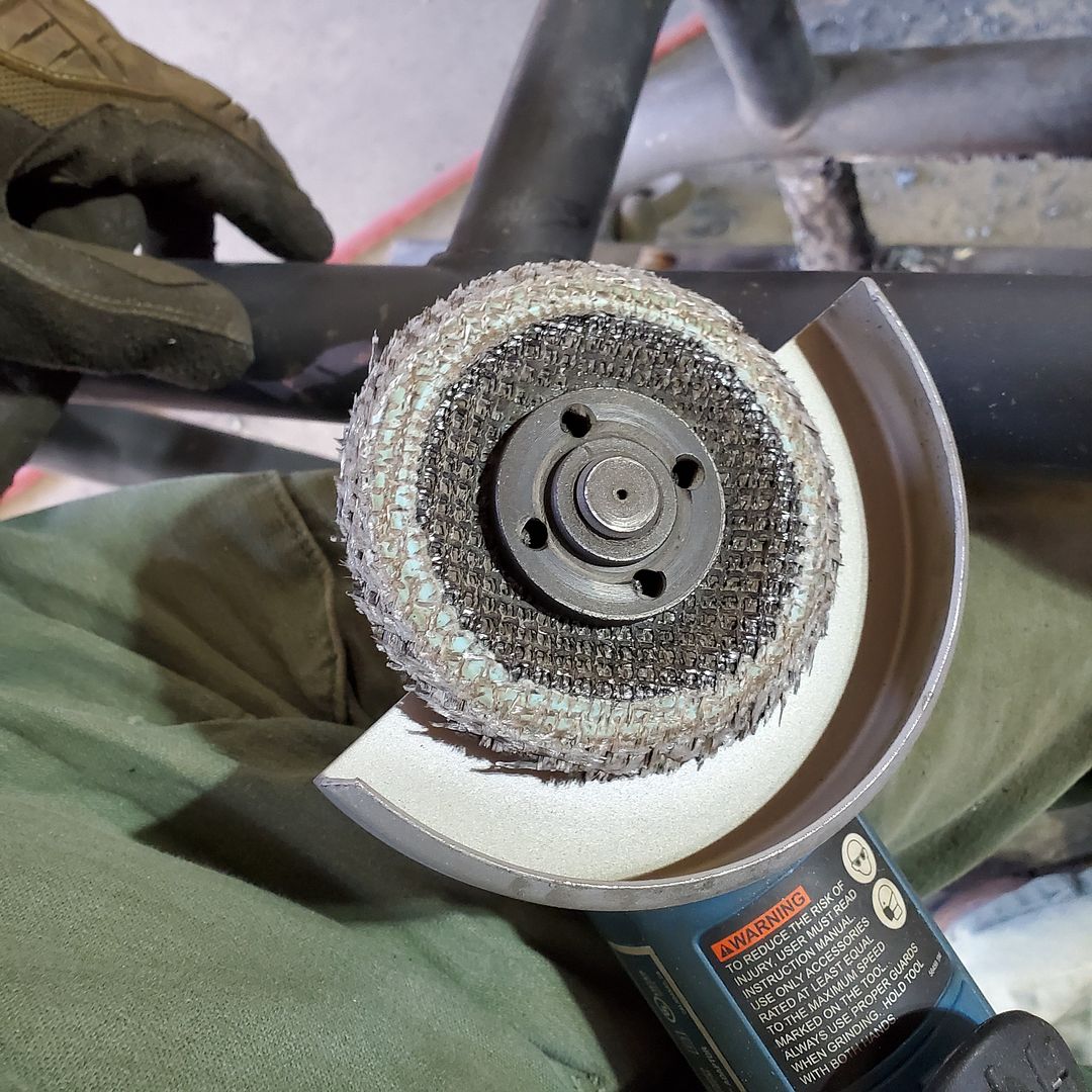

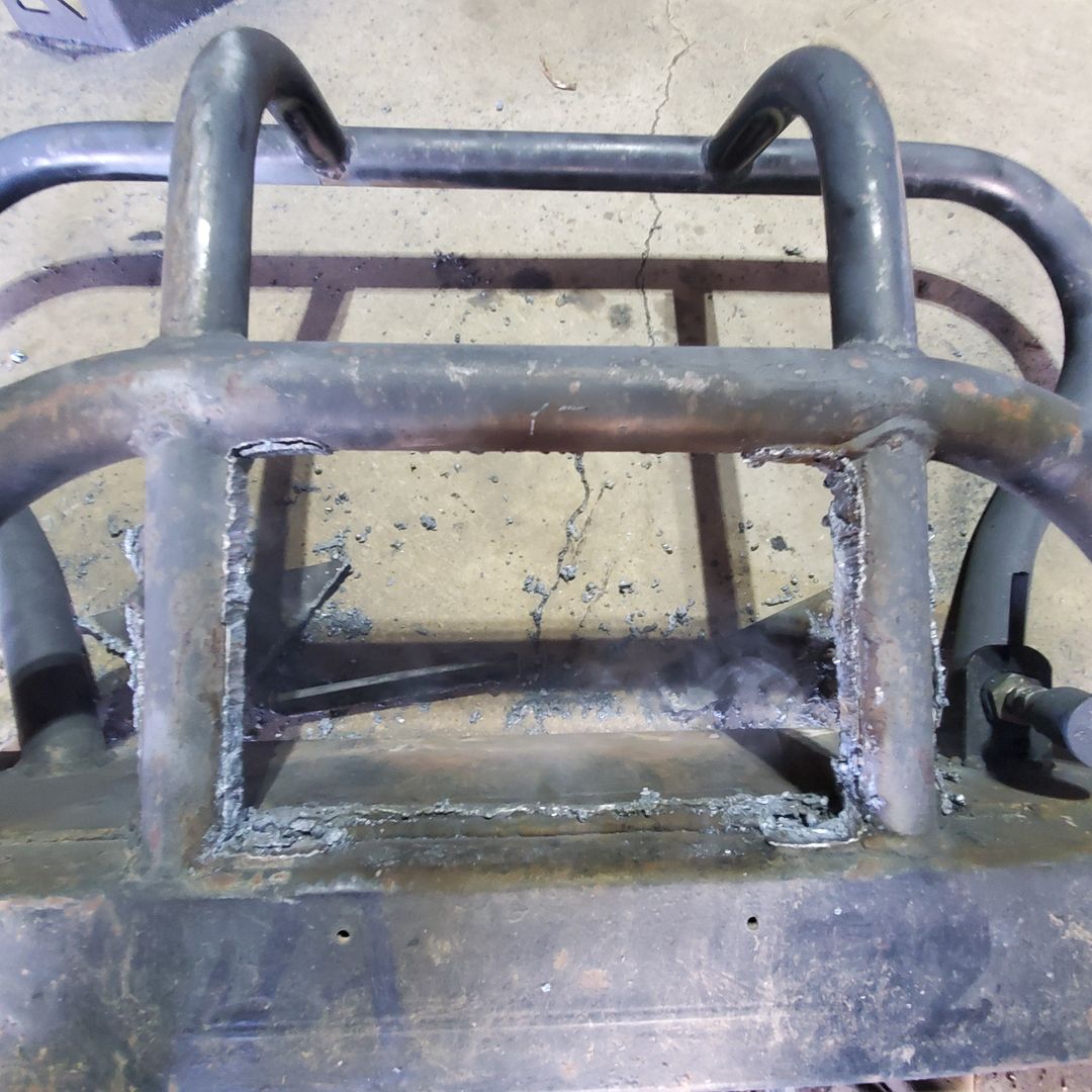

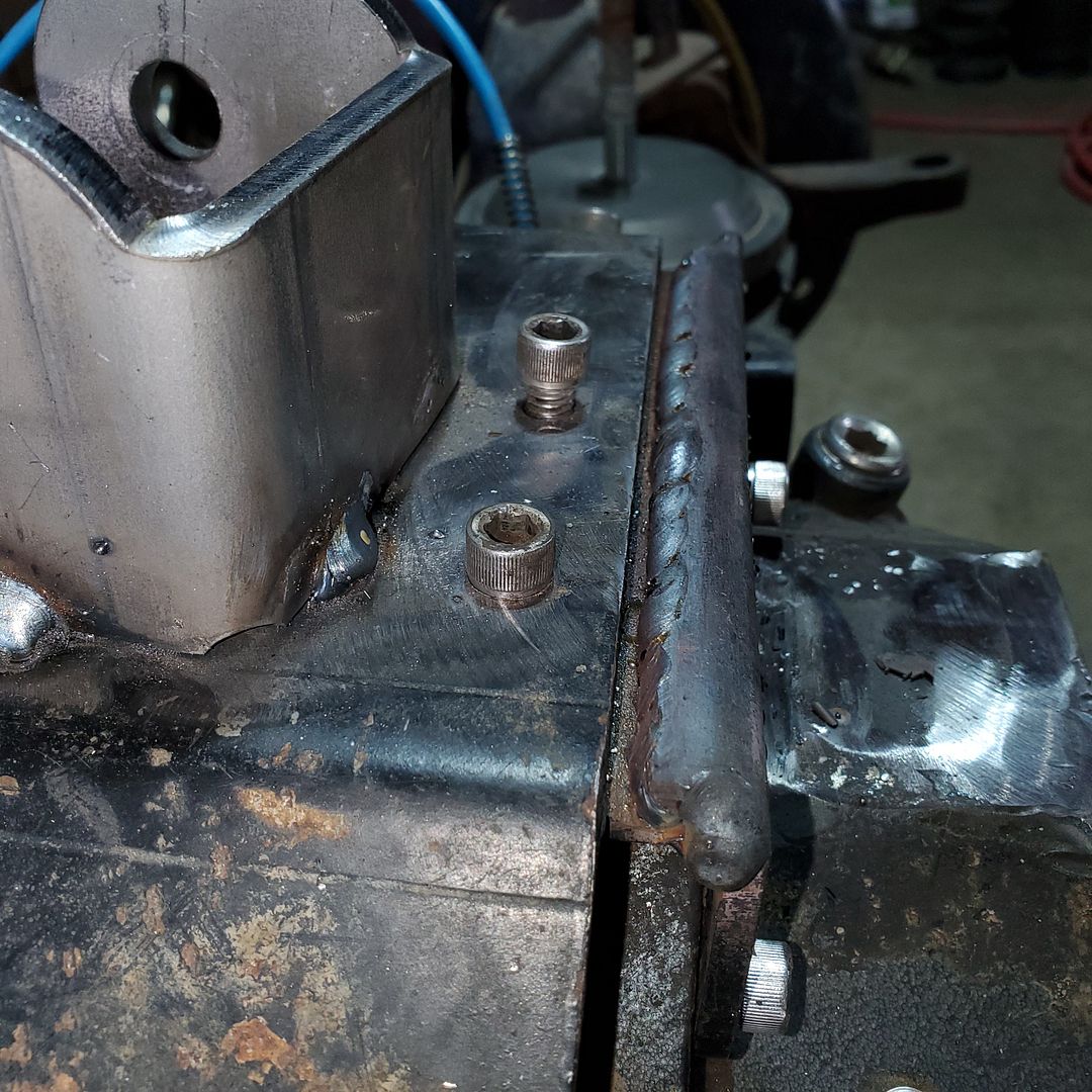

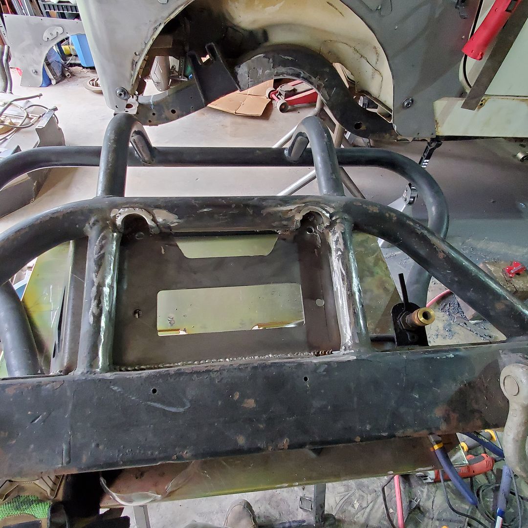

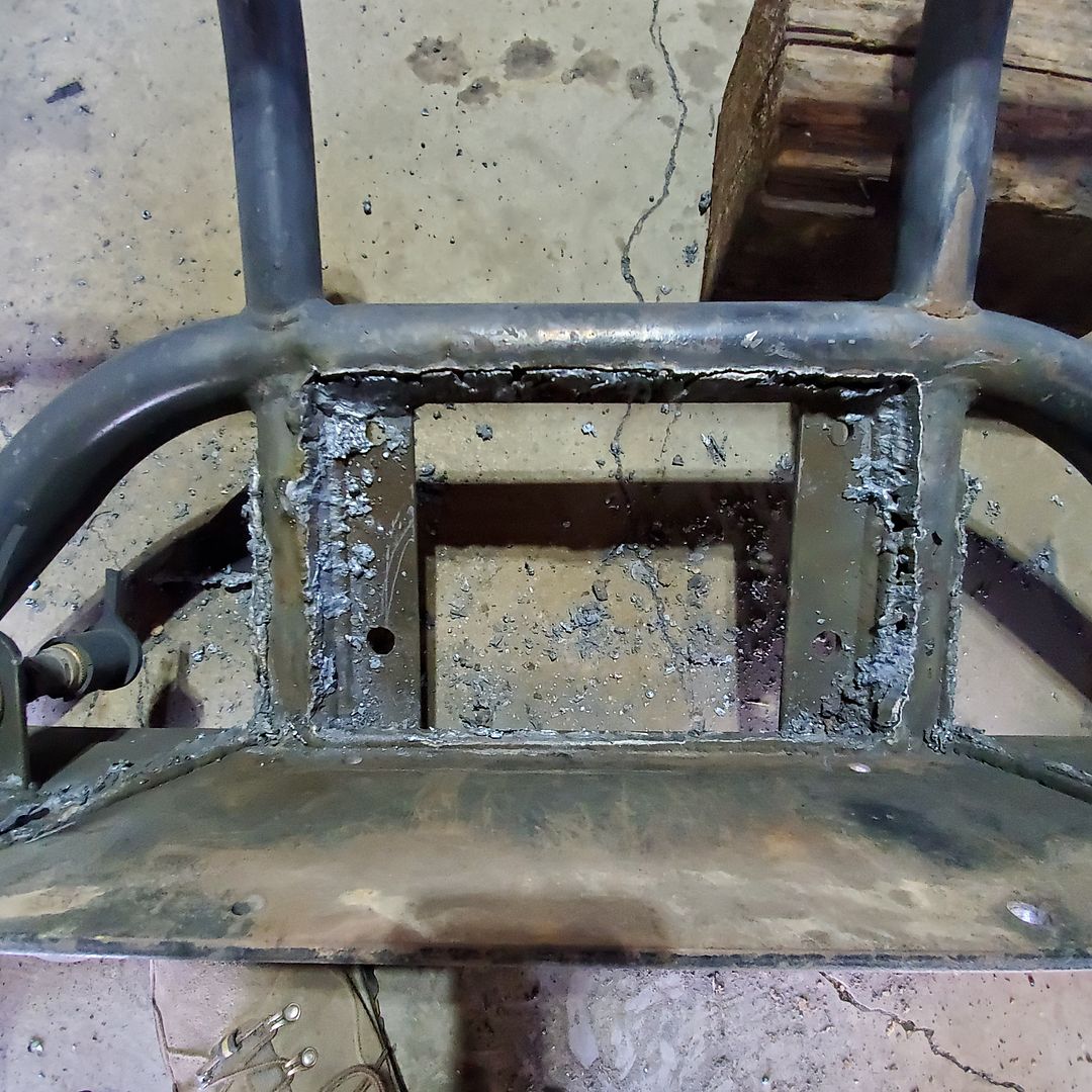

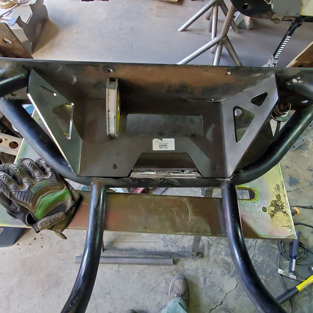

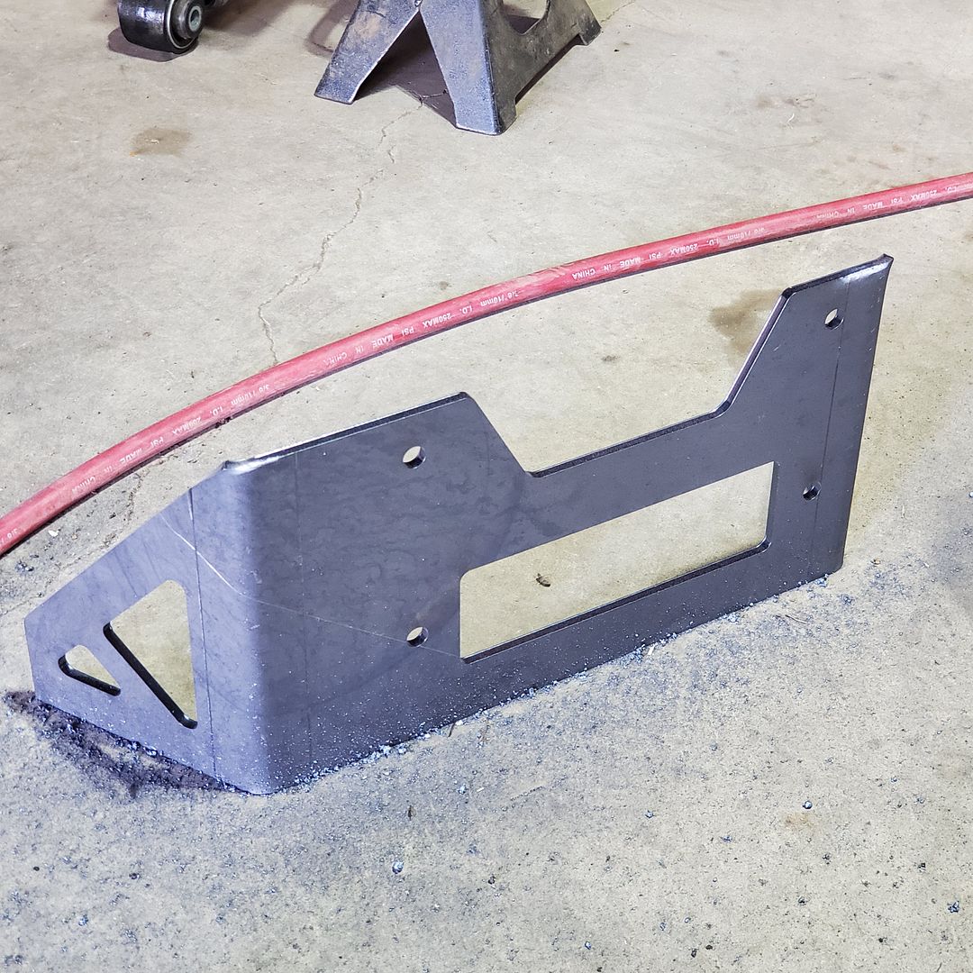

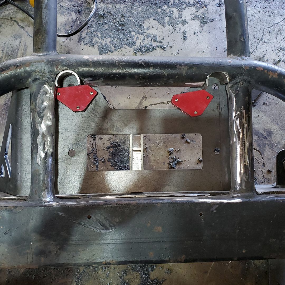

Today I decided I'd work on my front bumper. I needed to cut the old mounting plate for my Warn 8274 out so I could weld in a new mounting plate I got from TMR Custom. So break out the plasma cutter and have a little fun.
Here is the new mounting plate.
Cut and pry cut and pry. Then the plate was gone.
I was getting every last bit of use out of these flapper disks.
Get it all ground down so I can fit the new plate in place.

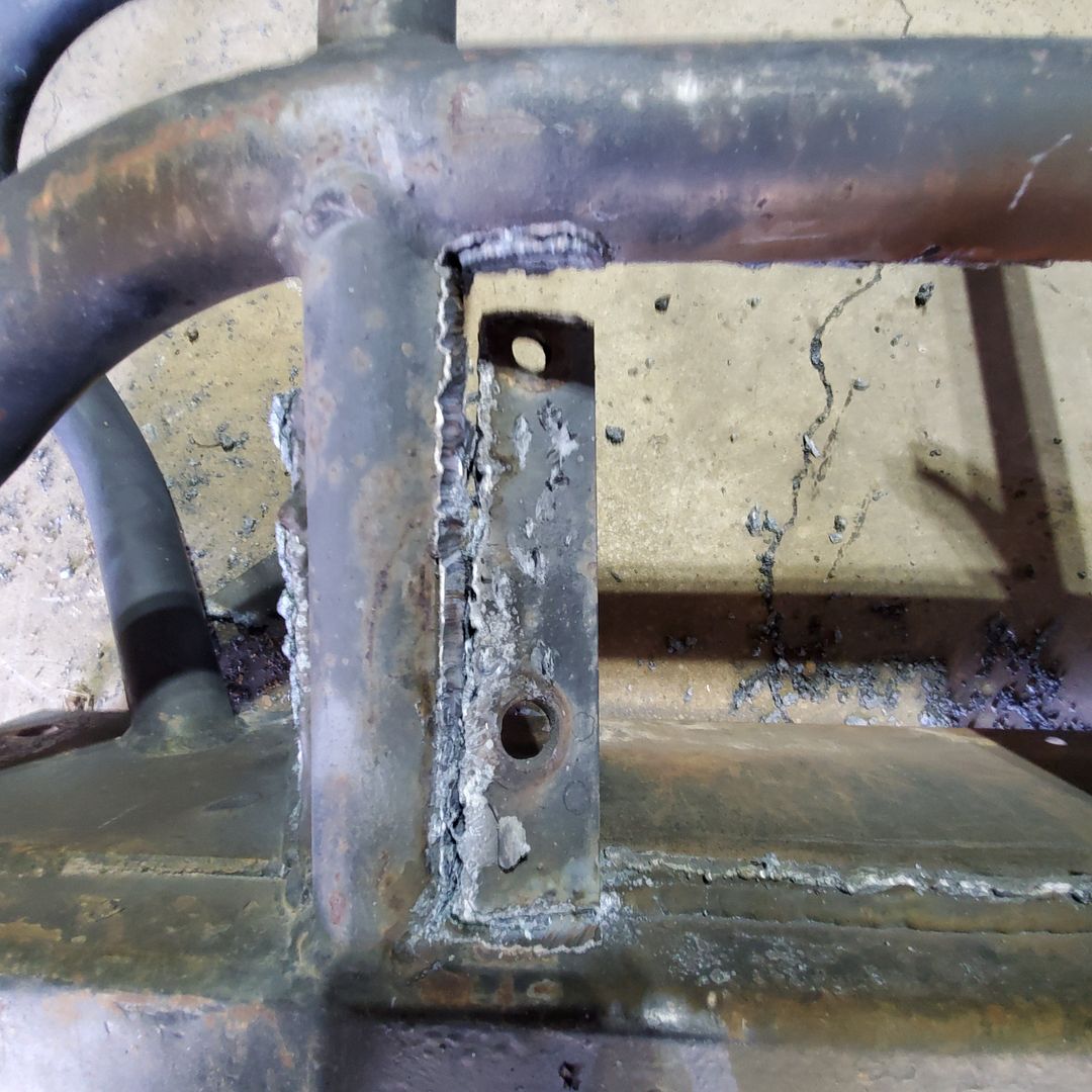

Notched the tube to fit the mounting plate in flush while trying to make it look better. Don't know if I am doing that or not.
Had to make clearance for the top 2 bolts. Hope my idea works.
Got to get this new welder figured out. Just can't seem to get the right.

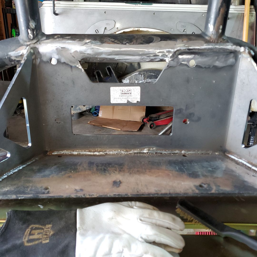

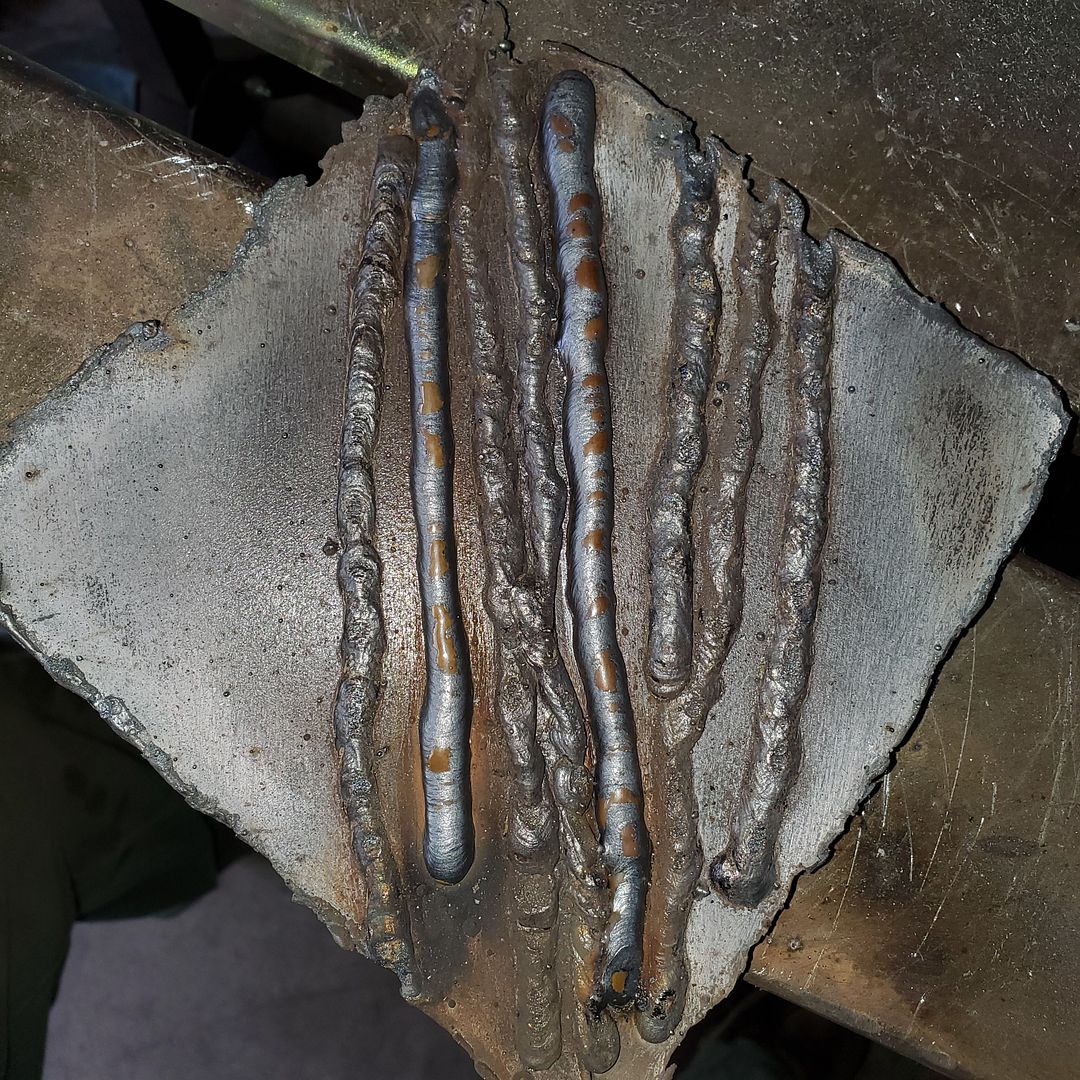

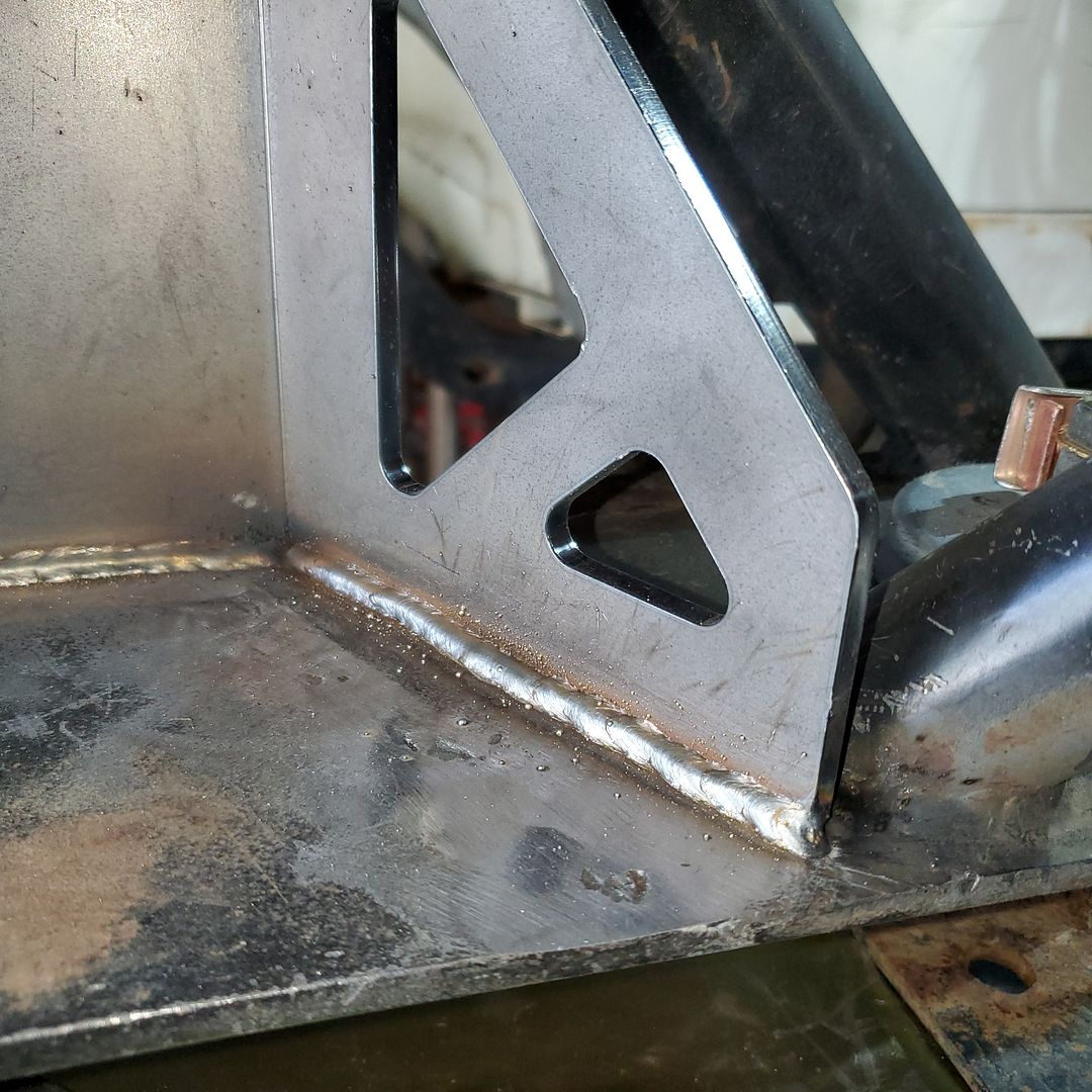

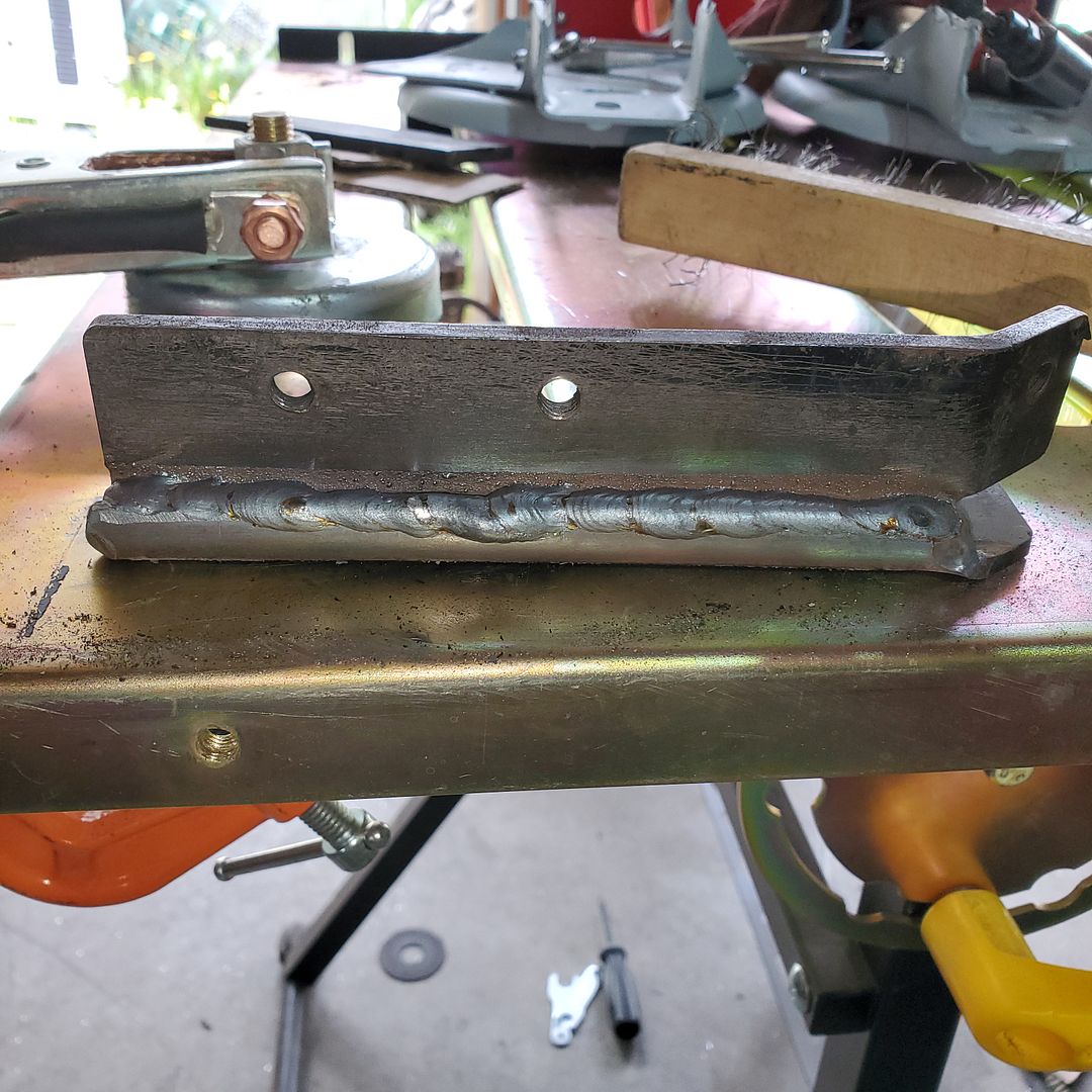

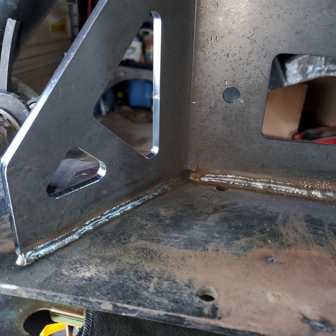

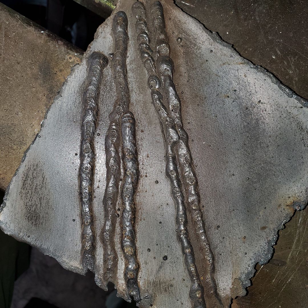

I started off the morning messing with my welder trying to figure out why my welds LOOKED like CRAP. ........ After adjusting the voltage & line feed I was still looking for a WHY. My welds looked wrong and I couldn't figure out why.
Then a forum member for another forum helped me out. Said it looked like I wasn't getting shielding gas or enough of it. So I started looking at my lines and other parts. After messing with the welder hose I got gas back to the nozzle again.
Can you tell which ones had shielding gas?
Might not be GREAT but they are a lot better.
