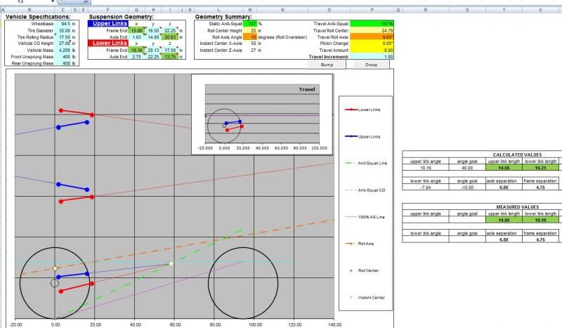

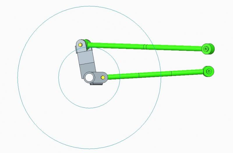

Well the weather this weekend ruined my travel plans so I played around with the 4 link calculator and then modeled it up real quick. Vertical CG I just used the bell housing bolt above the starter. But really I was just more interested in a delta between where I am now and where I plan to be when I do the stretch in spring. Let me know what you guys think!
Where I am now. 94.5" WB, 35s, OME 2.5 springs and Rokmen arms.
My plan for the stretch. I added separation and some angle calcs to the Pirate download.
I got the dims for the Synergy truss from Poly's website and found dims for the JJs online as well. To make the 3D model I plotted the X, Y, Z points from the Excel file and then constrained the JJs to those points. So it matches exactly. I like seeing the same info in two different formats.

the link placement looks very similar to mine. Which frame mounts are you planning to use?
Jeep looks good I love how your build went from 2010 on 33s to... o yeah I did a whole bunch of awesome ****!
Thanks man! Hopefully in 2014 I work towards a cleaner look like yours.
Frame brackets I think I am just going to run the salty Poly/Synergy ones. Some times you pay for convenience. Post #50 lays out my tentative plan for spring '14. I have to wait till I bring my other car out of winter storage as now the TJ is the DD. I want to run the matching Genright EXT aluminum flares and Savvy corner blanks (out of stock for 4+ weeks to date) then paint all the aluminum black. Just too blingy for me and I love the black on impact orange look.
One thing I realized while laying this out is that it is hard to have less than 8" of axle separation and keep the 25* upper angle the Poly mounts are set at. This forces your arms to be longer and forces higher frame separation. But I think what I have there will work well on ~6" rear stretch. About to start ordering parts! Currently working on my hp44 as that can be done on the bench.
