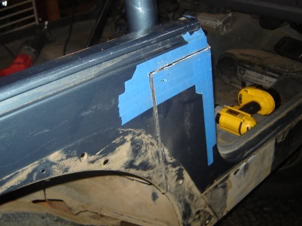

Mock up:

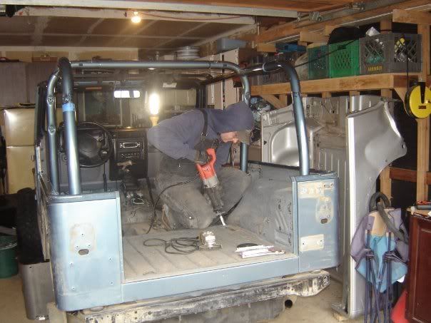

Cutting the tub:

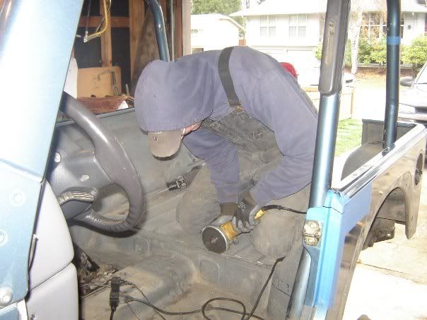

Removing the TJ tub.
I found a wrecked LJ tub in a bone yard, the back was still good. I have been storing this thing and dreaming of this day for 8 months. I will be using the floor, rails, and modifying the wheel wells for added storage. The rear will also be trimmed up to TJ spec’s.
