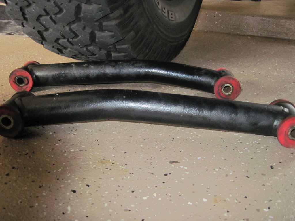

Mod: Currie front upper control arms; currie johhny joint, 15"
Mod: Currie rear upper control arms; dual currie johnny joint, 13.25"
Mod: Rokmen front lower control arm; Currie johnny joint, clevite rubber, 16"
Mod: Rokmen rear lower control arm; Currie johnny joint, clevite rubber, 16"

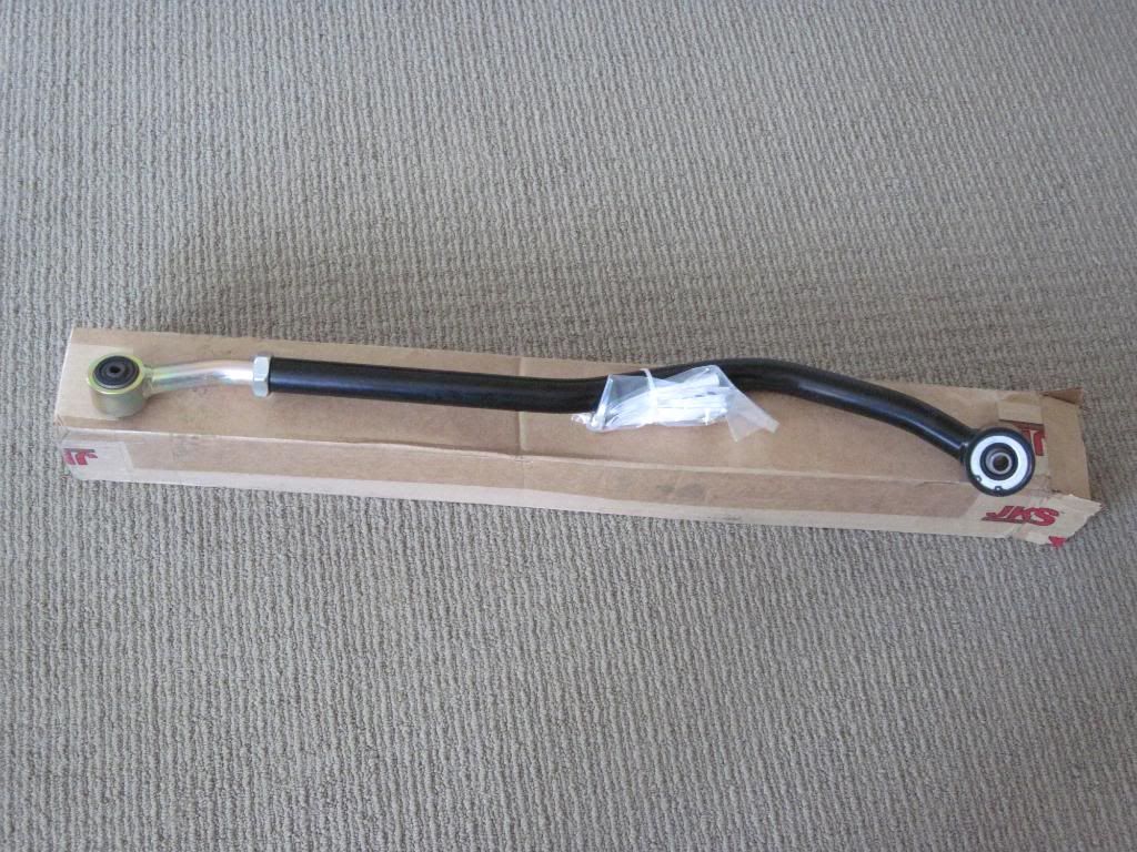

Mod: JKS front trac bar; currie johnny joint, clevite rubber,

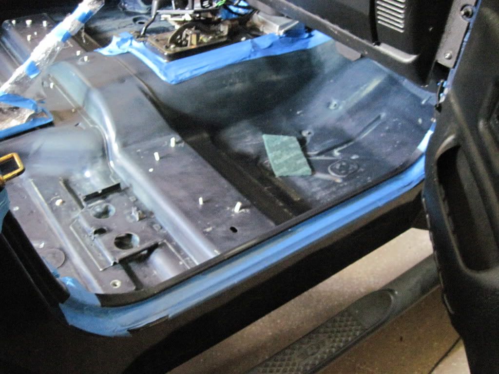

Mod: Monstaliner floor and tailgate; 1 gallon kit, black

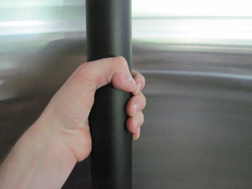

Mod: Kolpin RhinoXL Grips; top roll-bar as gun rack

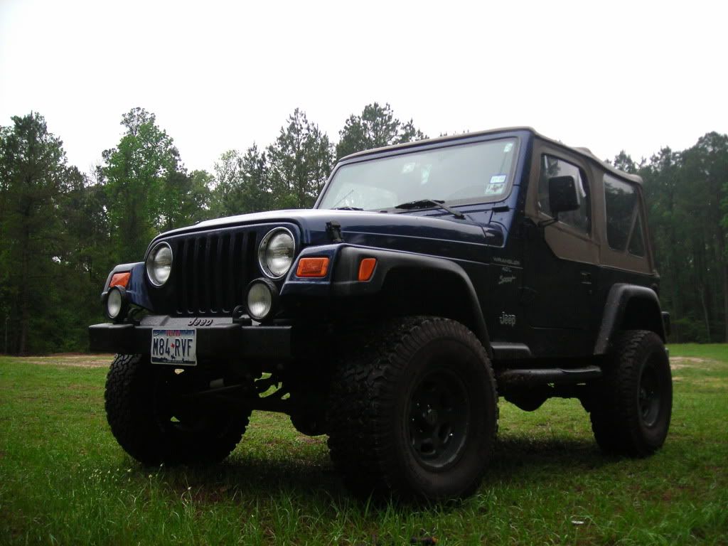

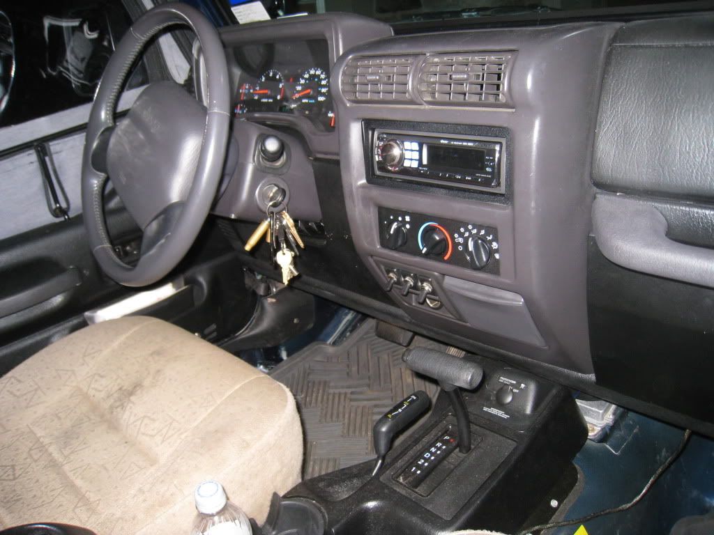

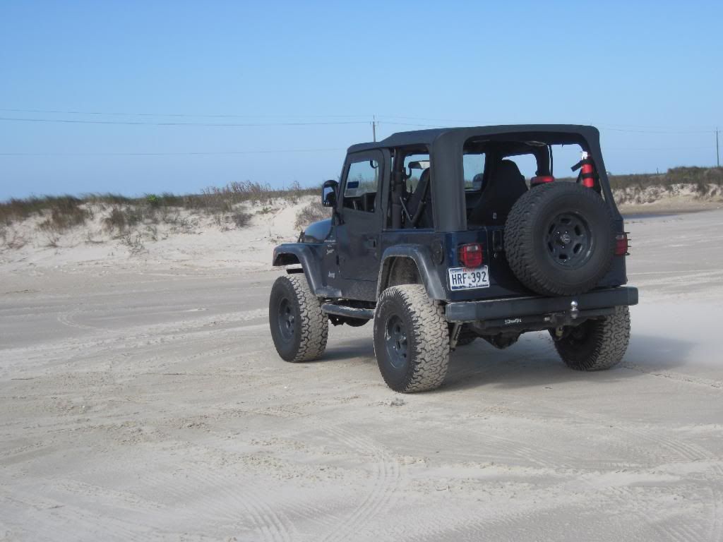

My dad passed down to me a blue 01 tj, 4.0 liter, 3spd 32rh, blue exterior, kahki top and interior, a d44 in the rear, 3.73 gears.
This is probably the earliest picture I have.

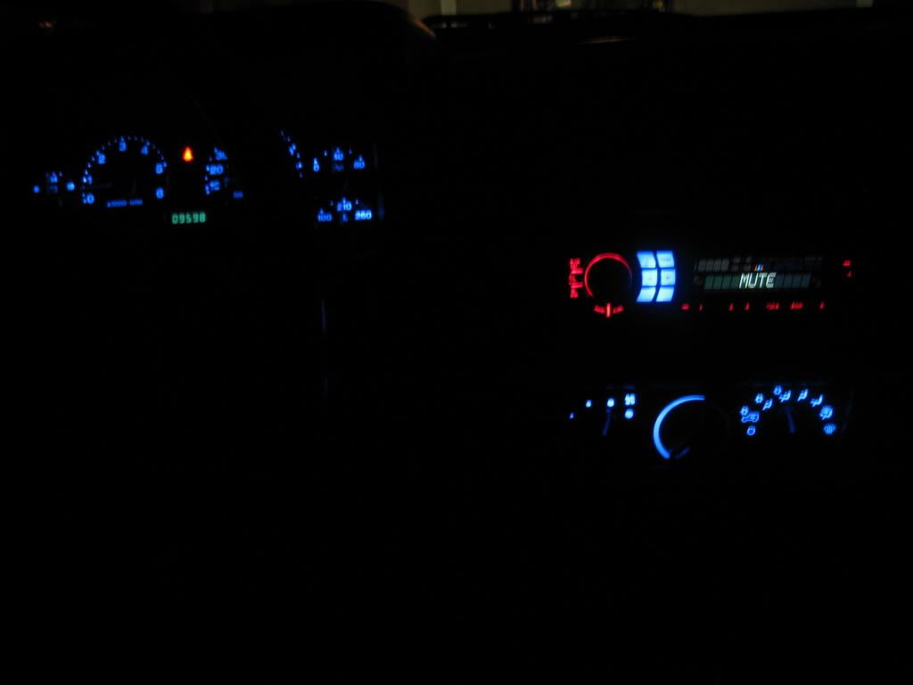

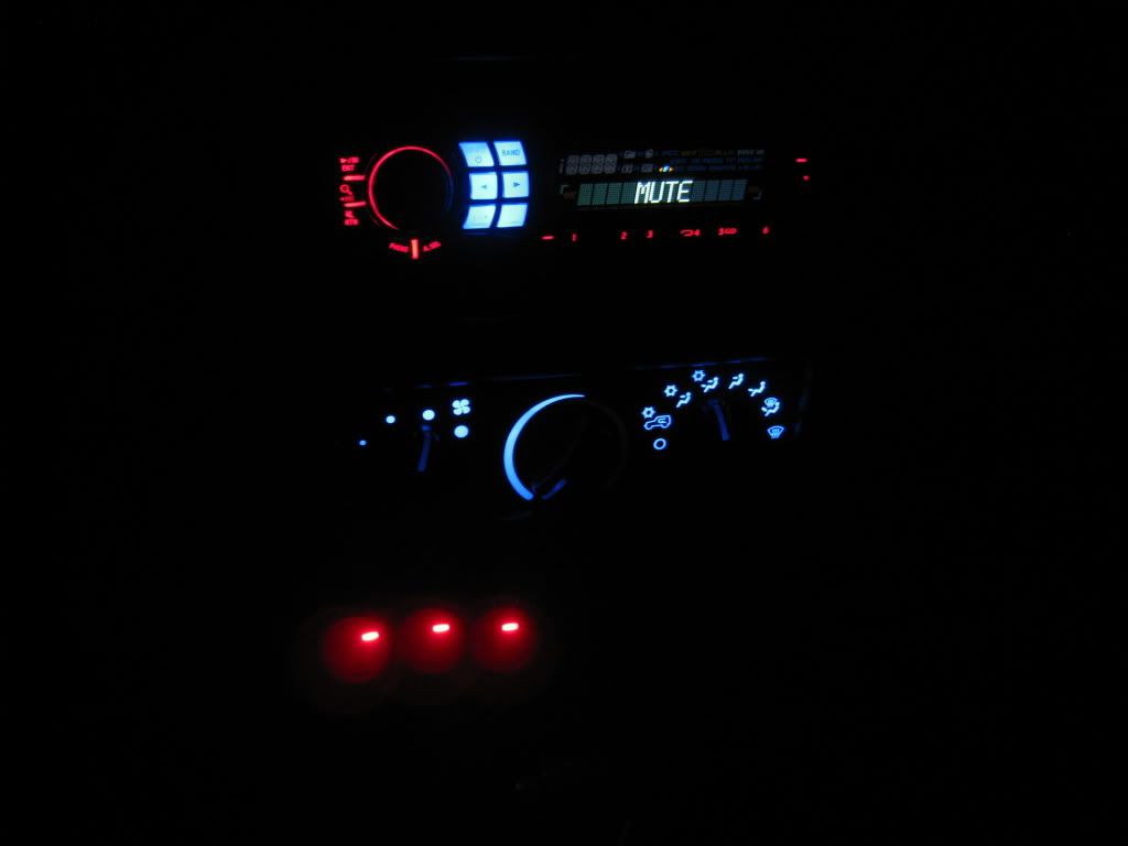

Of course what black dash wouldnt be complete without blue and red LEDS

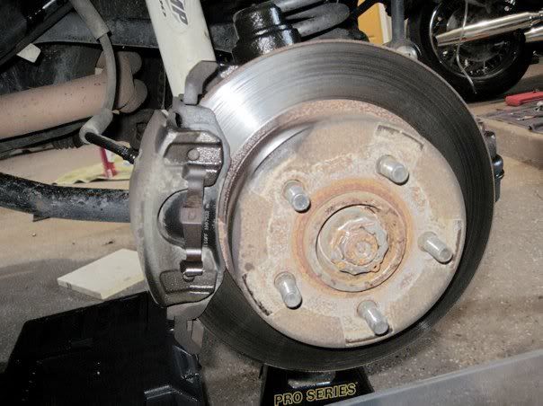

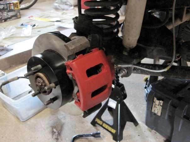

Well the time came to change the brakes, theyd been well overdue. I decided to add Goodridge stainless steel extended brake lines, and paint the new rotor and old calipers. Id never worked on brakes before but Id found 4x4xplor.com by this time and followed the guidelines there. I also went with the Preformance Friction pads he'd recommend in the article, which did feel like a step up from stock, without a heavy price tag.

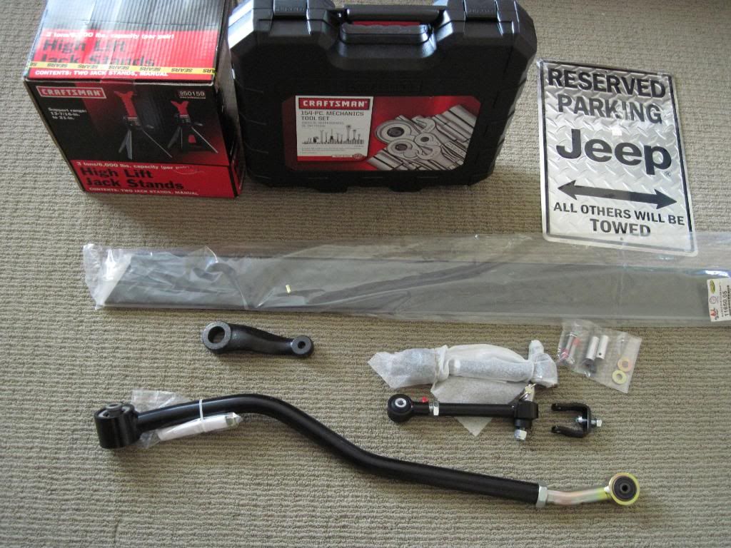

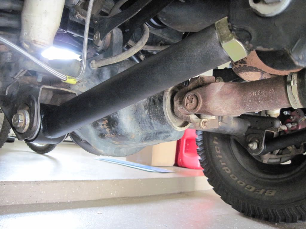

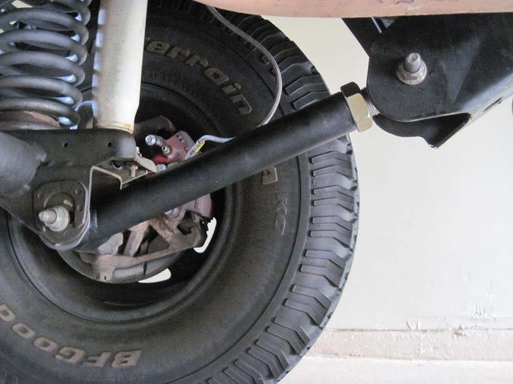

Around christmas I found some good deals on Northridge4x4.com and got a few things for myself including JKS quicker disconnects, a JKS adjsutable track bar and also a replacement stock pitman arm to replace the dropped one that was causing me trouble. I also was given jackstands and a jeep sign from my parents, and a big set of craftsman tools from my girlfriend, shes a keeper.
With some combination of the the new trackbar, discos and stock pitman arm, it cured the loud popping noise I use to have when turning, and a minor case of DW id been having.

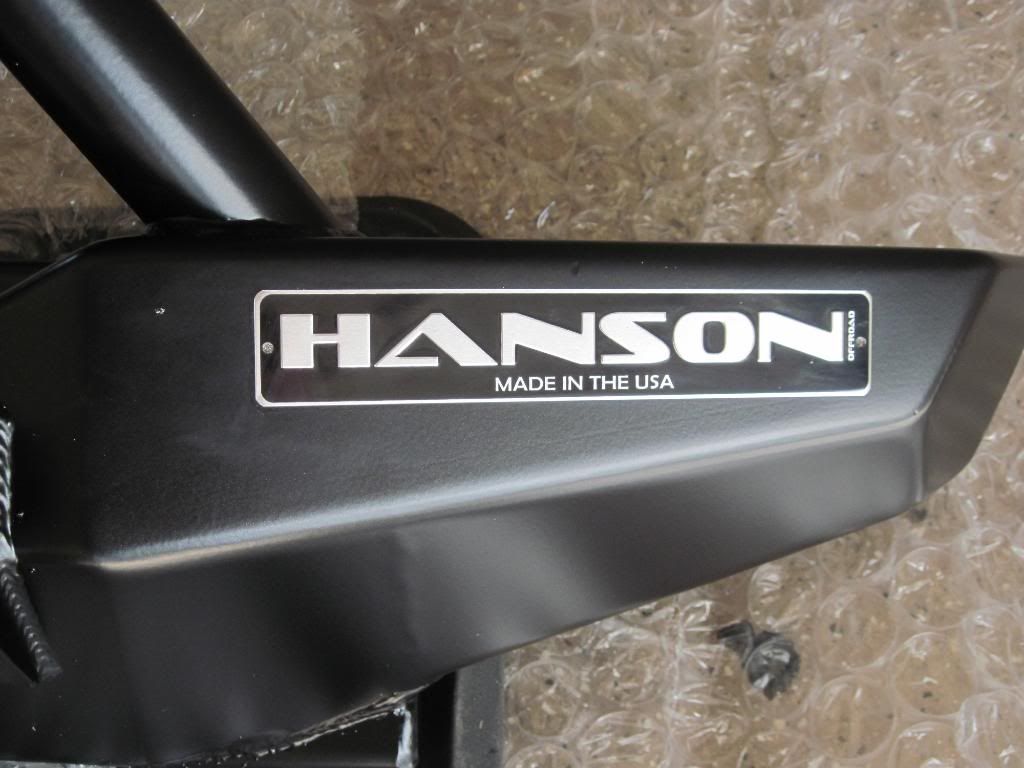

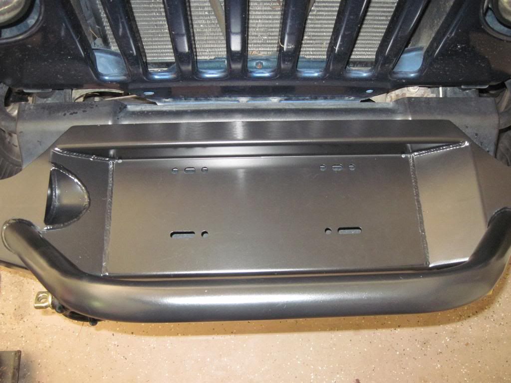

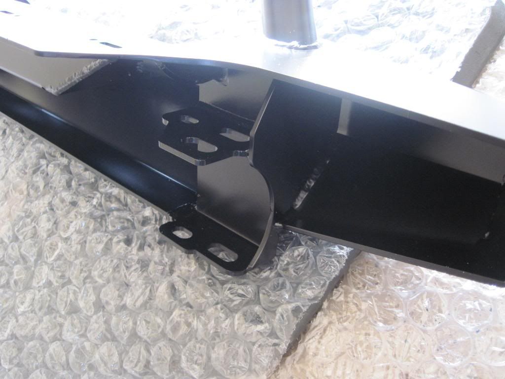

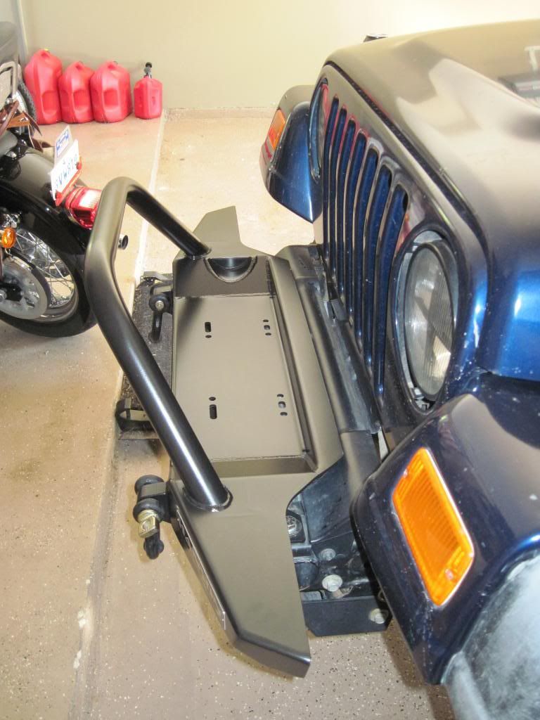

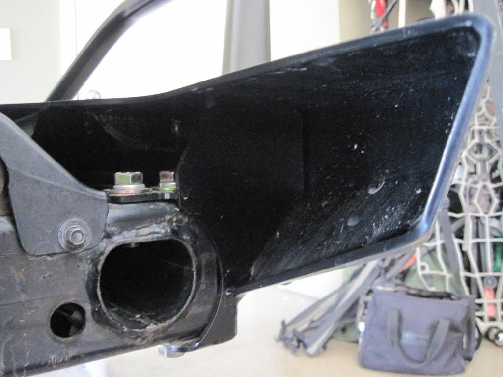

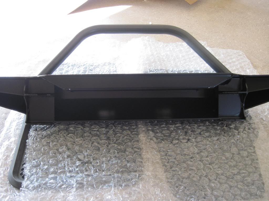

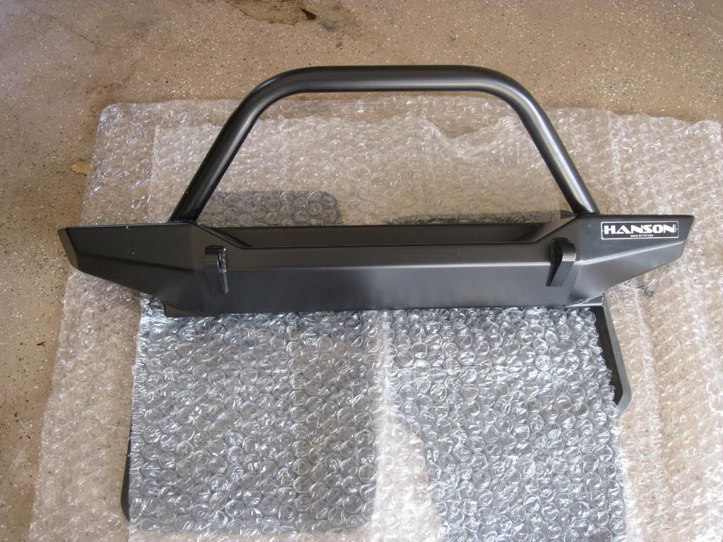

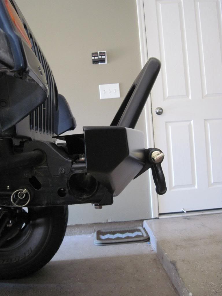

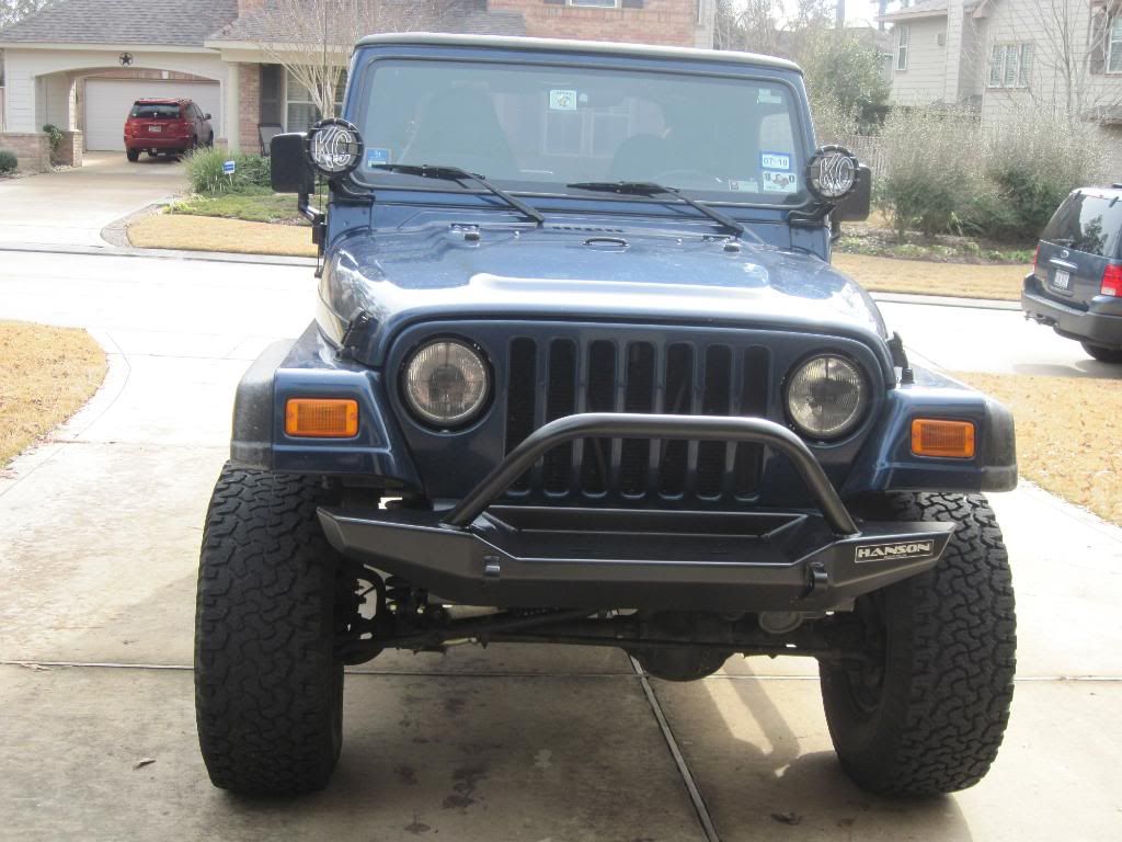

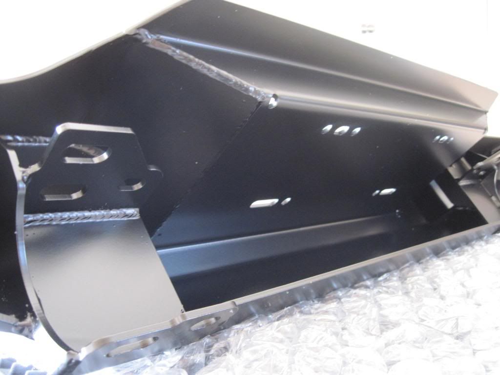

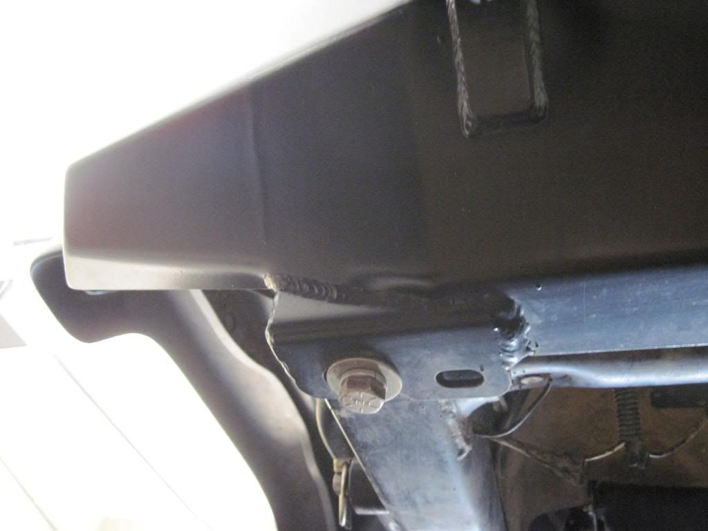

The other thing Id gotten for Christmas/Birthday was a new front bumper. Id long had my eyes set on the Hanson 52" Winch guard bumper. The biggest reason being the overall shape and aesthetics of the bumper.
The bumper has 45° forms in the lower face of the bumper. This form allows for great approach angles. The winch deck has a recess built into it to accommodate the cooling fins and longer motor of the Warn HS9500I and the 9500Ti. The bumper has the standard 4 ½” x 10” bolt pattern pre-cut holes in the bumper. The winch bar is constructed of 1 ¾” diameter x .120 wall tubing and is angled forward and welded for strength.There are two Clevis tabs to be used with the popular 3/4” Clevis shackle with a 7/8” screw pin. The tabs are 1” thick and are drilled for the 7/8” pin. Theyve received about 10 ½” of ¼” wide continuous weld. They are also placed approximately 2” off of the front center section of the bumper on the wing face. This points them 16° side ways to relieve the Clevis of stress created from a side pull. If a straight pull is done, 16° is not going to stress a Clevis. Theoretically, there would be a 64° range of motion for the cable. 32° on each side of center line. The bumper comes in a black semi-gloss powder coat, with an aluminum name plate attached onto the driver side wing.
It fits TJs, YJ and CJs.
shipping weight = 74lbs. Not for the weight watcher.
It shipped with grade 5 hardware, but I felt it necessary to upgrade to some grade 8.
I love that it mentions Made in USA on it.
I got the black and yellow zinc shackles at the local tractor supply. I put rubber grommets on them, to keep any rattling at bay since Ill probably just be leaving them on all the time.

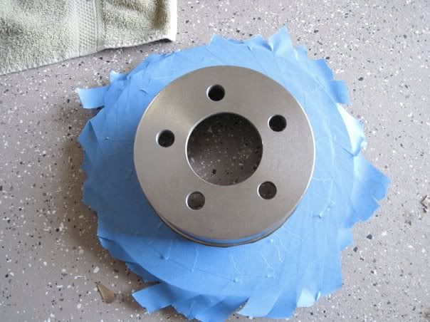

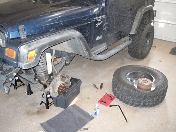

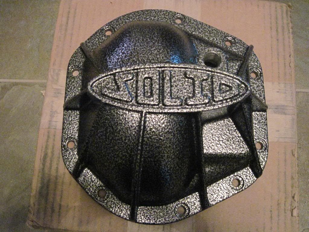

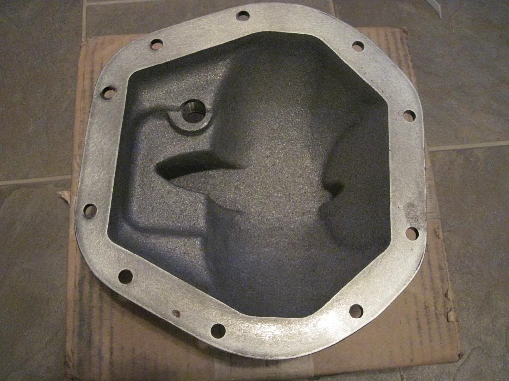

It then came time for a diff fluid change. I also wanted to add diff covers and found a good deal on a pair from Solid axle industries, $120 for a pair. I really dig the aggressive two tone hammered powder coating on these things.
The front change was simple after Id gotten a bigger deadblow hammer from sears. Unfortunately a bolt broke off in my rear when removing the stock cover and I had to get help extracting it and helicoiling it to finish the job.

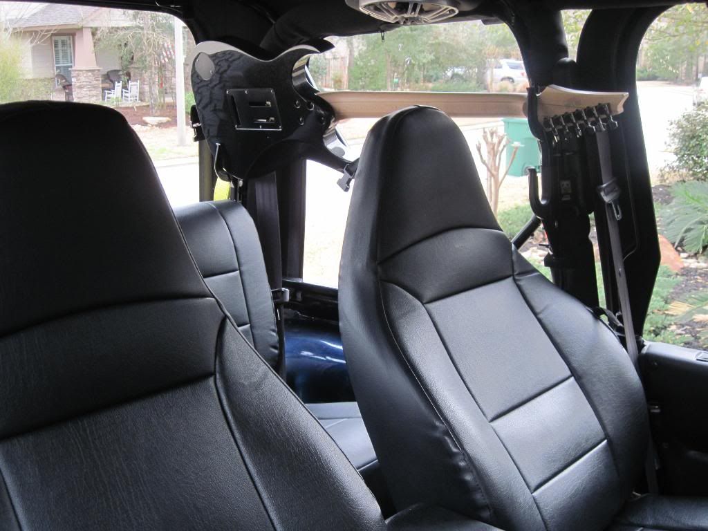

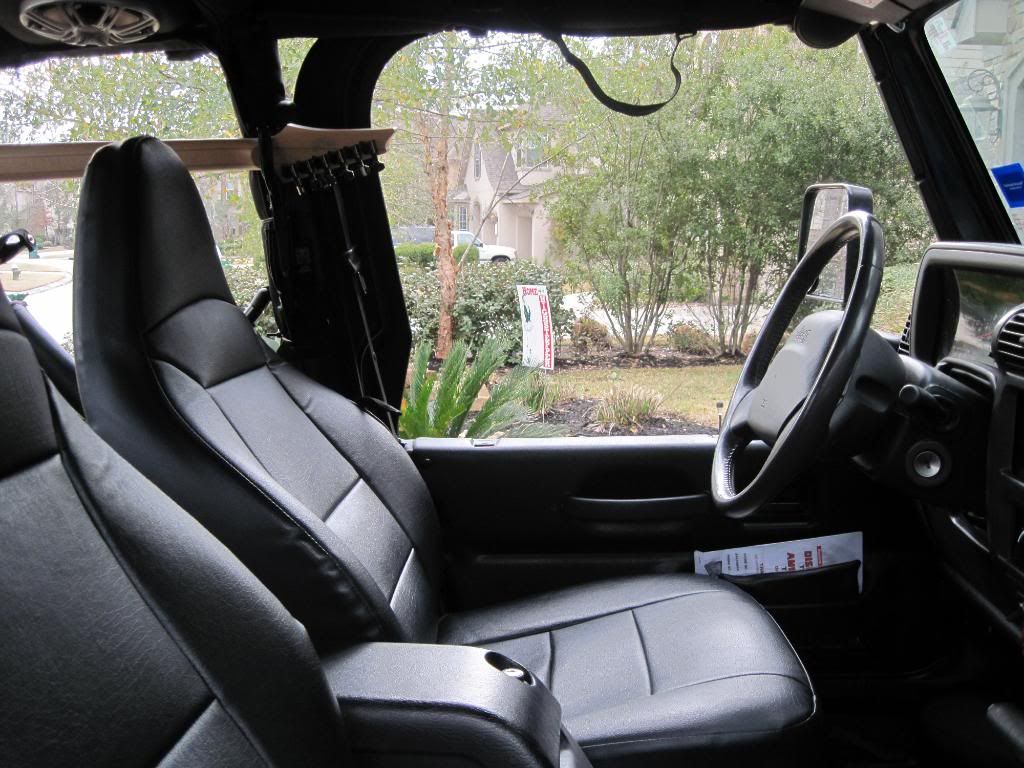

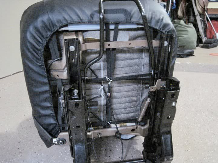

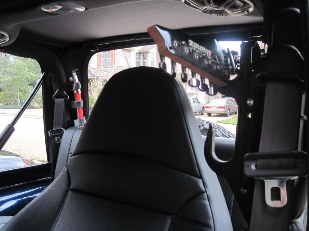

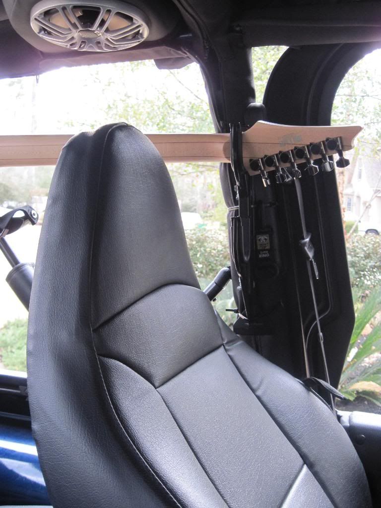

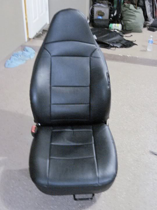

I had to get ride of the last bit of kahki..the seats. I ended up deciding on Iggee seat covers becuase of the good things Id heard on here. Im really glad I didnt go with a neoprene. The pleather look is sexy as hell.
It also doesnt seem to get as hot as the stock fabric seats did. The only thing I dont like about them is that theyre attachment points are pretty weak, just stretchy loops, held together by an oversized paperclip. They also didnt cover all the kahki color, on the lowest portion on the rear of the front seats. The rear seat, however fits like a glove and has a zipper down one side thats really keeps it on tight.
Also I mounted a gun rack between my rollbar using zip ties and very large pliers. In addition to holding rifles, I soon discovered that in combination with bungee cords it would safely hold my guitar in transit to band practice. (its an Ibanez Prestige RG2550EGK for anyone who cares to know)

I guess you could call this completion of PHASE 1

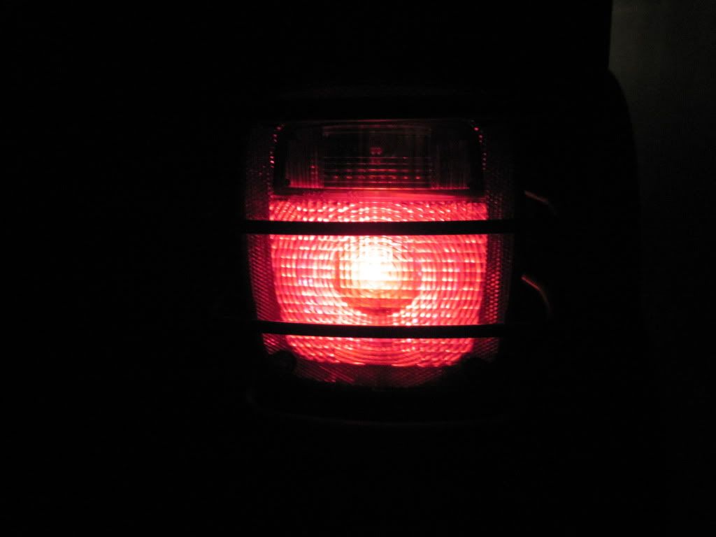

Around this time I took it to the beach to camp for a week with some friends.

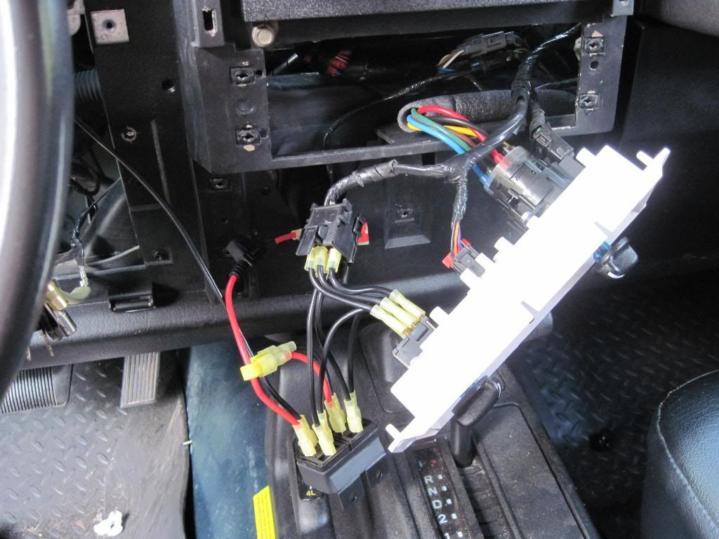

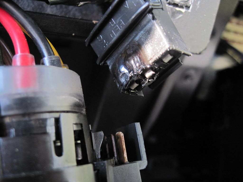

On the long ride home, id discovered my air conditioning switch went out at position 3 and 4, and my jeep was overheating, so it would have been a pretty miserable drive home.
I pulled it into a firestone on the way, and they pointed out the leaking thermostat. They wanted to charge $250 to do it, so I went across the street to autozone. Bought the parts and borrowed some tools and changed it in their parking lot. I think I came out under $50.
I later replaced the blower switch and added some relays and 12 guage wire to keep it from overheating again.
It has worked well, I havent had to replace the switch, but I do have a problem with it sort of turning itself off every 5 minutes, which I suppose is a good cooling solution, but sort of annoying. It could be that my wiring is wrong.
I also found this plug overheating too not sure how to fix that

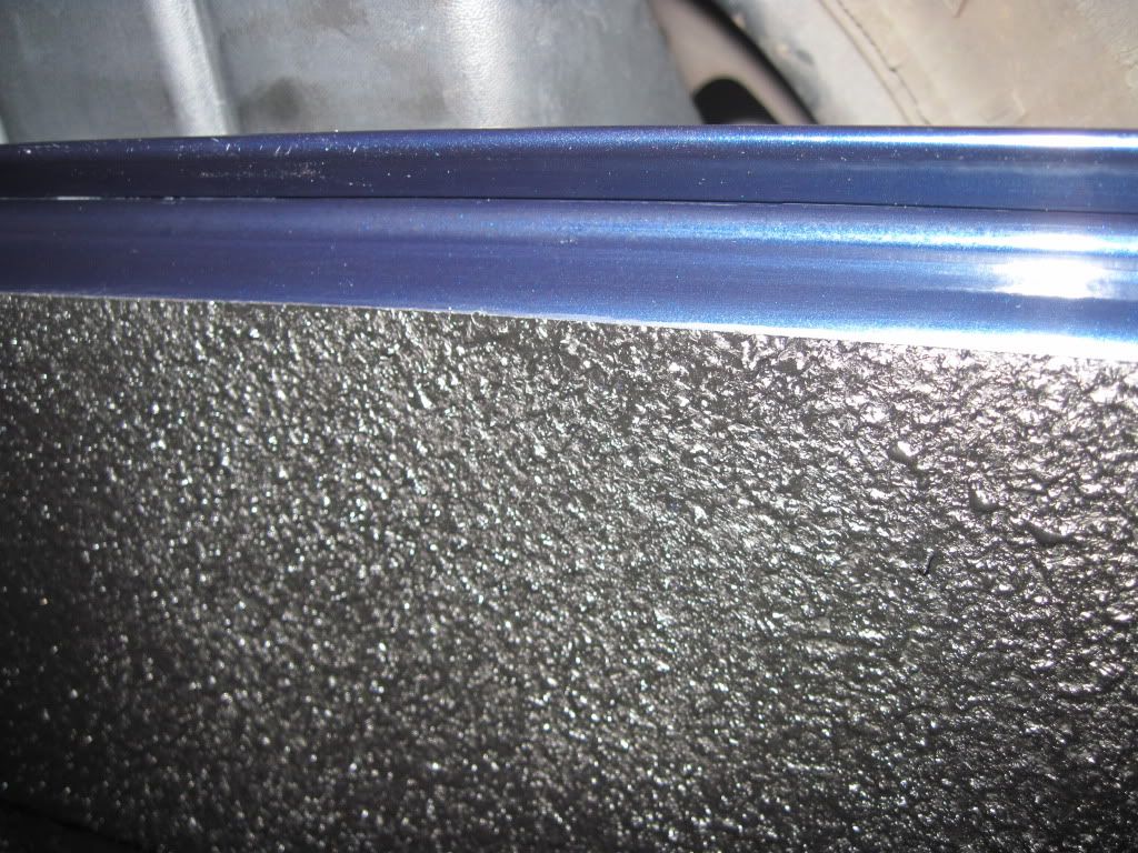

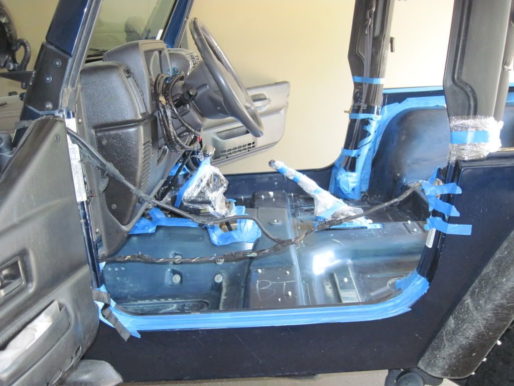

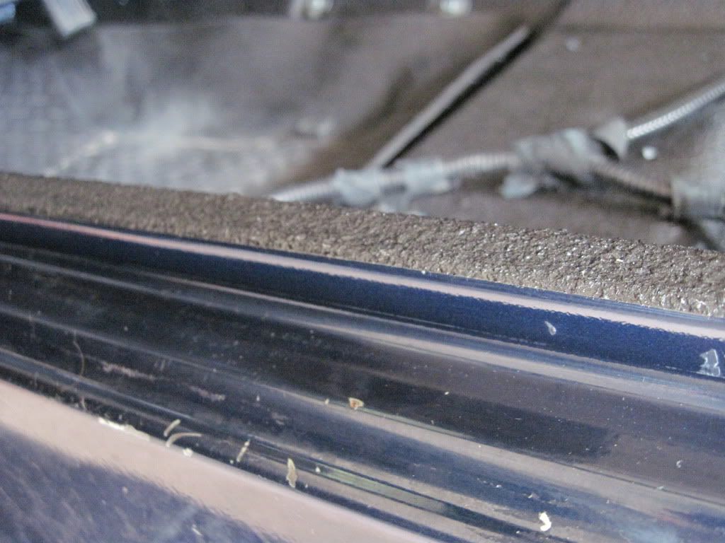

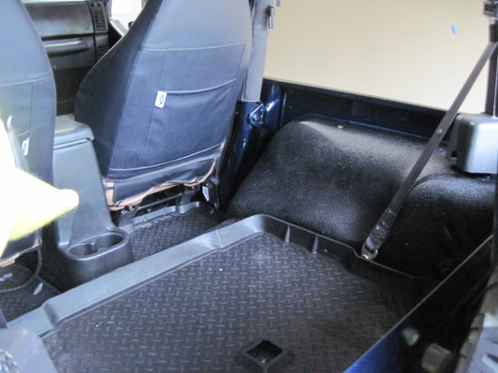

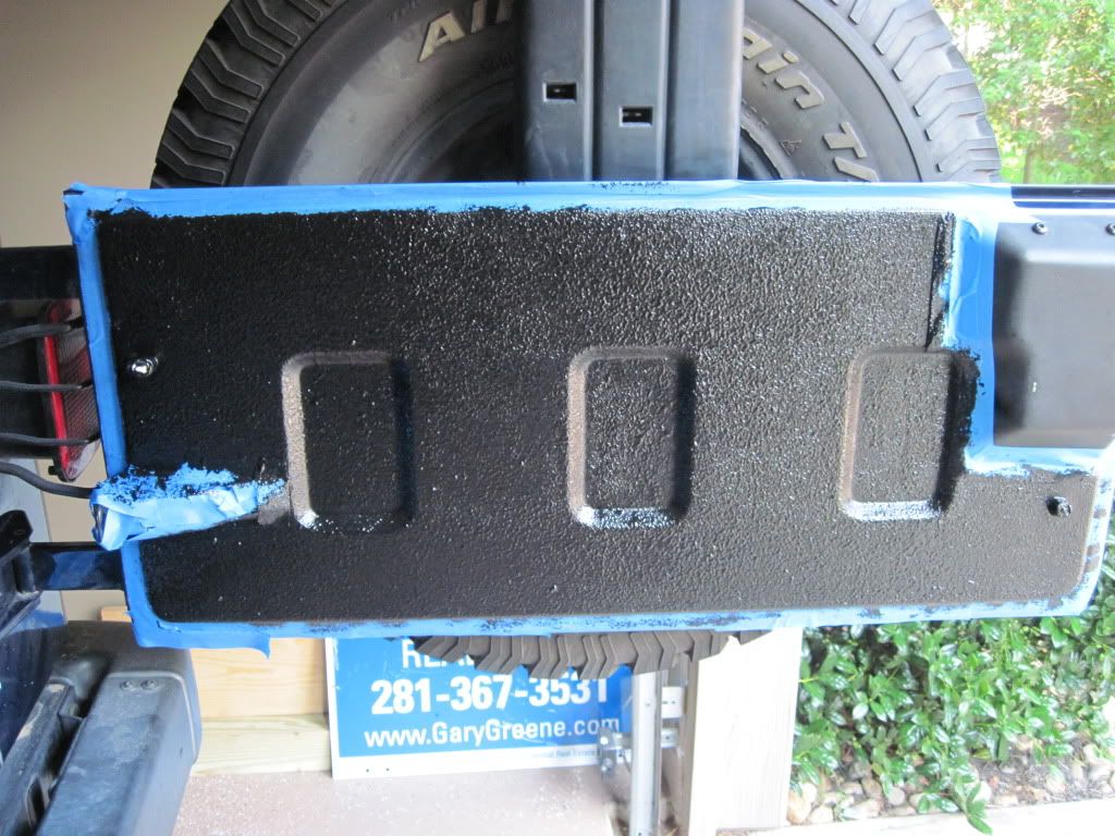

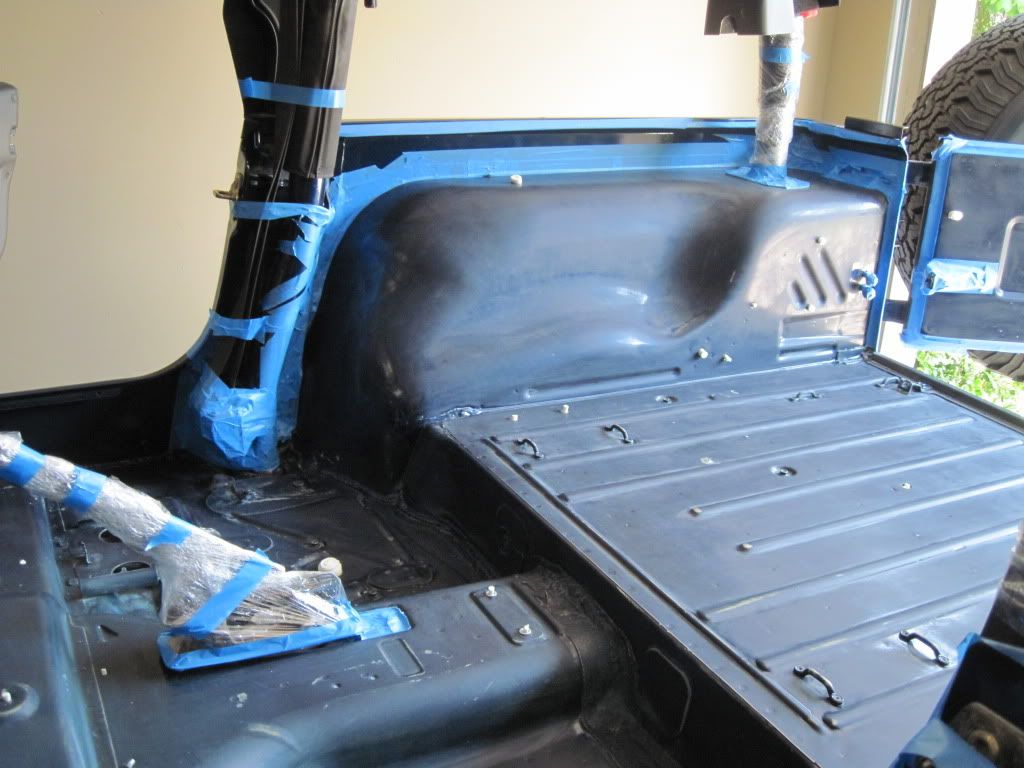

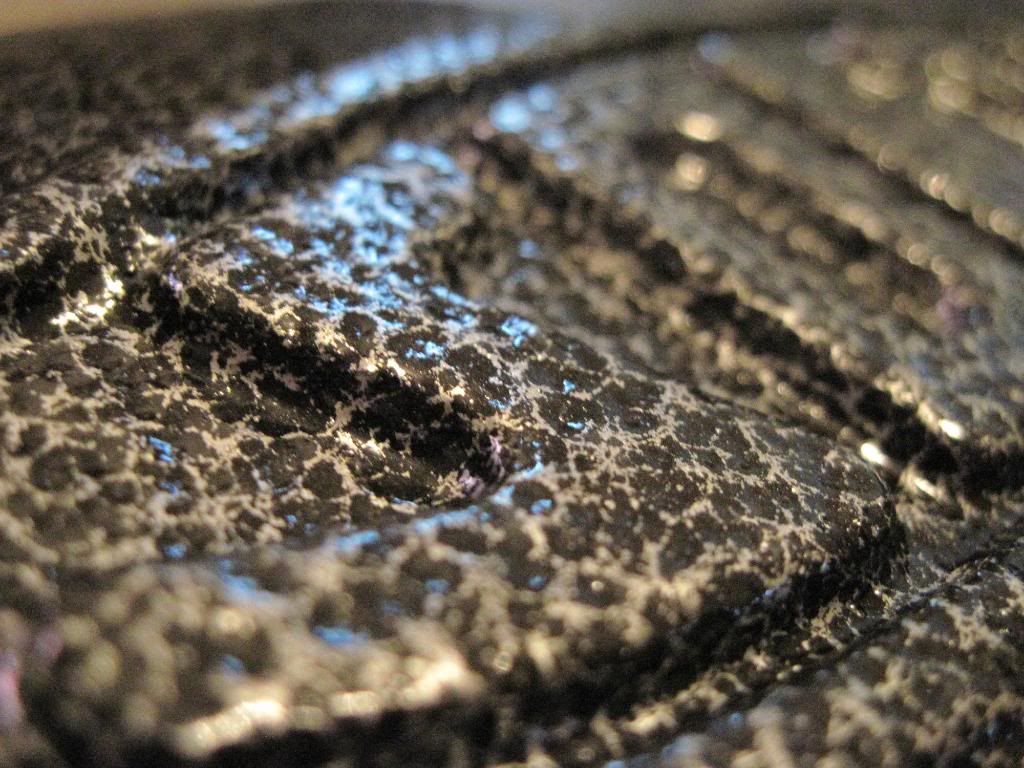

Starting PHASE II
After discovering the Monstaliner deal here on jeepforum I just had to get it to complete the interior.
I spent 3-4 days on the whole process of stripping the interior, hand sanding, painting, drying and reinstalling since I was working alone. I used little rolls of foam tape to plug all the threaded holes.
Id recommend buying good gloves to handle the MEK, which I picked up at ACE Hardware. The stuff was so nasty it soaked right through latex gloves Id grabbed from the last doctor visit. It probably didnt help when I spilled half the can all over my shirt.
Other than that the only problem I had was with the rollers breaking apart. I hadnt ordered any more rollers and only had two to work with. Because I had started from front to back, I ended up with a more rough texture in the rear wheelwells and tailgate from large flakes of roller material and the inherit tackyness once the mixed solution had began to dry in the roller tray. I wanted that gritty sandpaper type texture on my door sills so I "drybrushed", or rolled over lightly the tacky drying paint, to pull out a similar but more unified texture with good results for slip resistance.
I added new Husky floor liners on top to help with the floor heat.

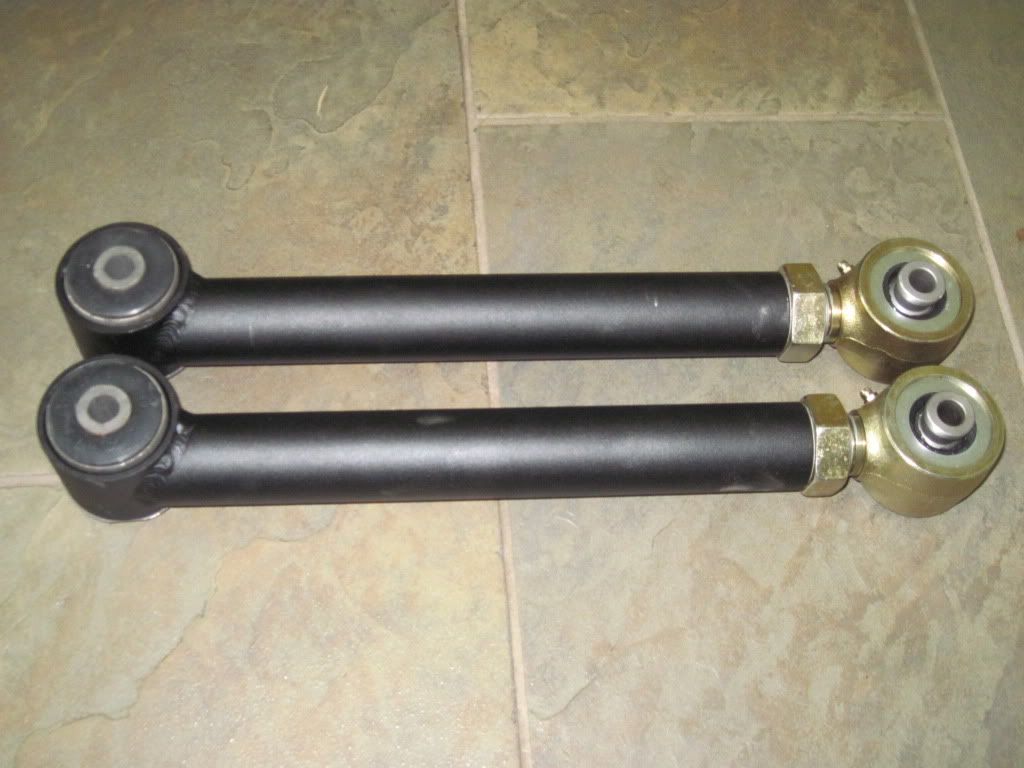

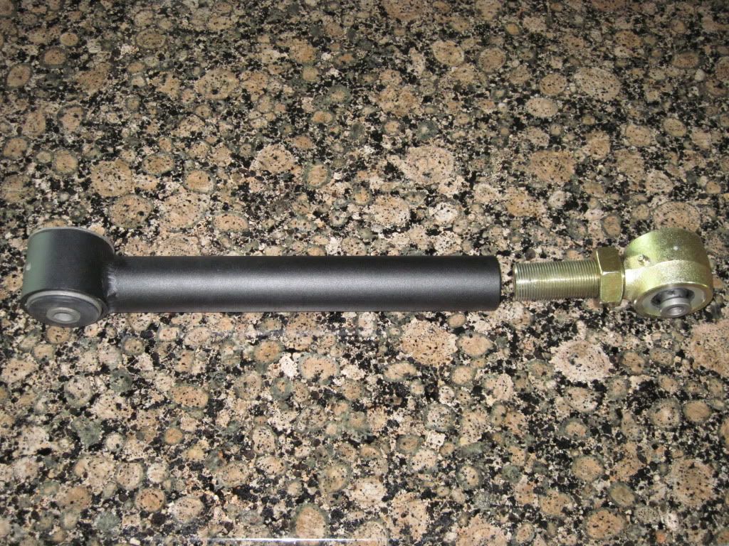

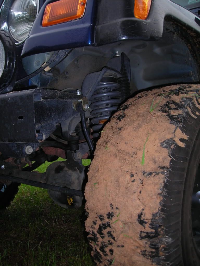

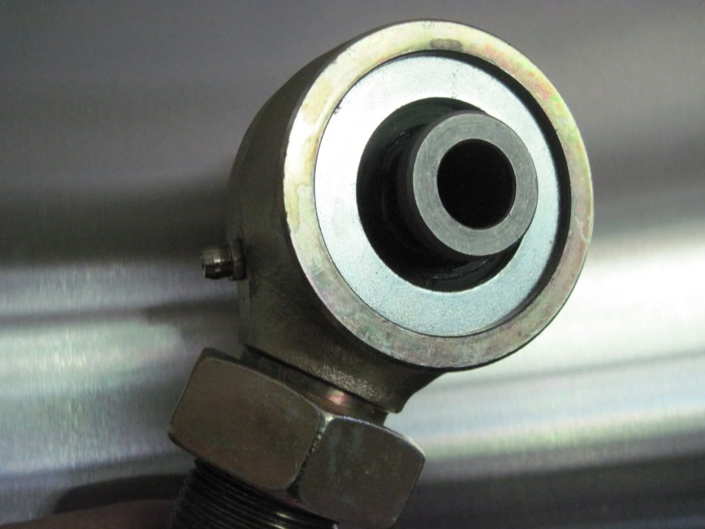

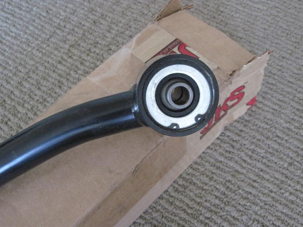

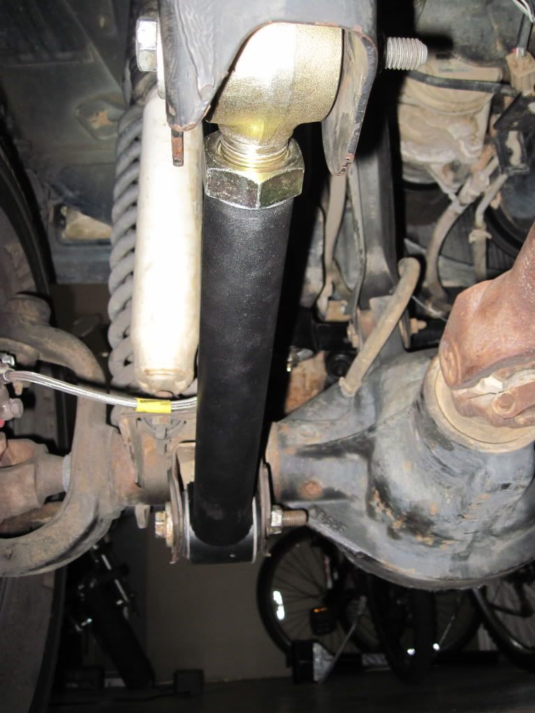

The next thing I needed was to start to work on redoing my suspension.
The problem was, being a student I didnt have alot of cash, especially all at one time. I had to start selling old hobbies, and trying to hunt down the best deals on ebay, craigslist, and jeepforum classifieds.
First thing I picked up from a local guy on Jeepforum was a set of front and rear ROKMEN lower control arms with Johhny Joints and Rubber, for $400. That saved me a bunch on the shipping.
I got so excited I went ahead and installed the front lowers myself on saturday. I just reused the old hardware at this time.
I set them right at 16" eye to eye.
out with the old procomp arms...
