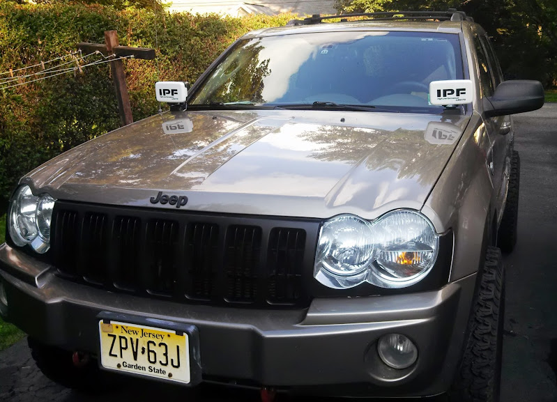

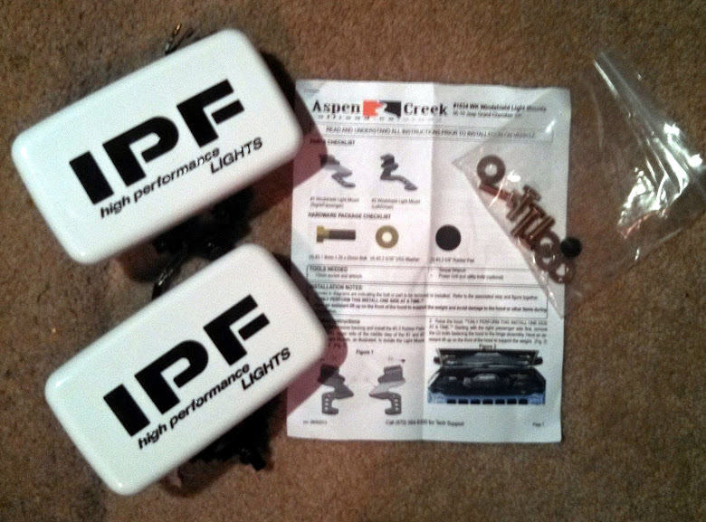

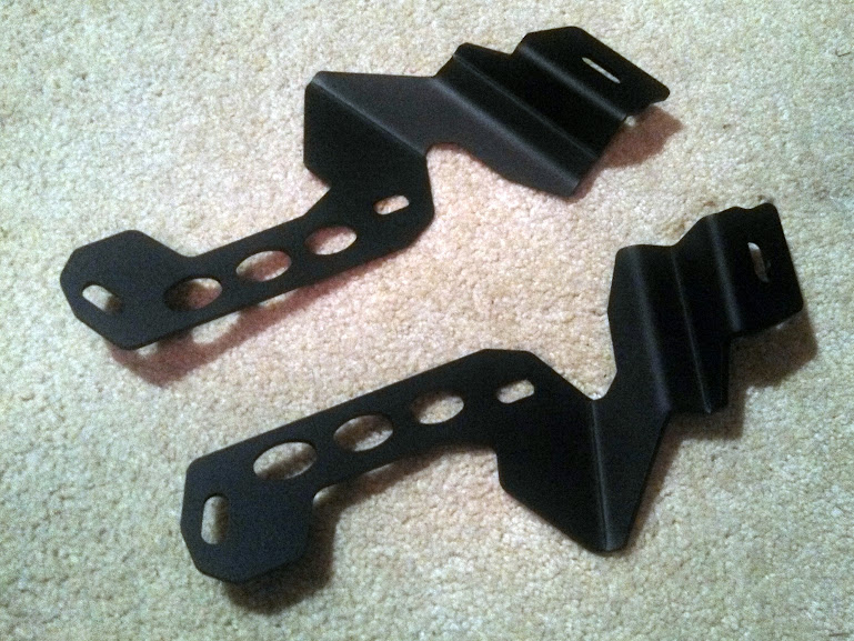

A little while ago I ordered a set of Aspen Creek windshield light mounts and used them to mount my IPF 868 Series lamps. They came out great and the quality of both products surpassed expectations.

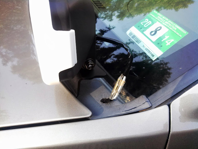

To install the light mounts, you simply unbolt the hood and rebolt it with the mounts applied and with the included longer bolts:
I drilled a small hole here to keep the wires clean and out of the way:
There is also plenty of clearance for the windshield when the hood is opened:
Here is all of the wiring done:
A piece of this plastic moulding was cut to allow the wires to travel under it:
And here is the switch for the lights:
Here are some pics of the finished outcome:
