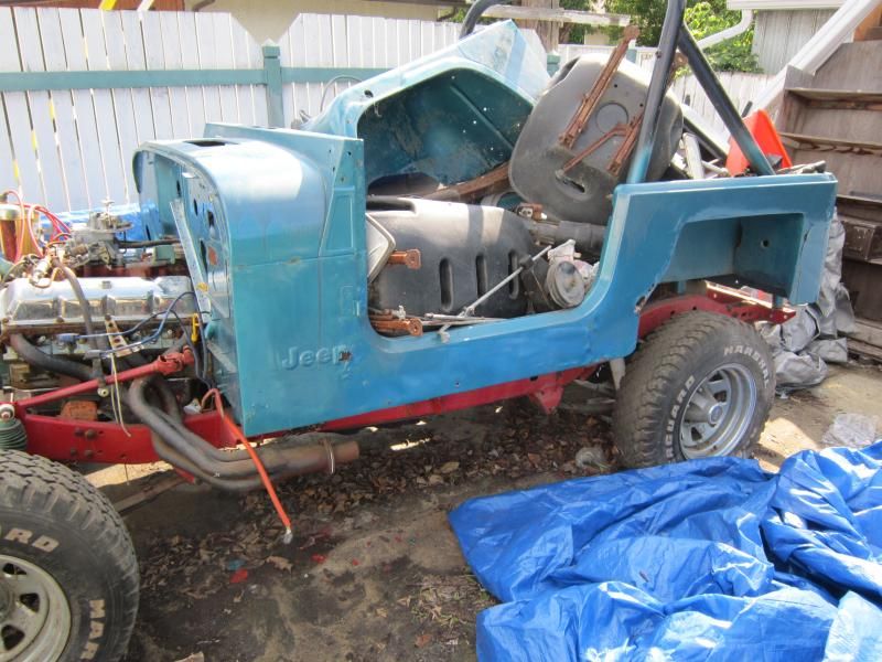

I found this little prize before it got junked. Ladies husband had expired and she wanted it out of the yard. Have already had the Block Shop do the machining and provide all rebuilding parts for the 360. My buddy and I will soon assemble the motor and the I will start on the chassis. Have a ton of replacement panels from the states and have a good Esab mig welder. Should be interesting providing I don't get divorced.

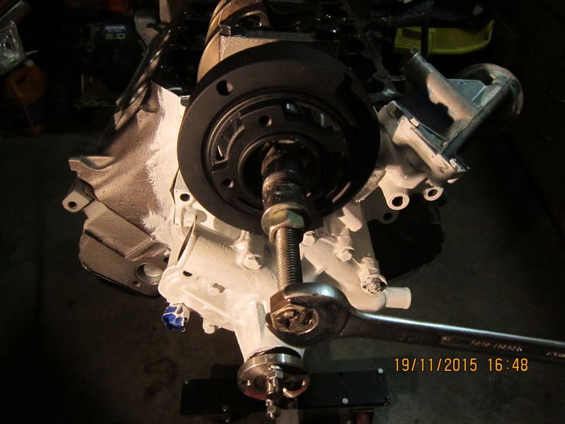

I am attempting to press on new vibration damper. Crank has heli coil in it. Have made a home fashioned pusher. I was thinking of cooling crank (dry ice) and heating damper and then go for it.
