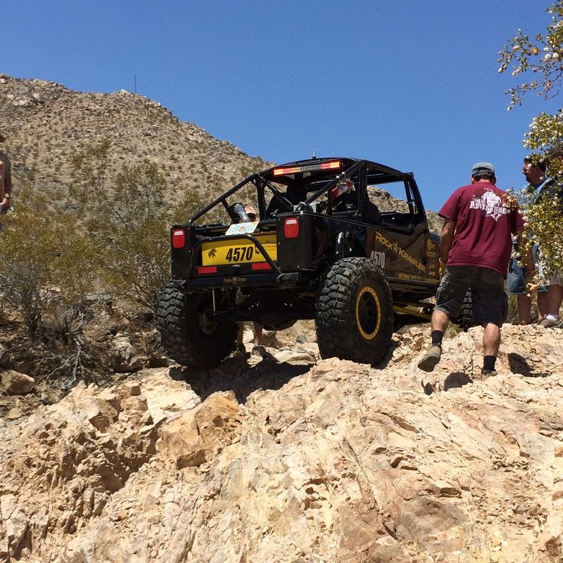

are the rear tail lights painted on? idk if you're planning to street drive this like the tj but it looks like you just have some minor mods to do . excited for this one!
They are a vinyl. Yeah some few easy mods and were back on the highways!

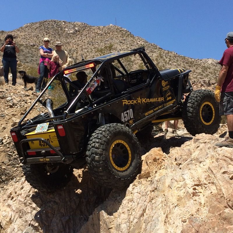

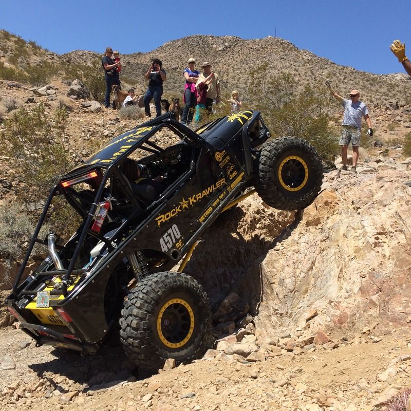

I have the bushing for the frame, just no spot to mount onto the axle. there is a lot going on down there.
I was able to take it out this weekend for HDR and see exactly what it was all about. nothing real bad went wrong with the car. temperatures ran good, motors strong, and crawled like a champ on the waterfalls.
There is a poping sound in the front end That needs assessed. I seen that the outer shafts have been contacting the housing when I previously picked it up Im assuming thats the sound when i turn left or right is that shifting the 3/8" back and forth.
The throw of the steering needs to be assessed, the turning radius is about as good as a u-turn in a school bus. The ram has more to give, in both directions, but the stops don't allow it. Just needs to be assessed. wether its another larger ram and adjusting the stops or changing the throw of the pitman arm to gain radius.
The fans were sent to "constant" not to the temp sensors. Those will be changed, and then another look at the temps while runing through the desert.
The Driver valve cover is leaking, that needs to be addressed. Pass side looks clean and no leak.
working on modeling the LJ in Solidworks to help define the suspension points, drive train, stress, full articulation, and frame constraints I am currently workin with. the rear frame does need to be renotched to allow full droop and articulation.
Drove the car without the front swaybar but didn't feel loose. wasn't doing fast tight turns either, but wasn't like driving a canoe.
The shocks need tuning. bad. bottoming out in the small sections just wasn't cutting it. the shocks and car have the potential it just needs some fine tuning and miles on the car with some seat time.
This weekend we are hoping to take it to the Hammers for a better run and see now it preforms with some minor adjustments we cna make before the weekend. also I'll be putting the 37's back on it to get a better ideal on ground clearance and "true" preruning. the 40's are great for crawling and trail rides, but i can't race on them
also forgot to say goodbye to this gem this weekend. she is now gone for good from CA and headed back to FL to her new home!

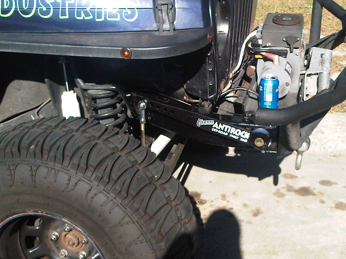

Had a few different styles of Antirocks in the Race shop at work so I figured id see what i can come up with for a fitment.
Think I Found a winner. need to mock up and articulate. And our band saw is broken FML
