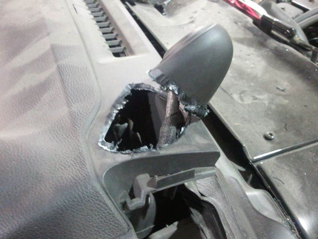

Stripped down....
Let the games begin....

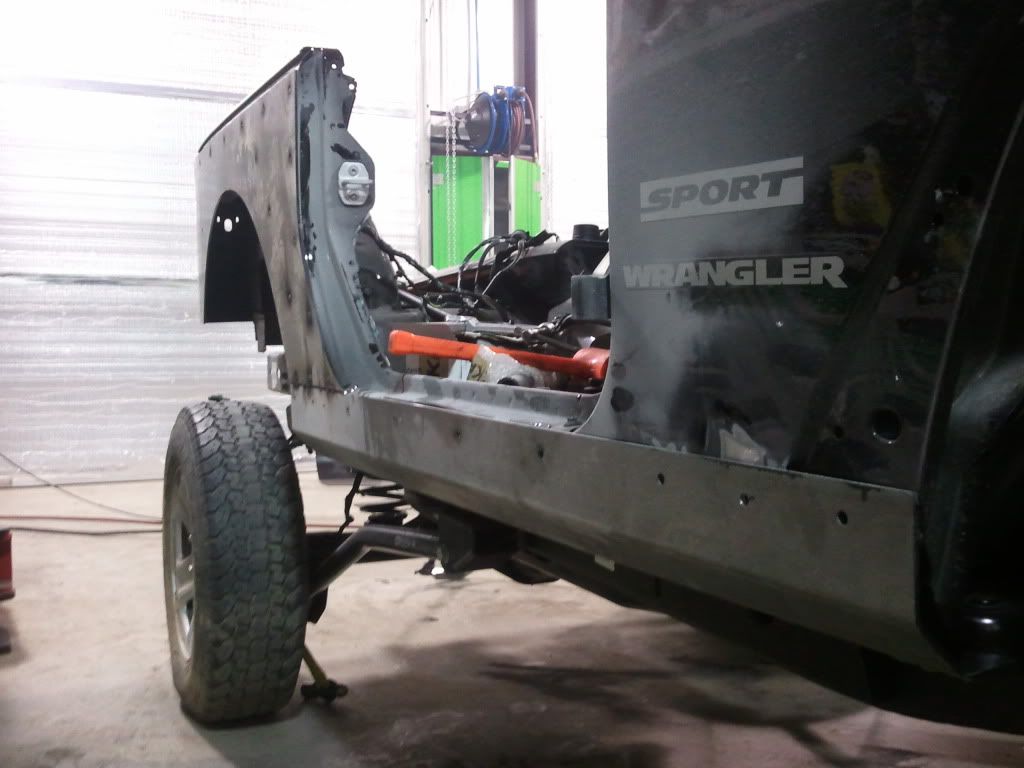

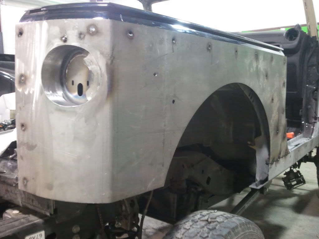

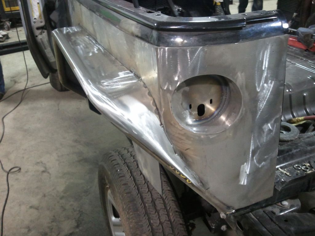

We started with a complete River Raider body armor set up welded in place...

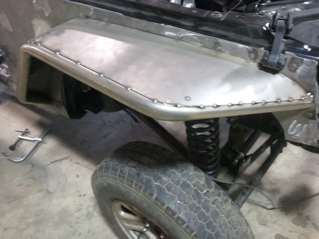

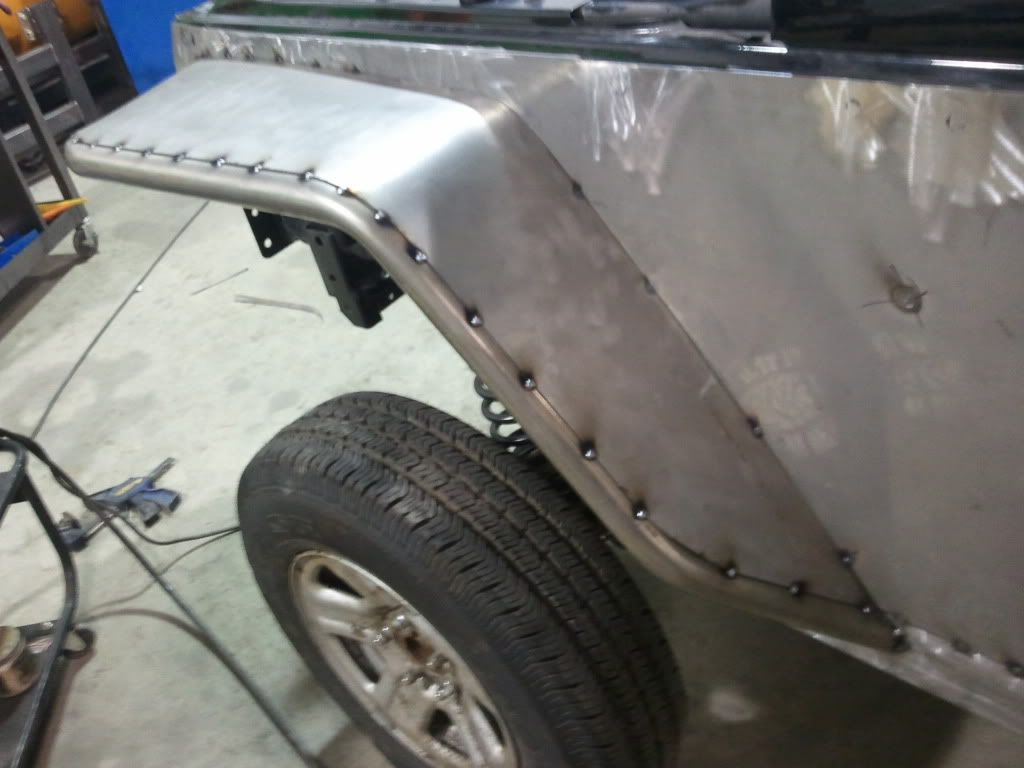

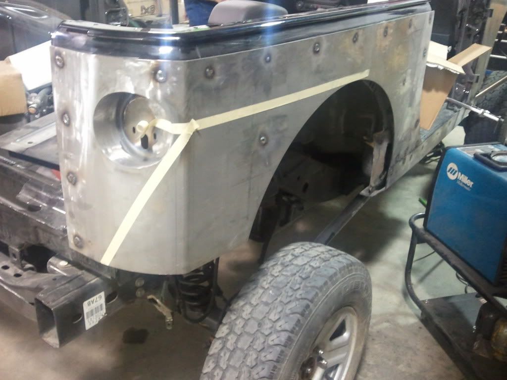

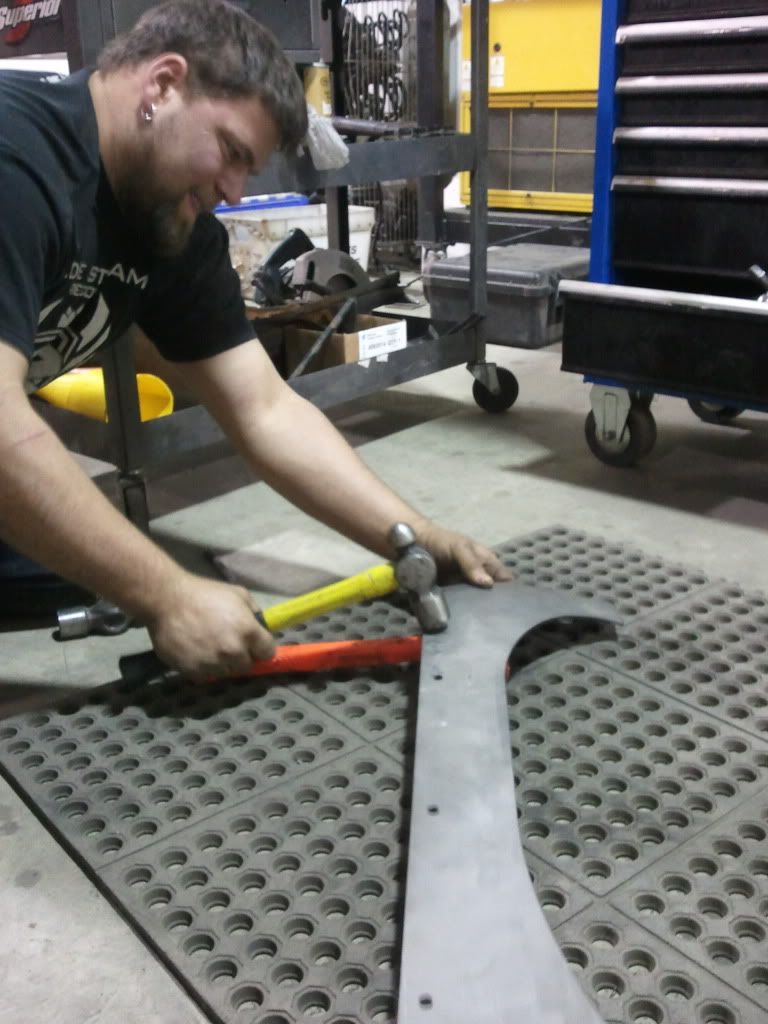

Forming the 3/16'' steel to fit the contours of the front fender....
Mocking up the front fender....

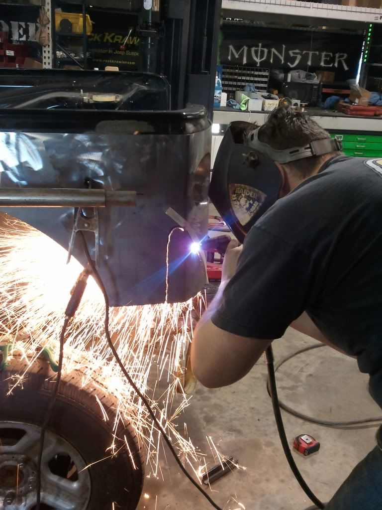

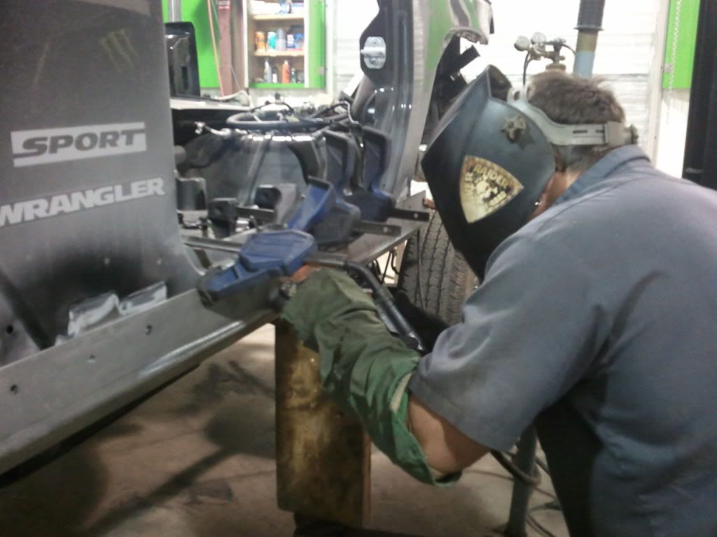

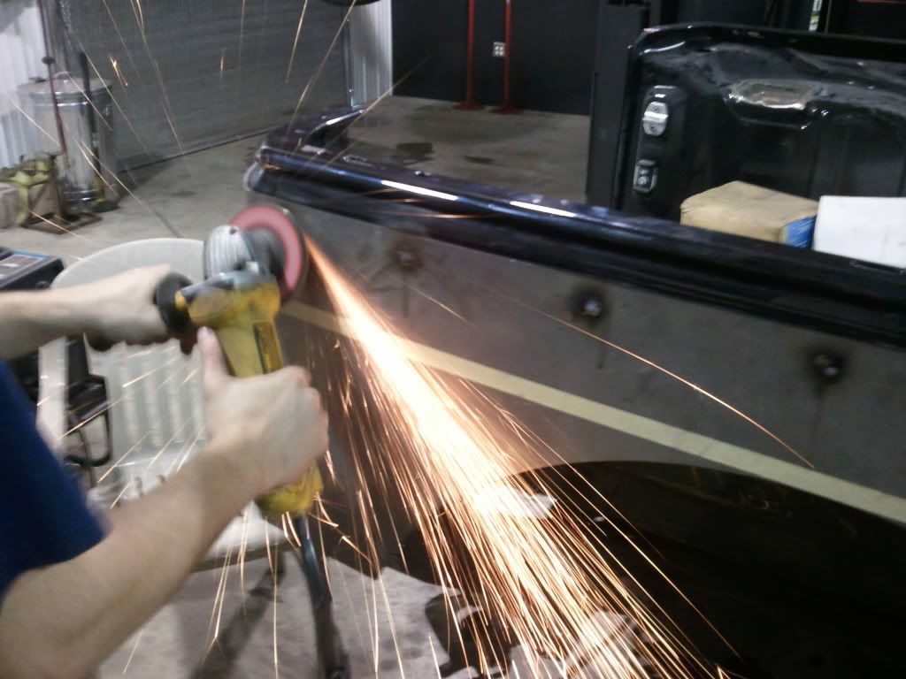

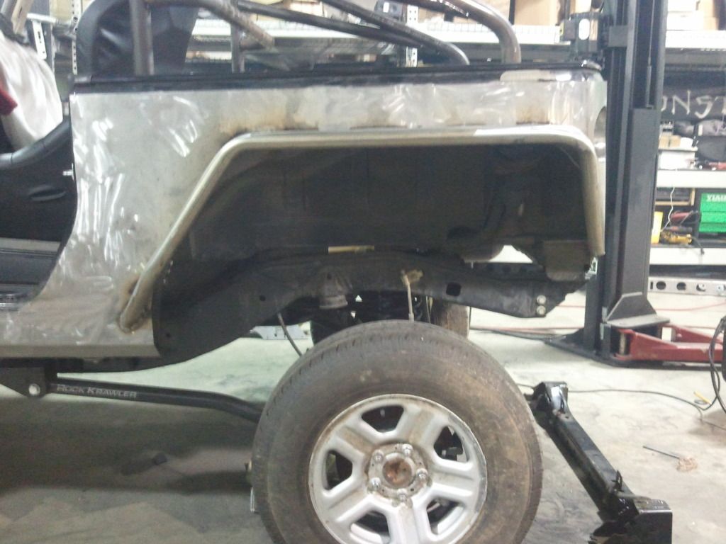

Comp cutting the River Raider rear corners to accommodate the Rock Krawler 8'' stretch system and 40'' Pit Bull Tires....

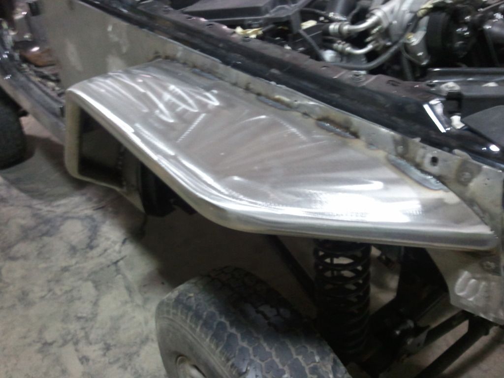

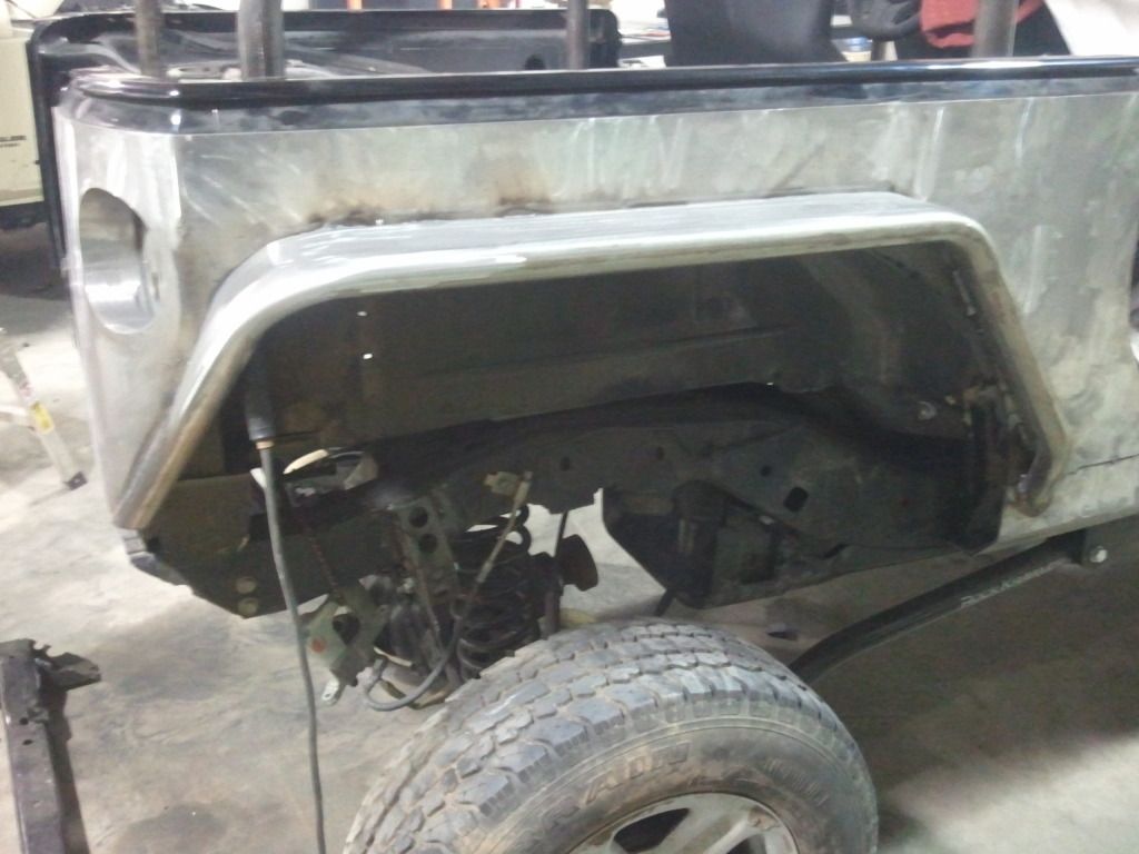

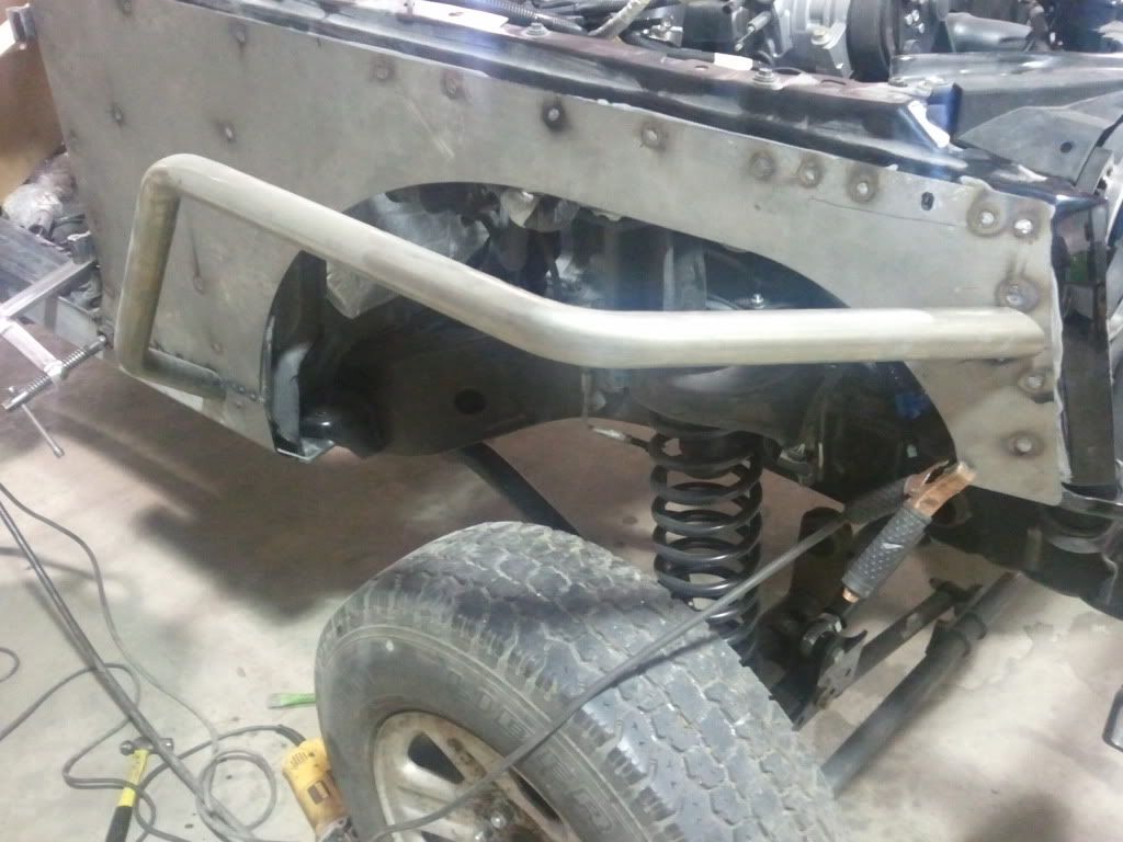

Front fenders tacked on to our full front corners that will be fully welded the entire length of the tube just like all of our JK fenders....

We finished fully welding the fenders the entire length of the tube. This is how all River Raider fenders are built....

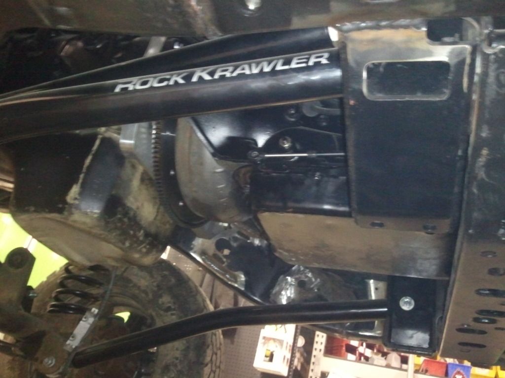

The Rock Krawler 3.5'' Long Arm 3-link Stretch System moves the rear axle back 8''. This is just the initial test fit. We will come back and show the complete suspension install in greater detail once we get the 1-ton axles under it.
The RK front lower control arm mounts fit up flush with the factory tranny cross member. This gives us the high clearance setup that we are looking for....

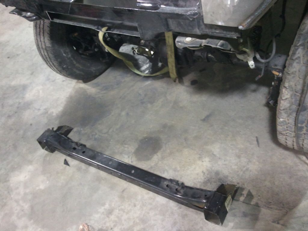

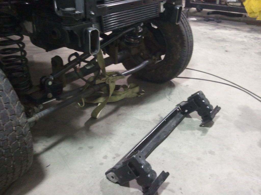

Next we cut the frame rails down front and rear to make way for our high clearance Rockster style bumpers....

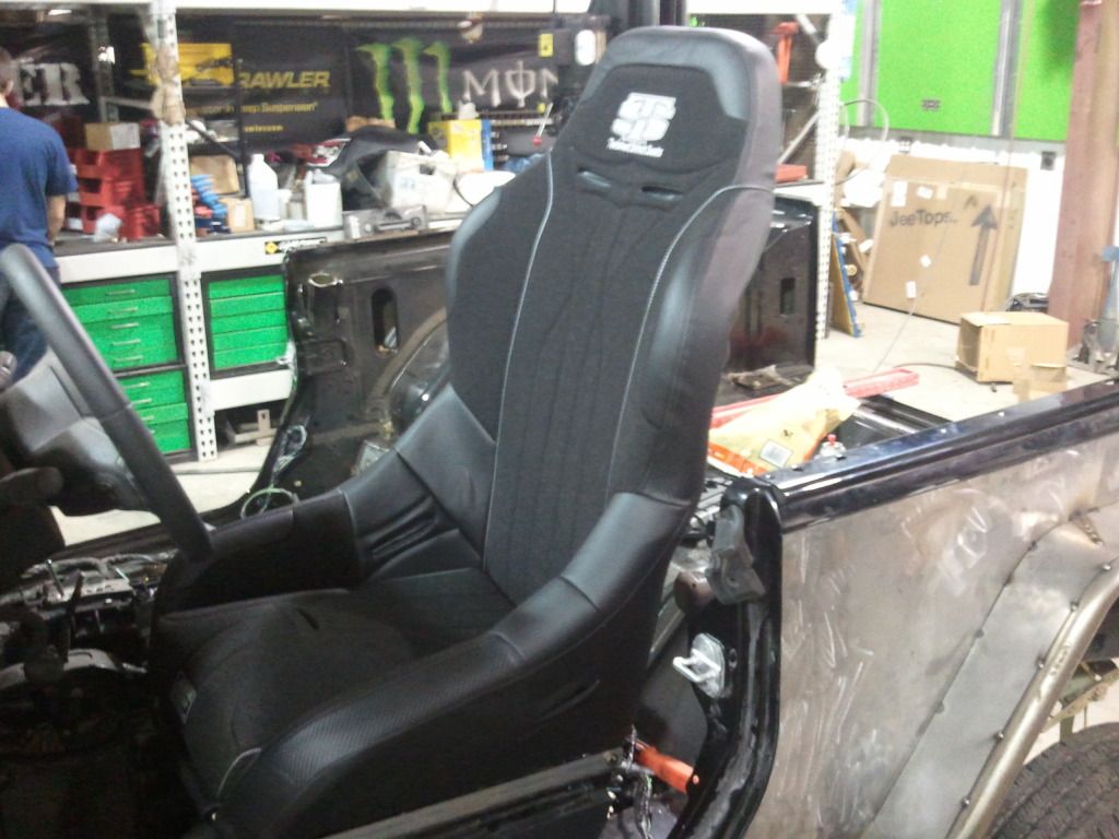

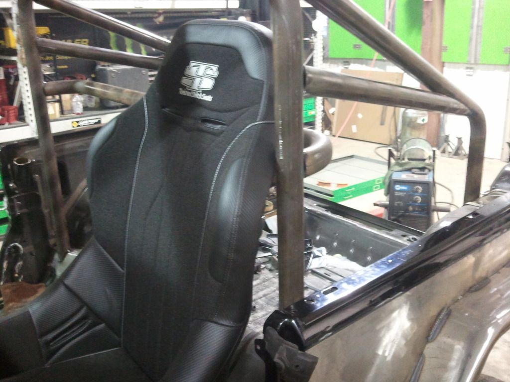

Test fitting the TS-1 seats from twisted stitch.... We have used these seats before in our Sledgehammer project and found them to work extremely well....

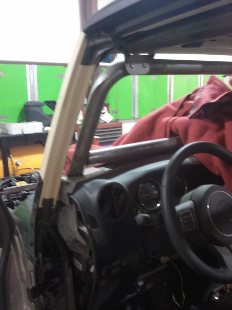

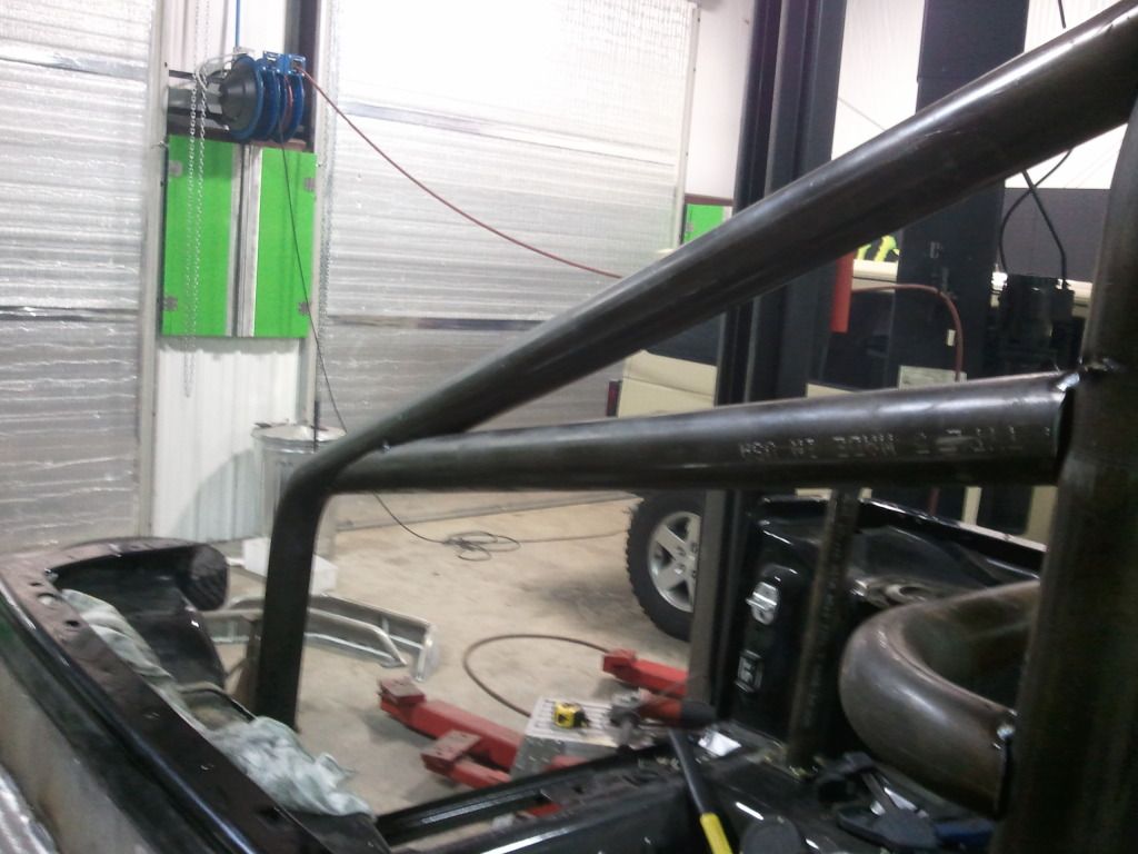

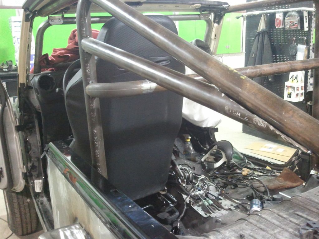

Custom cage work begins....

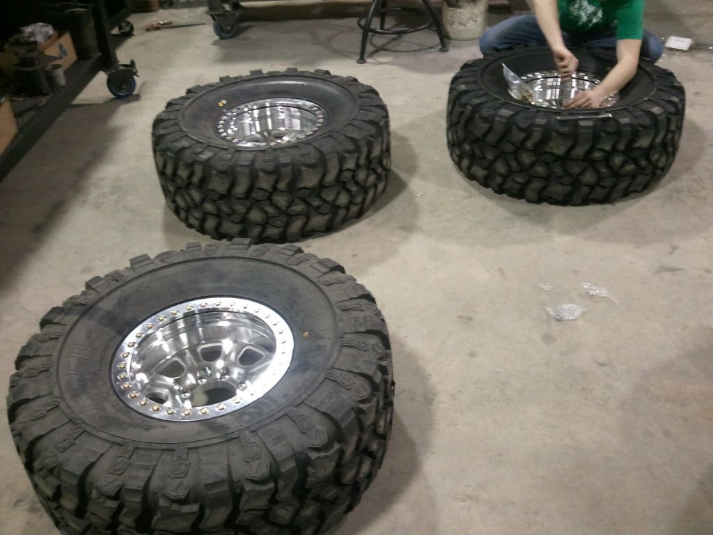

Raceline makes some of the best bead-lock wheels you can buy... So how could we resist?!
They matched up perfectly with our 39.5''x16.5'' Pit Bull Rockers
