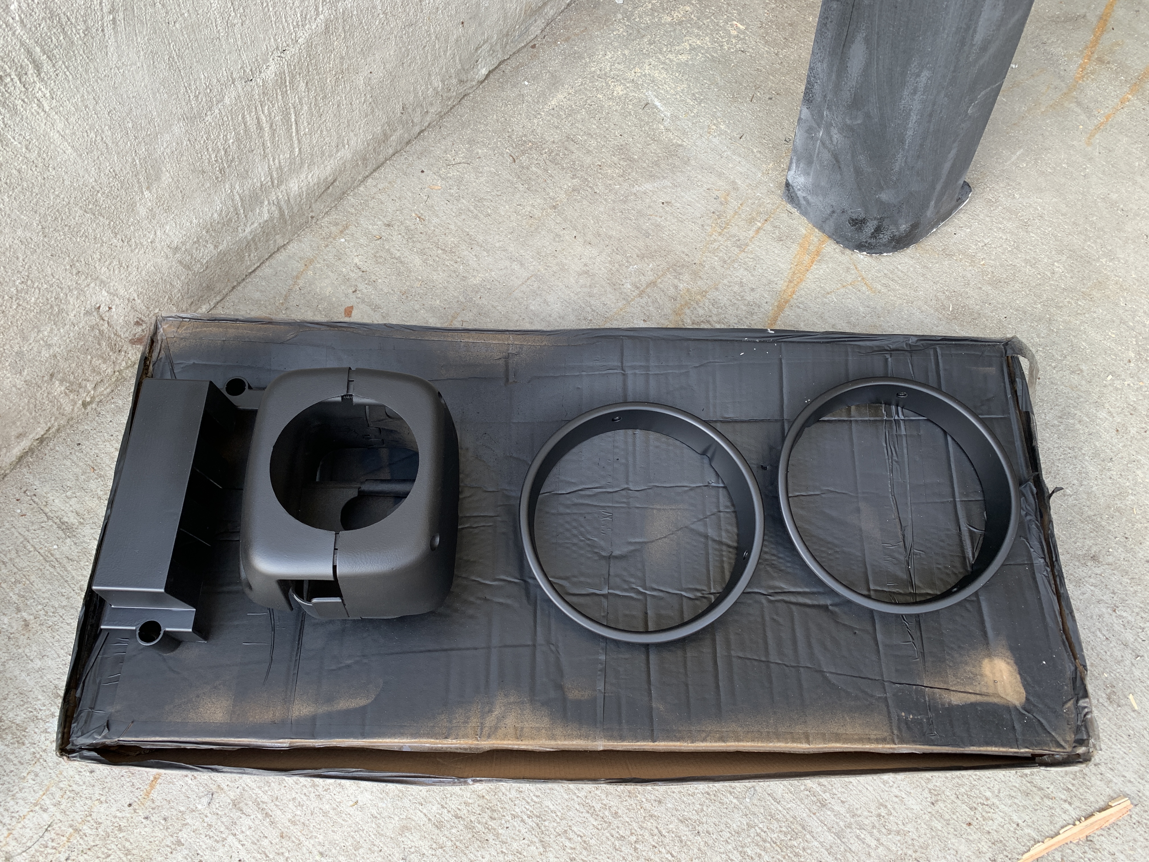

Well work is very hit and miss so I am able to get things done randomly. First off to get my motivation building was touching up some of the interior and exterior trim pieces such as seat bases, steering column cover, headlight bezels, transmission tunnel cover, and some bolt heads.. Nothing exciting but everyone loves pictures..

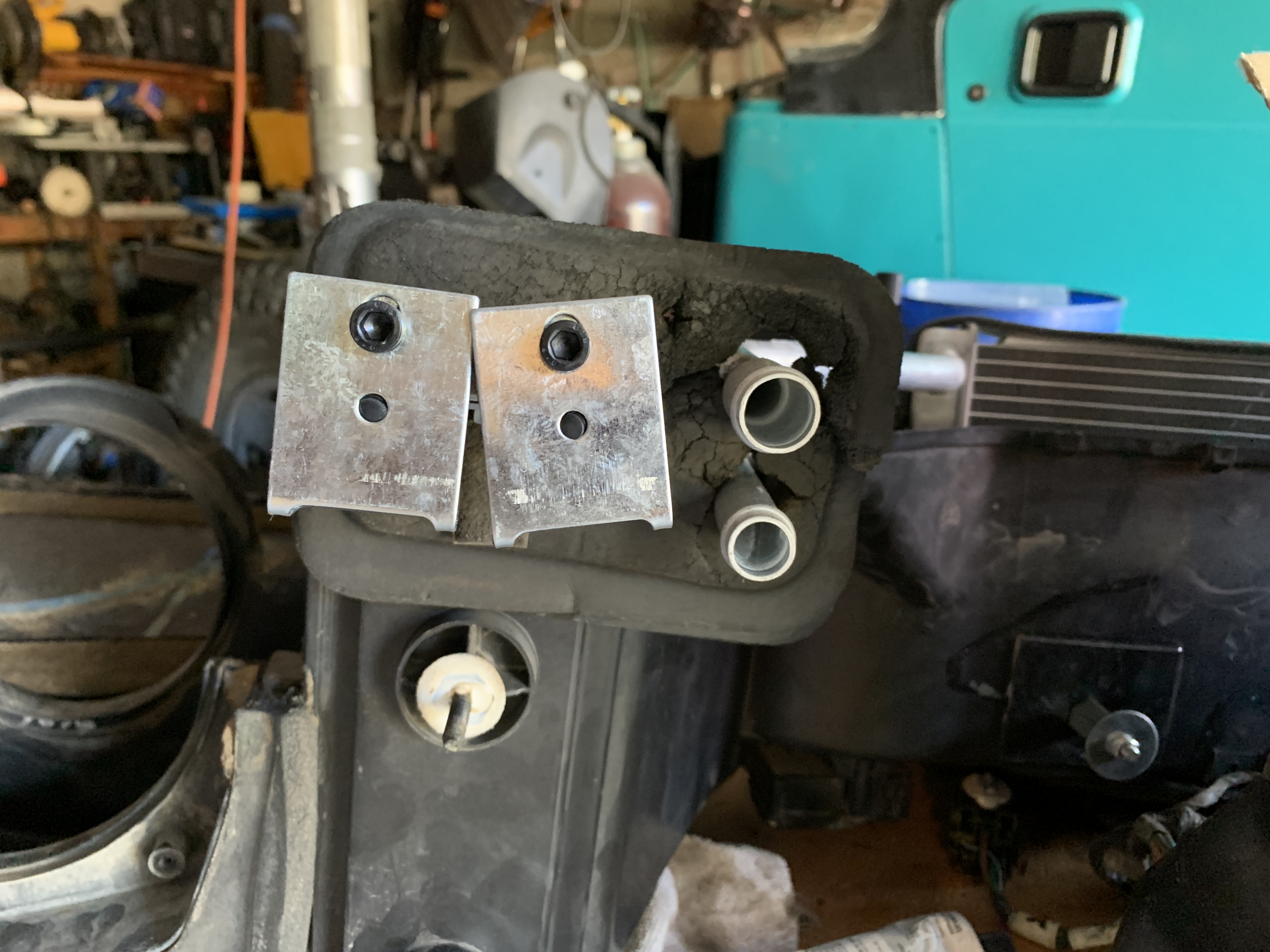

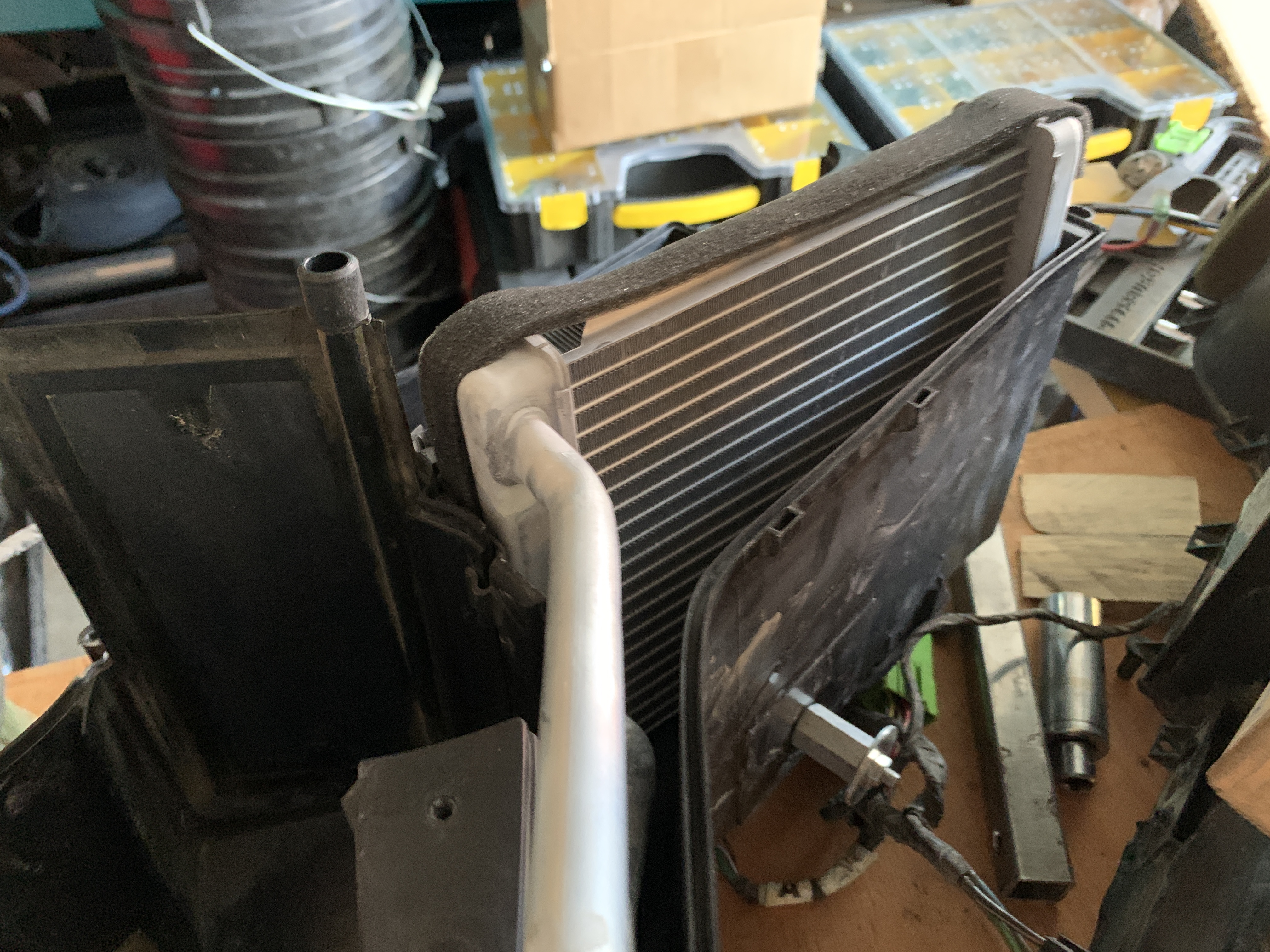

In addition to the painting, I got the HVAC box all apart and cleaned out. Jeeps really need a cabin filter.. Maybe I'll come up with one. But at the same time, it would get clogged every trip out. Hmm..
Also, I know it's not hard in a wrangler but I figured I would put some new components in there since it was out. New heater core and evap core. Less than a hundred bucks so why not?
Once the heater core was cleaned and assembled, it went into the jeep "permanently". Assuming I don't need to remove it again.. Nice.

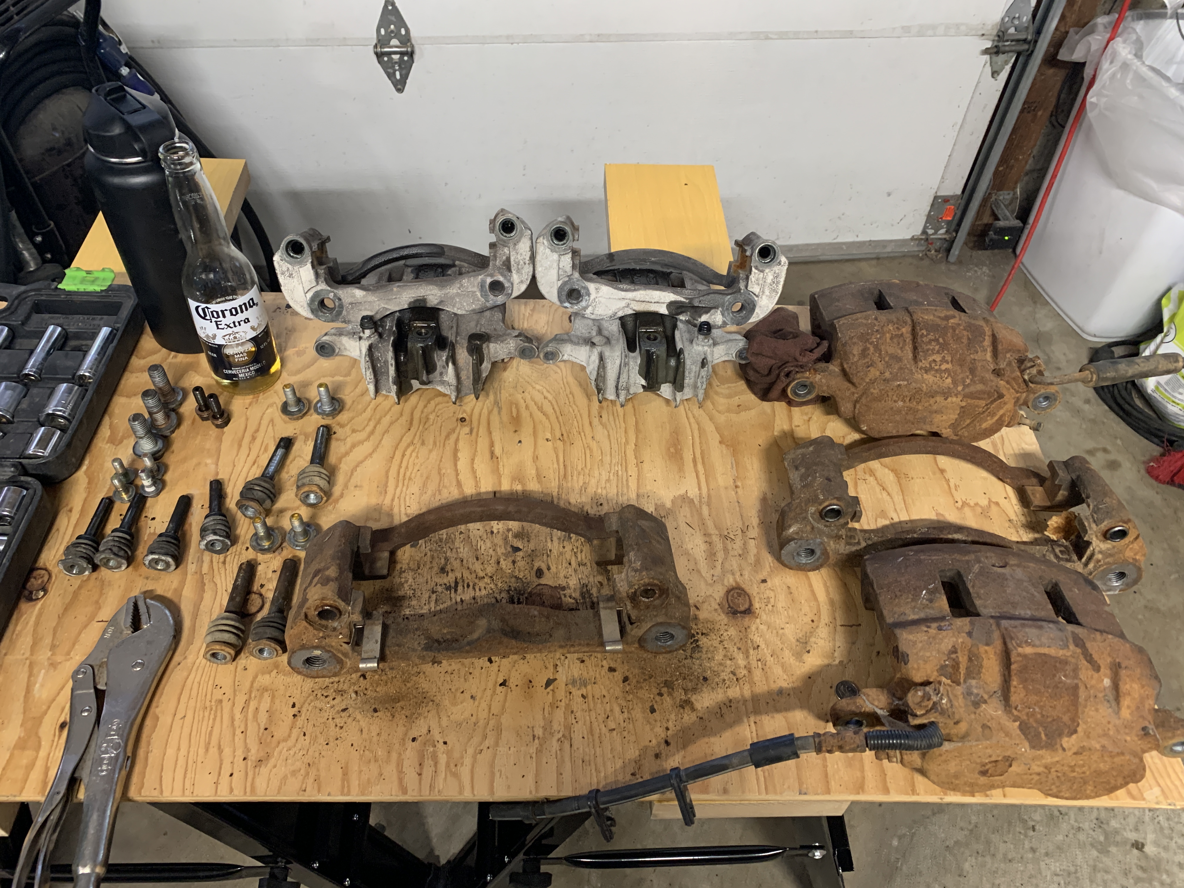

In addition to this, I started tearing apart the calipers for a full cleaning.
Got them apart and called it a night so I could finish them up the next day, but over that night I did some research. I knew I wanted powerstop slotted brakes, but I noticed they offer a full kit including their top line pads and rotors, and all 4 calipers for SD axles for around 650.. Yeah screw used calipers. I put them back together to get them ready for a core deposit. I will order brakes at a later date but nice to know that 650 will get me an entirely new braking system in regards to the axles. Gotta stop those 40's somehow...

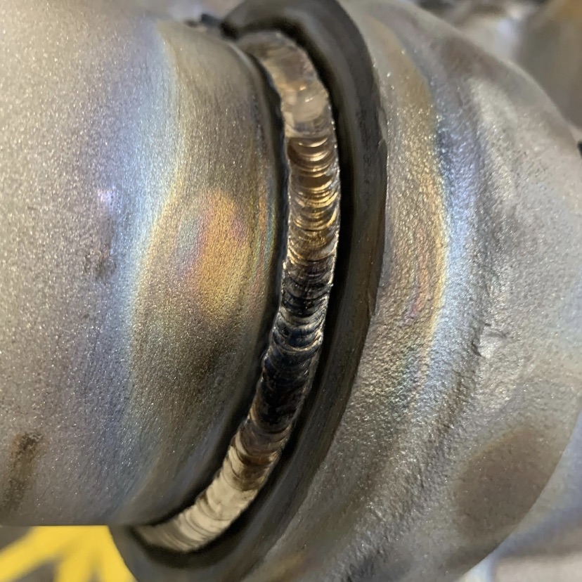

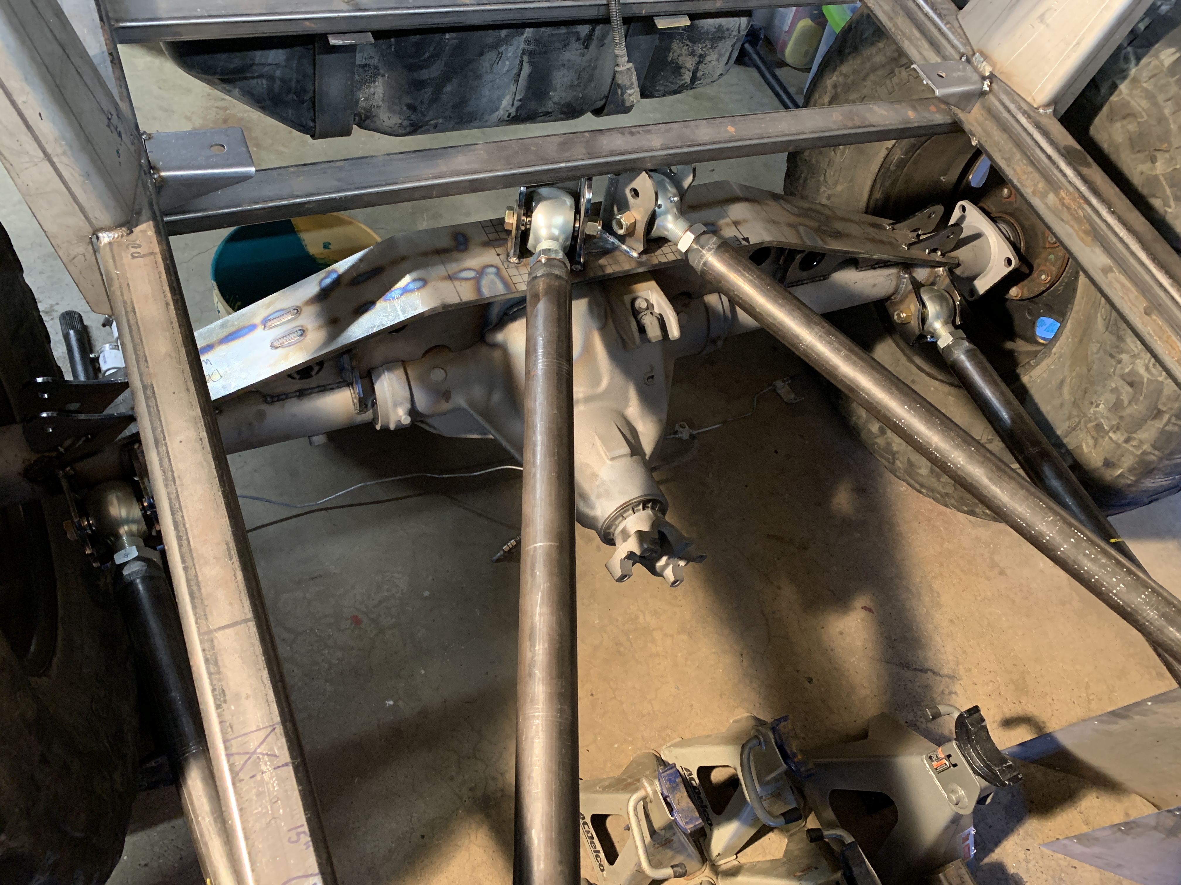

Rear axle and control arms are welded! I must say though.. I've heard all of these jokes about "when your friends a welder", but I don't see the punch line? Seems pretty alright to me?.. Enjoy some weld porn.
But seriously, this guy knows his stuff.. He works for a company that is the only company in the country certified to construct portable explosives mixing units for mining. They convert shipping containers into these labs that mix ammonium nitrate* and diesel. (*If I remember correctly). His welds can never be less than perfect or people may die. He can weld any metal at any angle. Soon he'll have his own shop and I can recommend Klunker Kustoms to anyone, but for now, I'm just lucky he's a good friend
Got it all mounted! Rear suspension is under its own weight! (minus ORI's for now)
I did not have him weld the strut mounts so I knew, in the end, They would be exactly where I wanted them to be.
And just as a fun side note, I asked my buddy to write a quick paragraph about his process with welding the truss to this axle. I will put it in when he gets back to me.
"Insert genius welders info here"
That's all the fun for now! Front axle is underway.. I picked up 6 more Summit Machine flex joints and will be making some measurements for more 2 inch DOM to pick up from Midnight 4X4. I am hoping to have this as a soft rolling frame in a month or so. This way I can put it on the alignment rack and see if my thrust angle is close or if I completely botched my bracket placement

This post will just serve as a search marker. I know a lot of people have been wondering about welding the cast on the Sterling axle. Here is what my buddy said...
"Housing section was welded with Ni-99 and everything else was welded with ER70S-6."

Those are some pretty welds. Nice work on the project.

There should have been a few more steps to welding that nodular iron center section. What was his pre-heat and cooling procedure? Other than that, it Looks great.
Oh trust me there were more steps. I haven't gotten the full process from him yet but I know for sure he pre-heated and wrapped with welding blankets afterward. As soon as he gets around to it, I will have a full detailed writeup of what he did to it.
