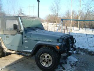

the only picture i saw before i bought it :lol:
the day i brought it home... and washed it...

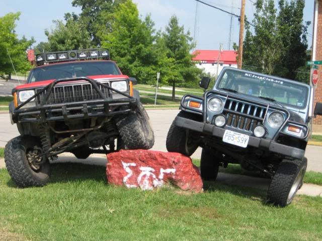

me and nick in front of our fraternity

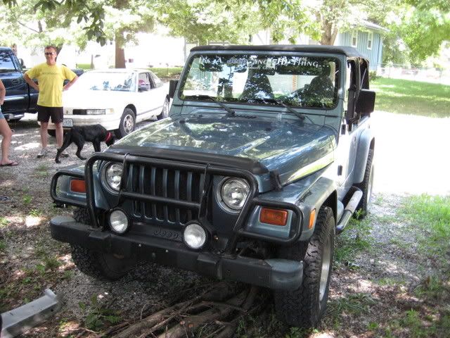

First Mod:

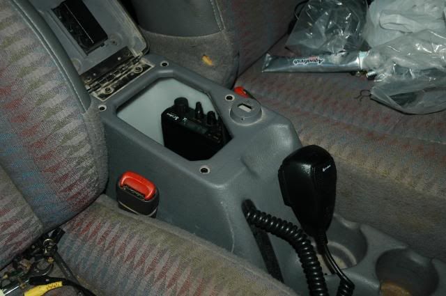

CB
Mirror relocators... gotta stay legal
Corner gaurds

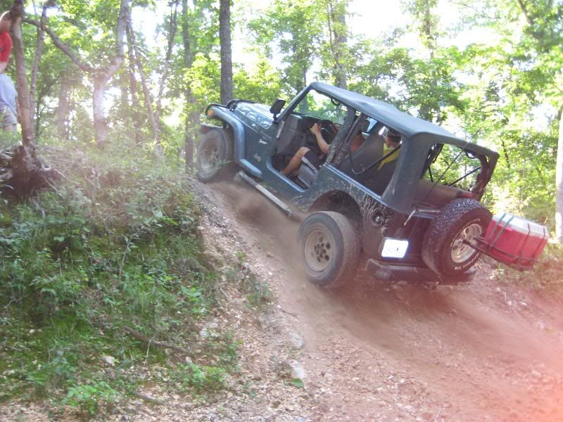

All this in prep for my first trip to Disney... within my first month... and realized it needs to be a little taller :wink:
Molli had never driven a stick :shock:
one of my favorite moments... its a little hill but half the group had to be winched up... not me i was impressed with my little TJ

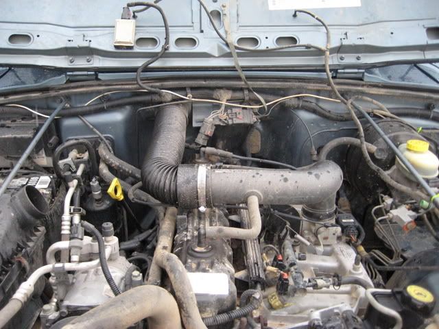

shortly after i did a stealth snorkle based on this write up on here
Tj Cowl Induction & Snorkle

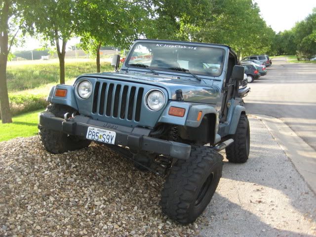

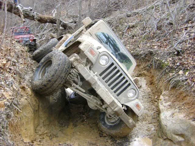

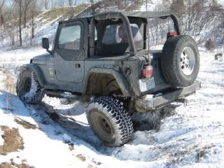

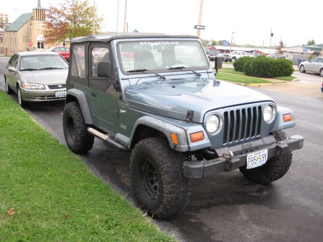

so... at some point between the snorkle ad SMORR I did a 1.25" body lift and 1" motor mount lift
here are some pics from SMORR...
V-Notch... 2nd day and 2nd time... not as successful as the first... but more successful than reed :P
and a cool flex shot from that place out on the ks side... off 435...

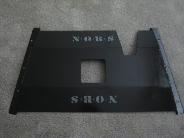

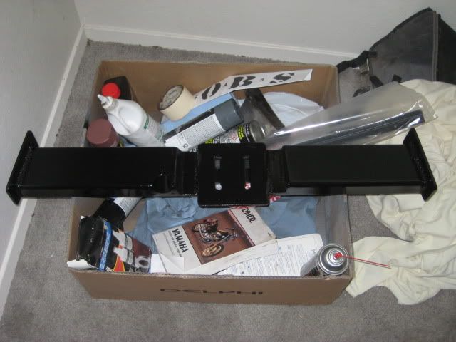

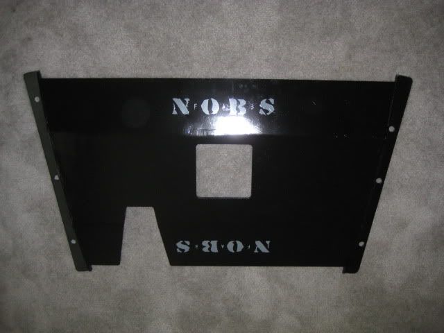

Here is the write up of my belly up in the fab section!
https://www.jeepforum.com/forum/f37/t...p-skid-776123/

pics of it painted

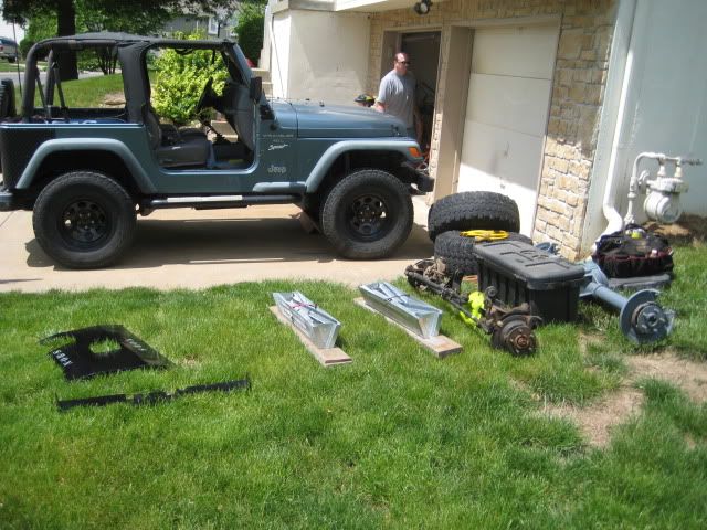

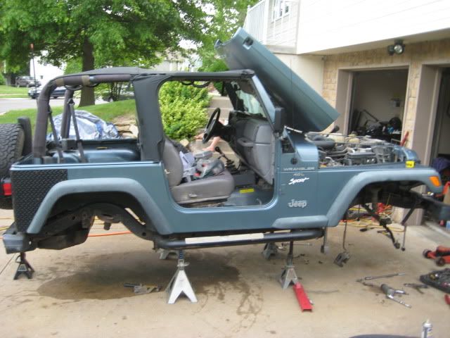

Installed over memorial day:
SYE
2lo
Belly up
HP D30 w/ Aussie
Ford 8.8
Pics:
Parts

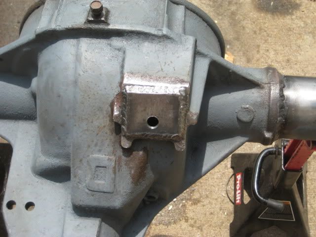

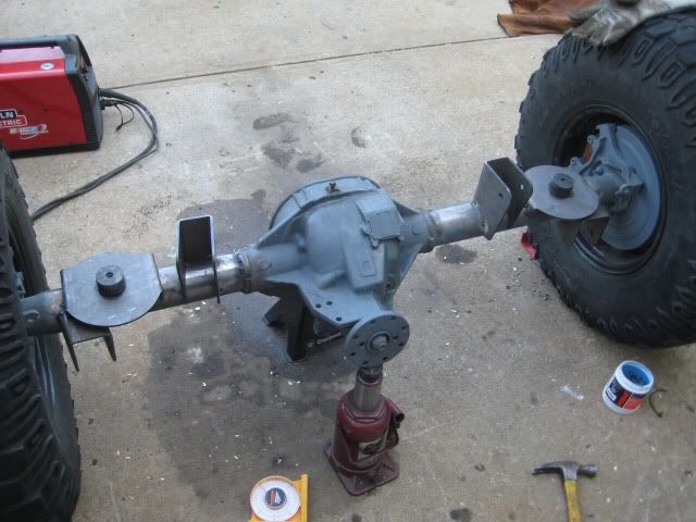

Some of the brackets tacked on... i had some issues w/ the uppers and sway bar mounts. Stu's write up says to mount the sway bars first and then mount the uppers around them but that was for the MORE kit and the madw4d brackets are different. so i measured the D35, welded the upper in the right place and then relised the swaybar mounts were cut wrong...
the one on top is the one i modified vs how they cut them...
much better

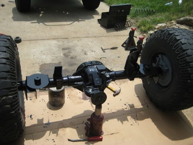

everything welded up... after a couple test fits of course
welded a plate over the abs sensor hole and tapped it for a fill plug
cgmrdc is offline
post #12 of 392 Old 10-13-2009, 11:09 AM Thread Starter
cgmrdc
cgmrdc's Avatar
1988 MJ Comanche
Location: Denton
Posts: 894

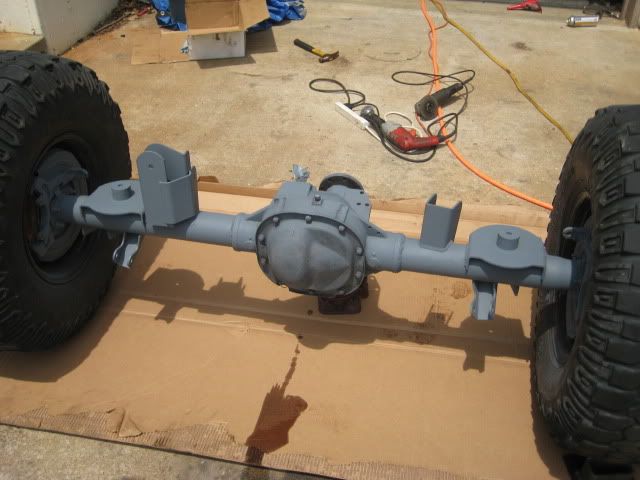

Primed
and painted 8)

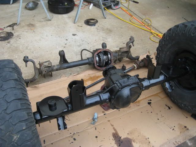

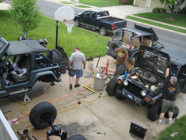

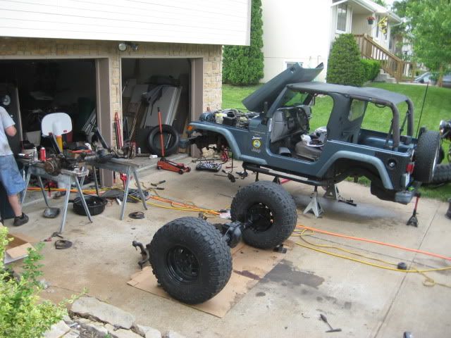

Pulled the front axel and started swapping the shafts and knuckles
The kids together for the first time
floatin Jeep

Kevin and Reed came over and did some of their own swappin... the looks from passer-bys never get old...

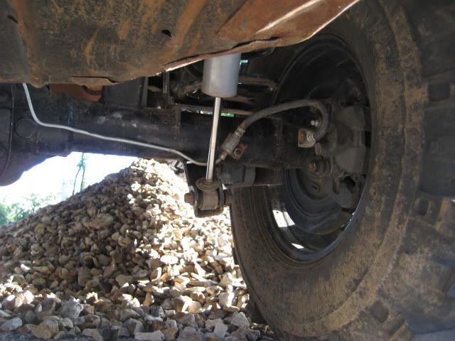

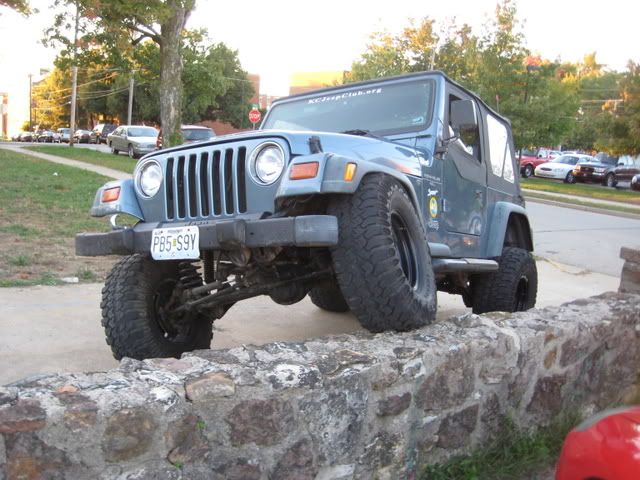

since i didnt get pic of my rti i thought id post some flex shots w/ the tsl's
at full bump my shock its the brake line... but after some trail adjustments (flexing) its now out of the way. I plan on outboarding my shocks soon so ill prob just leave it till then
