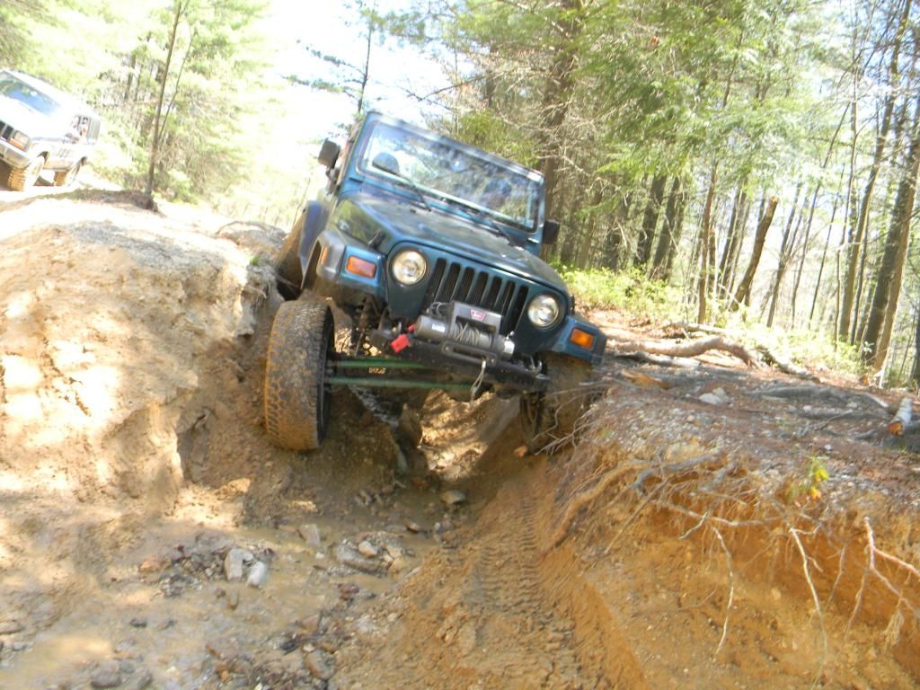

did some of this kinda stuff yesterday.
which resulted in this.
but I had a spare so I replaced it on the trail and drove home.
Ben is offline

Thanks.
The control arms are working great, no issues from the home built driveshaft, and at 70mph on the highway it tracks great for a TJ with no rear sway bar and no steering stabalizer.
Overall I'm pretty content, just gotta hoss up the driveline a bit. A rear bumper would be nice too...
I do have an issue with the track bar, it's just too tight to the spring on the front right corner. The coil bucket allows the spring a little bit of movement, and in the just right situation, the coil will hit the track bar. Also, the heims are noisy as hell, squeaking everywhere I go. I'm going to change out the 7/8" heim (2" mounting width with misalignment) to a 2" narrown johnny joint (1.6" mounting width) at each end. I'll have to get new burn in bungs since the threads are different, so I just got a whole other piece of DOM and I'm just going to remake the whole TB. That way I have a spare too. Of all the things I re-did under this thing over the winter though, having to remake the front track bar ain't the end of the world.

Yea, the ear ripped off. I didn't even really feel it when it happened, but I stopped to wait for a friend to come through the same section, and I cut the wheel hard to roll back sidways on the trail out of the center of it, and heard the clunk clunk clunk.
The 760x joint wasn't broke, but 2 caps were missing.
The lower ball joint moved about 1/8", but I had a press with me so I slid it right back up.
Luckily a friend had a long side shaft with a joint already in it and it only took an hour or so to switch it out.
The 12pt 13mm bolts got a little tore up, gonna need new ones of those.
