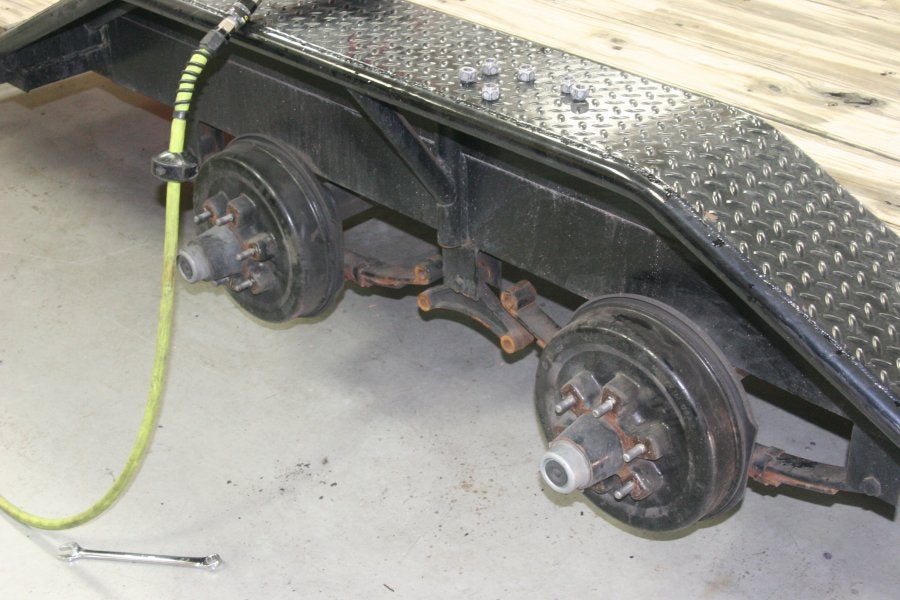

After the failure of those three shackles on the trailer on the way back from Moab, I thought it best to replace all of them with a heavier version.
First up, pulled off the sissy shackles:
The original shackles were made from 3/16" x 1.25" steel. To make the replacements I used 1/4" x 1.5" steel.
After cutting eight sections to length on the dry cut saw, I drilled 16 pilot holes, and then 16 9/16" holes on the drill press.
Then a little round over work with the flap disk. I deliberately left more meat around each of the holes as that is where the other shackles failed.
A quick paint job...
And reinstalled.
Overall, between the axle failure and the two flats, I'm not happy with how the trailer did on this trip. It's a custom 10,000 pound Kaufman, and this was the fourth time I've made the trip to Moab with no previous problems. Between the rig and the trailer tool box with about half a ton of of spare parts, CO2 tanks, fluids, straps, and the like, I think I may be pushing these 5200 pound axles a bit too close to the capacity limit. I'm giving some thought to going with a larger, 8 lug axle which would also allow me to run higher load rated tires. Or, I could just trade up to a 14,000 pound trailer. Just thinking at this point...

Even though I replaced the shackles on the trailer, when I pulled it all apart I discovered that most of the bushings were shot - all worn though on one side. So, I went ahead and ordered a Dexter heavy duty suspension kit. Much beefier 3/8" shackles, and bronze bushings. All the bolts are greaseable as well. I'm doing a short wheelin' trip down to AOP with Chris and John next weekend, so I'll get this done this week.
