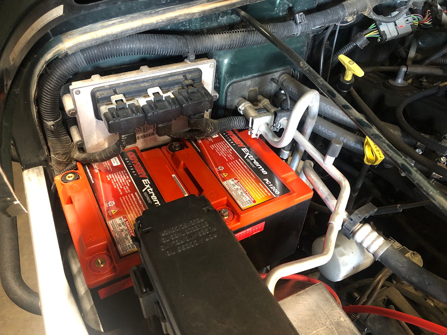

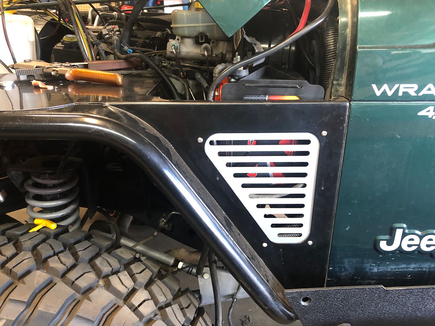

The battery tray in the rig was designed to hold an Optima - snug. The Odyssey 34 is a bit larger than the Optima (and much heavier, as I recall), and out of the box it does not fit down into the tray. The base of the battery fits into the tray, but about half way up there are fins that increase the width. To get the Diehard to fit, you can see here where I had to trim those fins.
With a chisel and a hammer, I made quick work of the modification to the Odyssey.
And after the cut:

And then it was a simple trip into the Jeep. So, I guess that I did get a Red-Top after all...
