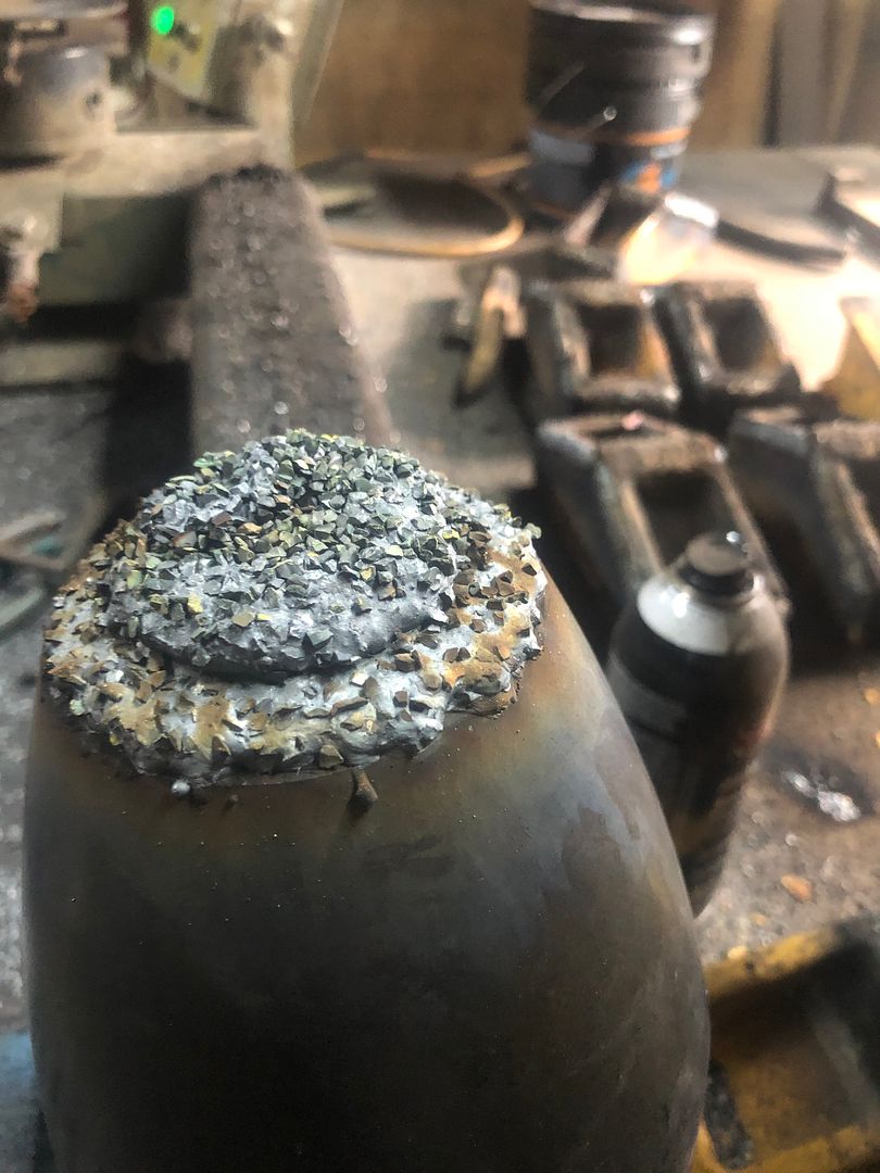

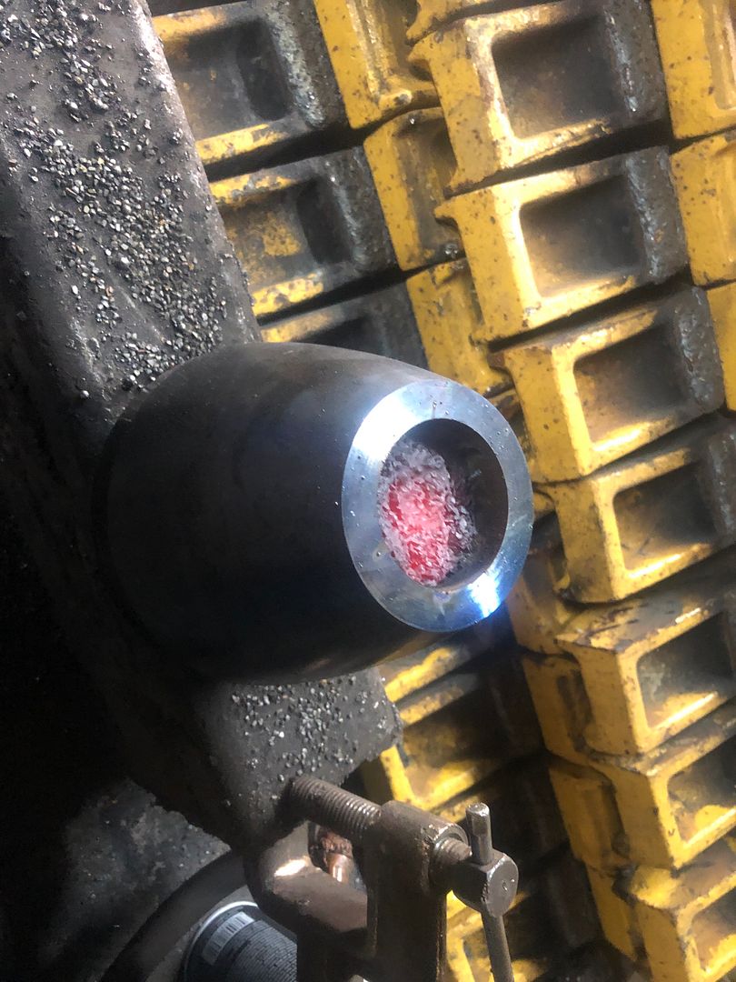

Very clever! If your going to do much rotary work, try a tweco roto ground, you can see one in the bottom right of first pic:
The piece shown was done on a weld head positioner (rotary) by me on Wednesday. The second pic shows the final "icing", positioner jaw chuck can be seen in back of pic
These little doo dads are cool, switch is in base and comes with a adjustable torch holder:
https://www.ebay.com/itm/Bug-O-Conta...4AAOSw2yNbSM1w
The ideal torch holder for manual operation is a rack and rail, but I have been using underwater flash/strobe arms that use the 1" ball for manual positioning of torch, rigid enough to be still but also smooth enough to be moved at will
