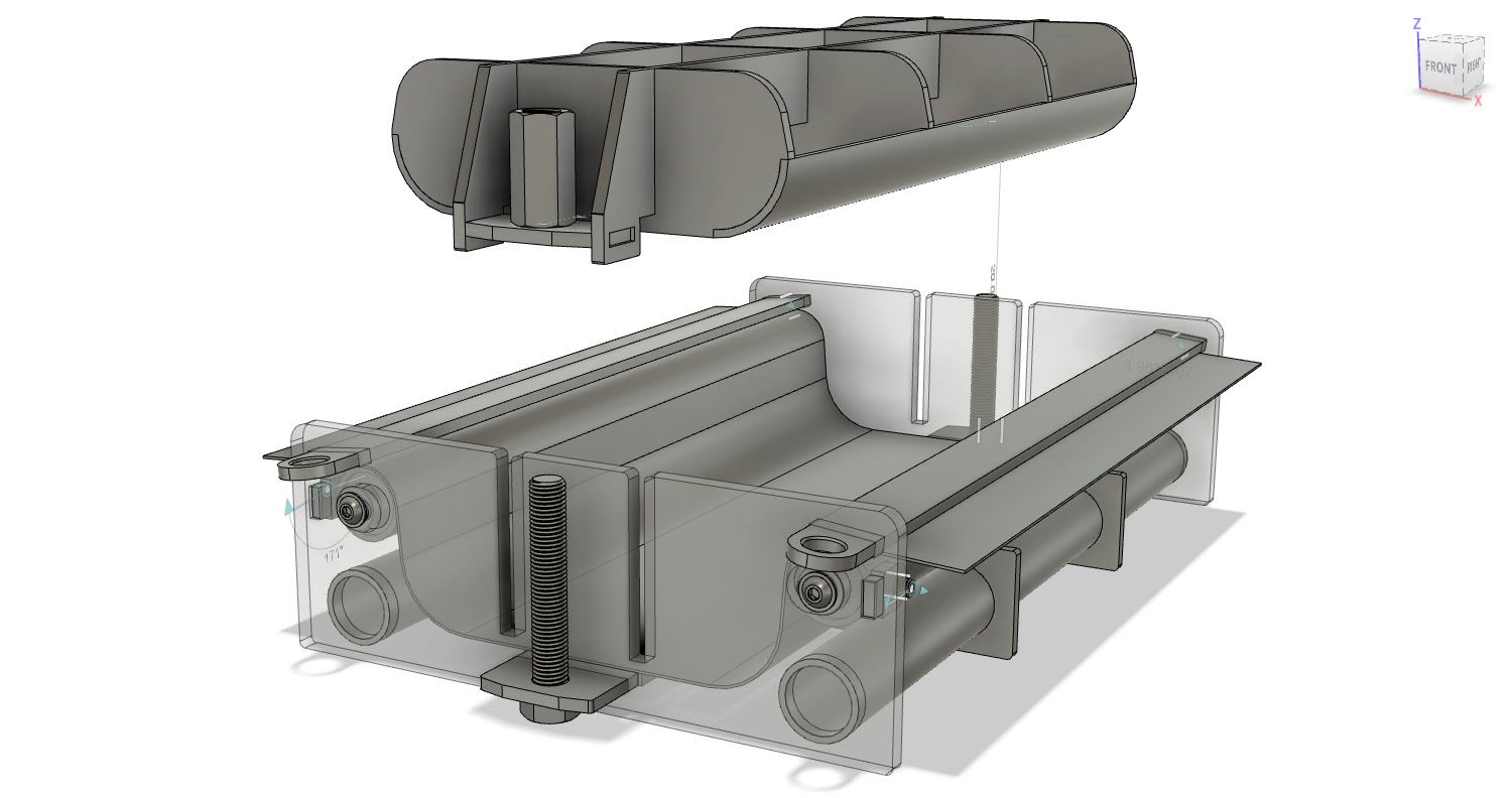

I'm back in the throws of another transmission tunnel binge.
I've decided to retired my O.G. lo-tech wooden tunnel press. It served me well and helped bang out a few dozen tunnel orders, and would probably hold for a few dozen more. However I wanted to build something a bit more sophisticated. Something a bit less labor intensive. The first press required 2 hands, two feet, a bottle jack, and the weight of a Jeep. The new design should only require a few zips of an impact wrench. I went through several drafts and stages with it and I'm happy to say it's finally done. I should have all the parts back from the machine shop in a week or so. I'm really looking forward to final assembly. I've been brushing up on my welding skills in anticipation. I've decided that this will be my first project welded entirely by me.
VIDEO OF THE PRESSING PROCESS
https://photos.app.goo.gl/imebymzq6AzRH7LX8
Study model:
The new design will incorporate roller bearings to reduce surface friction between the tubes and the sheet metal. They should also help reduce overall stress on the base of the press. (in theory anyway...) The tubing is also beefier on this one with a 3mm wall. I got all nostalgic walking around in the locale skateboard shop. I actually considered buying one to play around with my daughter. They actually had a reproduction Rob Roskopp deck hanging on the wall behind the register (you'll understand if you skated back in the 80s)
Sorry if the photos are giant. I use to be able to resize them to something more reasonable in the script of the links but that doesn't seem to work anymore. Hence the issues with my previous post.
