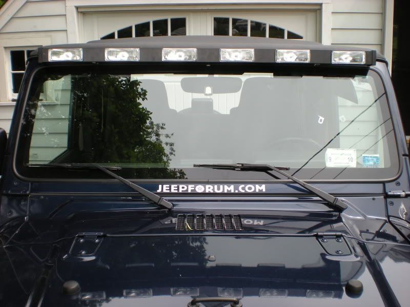

Originally Posted by Tyler_C_Perry View Post
Love the light bar!
I'm definitely gonna try and do the same thing, but mounted at the top of the windshield
Thanks for the compliment man!!
You might want to do a search for a user by the name of minges14... he built a windshield version of what I build for his TJ using the same lighting and same hardware equipment. I had mentioned his build earlier on page 4 or 5 of this one as the inspiration for my idea. I couldn't find his exact thread for you, but I know it's on here somewhere. Use keywords like his name, the phrase "northern tool lights" and "light bar" and I'm sure you'll find it in no time!
Here's a pic of what he did:
