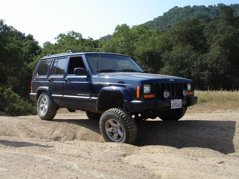

I have a build thread in the xj section, but it's alot of fluff, heres a concentrated over view.
2001 Jeep Cherokee Sport, born August 2000.
-Bought October 11th, 2007, with 124xxx miles. STOCK.
-It now has----
-4 inch RE lift, RE rear shackles
-Rough Country Long arms.
-OME shocks, steering stabilizer
-SYE -PORC
-High Pinion D30 disconnect axle, converted to single shaft, 4.56 gears, Lock rite, Gofer it flip, solid cover, lca skids.
-Chrysler 8.25, 4.56 gears, Aussie locker, zj disks, ruff stuff cover.
-255/85/16 KM2's on Rubicon MOABS
-Aj's sliders
-HD offroad frame stiffeners
-Rigidco FBG front bumper
-Custom winch mount, smittybilt xrc8
-C4x4 tire carrier bumper, with cb mount, hilift mount.
-Rear hitch
-Cb,Sony deck, Polk Speakers, PA.
- Autopal h4 housings.
-Dom Tie rod.
-Oem gas tank skid
-Iron Rock Offroad Xj cat back exhaust system
-Husky Mats
-Napier Precision products flares
-As it sits Feb 2013
-As it sits on August 09
Stocker. -October 07
New tires, used off of a member. And new Kc slimlights
Budget Boosted, and didn't ride all that great.

A little wheelin
New switches, top is for the kc's, bottom, for the electric fan. GREAT for traffic.
Free hitch, and junk yard tank skid.
Painted front skid, design courtesy of Mortalenema
2004 Grand Cherokee Overland Project
2019 Compass Trailhawk DD
srmitchell is offline
post #3 of 1191 Old 01-10-2009, 11:48 AM Thread Starter
srmitchell
Location: Humboldt County, CA
Posts: 3,508
Bedlined sides
I used duplicolor spray on, found at kragen, or pepboys.
I removed the trim, sanded and sprayed.
Aj's Sliders
Clevis, and finally a member.
And finally, a real lift.

Fresh Rubicon Express 3.5 inch Super flex kit, with ome's, and Treadwright At's, 31 inch. Along with cragar d windows.

So I wheeled it!
And took it to Yosemite.
Next to our 08 Liberty
Autopal lights
post #7 of 1191 Old 01-10-2009, 11:59 AM Thread Starter
srmitchell
Posts: 3,508
Last post for now, trip to Hollister, it performed flawlessly, but I had to trim the flares after, they got ripped off. Thanks for looking!

Most recent stuff.
Solid diff cover
Alloy usa x-joints
Trimmed t case skid that works with the drop, and sits higher than the x member. I drilled 2 holes in the x member, and drilled and tapped 2 holes into the unibody rail. Cost was next to nothing.
