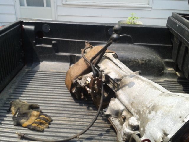

I also have a dodge 360 with a 727. Trans is from a 86 dodge 4x4 pickup. I have a twin stick dana 300 and it slid right into the 727 using the stock tail housing on the transmission. I will look for a pic of it.
So this is the transmission with the 300 on it. Had the same spline count and the same diameter shaft and seemed to fit just fine. They made enough of those trucks you should be able to find a new tranny online close by
its a rusty one
