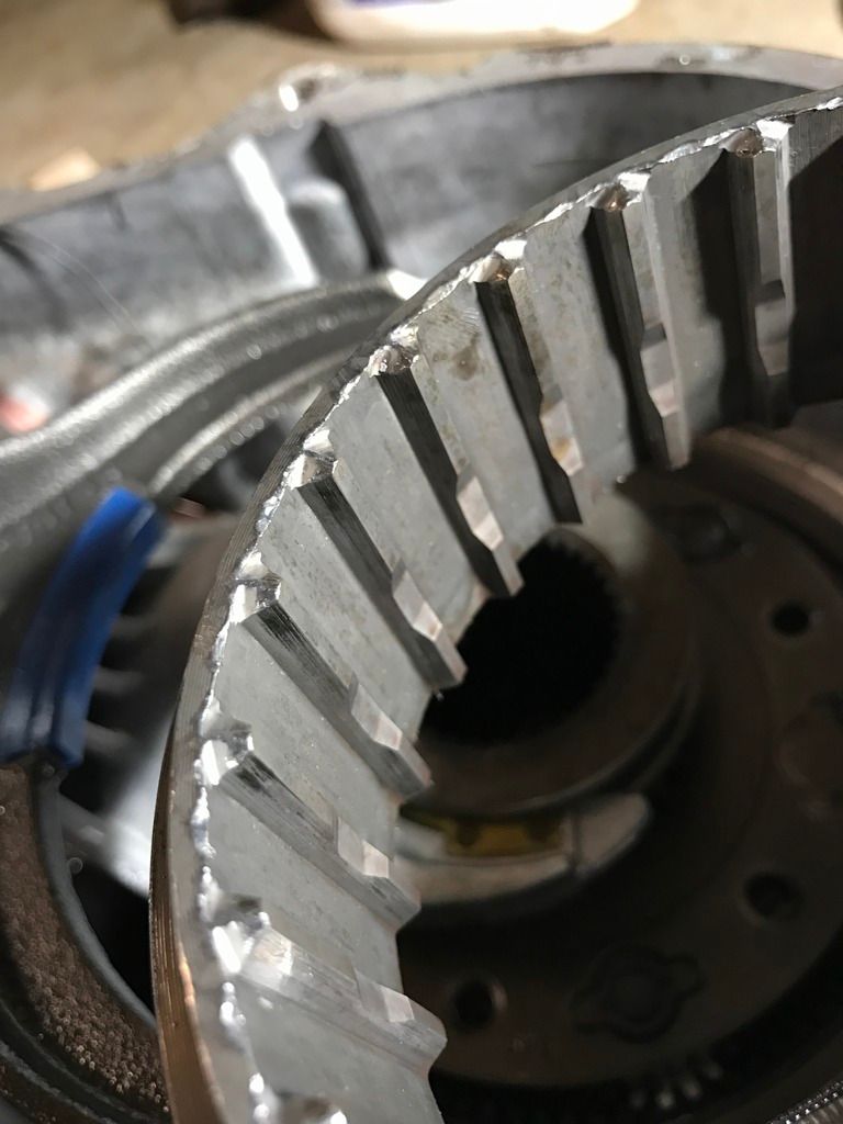

Here's a picture of the wear caused by the broken snap ring in my NP231. I ended up running this case anyway and so far have had no issues with it. I am going back to Rausch Creek for new years so I guess that will be the true test. So far good though. The wear point on this case will only ever see any contact when shifting from 2wd to 4wd, so it will usually not be used at all.

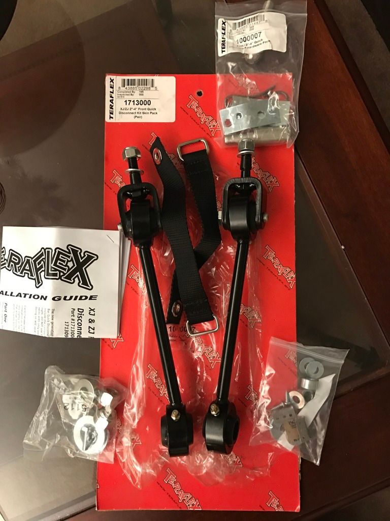

I also scored a set of quick disconnects the other day on Craigslist for $20. They retail for like $180 so I would say it was a pretty good find. All still in the original packaging when I got them. Unfortunately, they are a little too long for my current setup. Should be just about perfect for when I switch everything over to the silver Jeep though.

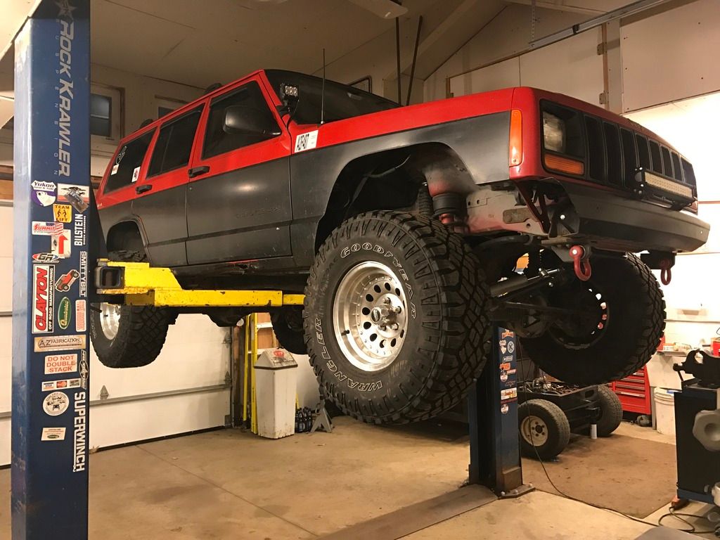

Had the Jeep on the lift last night at a buddies house so I could bead balance my tires. Good chance to check everything over while it was up in the air. Other than my rocker panels, there's almost no rust on this thing... Floor pans are spotless and the unibody is in great shape. Kind of a shame I am going to end up scrapping it...

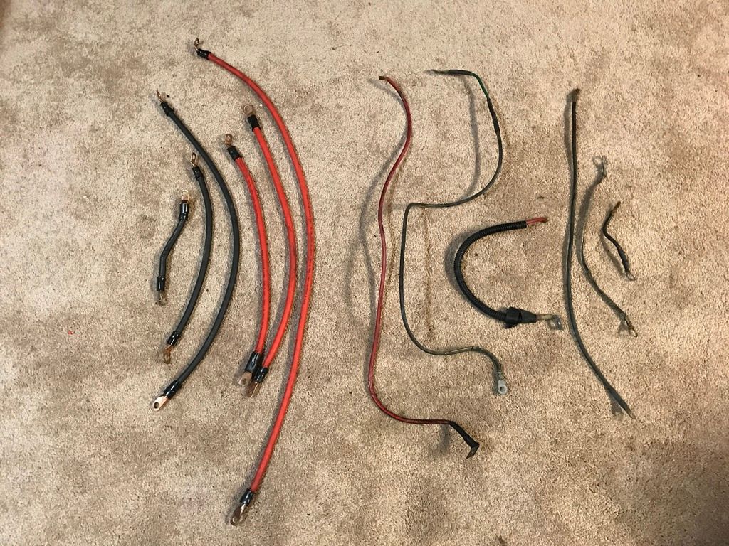

Didn't take any pictures of the steering box, but here's the new battery cables. I put one set in my roommates Jeep last night since he was already in the garage. I will most likely swap mine out today after work.

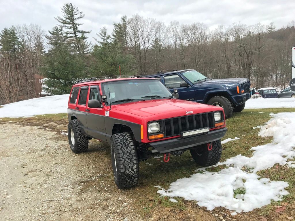

My Girlfriend and I wen't to Rausch Creek for New Years. They had an inch or two of snow on the ground which made for some interesting wheeling. It was also warm enough that the snow was melting so there was some slick mud as well. We decided to stick to the green trails given the slick conditions and the fact that Emily's Jeep is open open on street tires and both Jeeps are only lifted 1.5". We had a really great time and got to find some strengths and weaknesses with both of our Jeeps without bashing on them too hard. Here are some pictures from the trip.

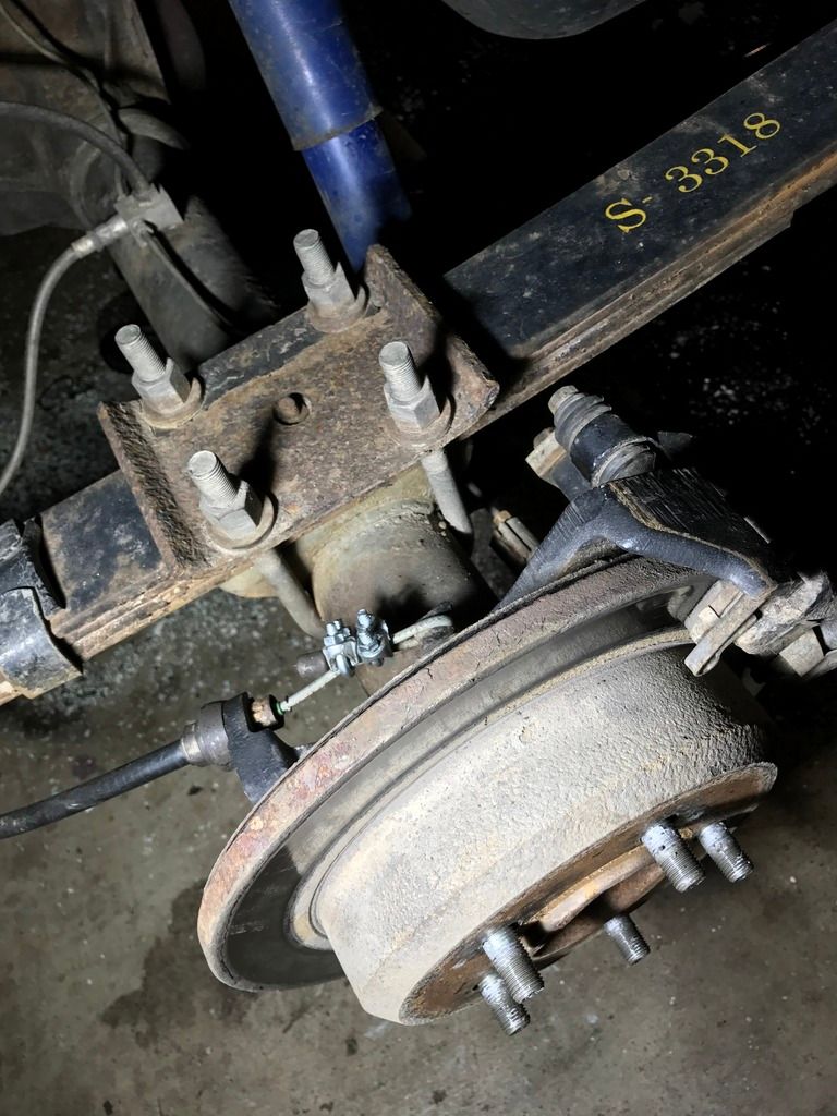

Actually have some updates this week. Got my emergency brakes working for the first time since I did my disk brake swap like a year ago. Way overdue. I was at Tractor Supply and found the cable clamps I needed so I grabbed them while I was there. Got back home and got to work. I used the stock cables and wrapped them around the the e brake "finger" and then tied them back to themselves. It seems to work good for engaging the brake. Brake doesn't hold almost at all though. The cable has stretched into shape a little more so it definitely needs to be adjusted again, I may do that today. I also think the e brakes are probably full of mud. I noticed a ton of mud on the outside of my rotors. You can probably see it caked on in the photos below. I'll have to pull the rotors off and give them a good cleaning, adjust the cables again and give it another try. Since it's an auto it hasn't been a huge deal not having the brake, but it sure would be nice every once in a while.
Here you can see the whole disk brake setup with the modified e brake cable attached (and all the mud on the body of the rotor)
And here is a closeup of the cable with the clamps. I am still using the stock adjuster, just adjusted farther out.
