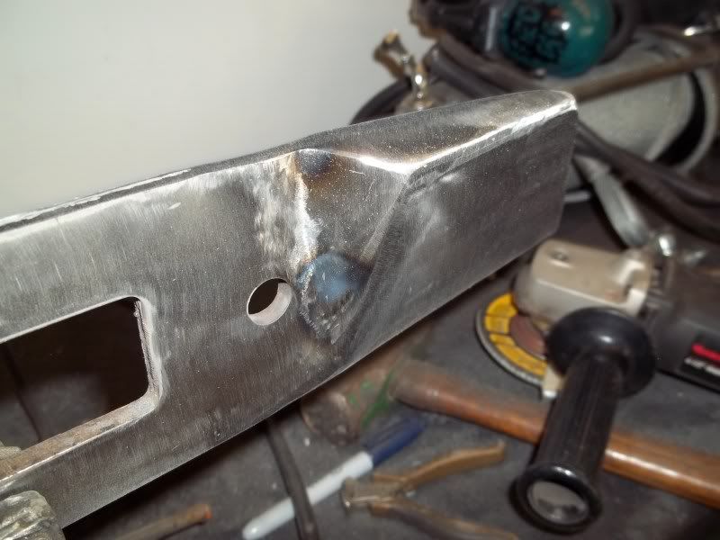

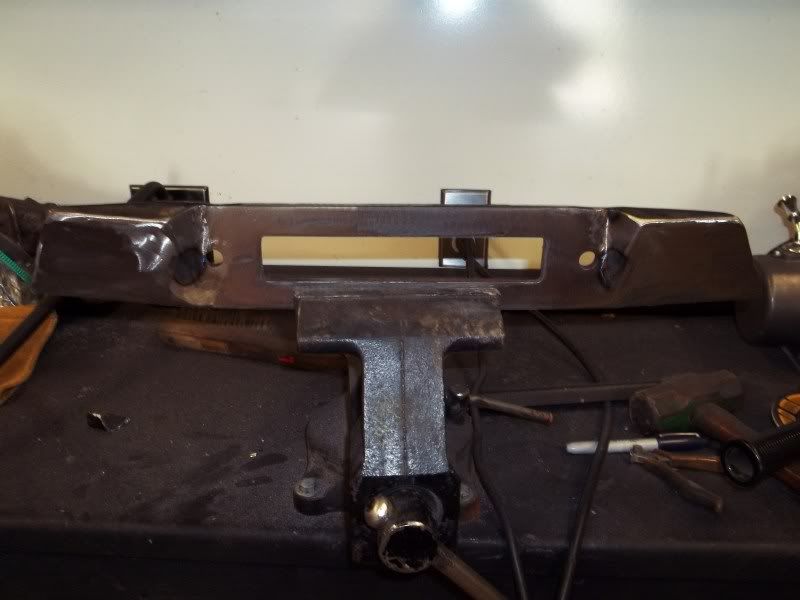

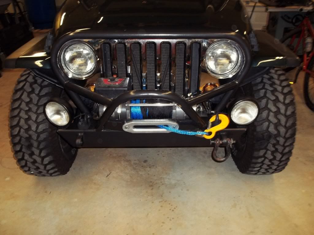

Finished up the fairlead tonight . Decided that I wanted the fairlead to be square to the winch .
I used the sawzall to make two vertical cuts . Then I used the vice with a large crescent wrench to make the bends .

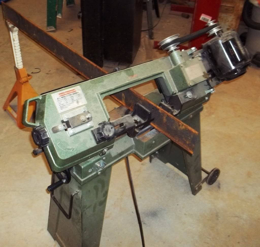

Then it was over the bandsaw to cut two filler plates .
All welded up and smoothed out .
Another view of it welded up .
All fitted up to the tubing .
Fully welded and getting prepped for paint .

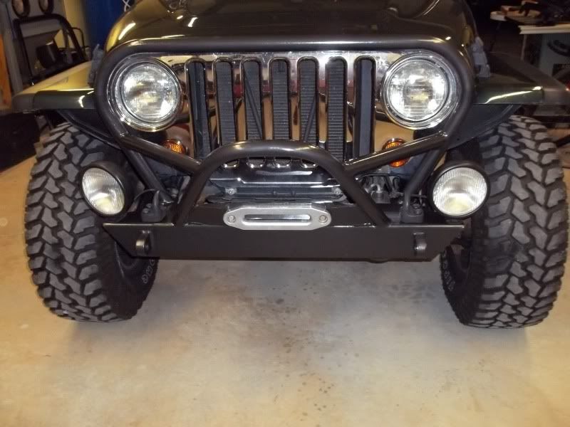

Painted and installed . I had to machine the aluminum fairlead to match the angles of the bumper , but everthing clears and fits nice .
Tomorrow I will finish mount the winch and moving the solenoid box . The box doesnt clear the lower tubing so I am making a bracket to mount it vertically .
I am almost ready to start the cage , but I need to go get a few sticks of tubing first .

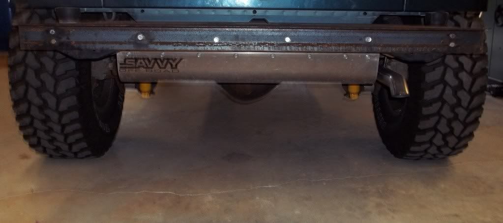

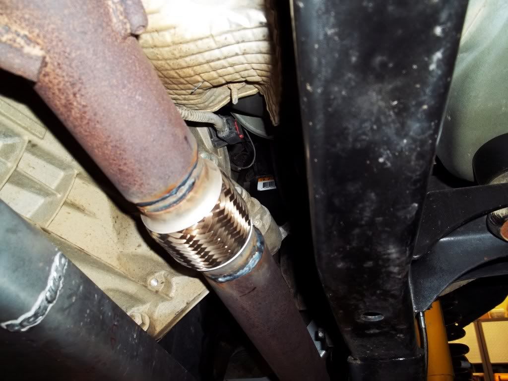

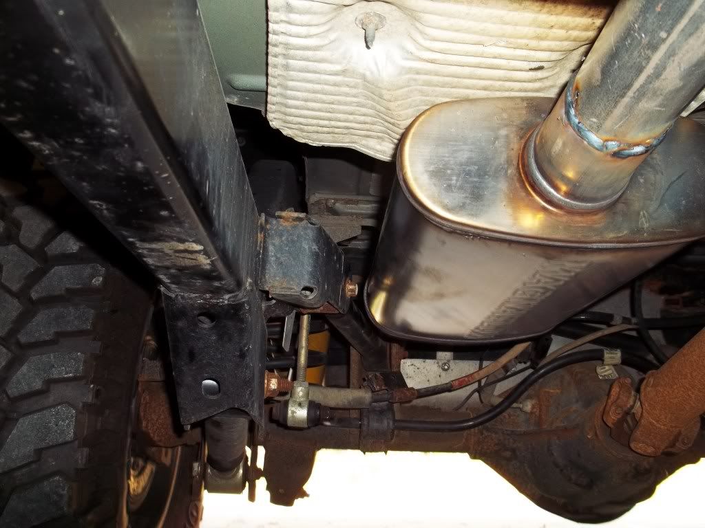

I had a few persistent exhaust rattles after I installed the Under Armor . No matter how I adjusted the hangers and mounts it would still rattle . So I was off to the exhaust shop and this is what we came up with .
The flex coupling should take some of the stress off the exhaust manifold and it also let us get everything lined up .
New muffler installed , the old one was rotten . I also cracked it when I lifted the drivetrain . Its not too loud and it is considerably smaller than the stock one .

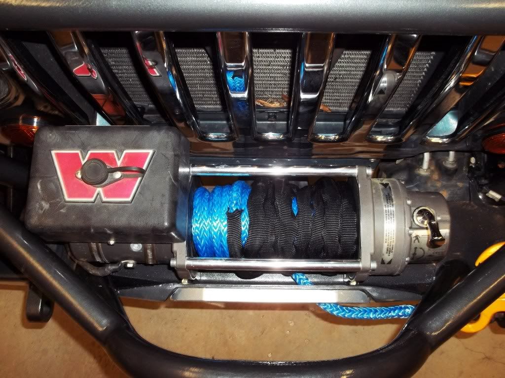

Next up was mounting the winch .
The winch control didnt clear the tubing so I made a lift for it . I took a piece of 1.75 hrew and cut 1/5th out of it . I used the anvil to flatten it so it would not slide . As an added saftey I cut two pieces of vacum tube to length and split them . The vacum tube slipped onto the bottom of the tubing and it is nice and secure .
And a few pictures of the mostly completed bumper and installed winch . I think I am going to get a saftey thimble and also weld a loop for the winch hook to hang from . Still need to sew up a cover for the winch too , but thats for another day .

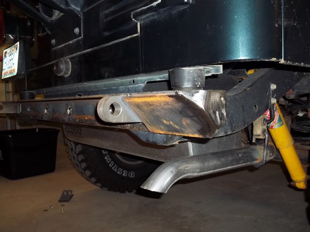

We are heading to the beach this weekend and my wife wanted to use one of the baskets that attaches to a receiver for the kids beach stuff . Theres one problem , I dont have a receiver , so out came the bandsaw welder and grinder .

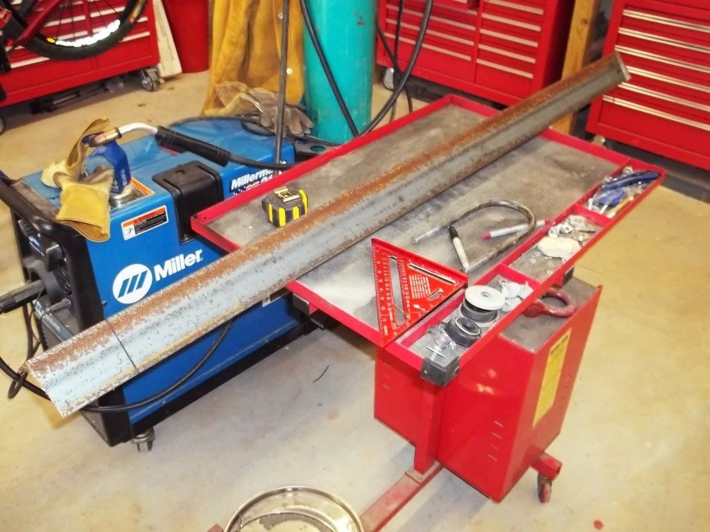

I am using 3"x3" 3/16th angle iron with 3/16th flat bar to make a triangle shaped bumper .
All of the holes are drilled and the bolts are ready to be tacked in place . All of the fasteners will be hidden on this bumper .
All welded up , it took a while as I had to skip back and forth to avoid warping the bolts but it bolted back up perfectly .
This is the flat bar I am using .
And this is the first of the plates that will make the triangle . I knocked the corners off a little , but I think I may go back and cut more .

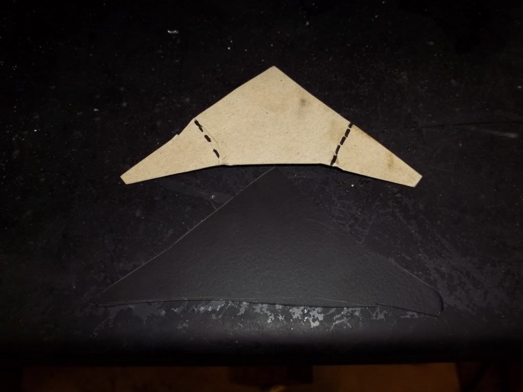

Cardboard corner template .
Carboard meets 1/8th steel . I am using the 1/8th on the corners as it is much easier to bend around the corners yet is still plenty strong covering such a small area .
All welded up . As I mentioned above I think I may go back and cut more off sort of like the Warn bumper . It just seems too chunky to me . I am open to ideas post away .

I had a little indecision with the bumper this afternoon . Then the sawzall and I made a decision ...
I made a few lines while it was on the jeep to see which angle would look the best to me .
And this is what I took off .
I cut out a endcap after making a cardboard template .
This is the endcap tacked in place .
I used a small ball peen hammer to work the metal into place as I tack welded the perimeter .
The ends are fully welded , and the receiver is tacked into place . I am going to french the receiver into the bumper sideways and drop the pin in from the top . I will have to drill the hitch , but it will allow me bury the receiver flush .
From the side , I am happy with v 2.0 so far . Still a lot more welding to go .
