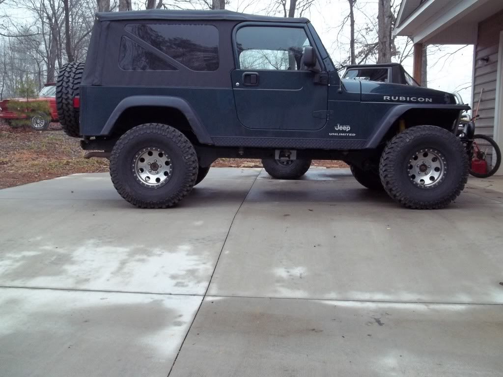

This a great visual piece for me since I plan on doing the same suspension work on mine and am a novice at suspension work. I originally wanted a TJ, but bought the LJ so my dogs will have some room with my stuff.

Glad it can be of some help . The LJs have a nicer ride and the extra space is nice for tools and camping gear . I have a Savvy Under Armor setup waiting to go in along with most of a cage , so theres more to come once the weather gets cooler . Until then I am on a house / yard work rampage .
Good luck with your build , if you have any questions feel free to ask .

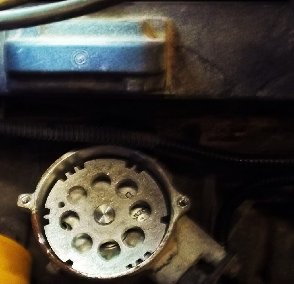

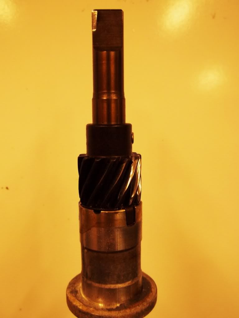

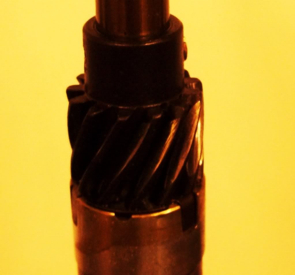

Havent had much time for fabrication , though I do have the cage ready to go . Just havent had the time to put it in . I did get the OPDA swapped out today .
It didnt look as bad as some I saw in the OPDA thread https://www.jeepforum.com/forum/f9/20...ilure-1144202/ but it did have some wear . I used WilyDiggers youtube video as a reference and it helped out a lot with the swap .
If you are on the fence about swapping yours out dont be worried . It is just as easy as the video shows it to be .

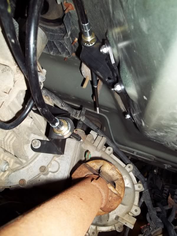

the old z linkage is out . I found the plastic bushings difficult to remove . My solution was to
use a serrated edge knife to cut one side off the bushings . Once I did this they pushed out easily .

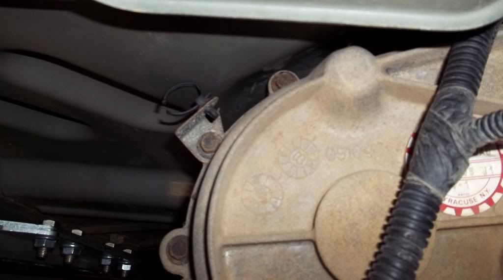

Heres the Novak cable shifter in place . The hardest part of the install was removing the old linkage . The install is more or less self explanatory once you get underneath and look at where the hardware goes .
I listened to what a lot of the other people in the Under Armor thread said . It went together pretty easily and I think it will go under the Jeep pretty easily . I am going to have to modify the front mount as I am running Brown Dog motor mounts .

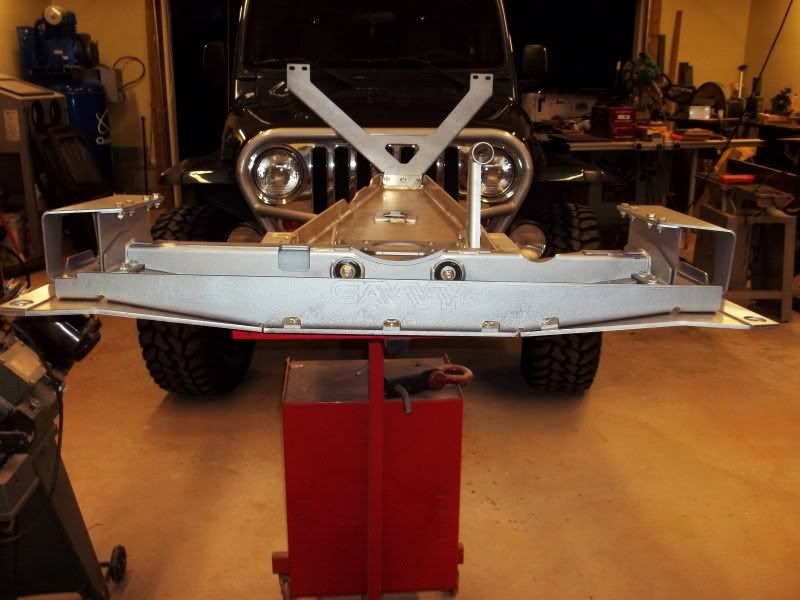

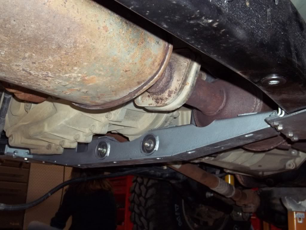

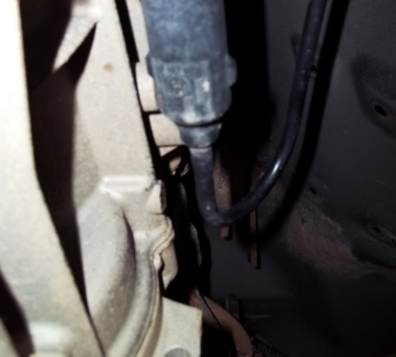

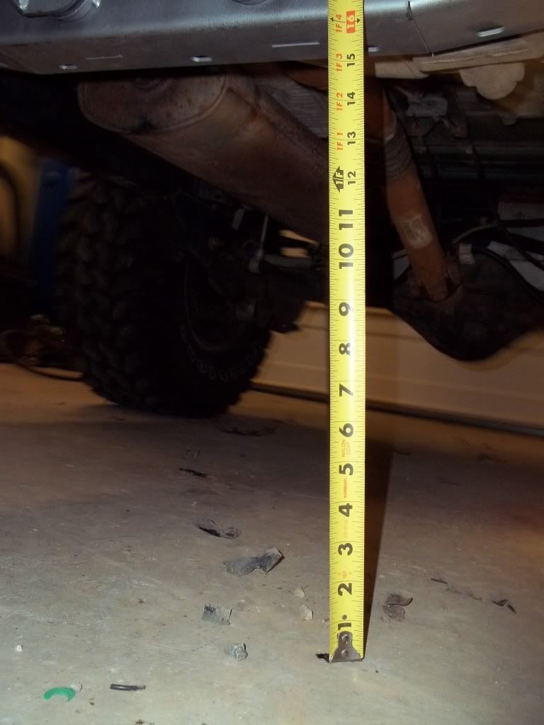

Started installing the Savvy Under Armor today . It went together fairly well . I really only had to fight the exhaust as it just didnt want to go up . With some massaging it now fits and clears the lower passenger side control arm mount .
When I pulled this measurement I thought to myself how much is this really going to go up ?
Once I got the crossmember in and everything bolted up I was shocked at how much higher everything went .
I used a 36 mm socket and it fit over the hump on the t case perfect . With a few lifts of he jack it made a nice sized indent for clearance . I had to use a crowbar after I took this picture for some additional clearance . I will start it up tomorrow to check for exhaust clearance and vibrations from the t case .
More pics to come tomorrow .
QUOTE]
Well to answer my own question it goes up a little over three inches .

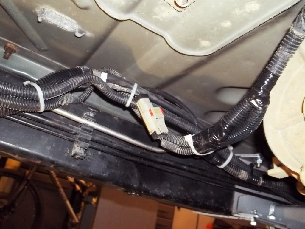

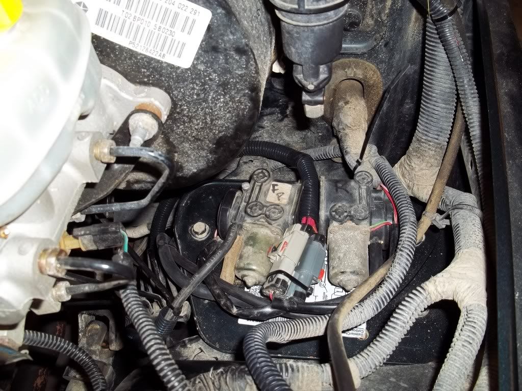

I did not like the factory location of the rubicon locker pumps . So I rewired them and added in some vacum line .
I moved the pumps under the hood onto the ABS tray .

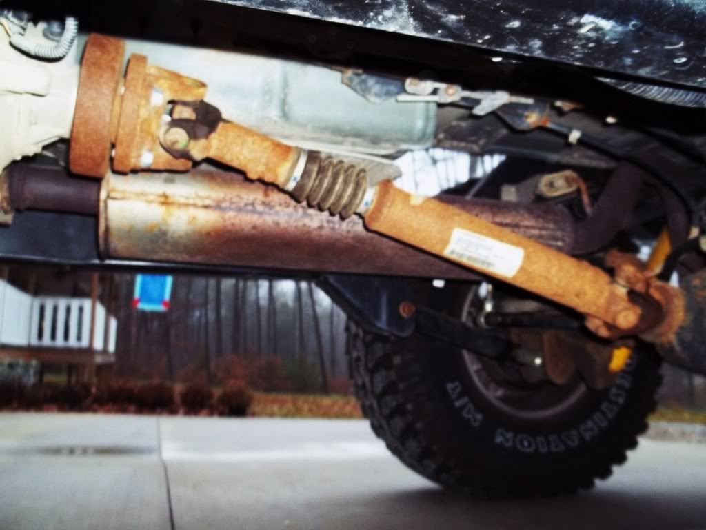

Side view of the under armor and the disappearing t case .
I still have the stock driveshaft under it , how do yall think the angle looks ? After an extended test drive I didnt have any vibrations from it ? I do have some vibrations from the exhaust at idle but most of it goes away once I accelerate . The passenger side lower control arm is super close to the exhaust and I think it may be hitting intermittently ? I cracked the muffler yanking it around so I am going to go to the exhaust shop this week . Once its on the rack I think I am going to shorten the elbow next to the lca and put in a new muffler .

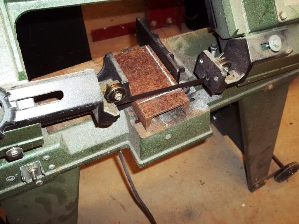

I chopped up a piece of c channel to start .
I put it up on the drill press and then tapped the front mount holes . I am not sure this is the route I am going to go yet , but its a start .

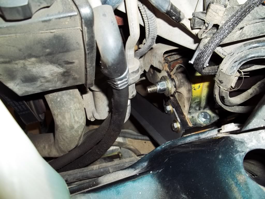

This flex head socket will save you a huge amount of headaches on the passenger side inner motor mount bolt . It is difficult to reach with a regular socket , but this popped right on .
I tried to re-engineer the brown dog lifted motor mounts to work with the under armor front mount . I made the 1st bracket and figured out how to make it work , but the passenger side was going to see a huge amount of shear . So for now I pulled the brown dogs and went with the savvy mounts .

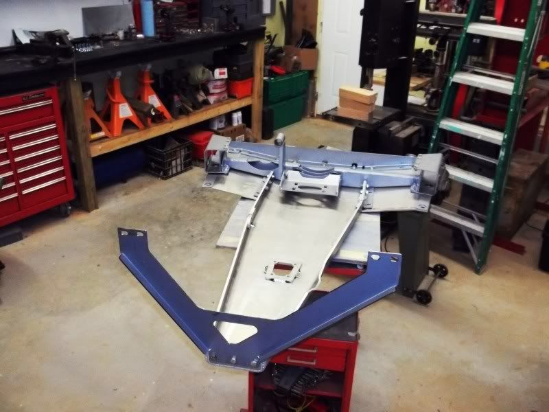

Once the bracket was in we got the surfboard in place . Horray !
It didnt take me long to figure out my fingers werent going to fit on the bakcside of the oil plug cover .
I made this plate and tacked the four nuts onto the plate . Next up was a finger hole to be able to get it into place .
Heres the plate in place . Its simple and the nuts keep it all lined up . Light pressure is required for the first screw because all thats holding the plate in place is gravity .
All buttoned up . The plate I made makes for a super easy removal when its time to change the oil .

Overall I am very happy with the Under Armor . It takes a while to put it in , but the end result is so worth it . Still trying to decide if the rear driveshaft is going to work or not . I have had it up to 55 and no crazy vibes ?
