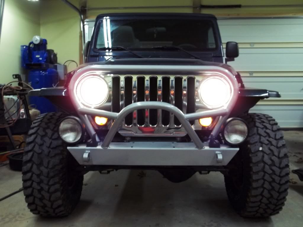

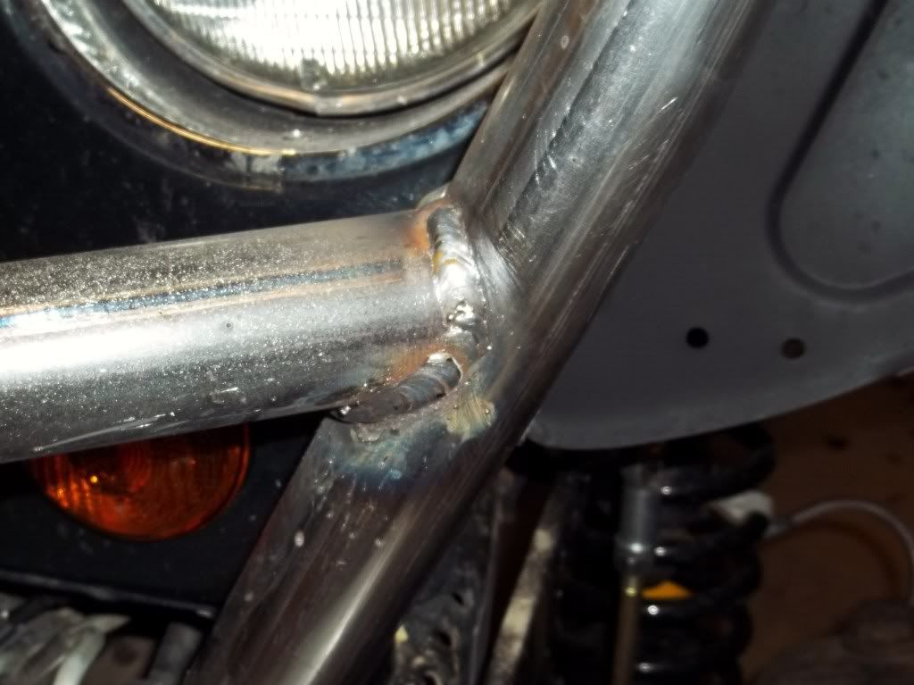

Even with a tubing notcher these joints were a pain .
Fitted and tacked in place .
Mostly welded .
Should have started on the front so my ugly stop start would be on the back .
Cutting the D Ring hangers .
All welded up and ready for primer .
And the finished product . I still have to paint it as right now its just primered , but beyond that it is done . Now on to rollcage , but thats going to have to wait until I make it home again .

Thanks , it was a lot of work but it was worth it to me . The next one I make will be much cleaner . The notching on the tie ins between the two hoops was tough to get just right . The second time will be the charm !

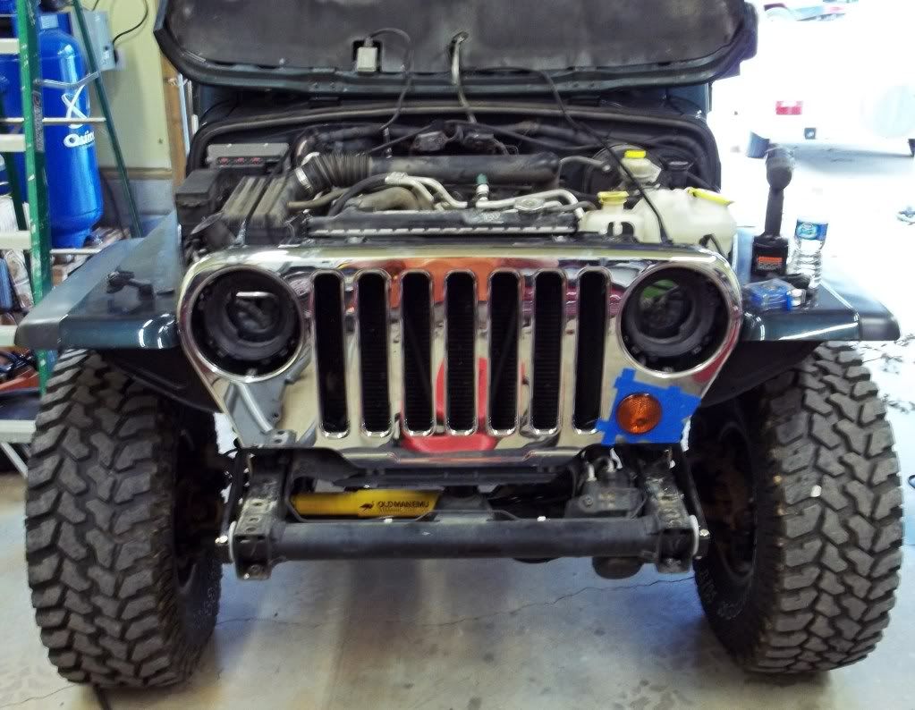

I didnt take any pictures of me pulling the deer damage . I used a ratchet strap to pull against the bumper and I got it mostly pulled out . Thanks to Jakes unused chrome grill you cant tell a deer attacked the LJ anymore .
Lining up and cutting the turn signal homes was a challenge . I ended up scribing them with a 90 degree scratch awl . I then drilled a hold and used a set of good sheet metal snips to cut out the holes .
I picked up a stick of angle iron this weekend to start the new crossmember project . I am going to make a triangle shaped crossmember with a frenched in receiver and d ring hangers . Once thats done I am going to add some tubing to go around the corner of the tub . This should help a little with the departure angle and it gives me an excuse to use the plasma cutter .
