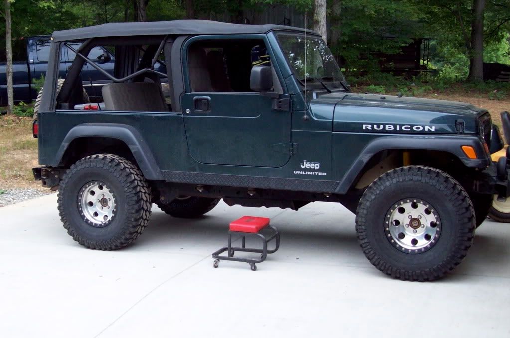

I havent had a 4wd that could be driven on the highway in a long time and I was getting tired of trailering everywhere so I started looking for a LJ Rubicon last Thanksgiving . Within a week I found this with 60k miles for a great deal and it was semi local .
This is the first picture I took of it once I unloaded it from the trailer . The next day I took it out back to have a little fun .

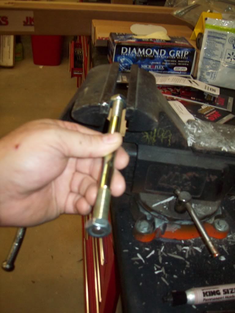

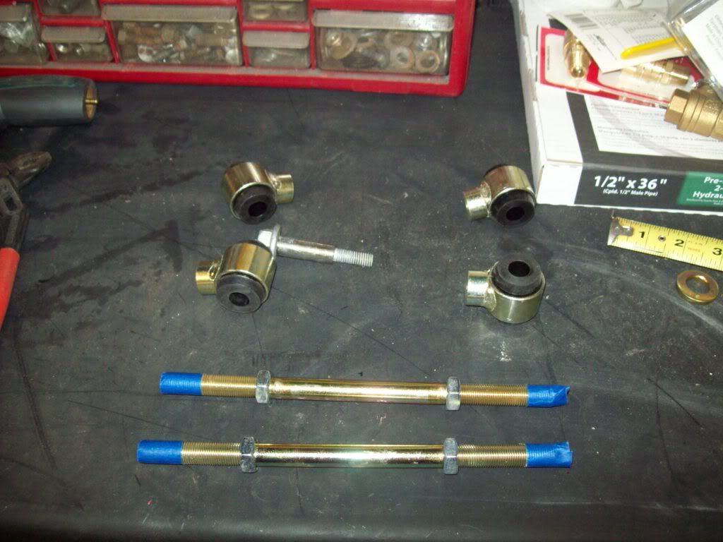

Heres the links cut down and with the threads cleaned up .
I had to cut the new links down so it gave me an excuse to use the bandsaw and grinder .
