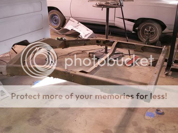

Got the mounts and cross member for the front suspension welded up.
-(O|||||||O)-

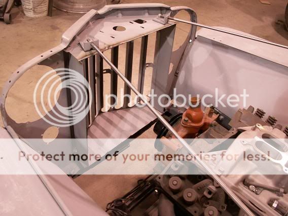

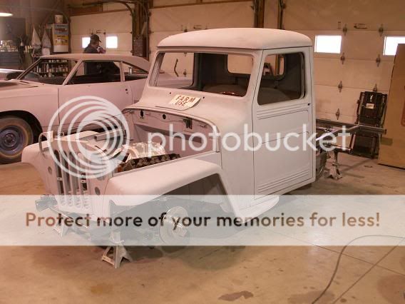

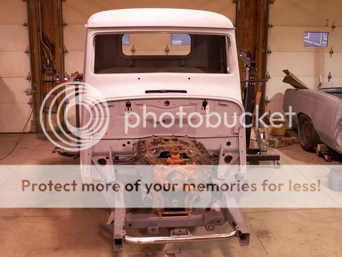

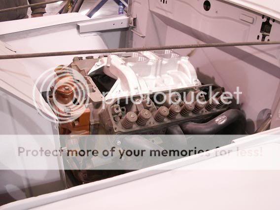

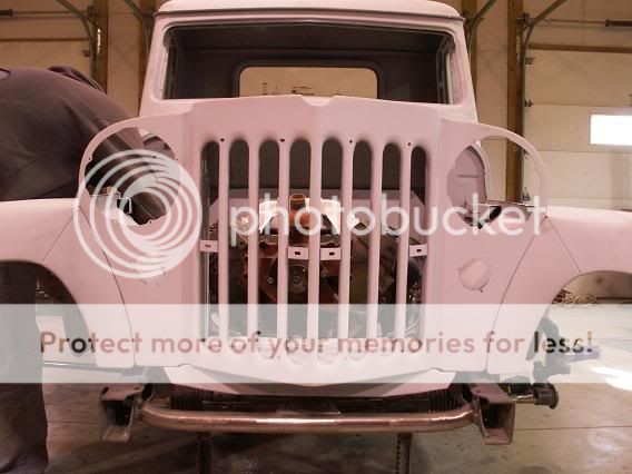

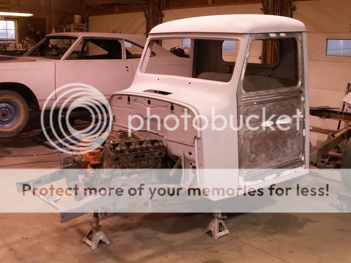

Chrysler 440 big block sitting between the frame rails. Once the engine has been built it will be a shade over 500c.i.
Had to move the firewall back a few inches to make it fit.

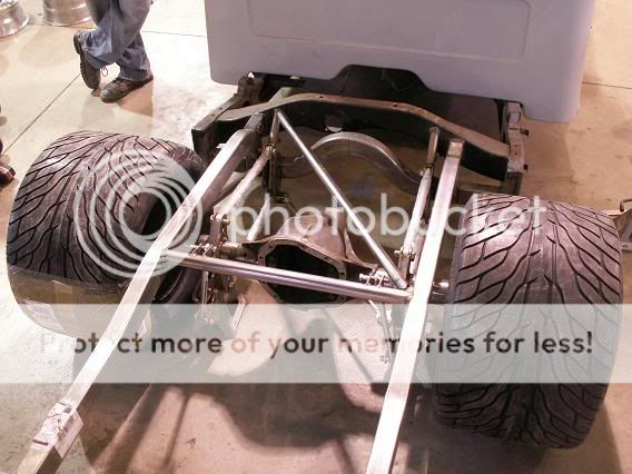

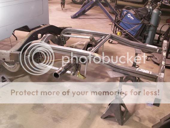

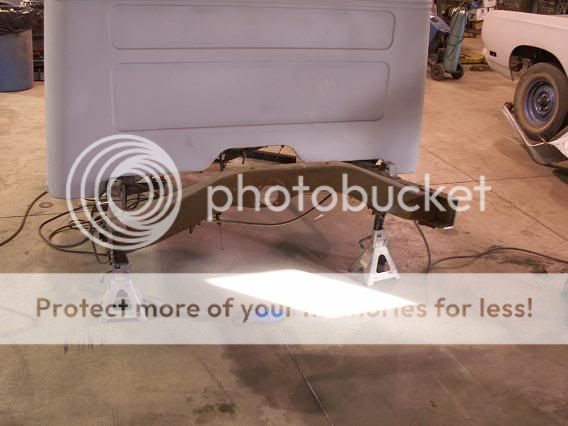

Getting the frame ready for 4 link setup.
Rear frame rails and 4 link starting to come together.

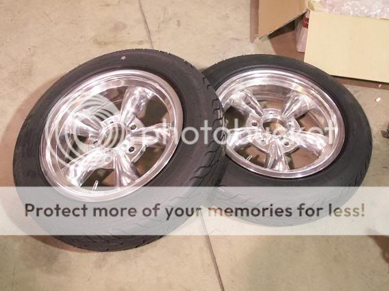

Got the rear tires and wheels in. The tires are 29"x18" Mickey Thompson S/Rs and the wheels are 15"x14" American Racing Torq Thrust IIs.

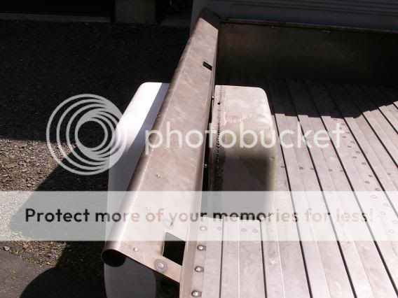

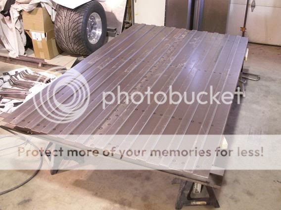

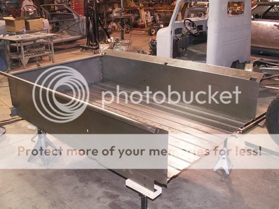

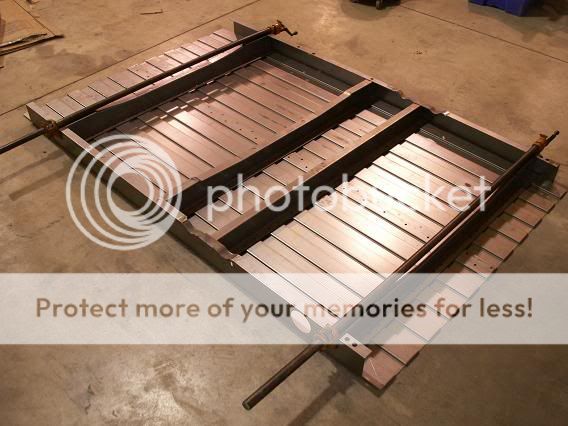

Assembling the new bed.

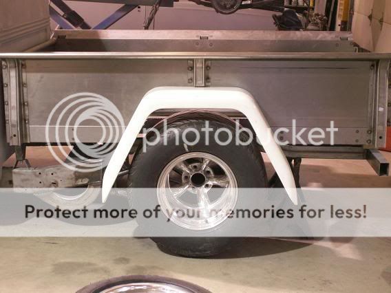

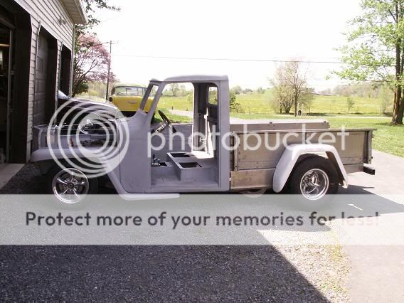

Bed sitting on the frame with fender mounted.

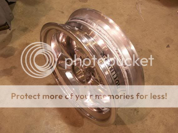

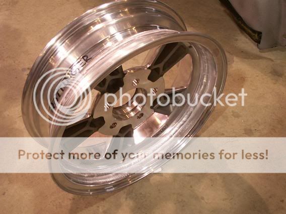

I had a heck of a time coming up with wheels for the front that kept the tires under the fender. I ended up having Halibrand machine me an extra 1/4" of backspacing out of their 15"x6" spokes. Then I had them drop ship them to Weldcraft Wheels to have them narrowed to 4.5". The tires are 24"x5" Mickey Thompson S/Rs.

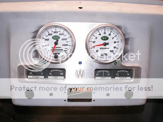

Custom made gauge bezel. The factory gauges on the bottom will be send of to be rebuilt and converted to 12v. The face will also be matched to the Auto Meters.

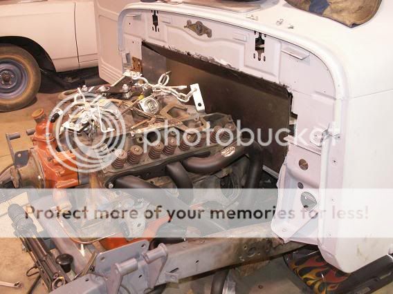

Got the headers made up and the custom made radiator installed to the grille shell.

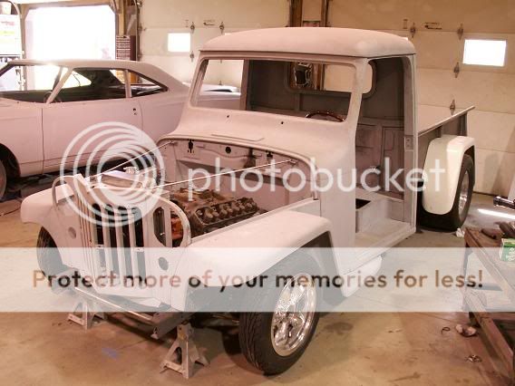

Here's a couple with the fenders bolted on. This is all of the progress so far. I'll try and keep it up to date.

Using the old fenders to make the wheel tubs
