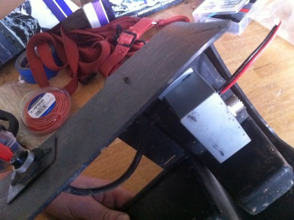

Sunday, I go out to remount the cb to test it and see if it works. While cleaning out my floor board I removed the front half of the center console and found this. The cable was cut and I never thought to look under here before. This picture is after I mounted the handheld part to the passenger side of the console. There was a hole there. I guess this is where the PO had it mounted too.
After i saw this, I wired it up and works. I still have the old one that was in the glove box as a backup, I guess. Still need to get another antenna to tune it... Anyway, until the glove box comes in, this is how the cab looks.
I cleaned up the wiring in this picture too.

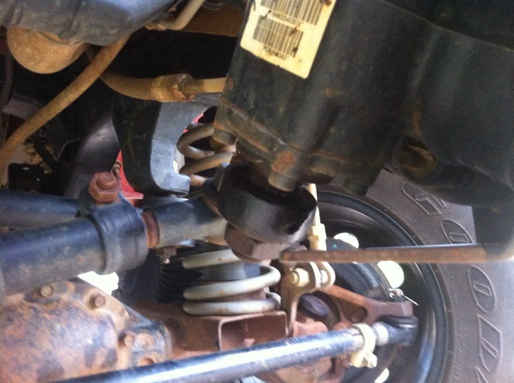

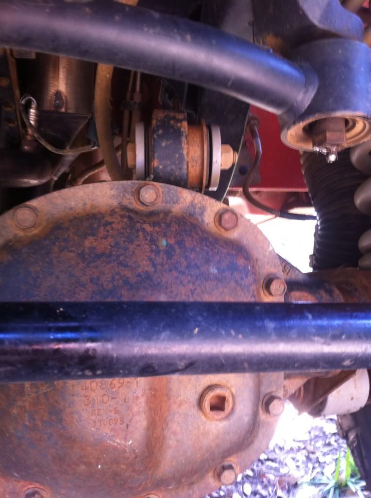

Also, saw this while i was greasing the front end.... Is this something I need to deal with soon? Axle side of the lca driver side.

I had one work itself loose. The other axle bushing on mine was removable without any tools it was so loose. The bushing was really tight but was loose in the housing. I replaced mine with the JJ kit.
Do you have a link to the kit. I have heard of this being helpful especially with DW. My concern is the installation. I am not the most talented mechanic and very limited on help.
Here ya go, I heard recently it was on backorder. If it was they should have them out soon because they sell a lot of these. The install is pretty easy, you have to get the rubber bushing out in the spot where yours is loose and cut the metal bushing housing on the other axle mount. The bushing housing is cut roughly in half and the pillar that comes with the kit is welded in its place.

Well at least, it appears that you do not have to remove the axle from under the Jeep.... Can this wait a few weeks, or is the bushing/joint going to work its way out at 60 mph hour one day?

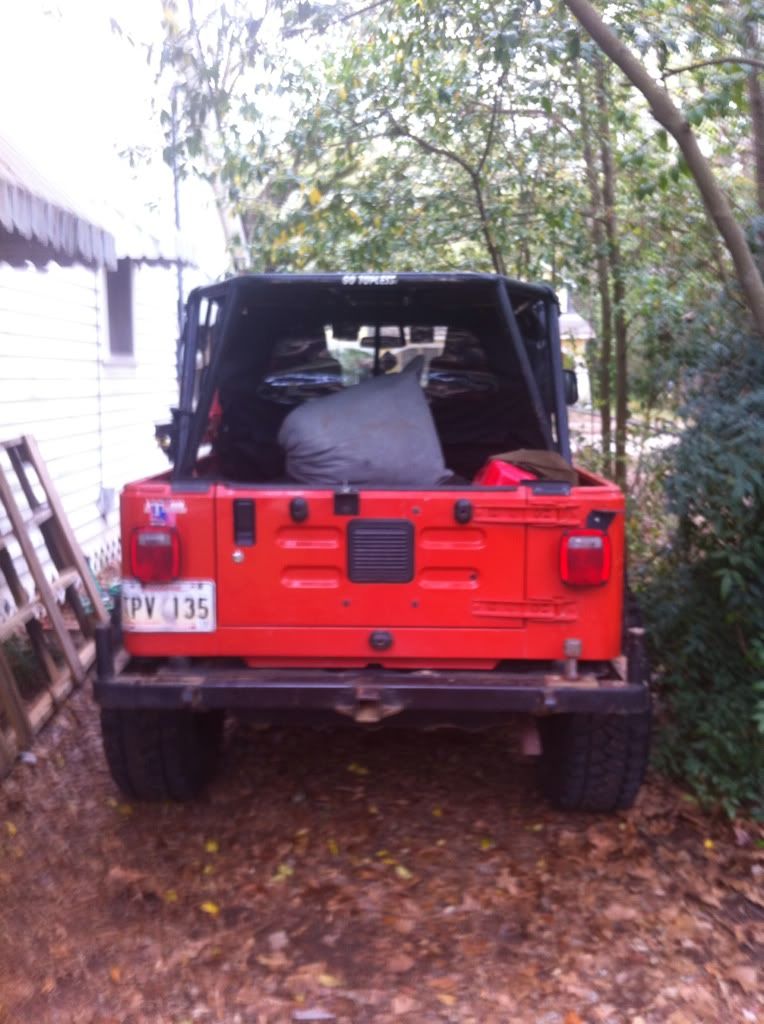

So, removed a few things this weekend.
No swing out, no rear seat belts. Tonneau on the way along with winch line. If you asked me a week ago what made a jeep a jeep, it would be a winch, removable top, lift and rear swing out tire. But after hauling a trailer this weekend a couple times, I am going to try this set up for a while. Spare tire is in the "bed". What do you think?
