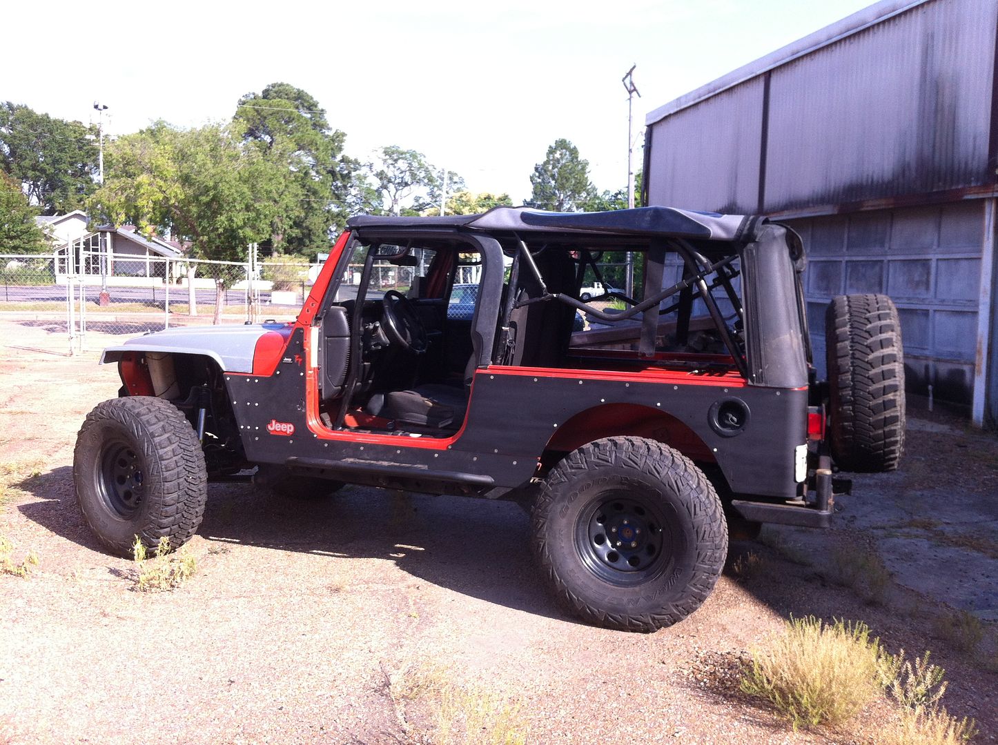

Might as well call this jeep Murphy.
Dialed in the rear suspension pinion angle
moved the front axle back almost an inch due to hitting the trackbar. Then dialed in the front pinion angle.
Added the springs that hit the artec gussets
Disconnected AR axle side
Trimmed the artec gussets
added the tires and wheels to align the steering
pushed it out of the garage..... due to a dead battery
brought the battery to get it check out and charge at Autozone
Here is where it confused me: Before I attempt to move the jeep, I tried to start it with absolutely no response (no engine turning over, not even a sound). Pushed it out of the garage and jumped it off with another vehicle. I let it idle for about 5 minutes to get warm. I then jumped in and was turning the jeep around to get it on level ground when it just died, just shut off. My dad was standing in front of it and said he heard a thud or some type of noise. I removed the battery cutoff switch from the circuit (a positive interrupter that goes to a switch to cut off power). We tried to jump it off again with no luck. I brought the battery to autozone for them to test it and recharge it. They said it just needed a charge and was at 5V when I brought it in (optima yellow). I returned about 6 hours later and they said it was at full charge and was still a good battery. I brought it back to the jeep and the jeep still had no response when I turned the key. Any thoughts?
I am going to try to clean the battery terminals (it has screw on post that have a bolt on them that allow me to add the cables and remove them with a wing nut)
A friend will be coming on day this week with a multimeter to test where the power is
Could be the main fuse going into the fuse box?
Don't think the power is getting to the starter
I just started it before the problem happened, I don't think it is the ignition switch, but it could be.
I also ordered so pre cut tabs that should work with the inner fender idea.
And ordered blaine's stripped knuckle kit https://www.jeepforum.com/forum/f9/st...uckles-437187/
And I think I will be changing u joints and possibly doing the washer/u joint fix with stock front axle shafts
Before it is wheelable:
blaine's knuckle fix
alignment and figure out battery problem
inner fenders/ mount rad overflow bottle somewhere
new u joints for front axle
Adjust both doors to work with the tnt spacer kit
Hopefully, I will be there LAS. I am running out of excused for not driving this.
And it is out of the cave.
