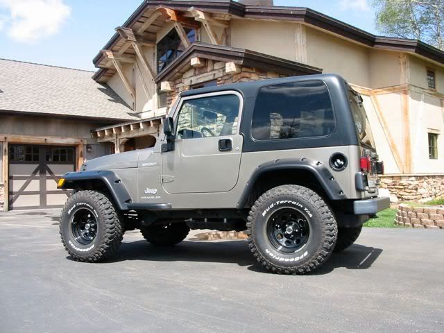

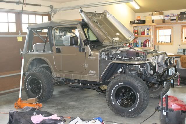

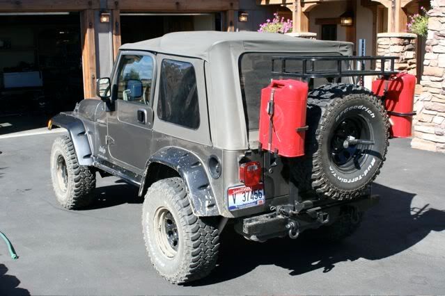

Here is what I started with:
And after first round of purchases and where this build starts:

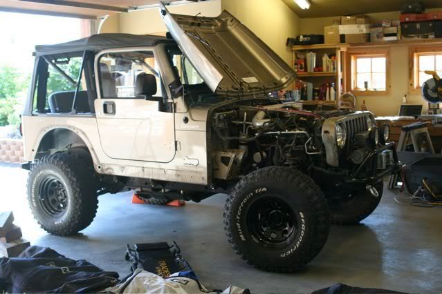

So to start off, I gave the engine bay and Jeep bottom a good bath and sprayed PB Blaster on every nut/bolt I thought would need to come off. I pulled off the spare, high lift, swing out tire mount, rack etc... and pulled it into the garage.

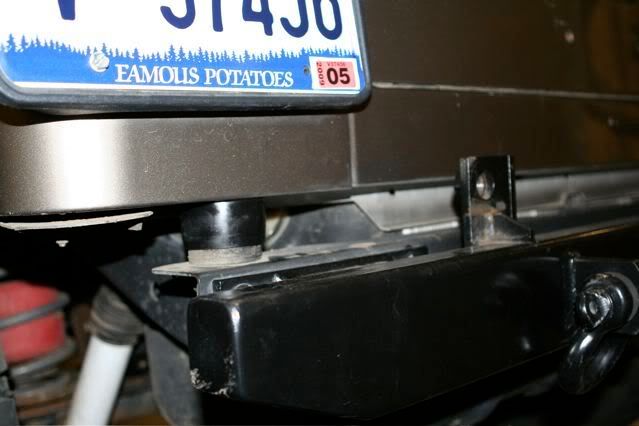

First up is the body lift. The body lift and MML is required to run the TNT lift with a high clearance belly pan - I will be so happy to get rid of that shovel. A BL is really not that difficult but I did use this write up: http://www.mudinyerioffroad.com/jks_bl.htm
Everything went pretty smoothly - although the mounts on each side of the gas tank are a real pain!

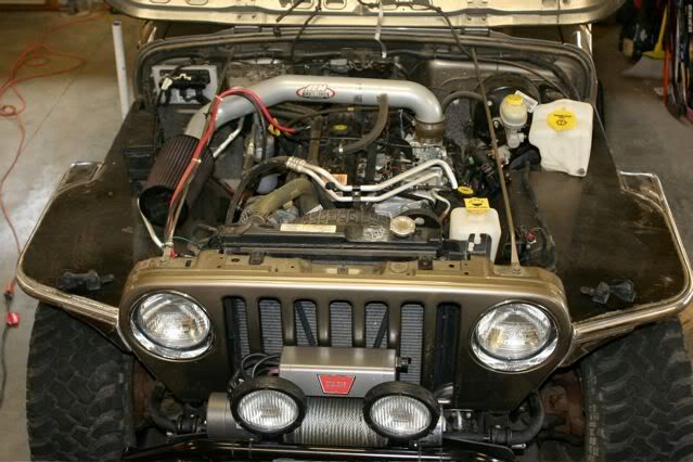

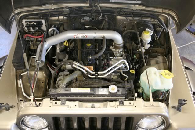

Because I am replacing my fenders with tube fenders, and the motor mounts are tough to get to I decided to pull the flares and fenders before starting the MML. Those nutserts that the bushwackers are attached with are a lot of fun. I also decided to pull off the rockers since they are attached to the fenders and thought it would be easier later during my tube fender test fits if they were gone.
After that we moved on to the fenders. There is quite a bit of crap attached to the fenders - looks like it is going to take awhile reattaching all of it.
Shot from above before:
And after:
Side views:

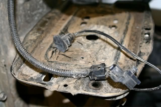

Question:

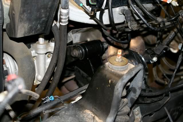

I took out the battery and battery tray - there is some sort of pressure switch or something that is plugged in and ran through a hole in the bottom of the stock tray. Can someone tell me what this thing is?

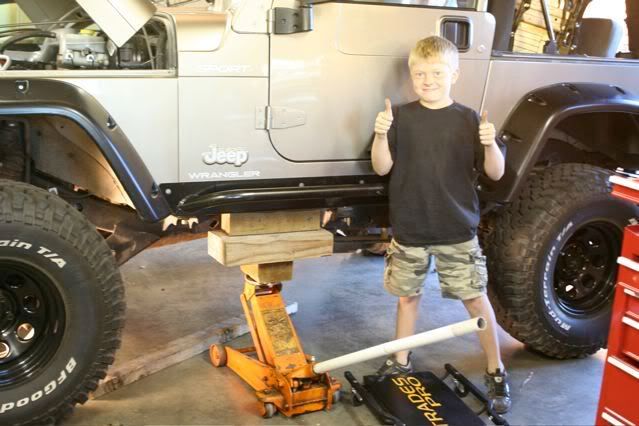

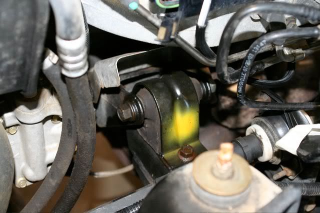

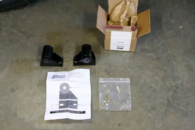

Finally I could move onto the motor mount lift. Seemed fairly simple but even with the fenders gone it took me a few hours. This is also a fairly simple job but I did use a write up which had some good advice. http://www.4x4xplor.com/MML.html
Everything went pretty smoothly, I had to jack up the motor more than I had anticipated. Doing this job with the fenders out of the way made it a lot easier.
The Currie motor mount lift kit - not much to it
The old mount - Part of the A/C is in the way and the entire bracket had to be removed to put the new mount on.
The new - 1" higher.

Originally Posted by thedirt View Post
That plug on the bottom of the battery tray is the temperature sensor for the battery, IIRC.
Out of curiosity, which RockMonsters are you going with? The one they show on the site, or the beadlocked-moab looking one?
Temp sensor? interesting.

ya the battery temp sensor basically verifies the internal pressure build up of the battery if I am correct. It will throw codes if you're not careful with it, most people don't know about it. Interesting little sensor actually, nice build looking forward to seeing the finished results.

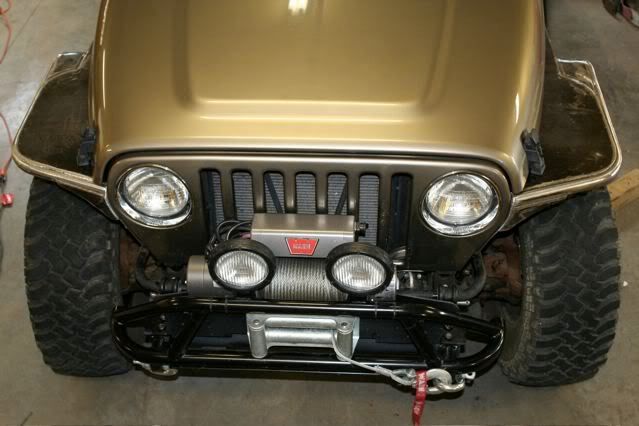

So it was raining today which meant another full day in the garage. I was able to make enough progress to justify another build entry.
I am waiting on paint and the rest of my lift to show up so I decided to focus on the fenders and corners. Here is the closest thing to a write up that I found. http://www.colorado4x4.org/vbb/showt...ht=tnt+install
I started with the front fenders and assumed there would be some modifying to do for the fenders to fit right. But they both went in pretty smoothly and required only some very minor filing in a couple of the mounting holes. They were easy to adjust and fit great. I am more and more impressed with TnT. Once these fenders are bolted on they are stout!
After I had them in place and adjusted, I worked on finding a home for all the stuff I pulled off the old fenders. The passenger side was not bad at all, I had to slightly bend some of the A/C tubing, bend the mount for the fuse box and drill the holes. The drivers side was about the same except for the washer bottle. Only place that thing will fit is now down in the bottom of the fender/wheel well area.
Once both fenders were in I pulled off the old hood latches and installed them on the fenders. It was great to see the Jeep with new fenders - it makes a huge difference and I really like it.

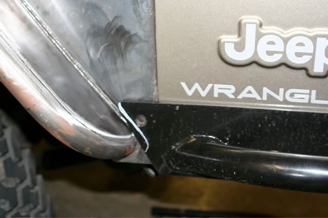

After that I put the rockers back into place and as expected Some trimming was needed. Rather than just making a little notch to fit, I chose to trim the rocker so that the angle matched the fender. I don't mind the gap - so long as the angle is the same.
Here is a shot of the test fit:
Here is a shot of the rocker after the trim. Hard to see, but the rocker angle and fender angle are the same.
Idaho-Jeep is offline

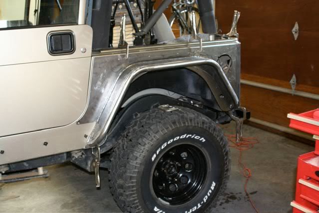

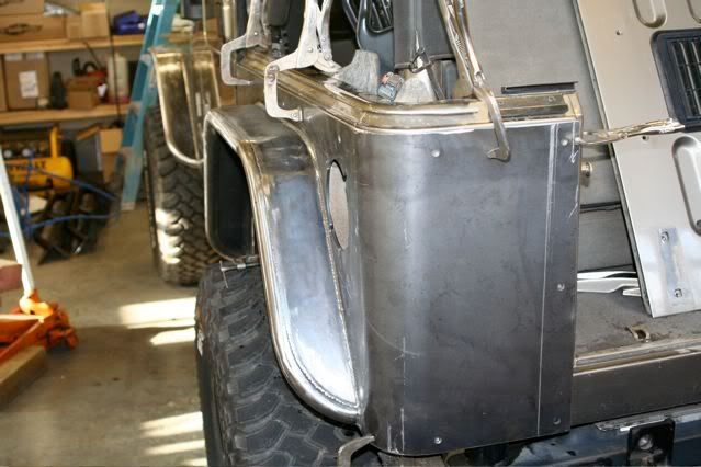

The corners were next. These things weigh in at over 50lbs each so putting them up on the jeep is a little tricky. I highly recommend using the wide mouth vise grips - make things much easier. Like the fenders, the workmanship by TnT on the corners is top notch, they also fit incredibly well! I had wondered if there would be gaps where the corner meets the tub at the corner - The bend is perfect and fits tight everywhere. I put the driver side on first, then drilled all the holes using the holes in the corner itself as a guide. I then put in a few spare nuts & bolts to hold it in place so I could use the vise grips on the other side. The Passenger side fit perfect as well.

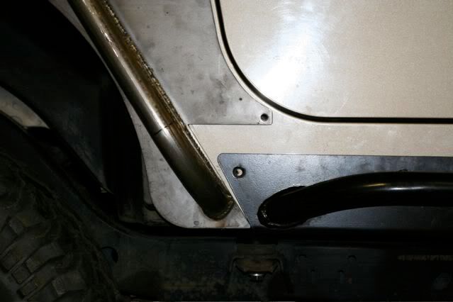

Like the tube fenders, the corners hit the rockers and so I needed to trim the rockers again. The only disappointing thing with the corners is that they are made for a higher rocker. I will end up with a 2" gap between the corner notch and rocker. Because the corners will be painted to match the body color I don't think it will be noticeable.
Here is a shot before -showing how the rocker was hitting the corner:
And after I trimmed it to match the angle of the corner fender.
It was really nice getting to see the Jeep with the corners and fenders on today. I need to pull them off now and finish drilling all the holes in them. I also need to do some trimming tomorrow to the tub
So here it is - I will be putting on tires 2" larger than these and taking off 1/2" of suspension lift - Not as Low COG as I would like - but will work for me for the next couple years.... I hope.
