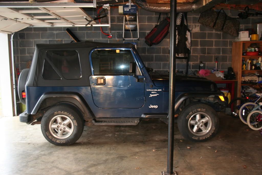

Technically, this is not a technical post. But, I had to show this off.
BEFORE
AFTER
Wife is really mad at the "missing tax refund check." You can have her if you want, but don't say you were not warned!!
Build parts
2.25" Budget Boost
Skyjacker Hydro shocks
Rubicon Express rear trackbar relocation bracket
1.25" JKS body lift
1" JKS motor mount lift
33x10.5x15 BFG MT's
Results
Total Lift at seat = 5 1/2 inches
Rides like a Cadillac
Gets 14.8 mpg
Cruises at 70 mph, 2,900 rpm
Plenty of power
Slight hum from wheels (they're MT's)
Stopping takes a little more planning

No vibes. BTW, special thank you to TN Trooper Butterfield for not giving me a ticket while checking for vibes (63 mph in a 45 zone).
No rubbing at all...not even close. I added the relo bracket to recenter the axle. I am off 1/8 inch. I went ahead and trimmed 1/4" off the top rear spring perches just in case. I have over an inch on both sides. No spacers necessary.

They don't stick out hardly at all. Maybe 1/2". Pics tomorrow!
Originally Posted by doogie View Post
You mentioned plenty of power, you got an auto right? What gears?
I've got a 6 speed with 3.73's and I turn 2900 at 80 mph now, so I was suprised to see you turning that at 70 mph. Before the 33's what did you turn, you had to be mid 3's at cruising speed.
I have the 32RH tranny (3 speed, no OD) and 3.73 gears. My OLD rpm at 70 mph was around 3,150. However, that was runnig 235/75's which are one inch bigger than stock.
Originally Posted by 03silversport View Post
Is that a standard 7 foot garage door height? Any clearance issues? I am getting ready to order tires and lift but want to make sure i will still fit. Looks like your rig fits fine, and i will have about the same amount of height.
Yep, It's a 7 footer. When the door is open, the clearance is 80 inches. The top of my Jeep is 75 inches.
