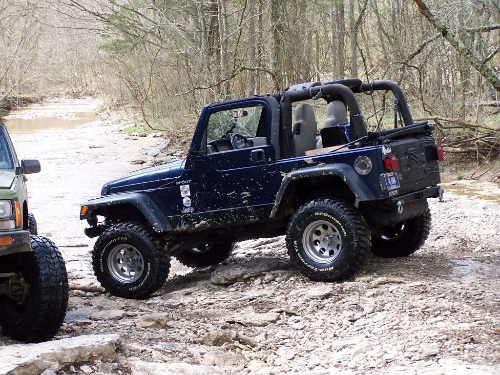

Ok, pic time! Poser shots first.
Our group for the day. Pretty good turnout.
Here she is for the group photo before the first trail.
Here she is post first trail. Tore the crap out of the flare. I think some Rokmen HiLines might be in store for her this year.
Sort of clean after taking on the waterfall. I like this shot.
Flexed her out again.
Like I said before, no rubbing.
Playing on some big tires.
Watching some others from the group play on the waterfall.

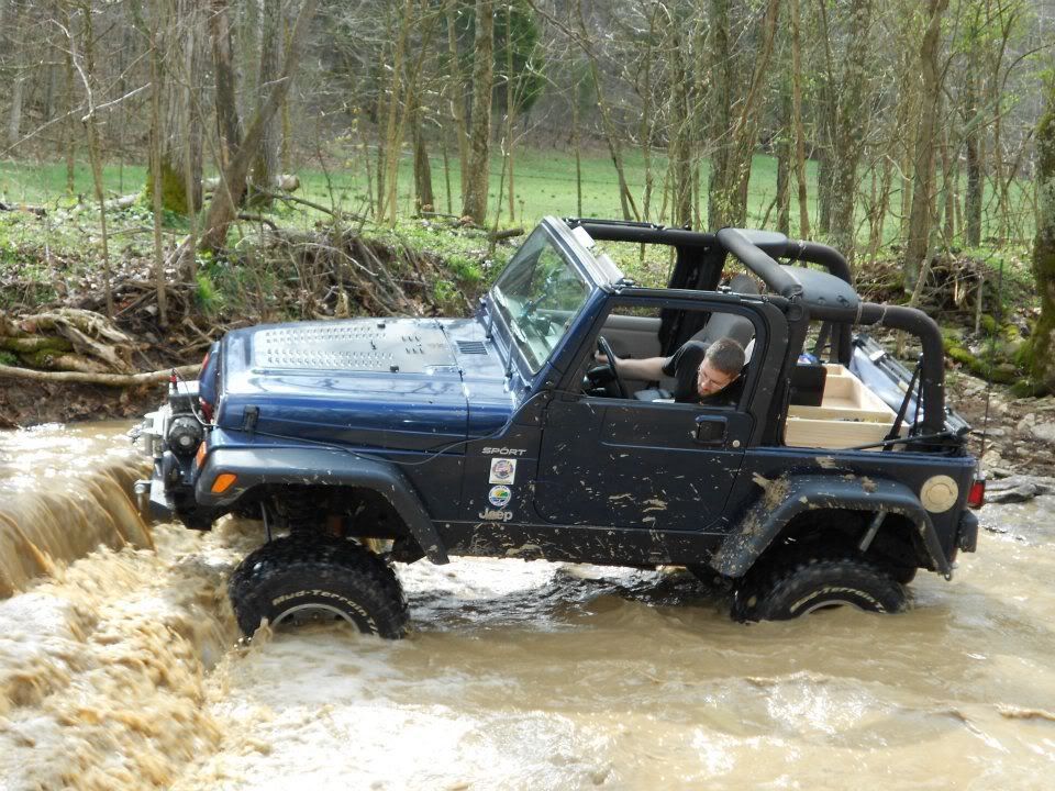

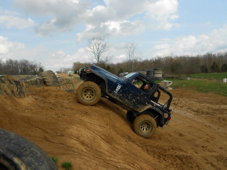

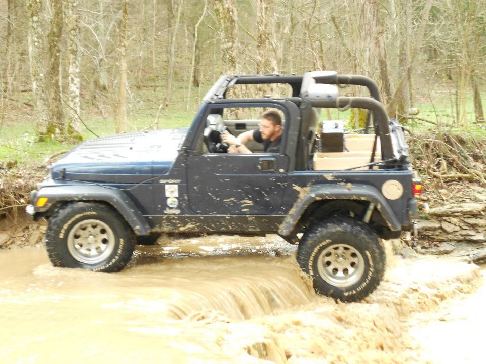

Me on the waterfall. Jeep didn't spin a lick any of the times I went up this. I tried the taller side, but my bumper kept getting caught on the rocks. With as muddy & slippery as it was, I'm just really happy with the way the Jeep performed Saturday. I can't wait to get to Attica & try the LSD out on the rocks or at least on something remotely dry.

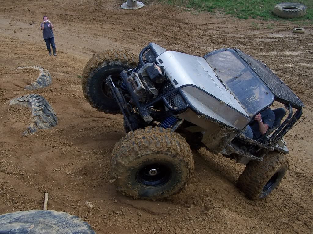

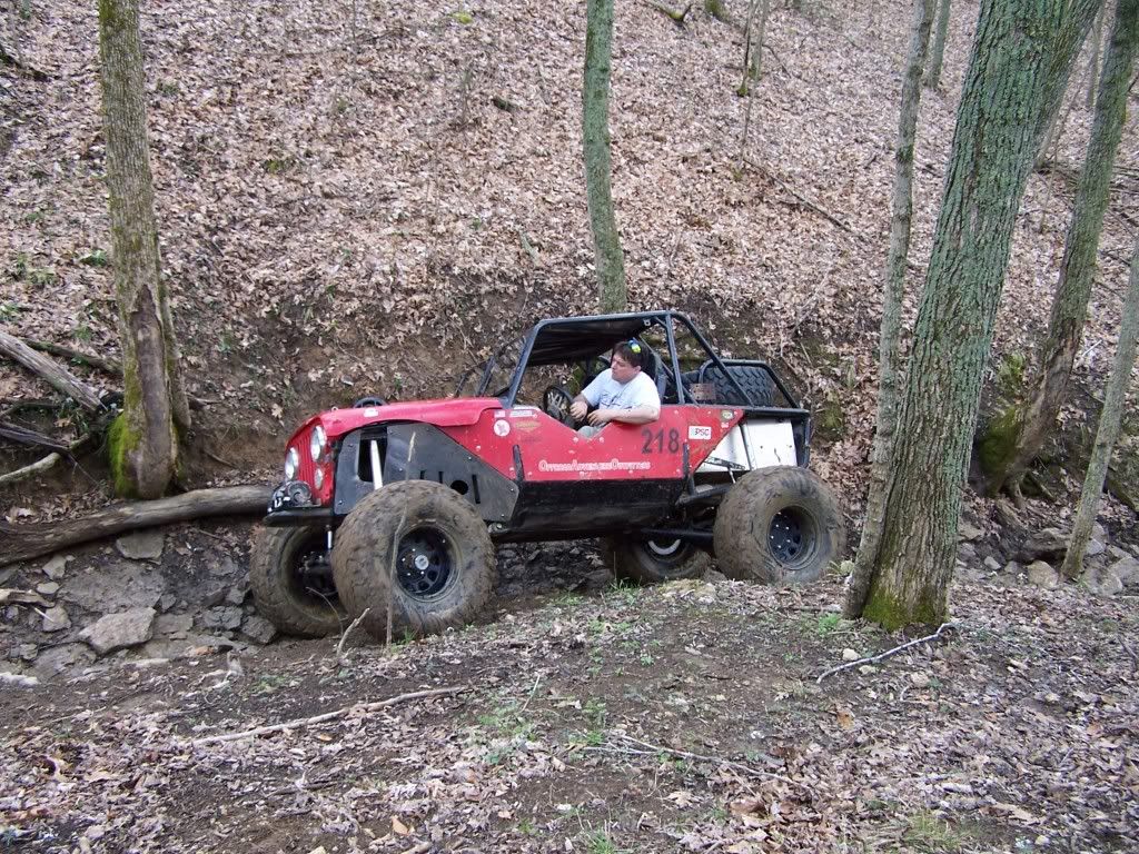

Here are some of the rigs that were in our group.

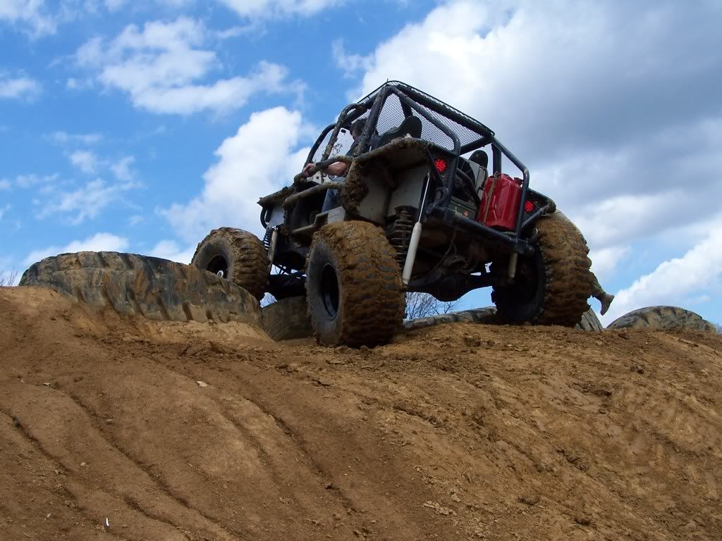

John & his CJ buggie he finished last year. He used to race it in the TREC series at the Badlands. He also is usually the guide for the Hardcore group at Mission Impossible.

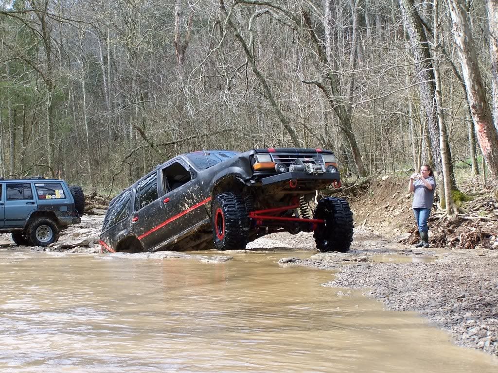

Dale & Judy in their Explorer. Full width axles & boggers, the rear have every other lug removed, it did well in the mud & the climbs.

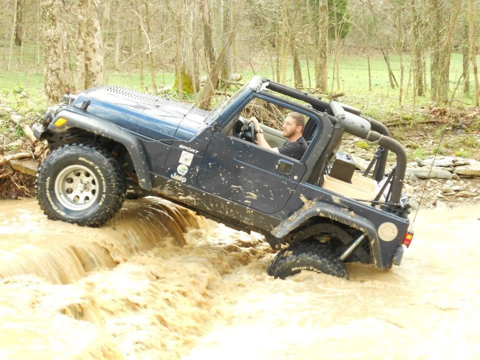

Justin in his JK.

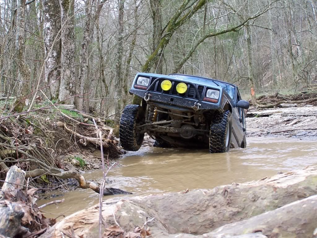

Aaron in his XJ coming up the waterfall.

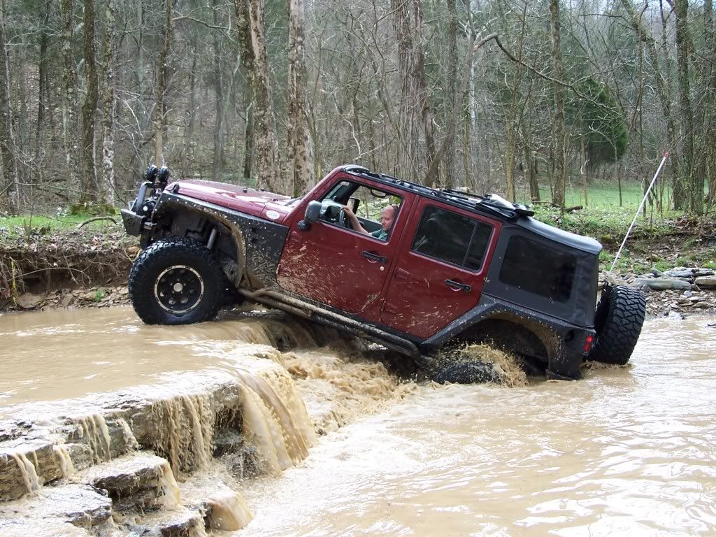

Jessie in his XJ on the waterfall.

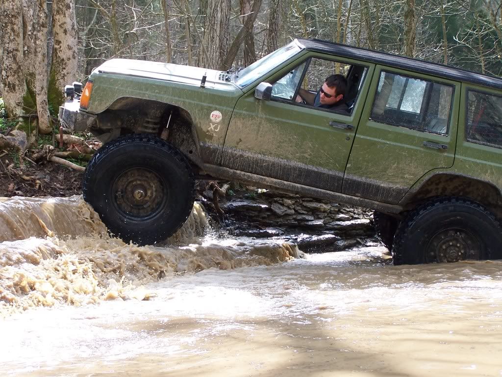

Steve in his, what used to be Bronco. This thing is bad ***. I got a bunch of pics of him. He was our Tim Cameron of the group.

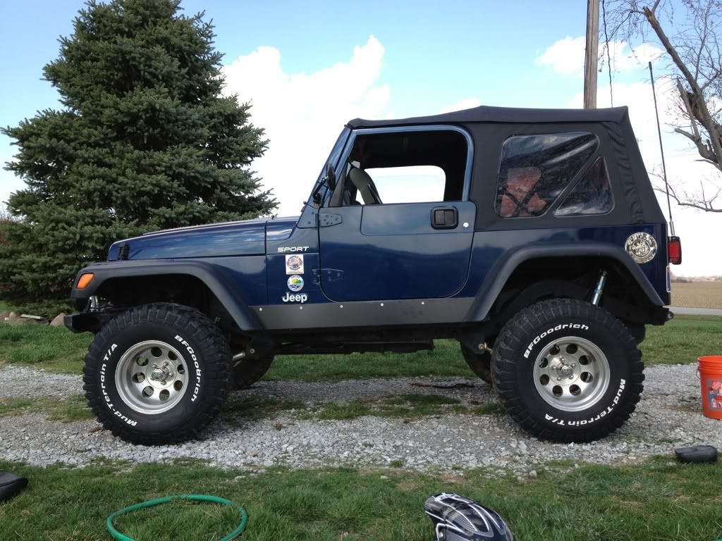

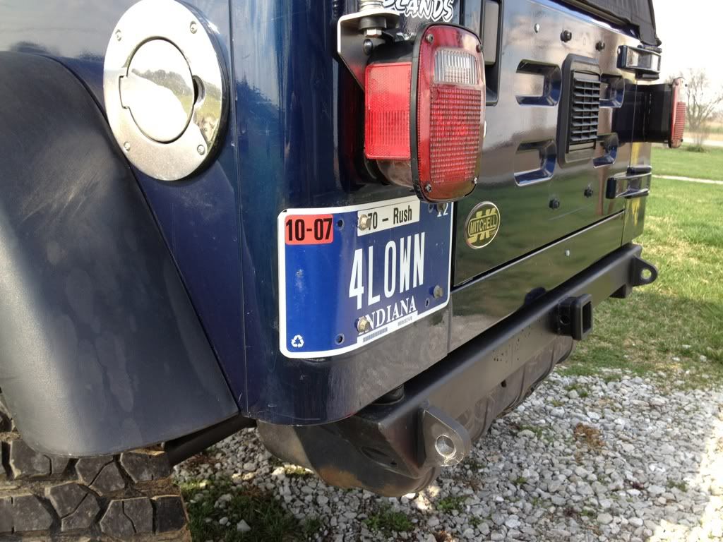

Huge mod when I was cleaning all the ****ing mud off of it on Sunday. Flush mounted the license plate.
Need some opinions on my dragster. Since I put the Bilsteins (+1/2") & the 8.8 swap (+1/2") my *** end sits at least an 1" higher than it did, plus I think the front Curries sagged a little since install as well. They are measuring 15.25"-15.50". The plan is to hiline this thing before the end of the year, but I am undecided if I should replace my 4" rear springs with 3" to get it sitting a little flatter, or leave the 4" in with the hilines making it appear more level. I'm sort of leaning towards the 3" just to get the overall rake back closer to flat. My rear shocks are also sitting at 6.5"-7" of uptravel available, so I have the room to go down to 3" springs & still have approximately 6" split.
God! I really need to paint that ugly *** feul door satin black!

post #74 of 1319 Old 03-20-2012, 08:55 AM
B2CARPEN
B2CARPEN's Avatar
Location: Northern Illinois
Posts: 3,580

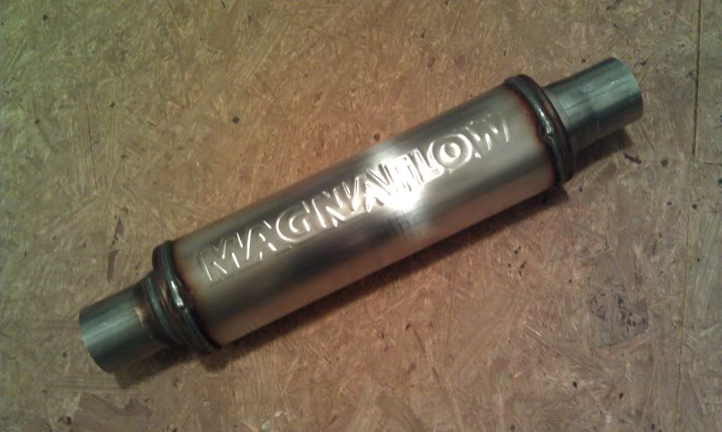

You are going to love the sound of that magnaflow... I love the tone of mine, and how it has a low rumble.
As for your suspension setup, I would definitely consider replacing your rear 4" coils with 2.5" or 3" (if you stay with Currie). I run 4" coils w/ 0.75" spacers up front and 2.5" coils in back and I'm perfectly level. With running coil relocators, wider axle tube diameter, and custom coil brackets I can no longer run matching coils otherwise my *** end will be up in the air like yours.
You will also notice a decent improvement with control and the ride when you level out your jeep. You will shift your weight back to center and have better weight distribution on all four corners.

post #75 of 1319 Old 03-20-2012, 08:58 AM
AngryTJ
AngryTJ's Avatar
Posts: 4,468
I think you should def adress the coils because even with front hilines itll still look *** up
