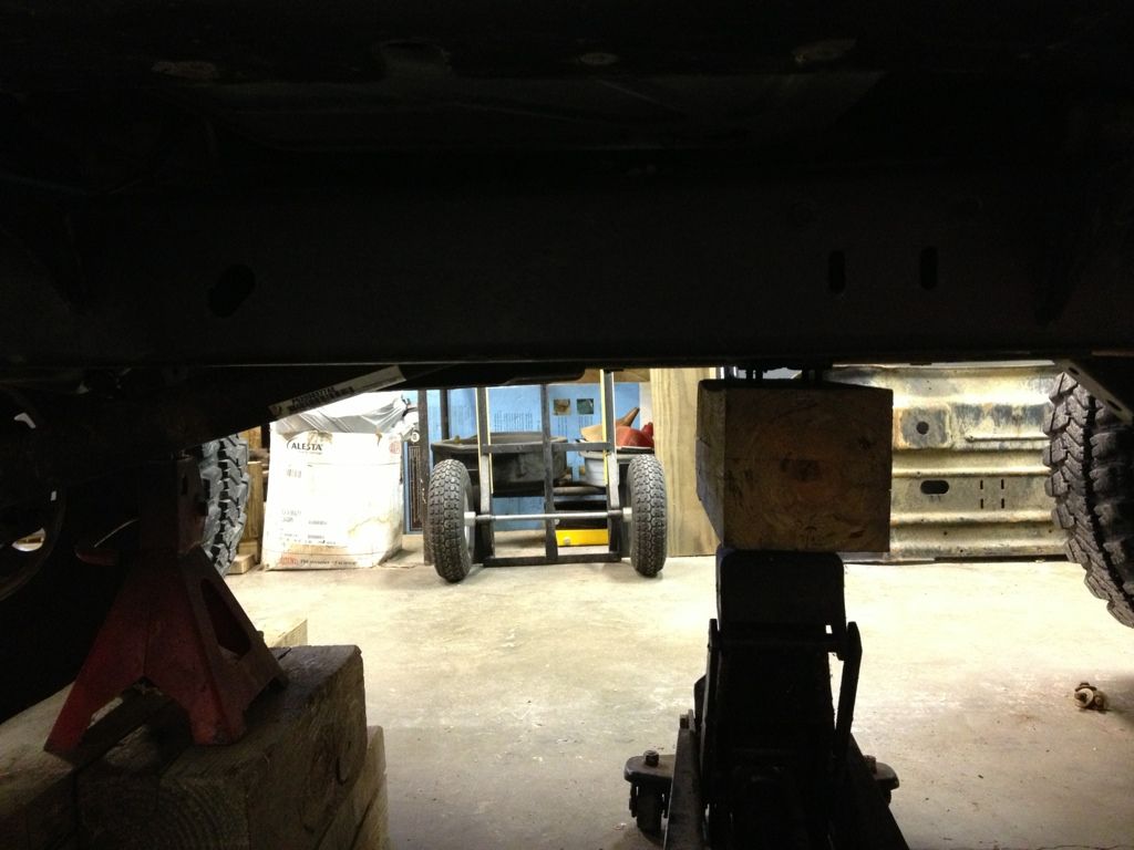

Got the motor mounts in last night & started playing around with the tuck. That damn tranny pan is the limiting factor right now. I'm about 1/2" from getting the entire belly flat. I'm pretty sure I can get the TC skid flat to the rails, but may need to space my engine skid down a 1/2" or so, which pisses me off. I'm pretty sure I have the tub clearanced, but it just won't go up any higher. I can't tell what's hitting. I thought the motor mounts might actually be binding. They're tweeked pretty good. I could also use another 1/2" of motor lift. My fan is less than 1/8" from the shroud on the bottom. I may order some 1 1/2" brown dogs & that would pretty much get me flat I think, but I will probably have to do some major sheet metal work at the tunnel at the firewall. Here is where I left it last night.
Tonight I'm going to throw the lopro on & the flat skid & bolt everything up & see what we have.

That's pretty damn flat Danno! About 1/4 below the rail.
