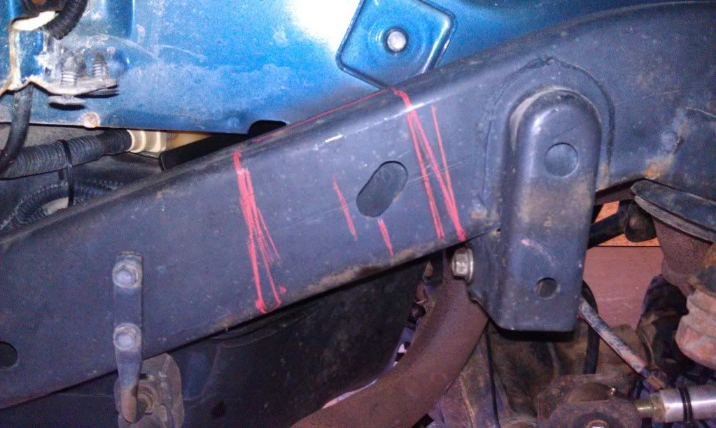

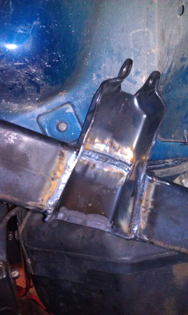

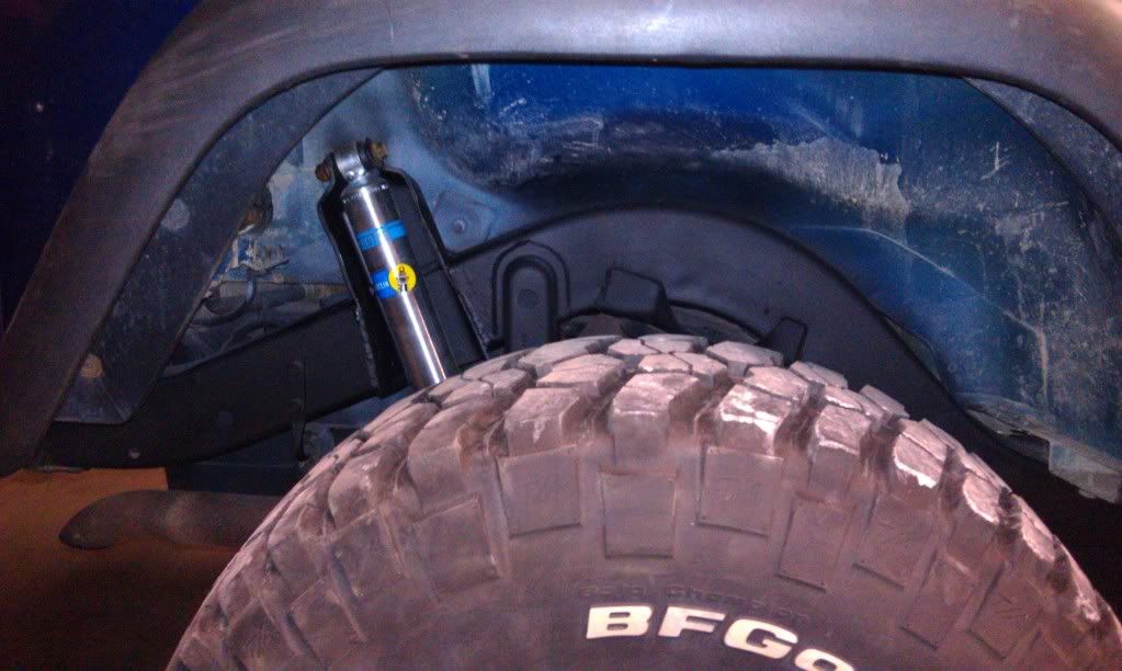

Marked the frame & notched it friday night. I didn't go exactly 90 to my lower control arms because I was planning ahead for when I 4 link. The shocks are tilted back about 17 from vertical. 90 to my current control arms would have been closer to 23.

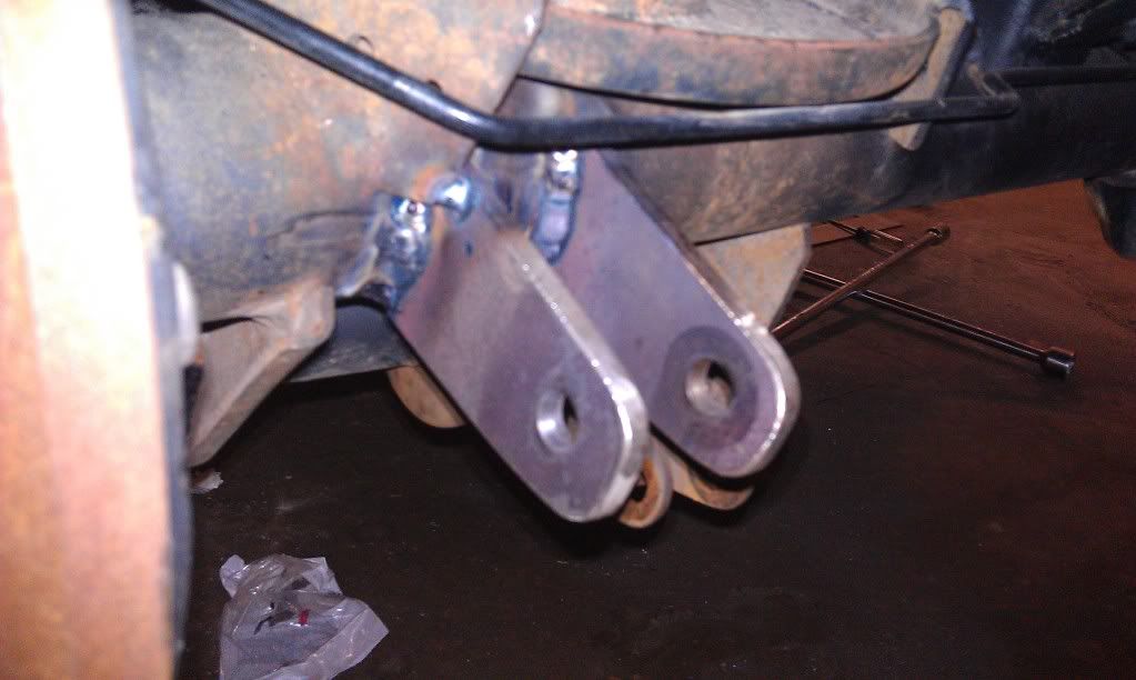

Seeing as how Poly sucks getting things shipped lately, I had to make my own lower tabs. They will get a phone call today espescially seeing as how I paid for expedited shipping to have them by Friday. Not bad for a grinder & a cuttoff wheel.

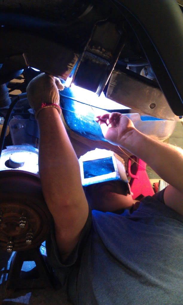

My brother in law came over saturday night & welded everything up for me. It's all tig'd. It's funny watching a fat man try to contort himself around axles, gas tanks, frame rails & jack stands to make all the welds.
I made one big boo boo. Just a big brain fart actually. Once I made the flare cut on the front of the frame rail I took that point straight back rather than taper it back to 4" on the inside of the frame rail. So once I hammered the tower sides out, there was a hug gap in the back. I just cut some small pieces to lay over the hole & he welded them up.

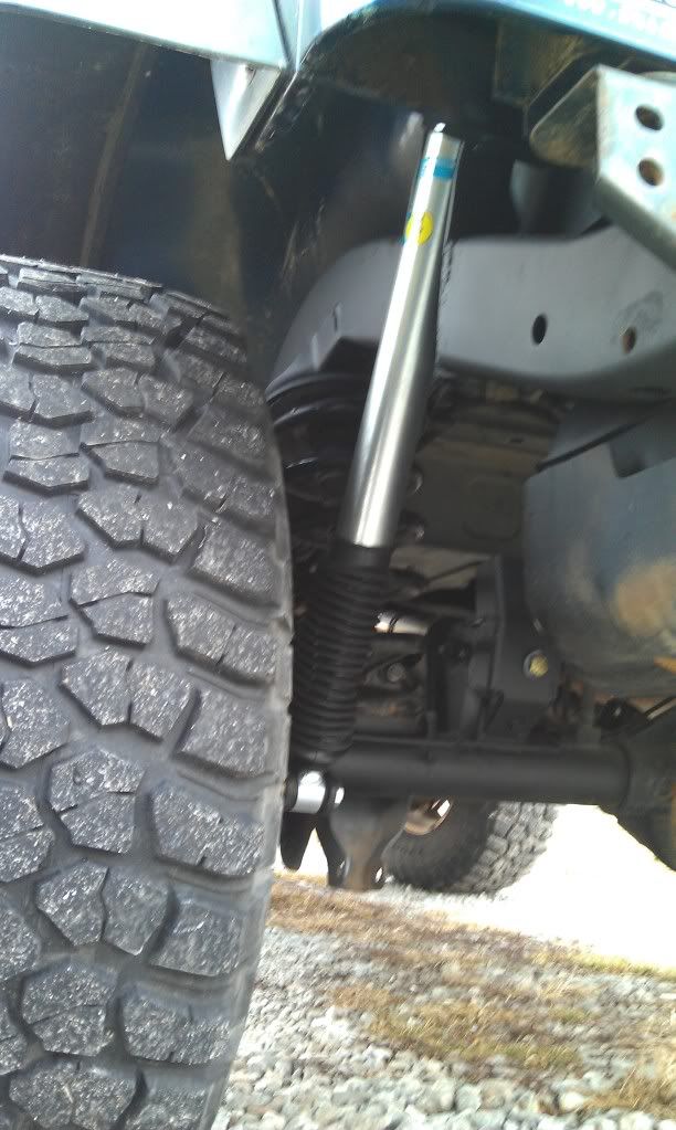

All done & mounted. I left the boots on, we'll see how long they last.

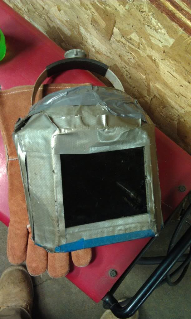

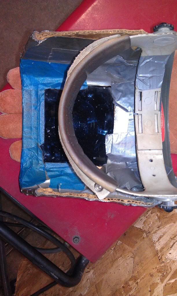

Here is a pic of the sweet low clearance welding helmet. Made of cardboard & duct tape. It's smaller & the cardboard is more flexible to weasel your head into things like race car chassis etc.

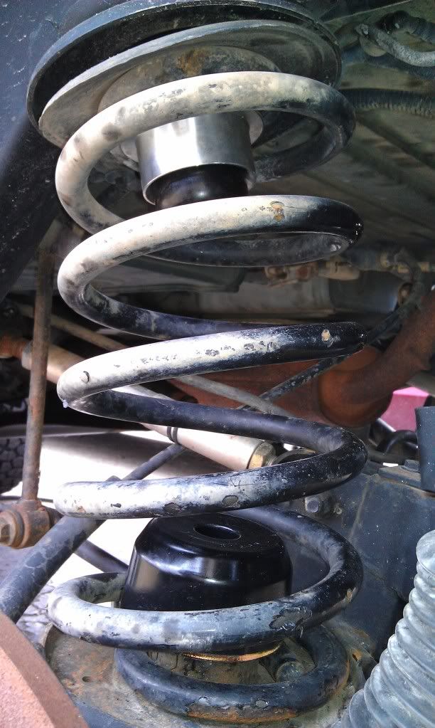

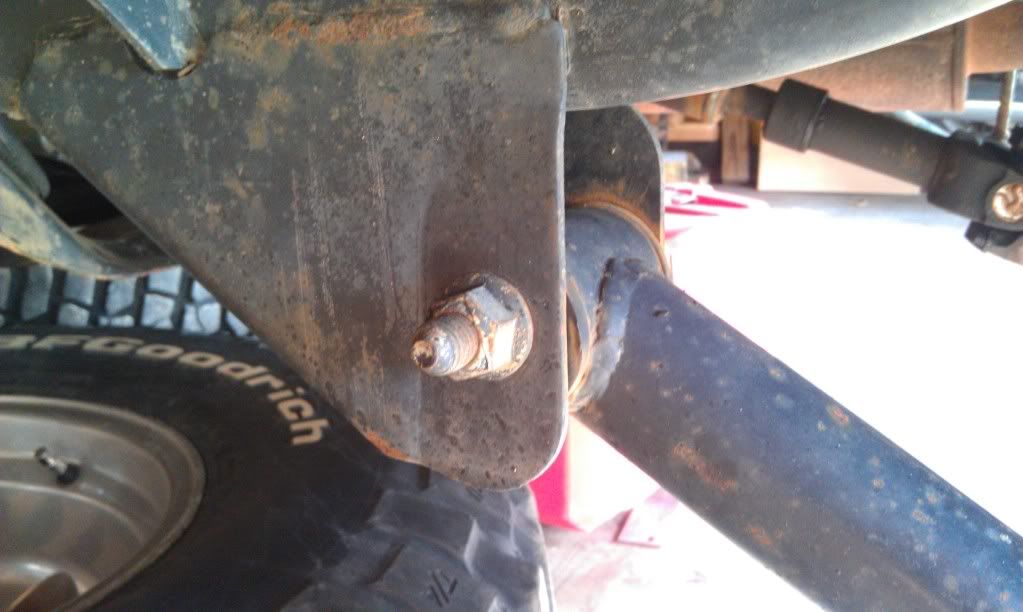

All in all the only thing I had trouble with was figuring out what to do with my travel. I currently have 7.5" up until my rear track bar hits the tank/crossmember & 3" of droop. After talking with Connor, we decided that even though I only get 3" of droop now & my current 4" RC coils would unseat at around 4" of droop, when I upgrade to Currie Progressives I should get another couple inches before they unseat. So I set it up for 6" up & 6" down. I will also need to get on some bump stop work quickly. Next wheeling trip is the 18th in Attica. I also need to get some new lower control arms by then also. Drivers side bushing is toast. Might be hard to see int he pic but that bolt is WAY off center. It's causing the axle to be about 1/8" out of square & giving me my pull to the right.

To layout, cut the frame & make the lower shock tabs took me about 6 hours on friday. 2 of those hours was layout, mainly because measurements weren't jiving on both sides of the jeep, so it took me a while scratching my head to come to the conclusion the frame was screwing with the angle finder on my cell phone.
Saturday was weld day & it took a loooooong *** time for him to weld everything up. Mig probably would have went a hell of a lot faster. We started welding about 6pm & I was final mounting shocks at midnight.
One final note. Make sure your shock bolts fit into the ford towers BEFORE you weld them on the frame. Caught one in time, but had to dremel the one side a little to get the bolt in because the drill couldn't get to it.

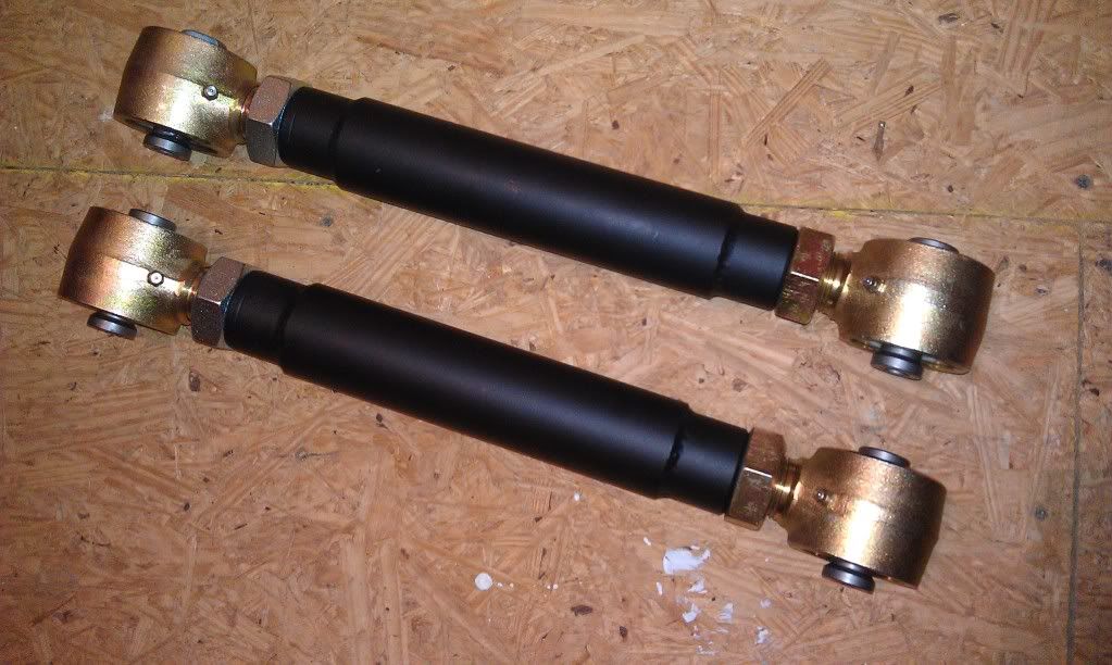

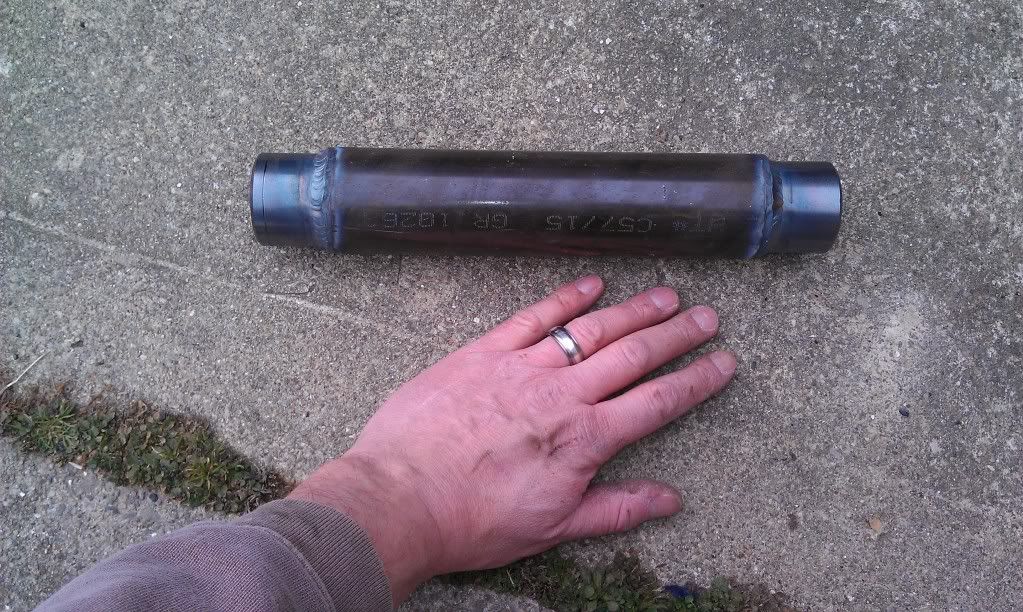

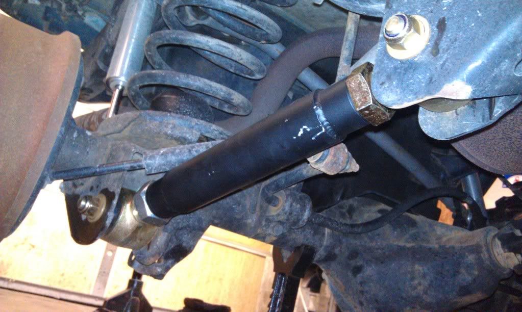

Got the new lower control arms all mounted up last night. Man were my RC arms SHOT! The sleeve in the bushings on the frame end would just fall right through the bushing. Needless to say the ride is much tighter. Only arms I have left to replace are the stock front uppers. I'll work out a plan for those before too long. Anyway, on to the eye candy.
We cut them to length 8 1/4" & squared the end in the lathe.

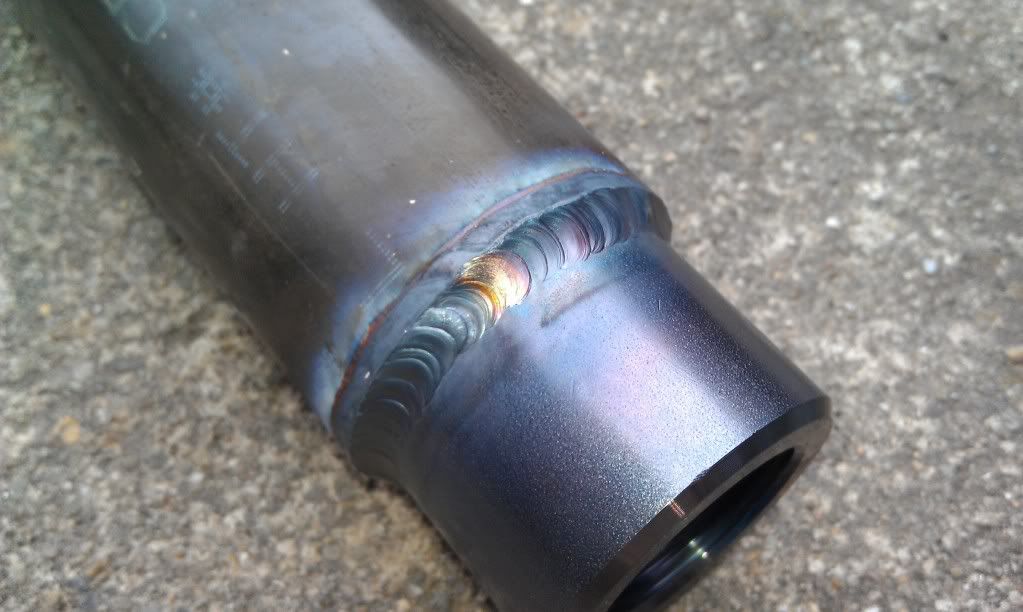

My bro-in-law laid down some sweet ****ing beads!
Total length of the arm. He's just a little guy.
All dressed up & waiting on grade 8 hardware!
Installed!
Rear axle is now perfectly square. No thrust angle that I can measure. Jeep still pulls ever so slightly to the right, which is good because if I fall asleep at the wheel I go into the ditch instead of head on traffic.
