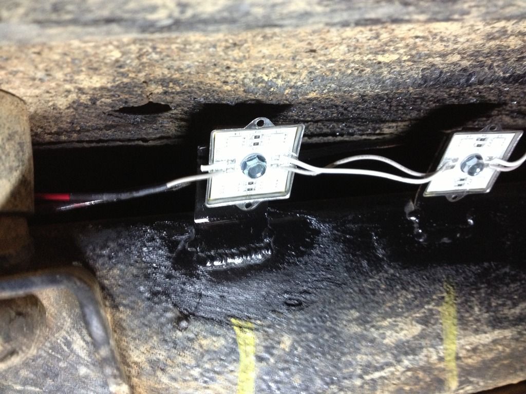

So first up just so there is some tech in here are my LED rock lights. I've been running rock lights for years as we do tend to have a blast riding at night. I originally installed 4 Walmart 55w fog lights (~$20/pair). Simple wiring through a relay with 1 light on each side. This worked great for a while, but it was a pain when bulbs burned out, and running 4 halogens +headlights +electric fan made my charging system less than happy.
Here's a shot with the old lights *edit* Found a better pic with all the lights working.
I picked up a string of LED light pods from a vendor on another forum to install under the Jeep and replace the halogens. I got 20 lights for ~$30 (there are lots of options available, and some for a better price). I broke them up into groups of 5 lights to mount on each side. Since I already had lights installed on the sides, and front and back I was able to use all the existing wiring. I just needed to mount the lights and add a connector to the end. The lights are in strings so you only need 1 power and 1 ground for all the lights in a group to run.
I started on the sides and welded small tabs near the top of the frame for each light. These lights have a hole through the middle so I used a self drilling screw for each. They also had double sided tape for extra security.
5 on each side gave me this. You can also see the color difference with the halogen up front (and the rear is burned out in that pic.. lol)
In the front and back I made a mount out of 1/8" strap steel and some more thin tabs. I bolted all the lights on these and installed them with self drilling screws front and rear. Apparently I never took any pics of these so I'll just leave a spot here so I can add a pic later.
Here is the end result with all 20 lights installed. It lights up even better than the pic shows. I guess the stack of wheels by the Jeep isn't helping anything either. In any case, plenty of light, and very low amp draw on the charging system. Between these and my LED light bars I should be able to light up the night. I'm sure they will get a proper test next month in Harlan.
