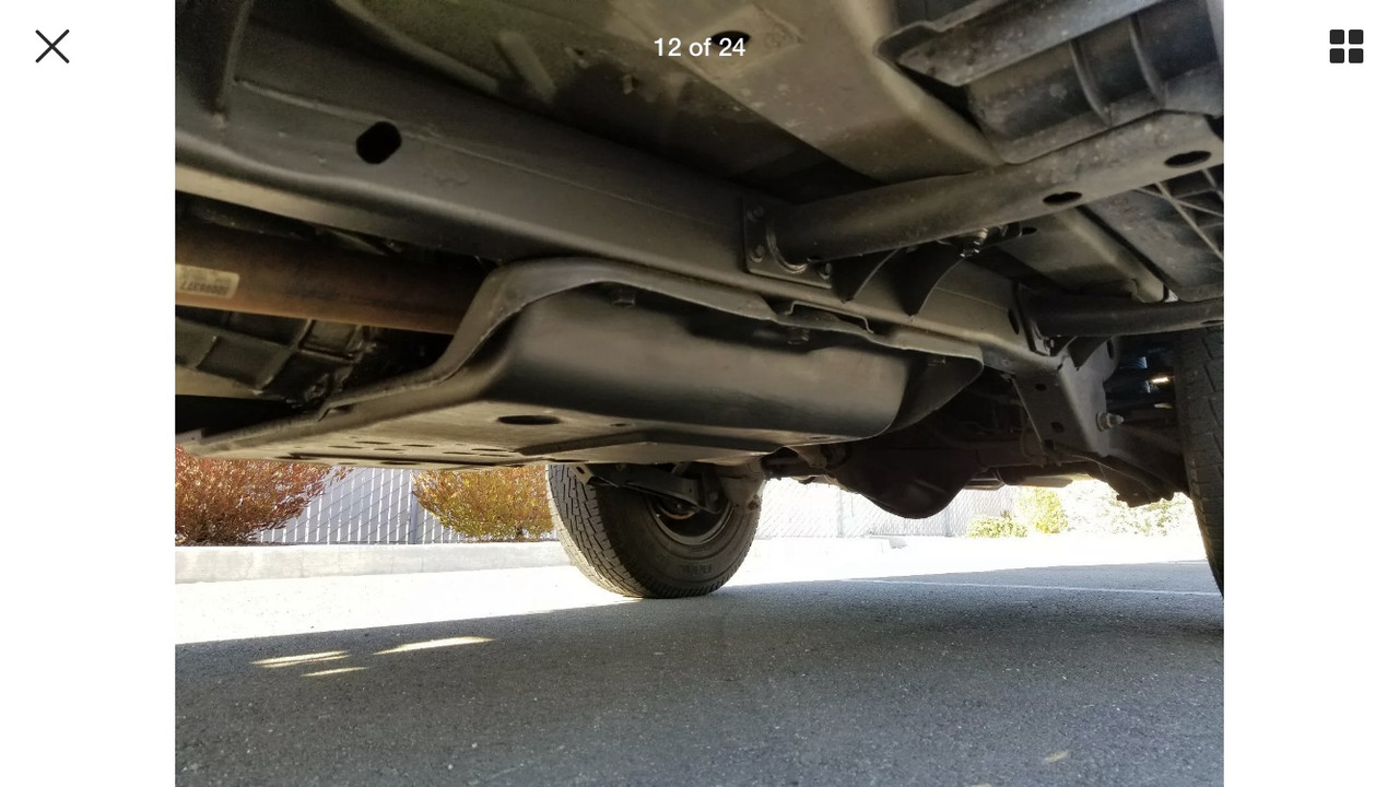

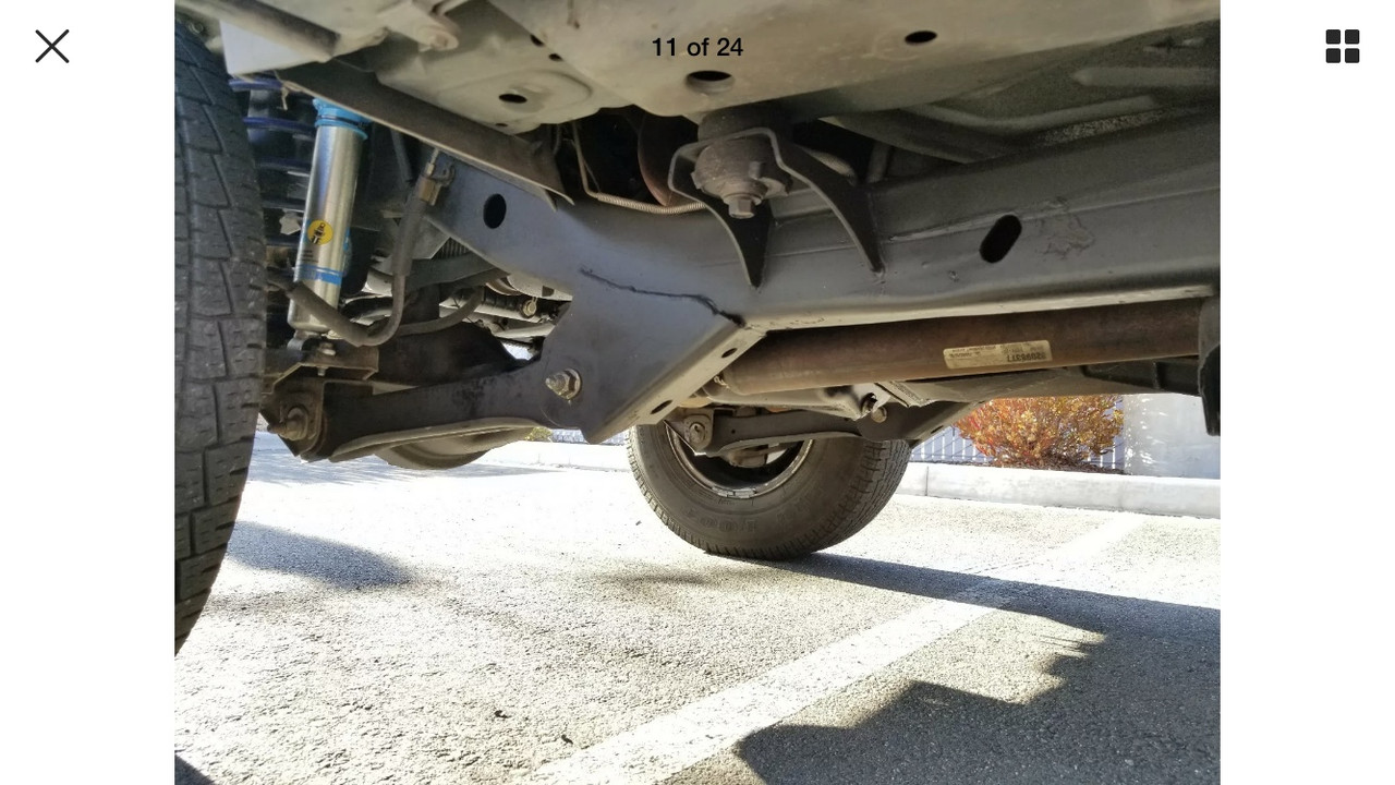

Here are some more shots of the underside, the interior, and the night I picked it up from the shipper.

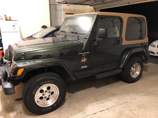

Here is the first day I got it registered:
I'll have to get used to the Jeep wave, since nobody waved to me in my XJ.
My goal is to build something like this, which is a picture I stole off Google, apologies to the owner if he is on here for stealing the pic:
The Jeep already has 1" H&R lift springs, which according to the tape measure have lifted it anywhere from 1.25"-1.5" over stock. It also has brand new Bilstein 5100 shocks all around, and rides perfect, so I'll likely stay at this height at least for now. The tires are round, but other than that they have zero redeeming qualities, and are getting replaced with some BFG All-Terrain KO2's in the 31x10.5R15 flavor. I'm not the biggest fan of the Gambler wheels, so I have (5) almost brand new condition 15x8 TJ canyons on the way.

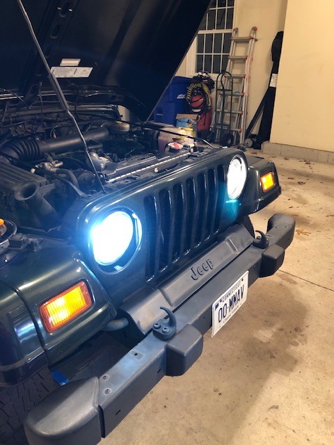

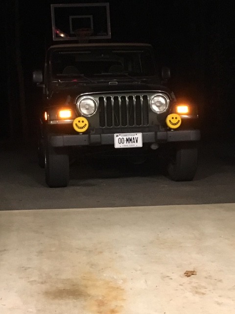

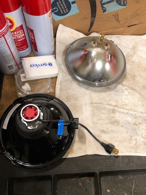

When I drove it home the first night from the shipping drop-off location, I immediately remembered how much my stock headlights sucked in my XJ. By the time I sold the XJ I had an upgraded harness, IPF H4 housings, and some Hella 80/100 watt bulbs. For this Jeep, I went a bit of a different route with IPF H4 housings and LED bulbs. Normally I wouldn't put LEDs in a housing meant for halogens, but the sharp Euro spec cut-off of the IPF housings and the fact that I won't be driving this everyday made it okay in my mind. It was a bit trickier to aim, but I was able to make it so the lights did not blind oncoming cars, and tested it several times with friend's vehicles. Overall I'm happy with the upgrade considering the bulbs were $40 or so and the housings were around $60 each.

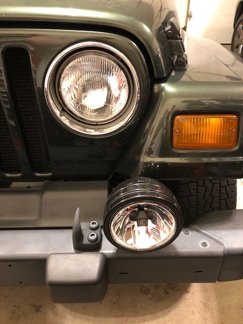

One of the stock fog lights wasn't working, and when I went to replace the bulb I found that the glass had cracked.
I plan on replacing the glass at some point and rebuilding the fog light, but for now I decided to upgrade to LEDs, with some LED KC Daylighters mounted in the stock location using the stock fog light switch. I plan on wiring the stock fog light relay to get power from the high beam circuit, so the daylighters will come on with the high beams, since they are way too bright to be used with the low beams as fogs and would definitely blind other drivers.

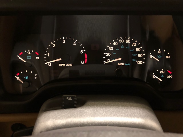

Three things that really annoyed me about driving this (dash wise) were the gauges being dim, the annoying shift light, and the seat belt chime if you started the Jeep first without the belt on. The shift light in my mind is pointless. If I followed that I'd be in 5th gear at 20 mph at the start of every hill here in Connecticut. I pulled the dash, put white LEDs in the gauges, pulled the shift light, and pulled the beeper thing out from the back. Took about 30 minutes to do, and makes driving it much nicer.
The LED bulbs for the gauges are a #74, and the beeper is only held to the back of the dash with 2 contact pins. I was able to easily "break" it off the cluster with a set of needle nose pliers.

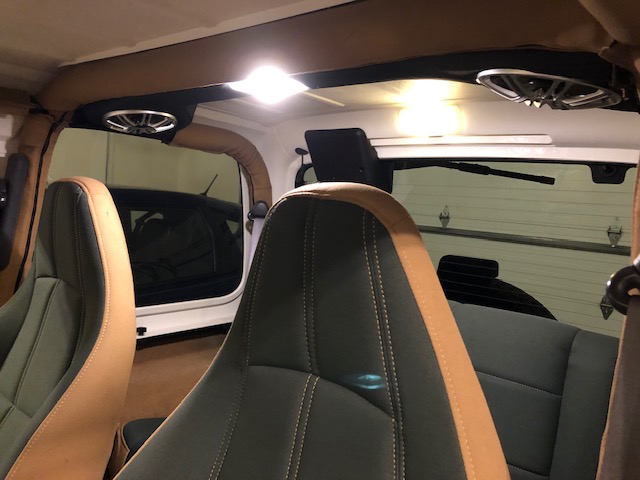

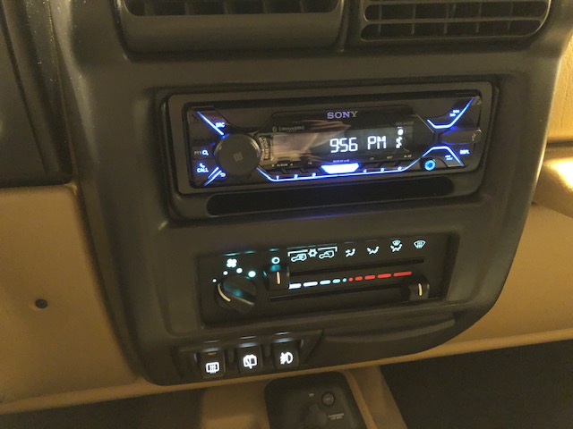

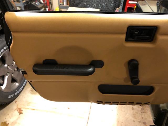

Next up was the factory sound system. There was a failing rear speaker, and it still had the stock cassette player. I replaced the cassette player with a Sony DSX-A415BT bluetooth capable head unit I got on ebay, and the speakers with Polk Audio marine grade. The rears are 6.5" Polk DB651 and the fronts are 5.25" Polk DB521. I used the Select Increments speaker pods for the front, and it sounds MUCH better. Very clear, and the bluetooth option makes listening to music/navigation on my iPhone a lot easier.
Be aware that if you install the front speaker pods on an earlier TJ, there is a metal strap that needs to be cut out of the dash to fit the pods. When the directions state you need a "good" set of tin snips they aren't kidding. Mine were too old and dull and I had to get better ones from the hardware store.

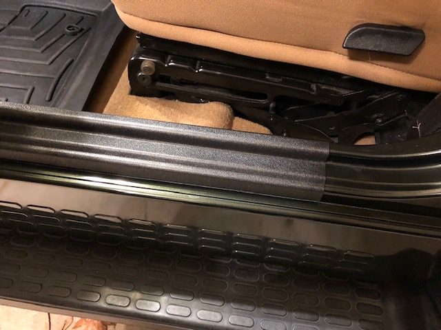

I also installed the Fairchild Industries entry guards to protect the area that seems to get kicked a lot by passengers when they get in and out:
And a friend got me the Misch door arm rests which are a great add-on for highway crusing:

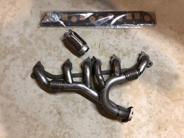

The manifold came in. I ended up ordering it for $100 or so on Amazon. Stainless steel with the improved design with the bellows, and gaskets/hardware. The gasket looks okay, but I ordered a Fel-Pro one just because I've had good luck with those in the past. The manifold seems to be of pretty good quality, and the welds are pretty good. The reviews all seemed to be good.
I also bought a stainless steel flex joint (6") I will add downstream in the exhaust between the manifold and the cat converter. From what I've read this combined with the improved manifold seems to be the best bet on preventing cracking in the future. The motor mounts are new also, so hopefully I won't have to worry about this for a while.
