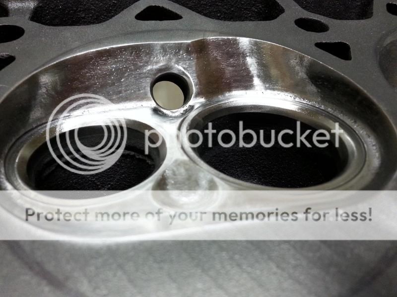

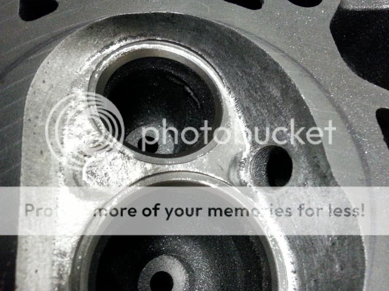

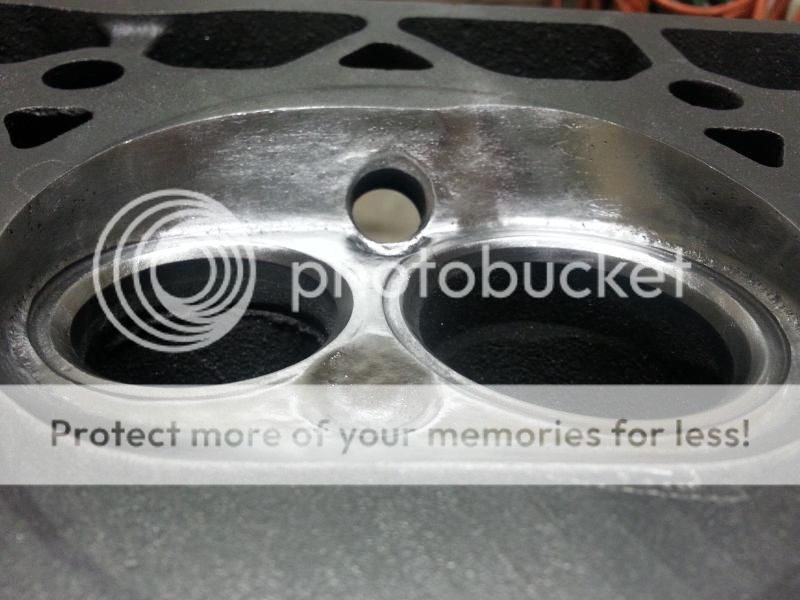

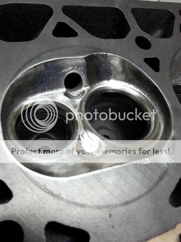

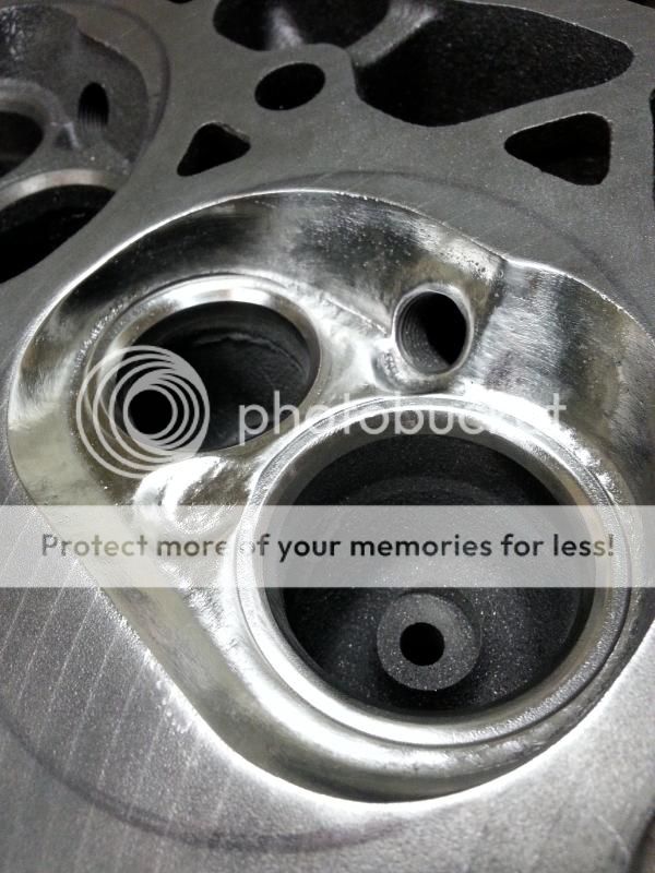

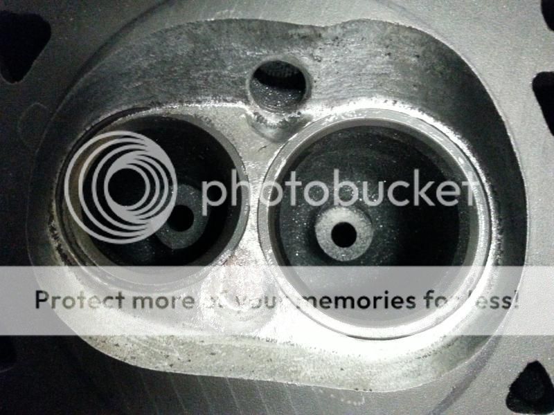

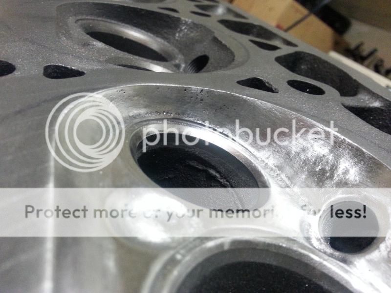

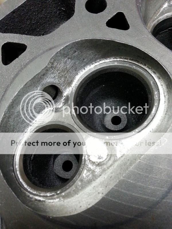

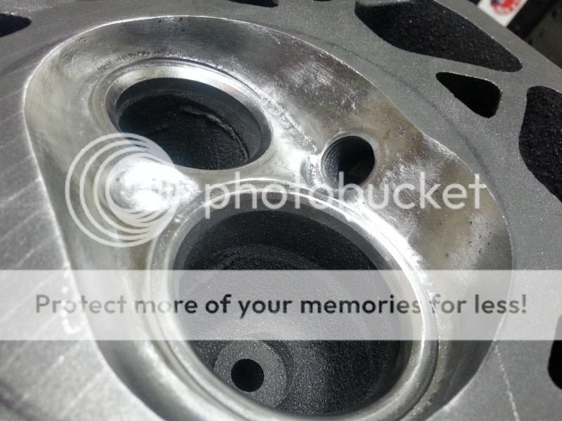

Made more headway on the number 3 combustion chamber, here's a few pics to show the progress and different appearances along the way...
Unshrouding the outer walls around the valves (since I will be running oversized valves) and deburring the rough cast...
Smoothing out the roof and walls with 80 and 120 grit cartridge rolls...
Then using medium and very fine grit cross buffs to achieve a polished look...

A lot of people will stop after 120 grit cartridge rolls which is perfectly fine, but taking it to that next level by polishing with cross buffs removes the deeper scratches and glue marks left behind from the cartridge rolls and blends it all into a smooth finish.
The exhaust ports will get a similar treatment to keep hot gasses moving at max velocity. The intake ports will only get the 120 grit cartridge rolls for the final finish since you need to leave some texture to the walls to promote air / fuel mixture. The air flow velocity of a mirrored finish port compared to a rough textured port is within 1%, so going any further than a cross buff (polishing compounds and bits) is a waste of time.
