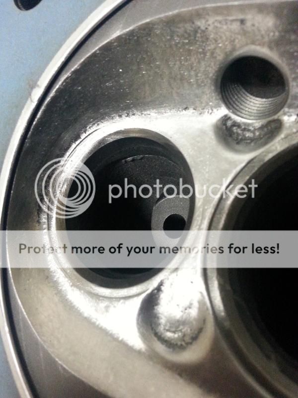

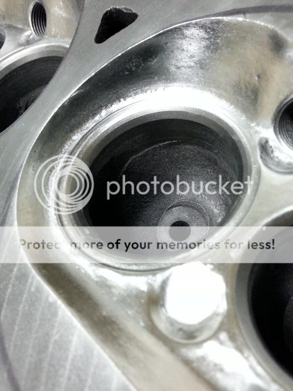

I began working on the cylinder head and starting in the combustion chambers. It took me a while to get a good technique down since this is my first port & polish job but it became easier as I got use to the carbide cutting tips and sanding cartridge rolls.
Here's a pic of an untouched chamber for reference, you can see all the casting flash and burrs throughout the surface...
Those craters and sharp huge ledges not only cause poor air flow, they also create hot spots that can cause pre-detination (pinging) with higher compression ratios. I plan on smoothing out each chamber and then match chamber volume (cc's), then perform a final polish buff.
Here's some progress I made on chamber #2...

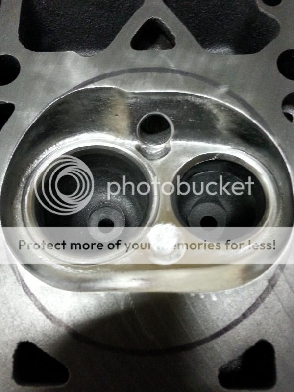

I now have two combustion chambers smoothed out and 4 more to go. I keep going back to chambers ive been working on to do more final touches as i pick up new techniques and gain confidence. This is definitely an artform and this is why the experts get paid the big bucks for port / polish head work. I'm 5 hours into this and I've already learned more than I did when I first started, and that's after hours and hours of reading about other DIY'ers does and donts and watching techniques on youtube (aussie heads, jafromobile, headbytes porting <-- this guy knows his ****).
In case anyone wants to do the same and is wondering what I'm using for this job...

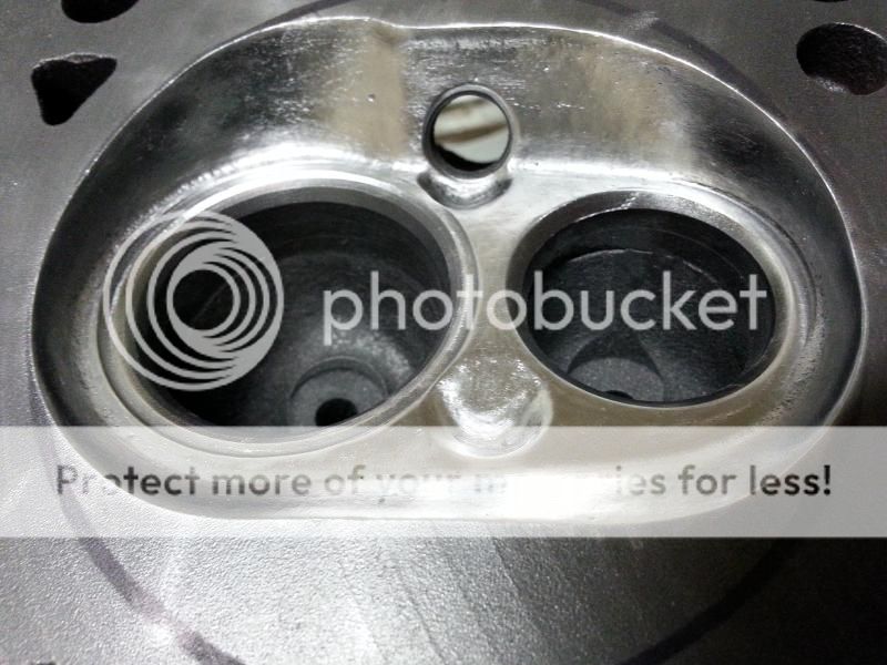

Spent some more time shaping chambers #1 and #2 to get a good base example to follow for the remaining chambers. The key here is smoothness and airflow, removing all corners and angles and attempting to get a swooping effect around the valve seats. If you compare these pics to the last pics you will be able to see the progress and changes made...

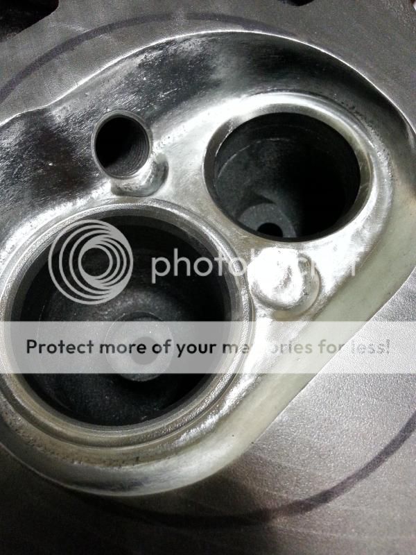

So I've been continuing my progress on the combustion side of the head, I swear after a few hours of staring at these chambers I begin to feel like they are staring back at me lol.
Look at this friendly looking little face...

I just purchased some standard abrasive cross buffs from summit racing. 20 medium grit and 20 very fine, all 1" diameter. These will transform the chambers into an ultra bling polished finish, even moreso than what I posted previously.
I have 3/4" med grit powerhouse cross buffs will aluminum oxide material that helped get the semi-bling finish currently, but the larger buffs will finish the job much better and remove those small fine scratches.
