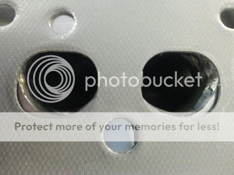

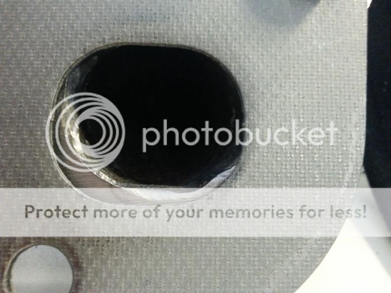

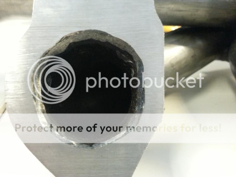

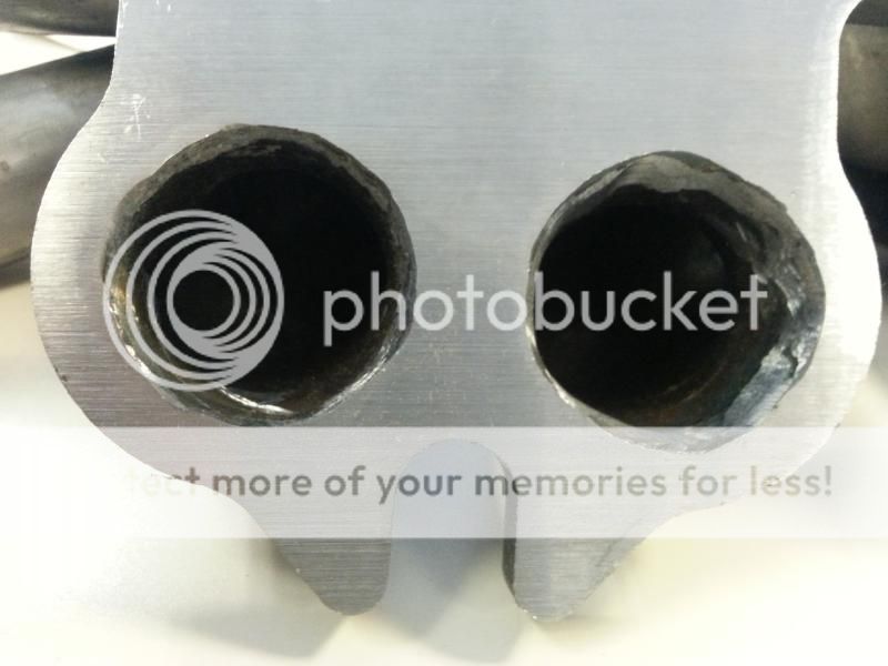

I'm at work and I'm wrapped up in some projects, but I will get some pics posted as soon as possible. Everything looks decent from the frontside of the headers, but the backside of the flange is an absolutely joke!!!!!!!!! It appears that some drunk guy took a dremel to the inner welds to attempt to "smooth them out" which only made things worse, the flange openings can't even be called circles at this point, and to top it off, the gasket that was provided doesn't even come CLOSE to lining up with the exhaust ports!!
I will be speaking to the company that sold this pile of **** to me later today to find out if all JBA headers are like this or if I was the lucky one to have mine built on a Friday @ 4:55pm

Well here are the pics that show what I'm talking about, unfortunately I can't find any pics online to compare to, to verify if these are truly JBA junk or a terrible knockoff. Ordered online via ebay from a seller with good reviews, but I did find it funny they asked for feedback the day after I bought them before they were even shipped. And they have a company note in a slip on the package requesting that feedback not be based on the product but their performance delivering the product. Who knows, but what I do know is that these are not getting bolted onto my engine...
Every port looks just like this, and the gasket would require major modification to get it to match up. Smh

I'd try to contact the manufacturer with those pics and see what they say. If there a knockoff or fake I'd contact the seller for a refund or dispute the charges. If JBA says that's what they should look like I'd be looking for a return and a new brand. Maybe take them over for Tony to see he might have an opinion

I've already emailed the seller to request a full refund with pictures attached and also mentioned that I still haven't provided feedback yet, and it will depend on how smooth the refund transaction goes (with a pre-paid return shipping slip).
No joke, they actually just emailed me back with a pre-paid fedex return lable and said the following...
I am very sorry to see these images and the hack job of a smoothing that JBA did to the header and passed it and shipped it to us as a quality item. I believe my two year old daughter with a dremel could do a better job. That is 100% unacceptable by any means. I will be emailing you a prepaid label to send this item back to us with.
This made me laugh and also made me feel much better about the seller. I do admit they have been excellent besides the crap product, and it that's truly the way these JBA headers come then why aren't people throwing a **** fit over these?!?! Even my girl could tell that's not right when I showed her pics lol.
