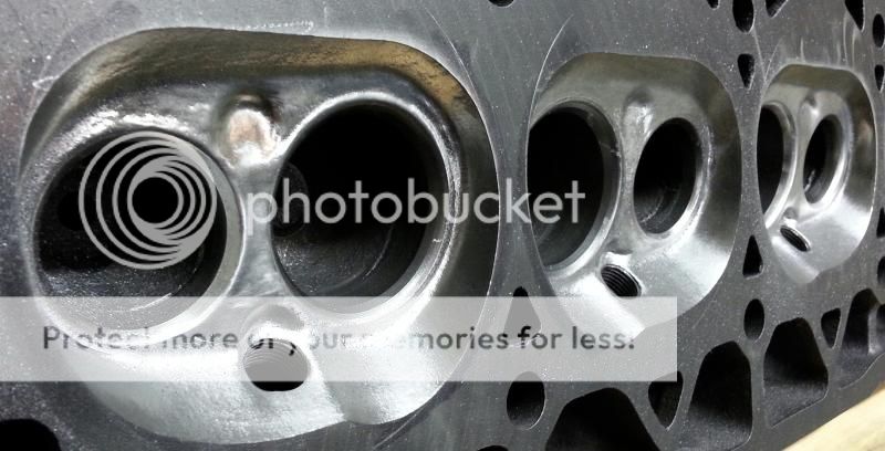

So I've been matching chambers 1 - 4 with my second revisions and I'm realizing how ridiculous my prior cuts were lol. You can tell from some of my prior pics how wavy and uneven the walls were after polishing, especially the pitch from the valve seat to the outer parameters.
Rod, you might want to start with making small adjustments at slower speeds to really get a feel for the carbides, especially when transitioning from the 3 and 9 o'clock positions to the back side of the chambers. I will take some pics to show what I'm talking about in a bit.

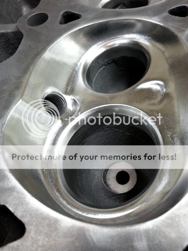

Matching and reshaping the chambers, notice how I did a better job keeping the walls even and smooth...

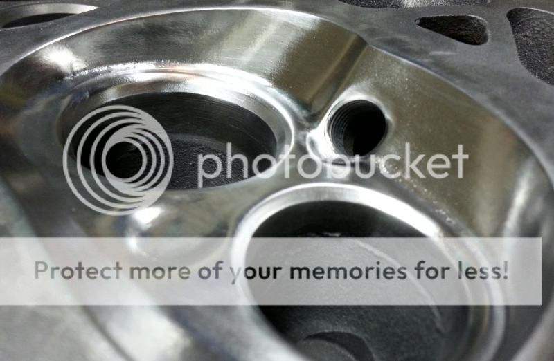

Sanding and polishing does wonders... almost finished with chamber #4...
