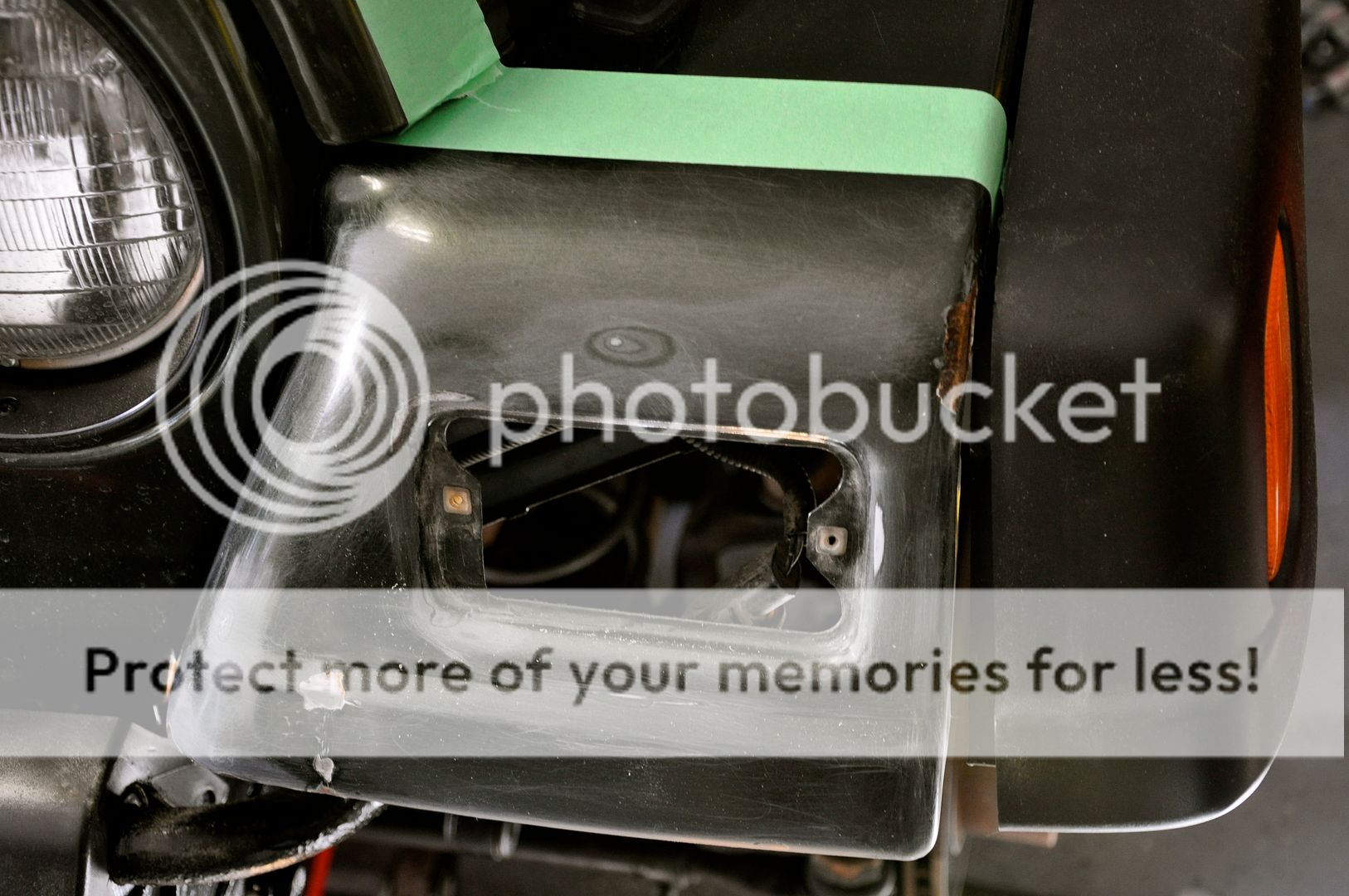

Took off the fenders to repaint and removing the stock steps. Also cut off front bumper jugs

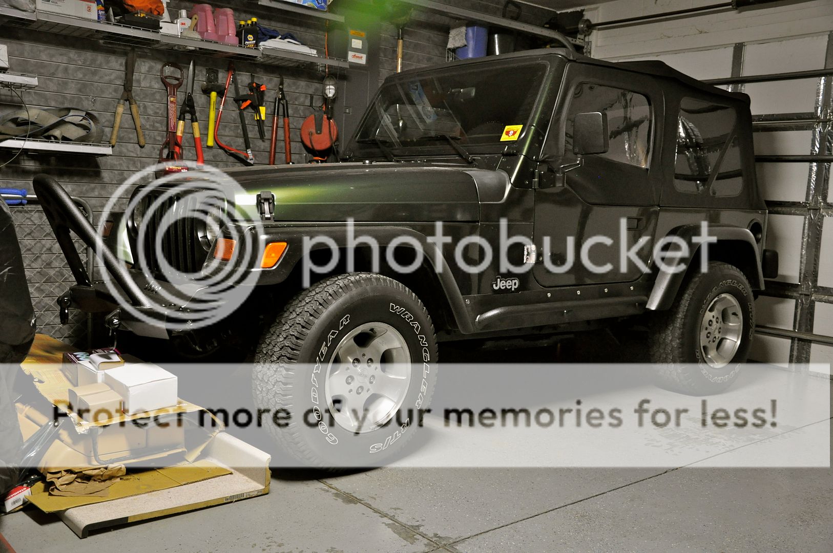

Home in the garage for the first time. Took off mirrors and wiper blade arms and sanded and repainted. Let the money spending start. Did alot of tune up things like plugs, cap and rotor, new battery, O2 sensor, TPS, valve cover gasket etc...............

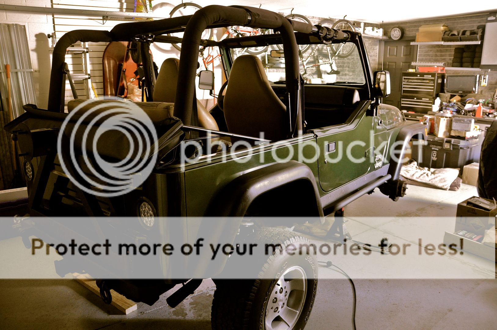

So after putting a black top on I decide I wanted the interior to be black (slate) so I purchased a dash out of a wrecked 06 TJ to install.

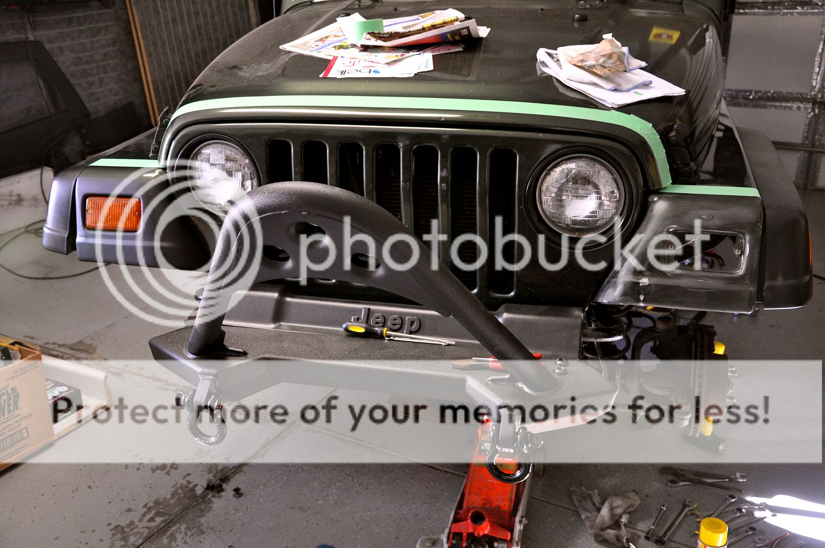

Painted the headlight bezels black with Krylon Fusion. And took off the front bumper to expose the rust under it. Ground it down and repainted, then installed smitty bilt stinger.

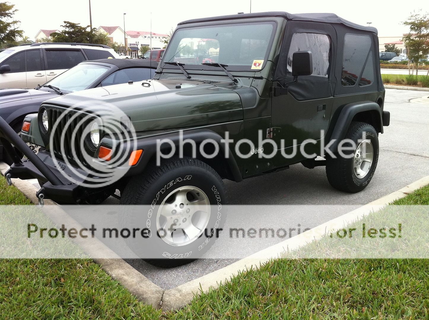

A couple posse shots while I use the jeep around town, still need to get it off road
notice the Zombie permit on the windshield, it was around this time I read the Thread on this site about having a Jeep ready for a Zombie Apocalypse and had to have one. It also gave me a direction for my build and at this time I ordered all the free catalogs I could to start looking at what parts I could buy and possibly some I could fab.

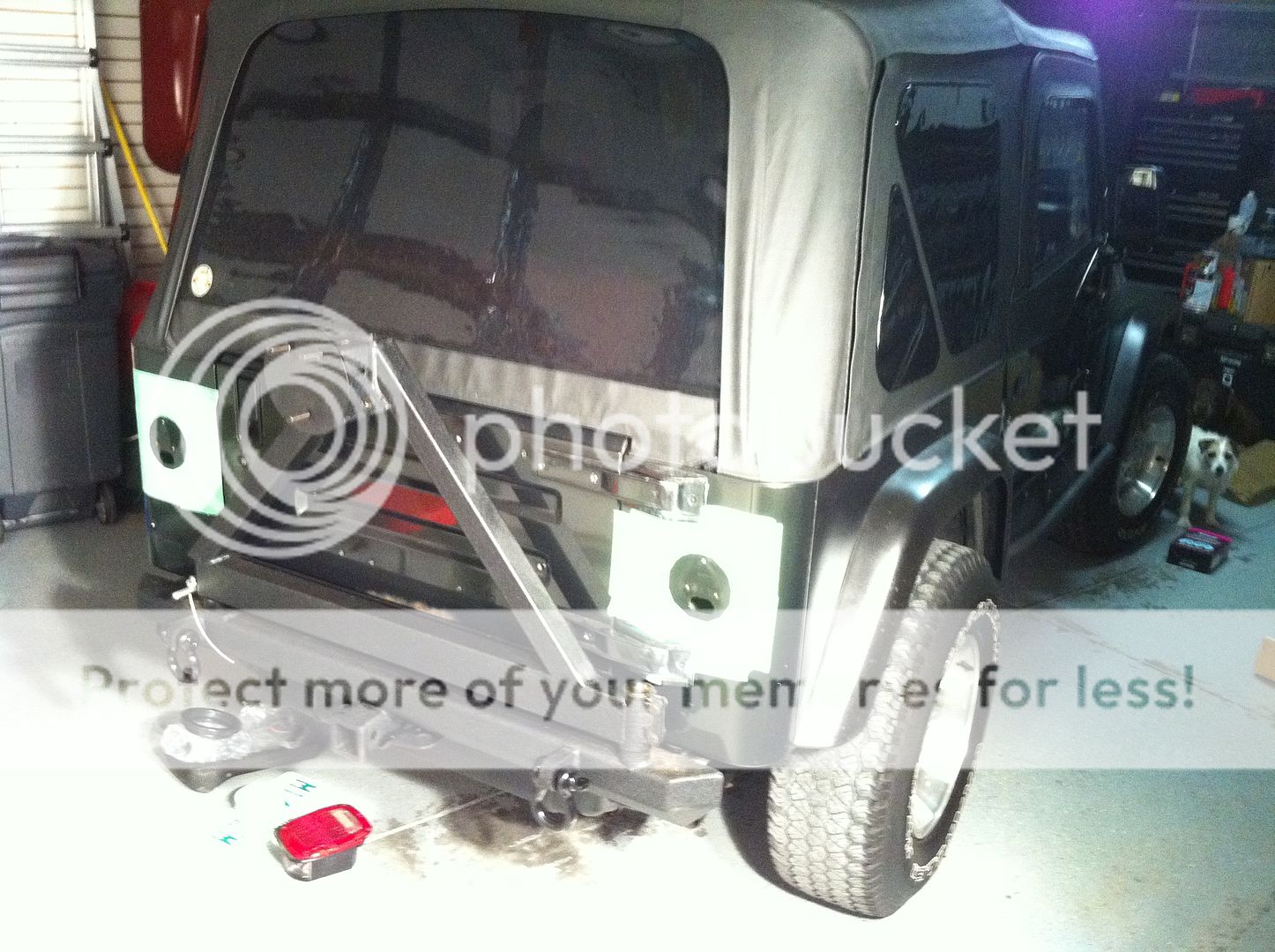

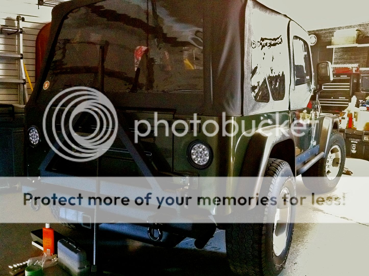

Got a heads up on this forum about a deal on the rear smittybilt bumper and tire swing I couldn't pass up so bought one and installed then decided to go the LED tail light route. Cut holes with jig saw and after referencing some threads on here install was a piece of cake.

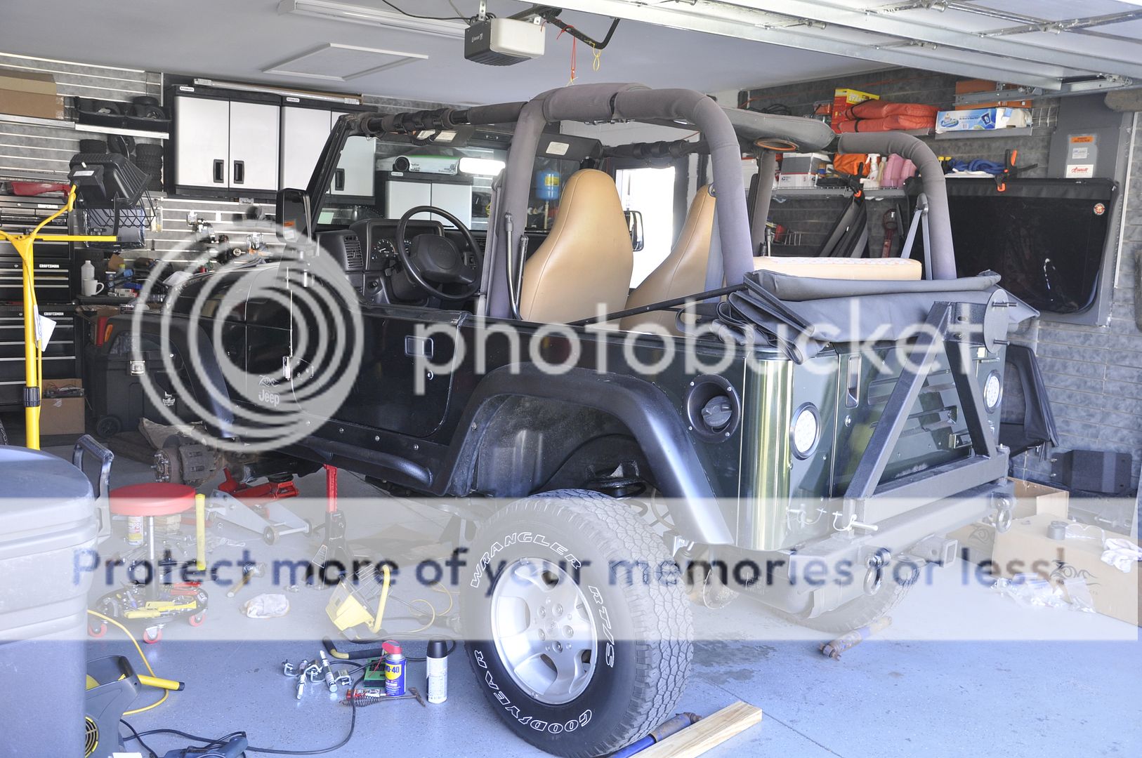

so here is the rear of the lift going in. wish I had purchased adjustable uper control arms but ended up drilling out the mounts on the axle and using the cam washers to move the the stock upper CA's forward a hair.
Rear done, looks beast and ever closer to a Zombie slaying MF'er

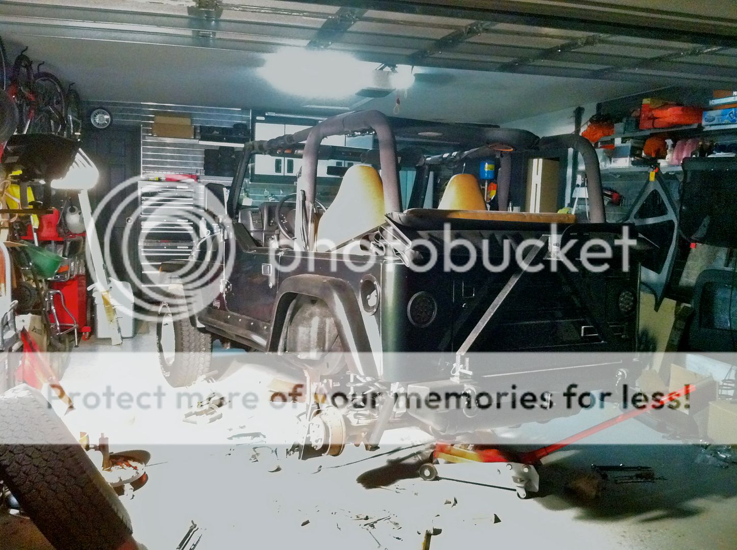

Front on jack stands gives a good indication of how bad it is going to look with 31's Time to decide on tires.
Started on the front and got smart and ordered front disco's sway bar links and an adjustable trackbar. So the front is on hold until the rest of the parts come in.
