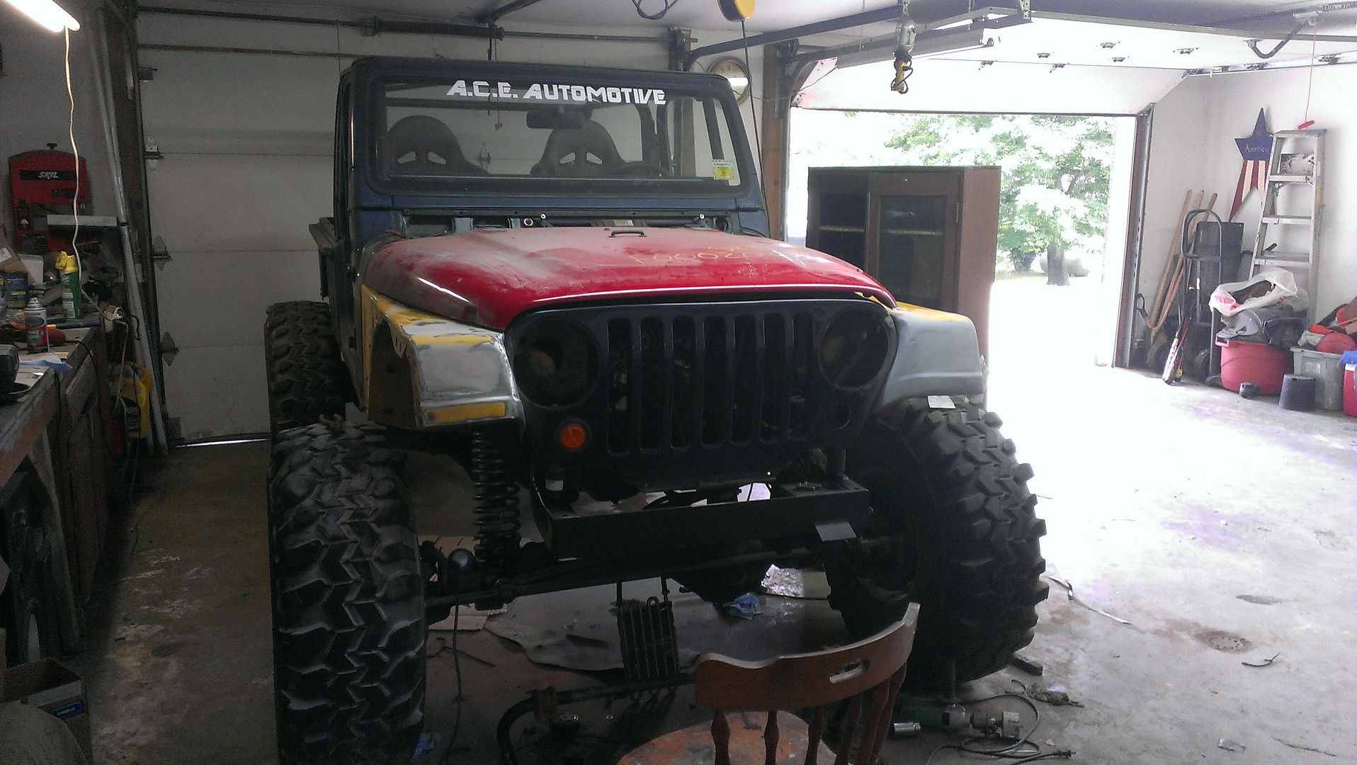

Well now where finally At my current Bought built mess
Its a 97 tj that has been stretched to lj specs 3 link front and rear dana 44 up front dana 60 in the rear 4.56 gears 5.9 magnum swap with the 46re trans and stock np231 and a hack job of a wiring harness.
The day it came home.
started collecting parts out of the junk yard one door two smashed up fenders

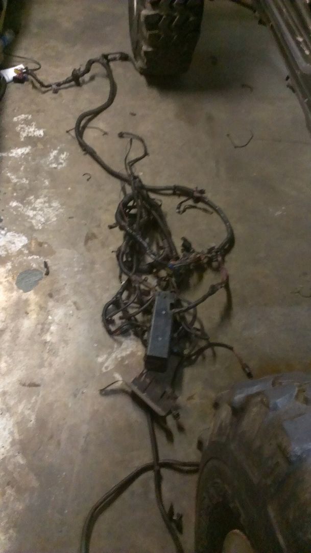

The wring harness

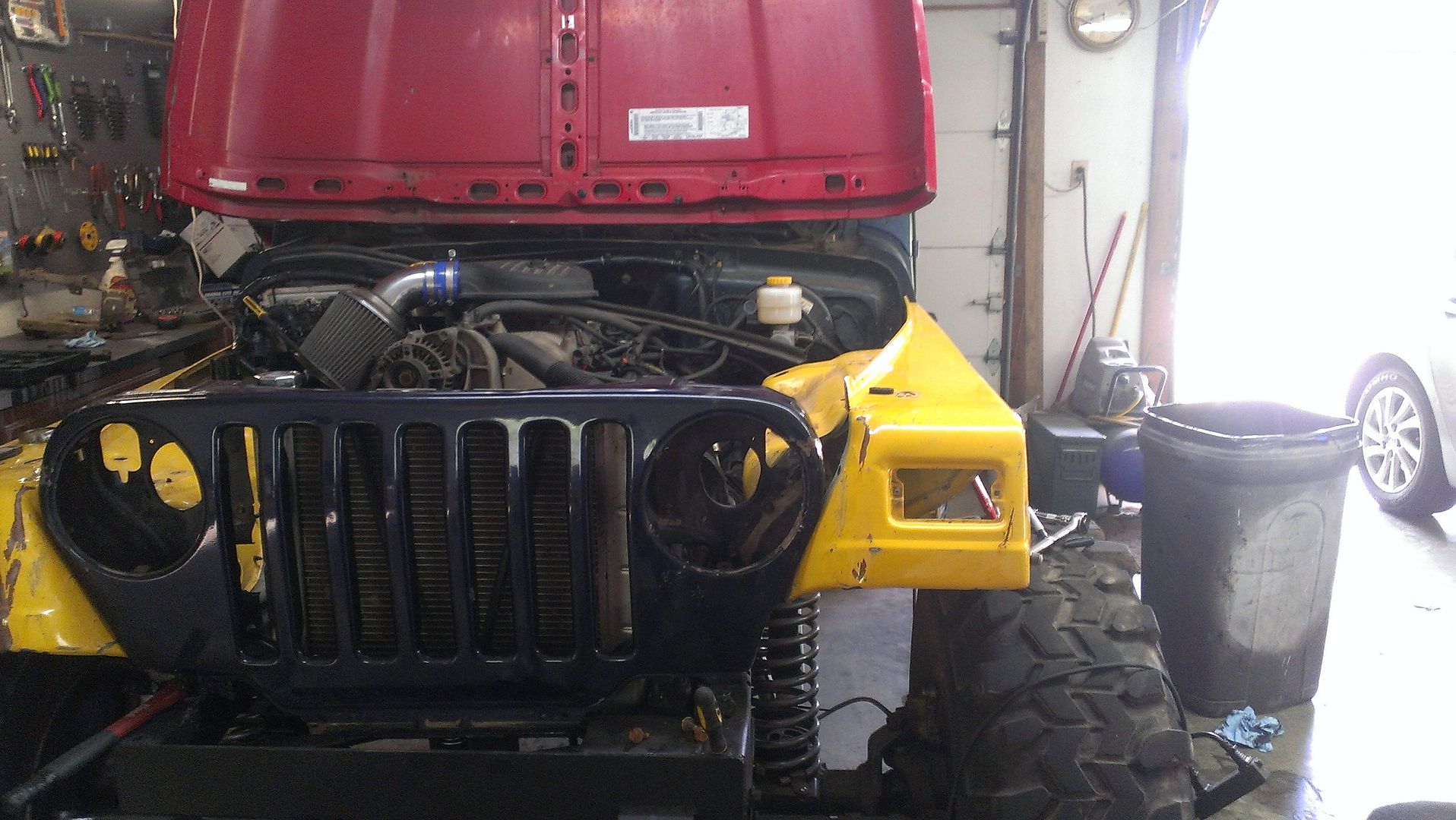

Started highlining the fenders
Started shaving the fender lights
made grill mounts
Hood pins came in
Finishing up the body work

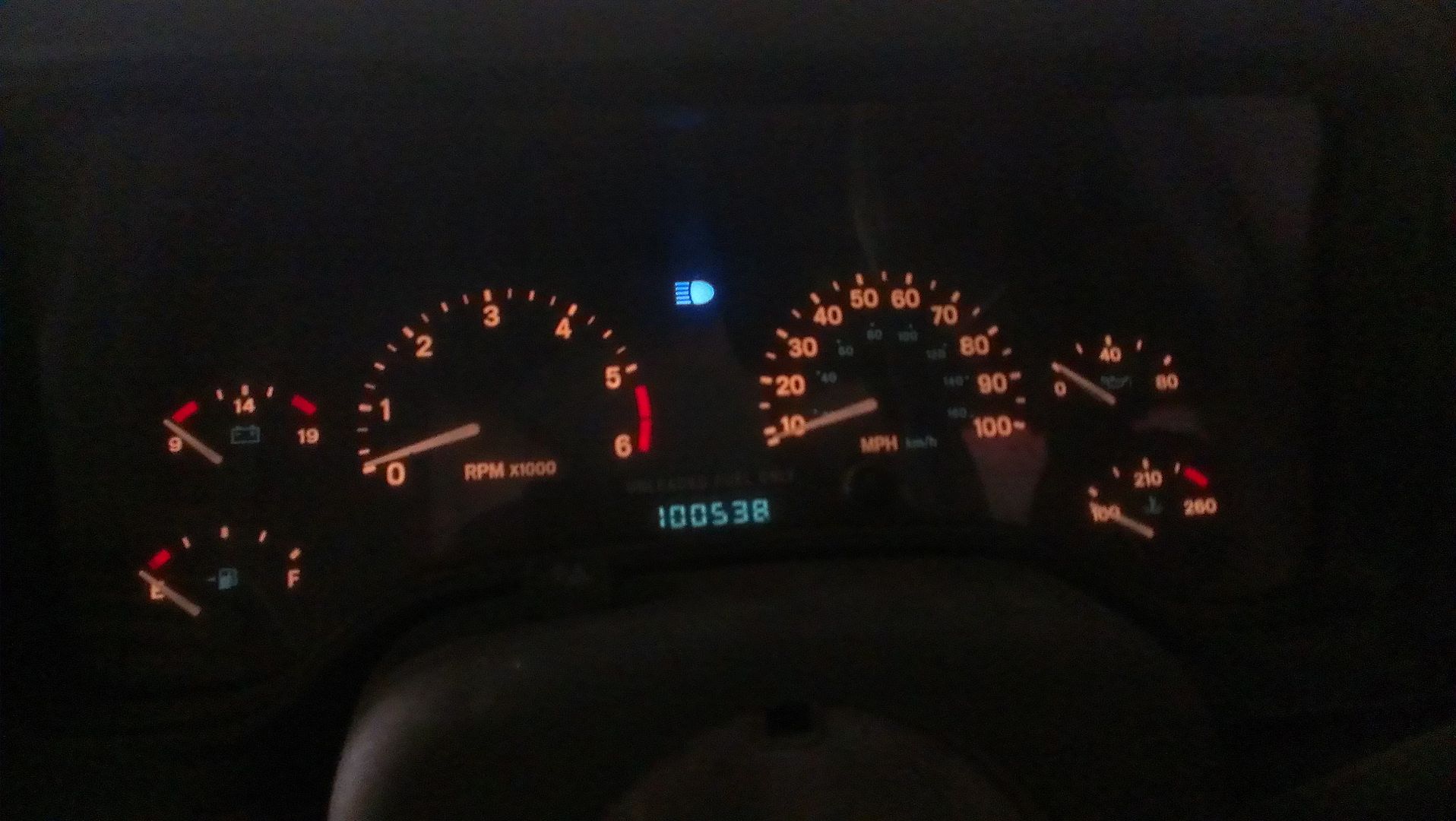

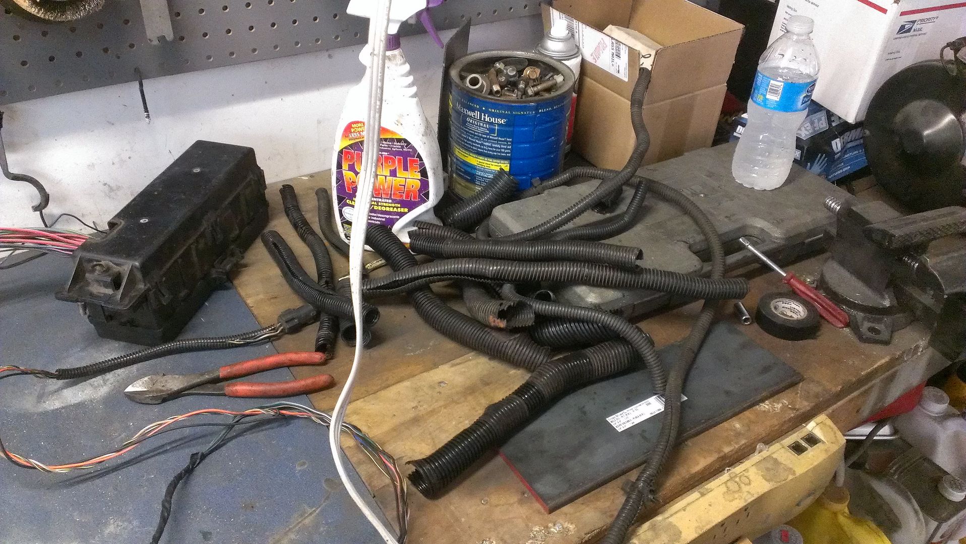

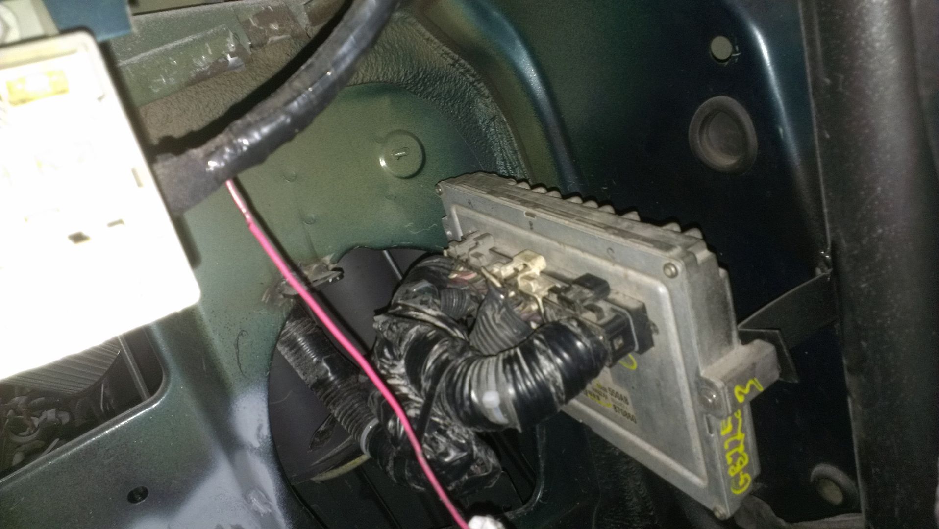

I tried to start it for the first time in over a month and its not getting spark. I can hear the fuel pump running. I may have pulled a wire loose in the harness as a few other things are not working. The voltage gauge is not coming on when the key is on the gas gauge is also not coming on it should be sitting at a little over half a tank and the tack is not moving when I try to turn it over So it looks like I will be pulling the harness tomorrow
jarrodblake is offline
post #5 of 52 Old 07-14-2013, 09:38 PM Thread Starter
jarrodblake
1978 CJ10
Location: patriot IN
Posts: 763
Redid the wiring harness runs great now, however the trans is dead will not shift into 3rd and 4th so I will be saving up for a 5 speed swap
