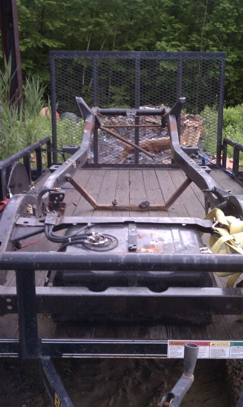

I've been posting updates in another thread so I thought I'd create an actual build thread. In looking at some of the builds on here this is mild in nature. The plan is to get this poor thing back on the road. No real details other than that. I'm in the market for a new frame. Suspension will all be replaced. Wheels... well there's 2 cragers on there... probably just get 2 more. For reference, the Jeep cost me $500. As of right now, I don't have any other money in it. This thing is much cheaper then some of my other hobbies so, I'm excited to see where it takes me. If nothing else this is a learning project for me.

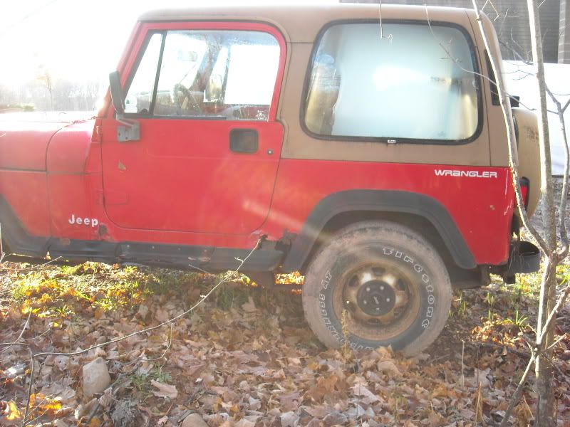

Here's the Jeep the day I picked it up.
Before bringing the Jeep home I had already started on a trailer project. Its pretty much done... getting the Thule rack put on shortly... but here it is...

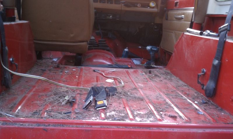

Finally started on the Heep... gut the inside.

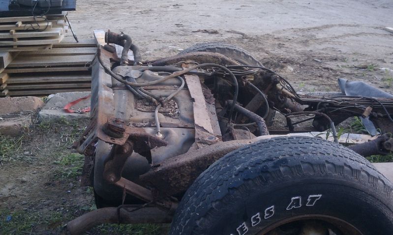

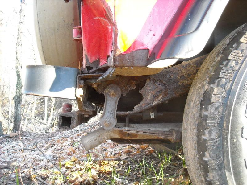

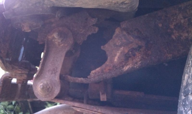

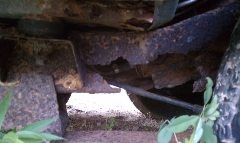

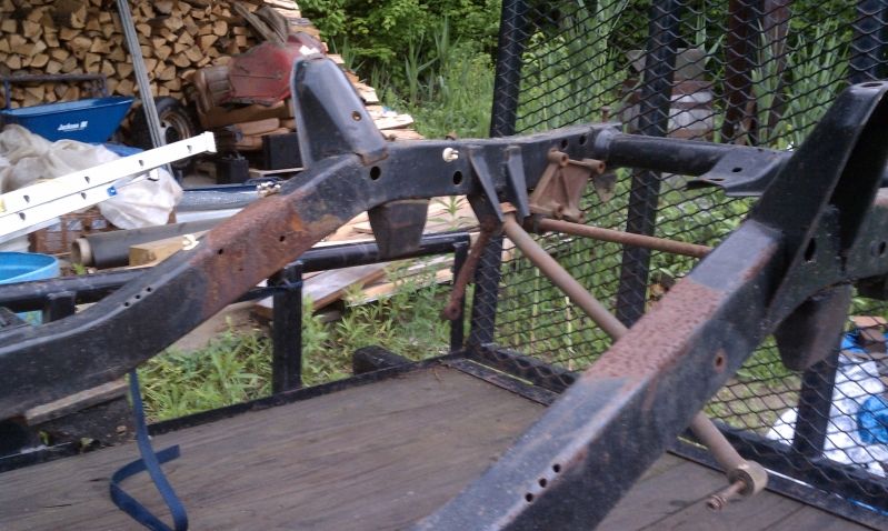

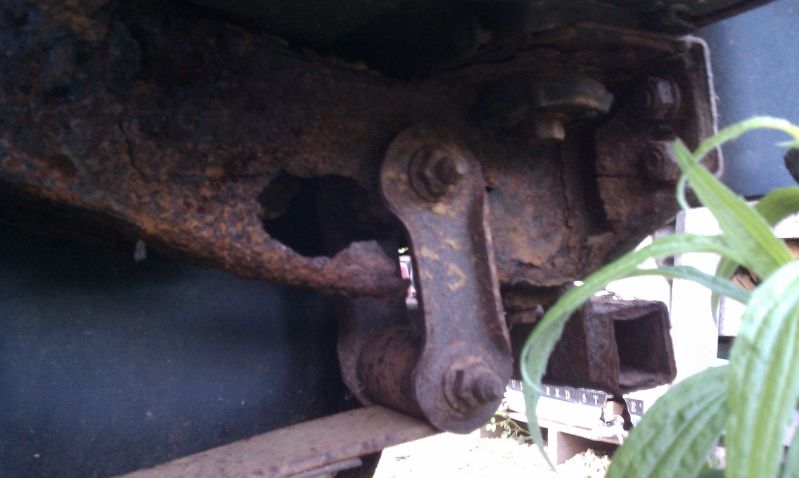

Somewhere in the short drive off the trailer (200ft) the frame gave way...here's the passenger rear.
Here's the driver side in front of the rear wheel...
And the driver rear...
I think this frame can be entered in the "worst of the worst" contest.

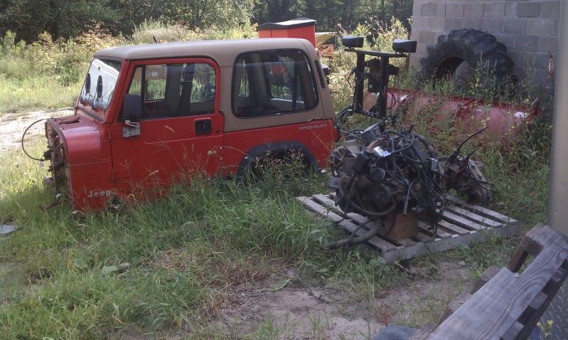

Today, the body came off. Pretty straight forward despite all the rust..
The rear is atrocious mess.

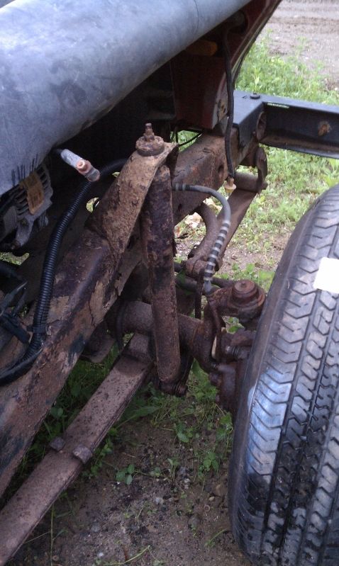

Figured I'd share another picture of what I'm up against. Thank heavens for PB Blaster and Impact guns.

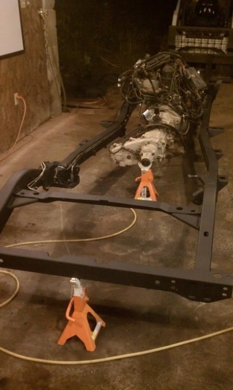

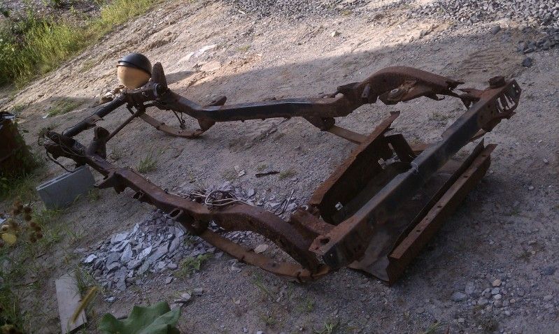

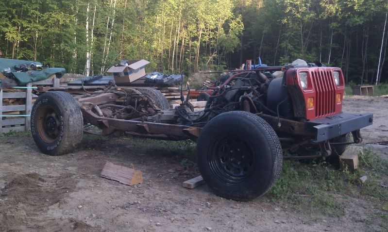

The Jeep is fully stripped. Here's the old frame... I'm officially on the rebuild.

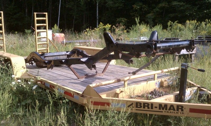

New frame coming out of storage
The mini powerplant and body...

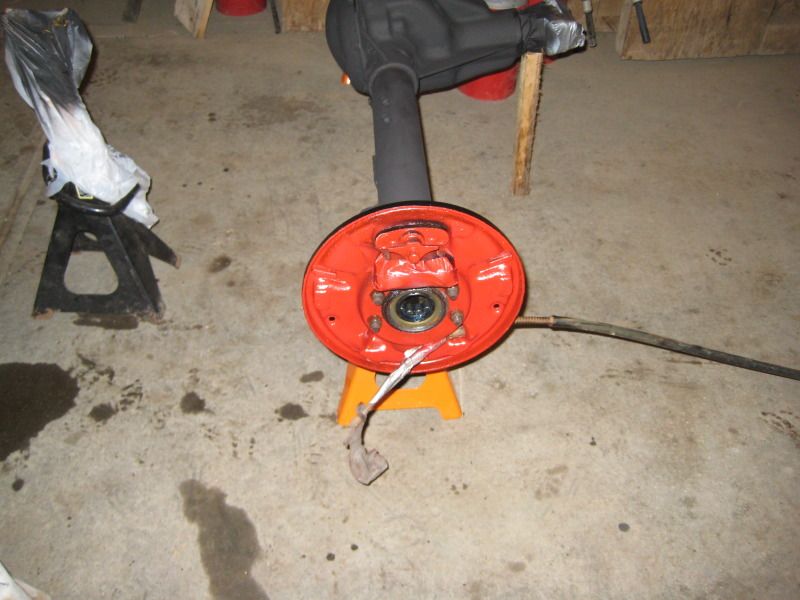

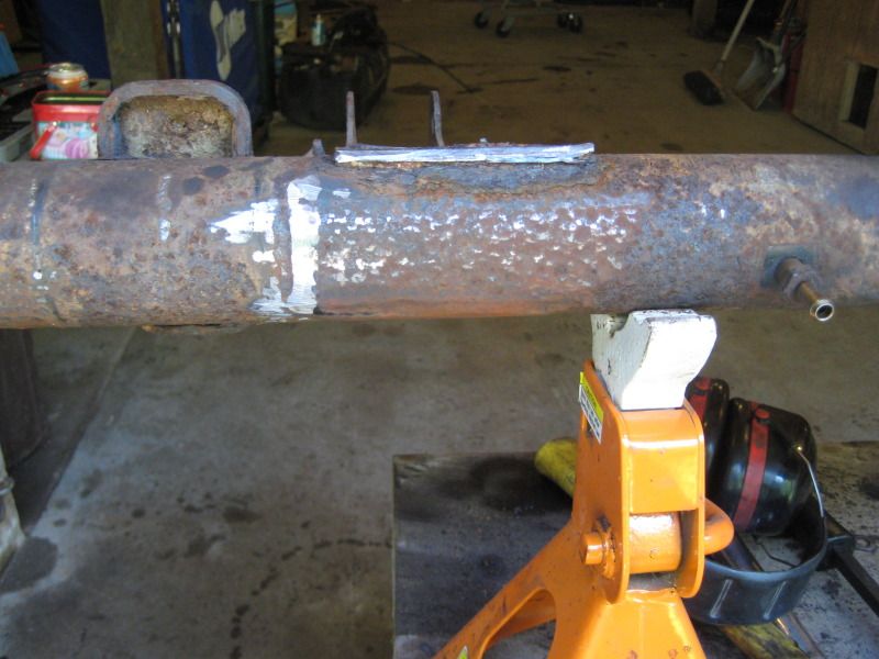

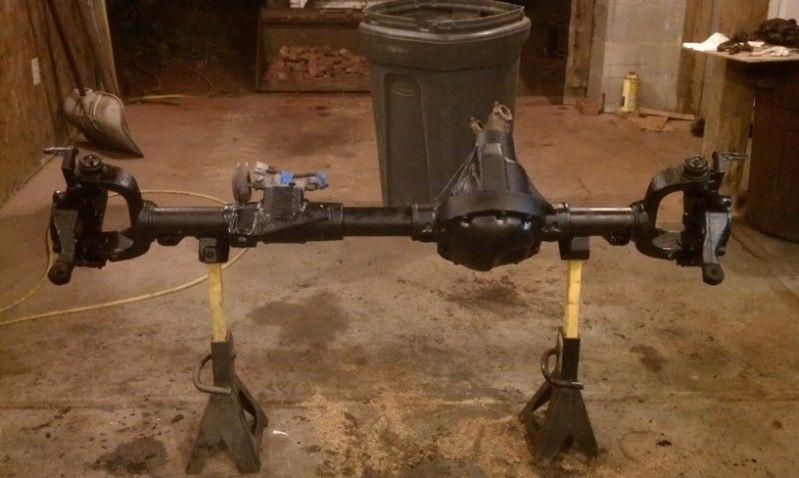

Being a budget build and little off roading ahead of me... I've decided to keep these axles. Rear one getting the track bar mounts cut off.
My homemade bearing puller... yanked the bearings out in 2 seconds... no hassle.
Axle coming together
Axle Complete

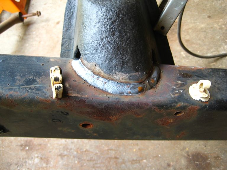

Yes. Cut them off the old frame. Sandblasted them and coated them with some rust encapsulating paint. Then welded them on to the new frame.
senecak19 is offline
post #15 of 32 Old 09-04-2012, 08:23 PM Thread Starter
senecak19
Location: South Hadley
Posts: 122
Here's one of the mounts welded on. I must've measured 16 times to make sure I had them right.
Few others... Front Axle Its now assembled and done with new bearing assemblies, ujoints, pinion seal, brake pads and calipers.
The Jeep as it lies.
