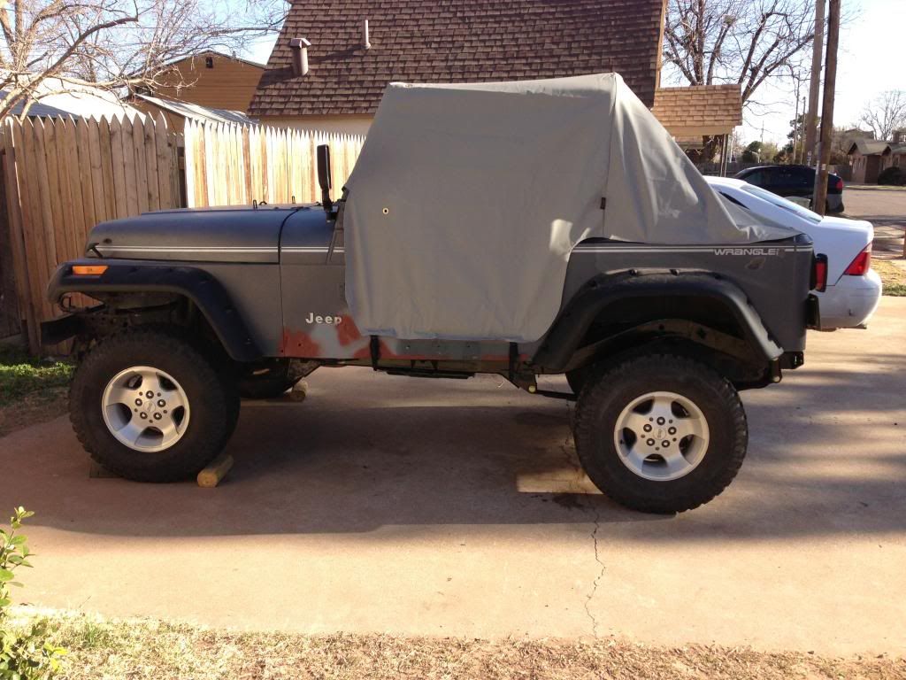

EDIT this is the current state of the jeep: 5.3L, SOA on RE 1.5" springs, Scrambler cab, metal cloak all the way 37s

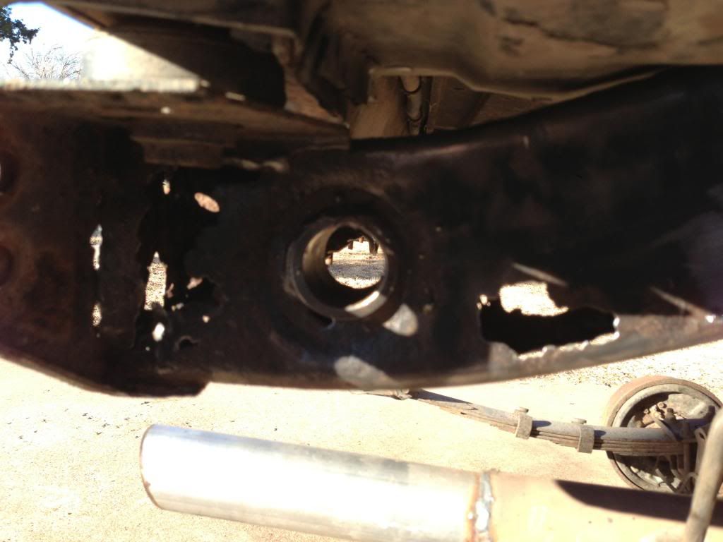

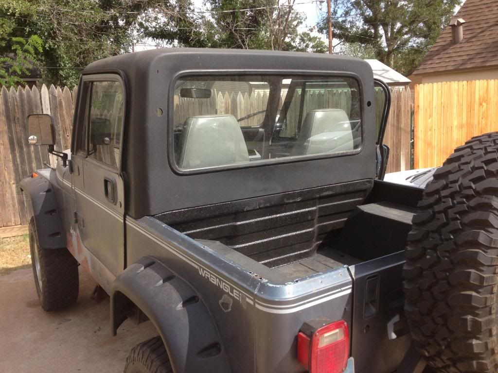

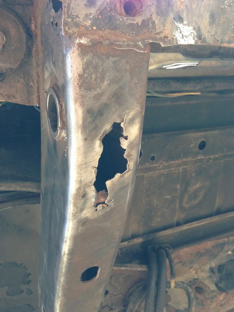

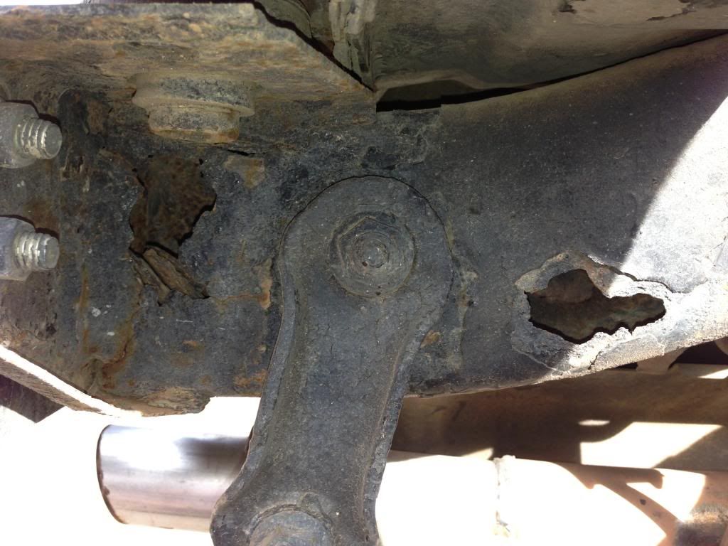

Bought this 91 YJ in November 2011 for 3600$. It was rusted, and the SOA was scary, but the interior and hardtop were really nice. I quickly sold the hard top for 1000$ and tore it apart to rebuild it.
Rust

Fix

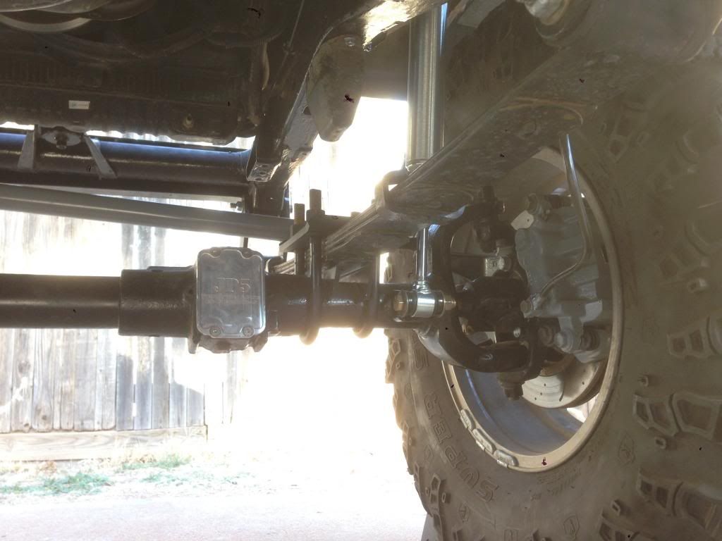

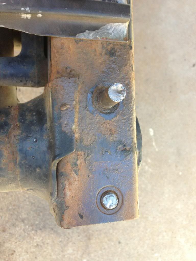

Painted the frame with Chassis Saver
Trashed the D35 in favor of a 8.8

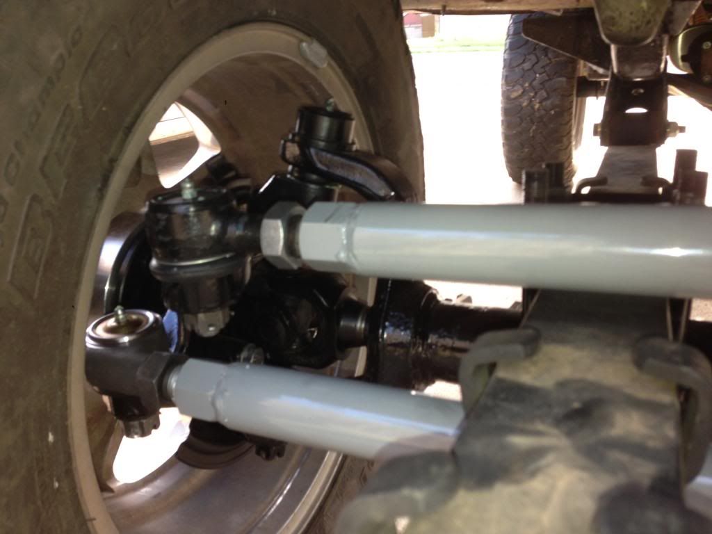

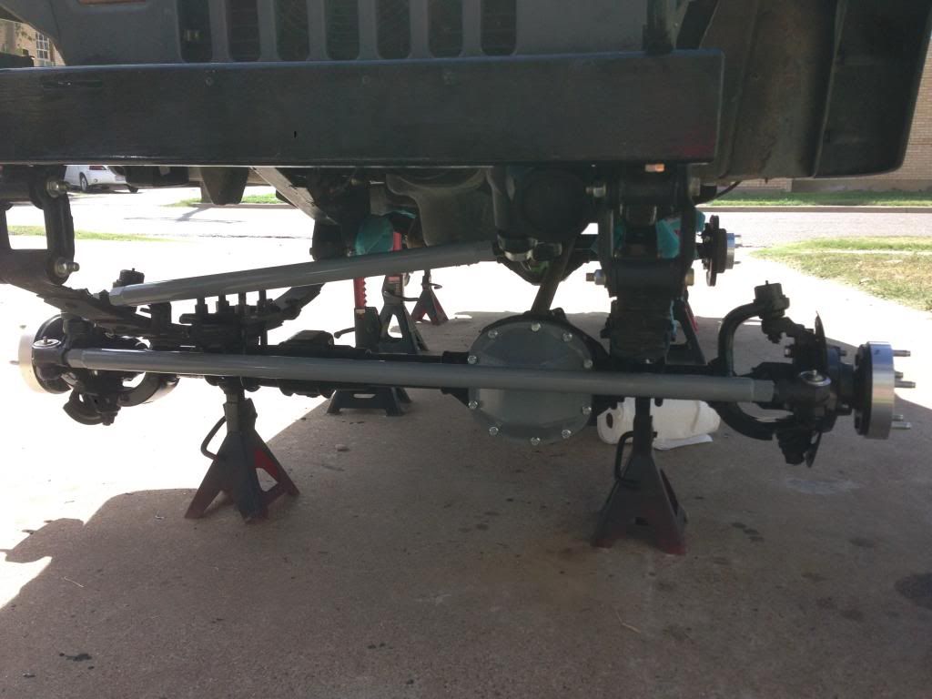

Rebuilt the Dana 30 with Tj solid axle shafts and WJ knuckles for Big breaks and cross over steering

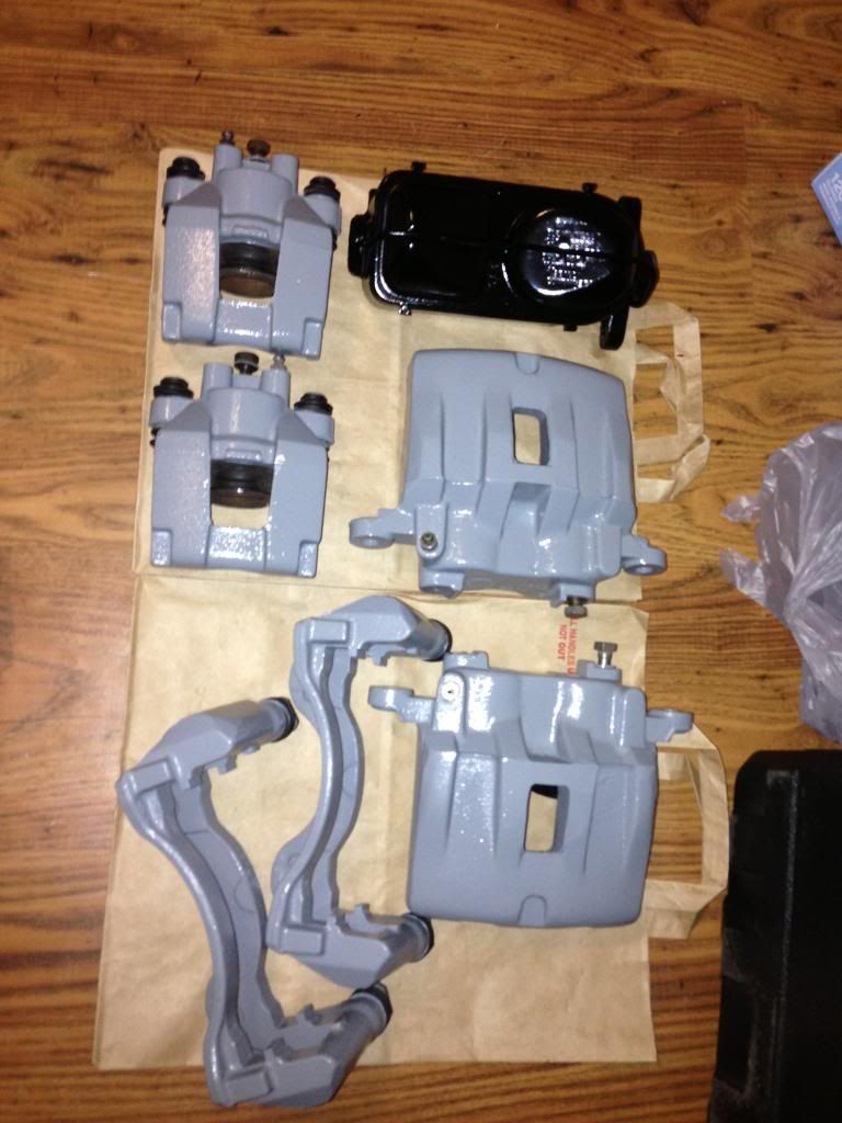

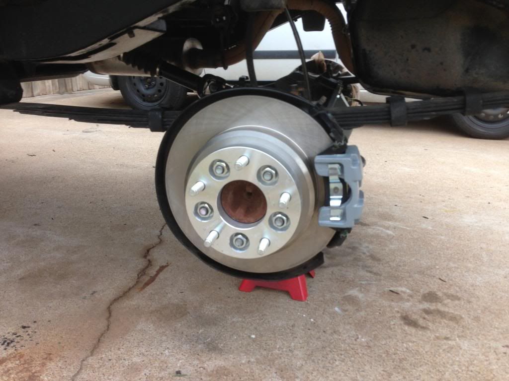

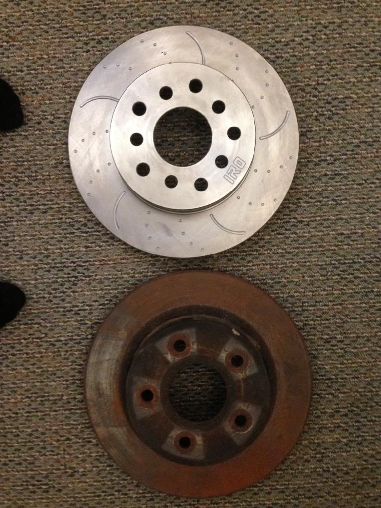

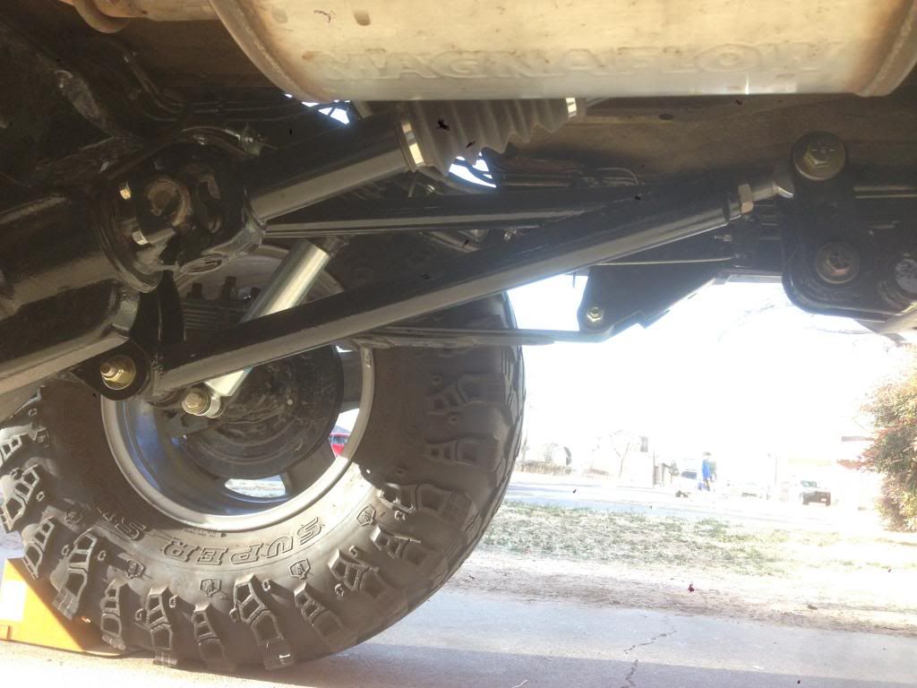

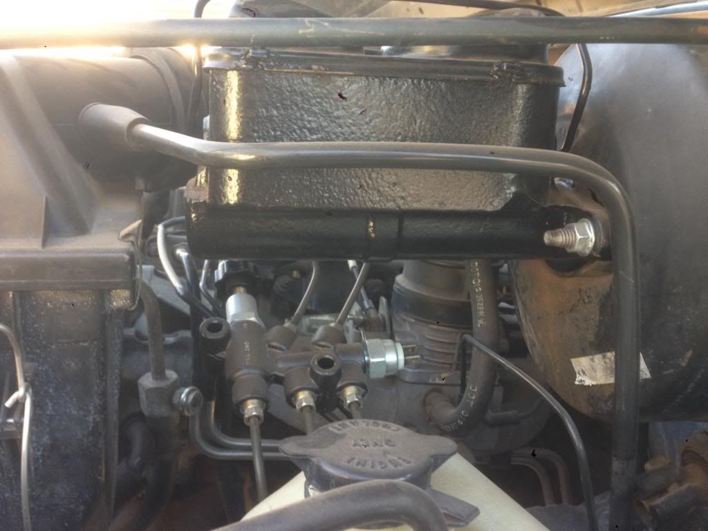

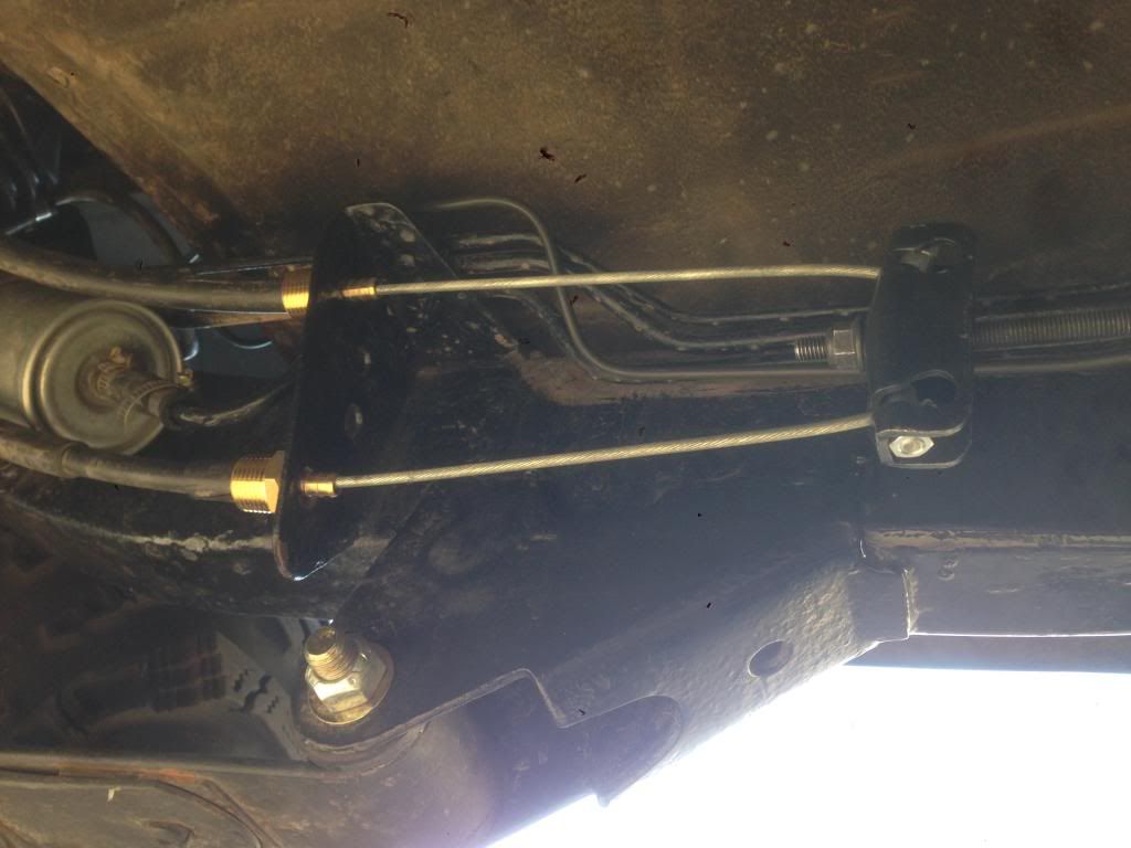

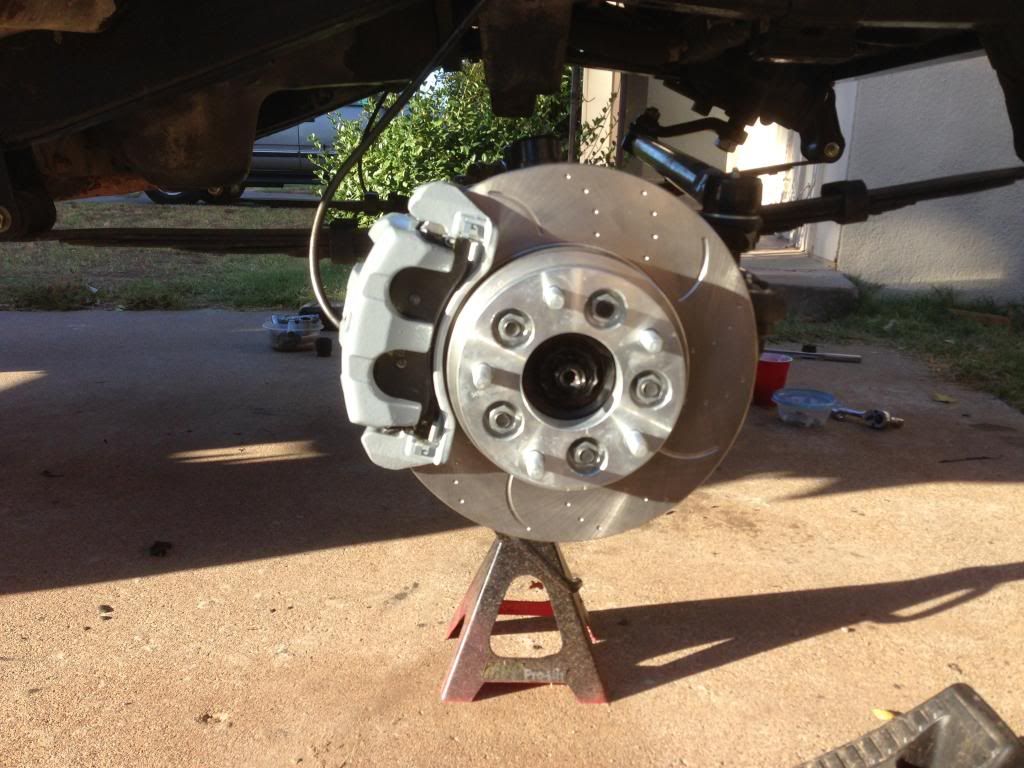

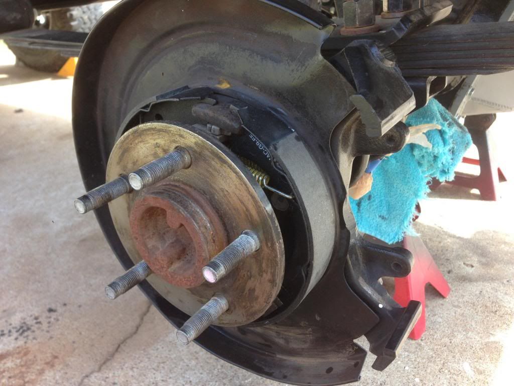

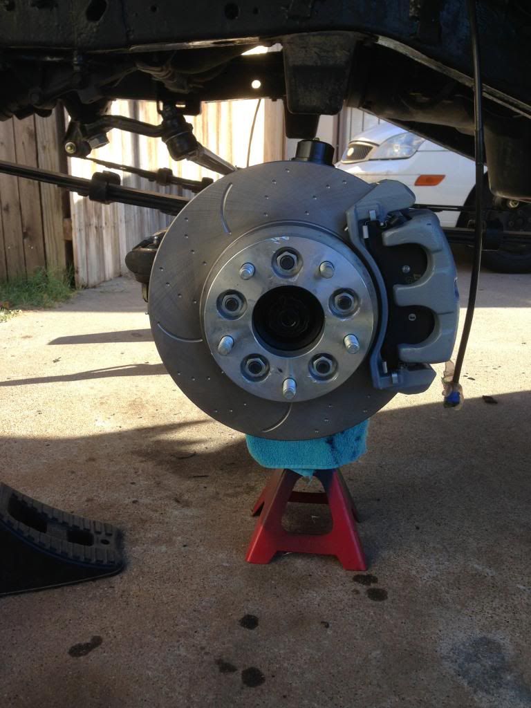

Replaced brakes front and rear with all new hard lines, extended soft line, 78 Marquis master, Wilwood adjustable proportioning valve, and rigged up E-break cable

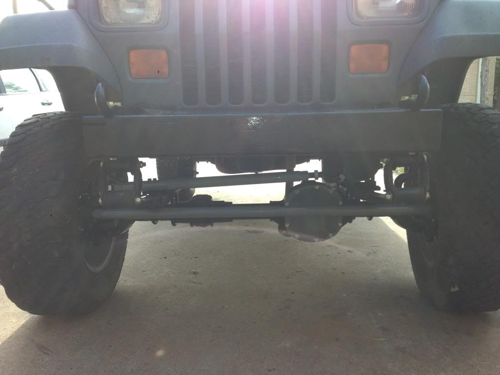

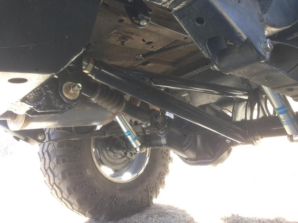

Did RuffStuff's steering with offset TRE

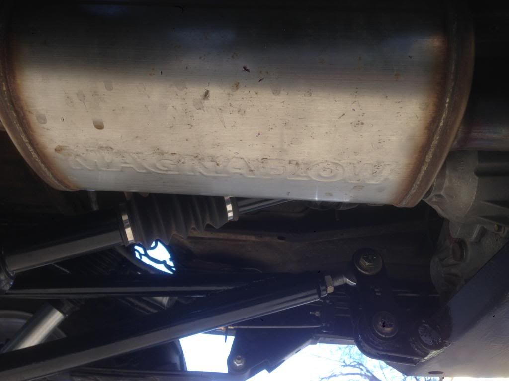

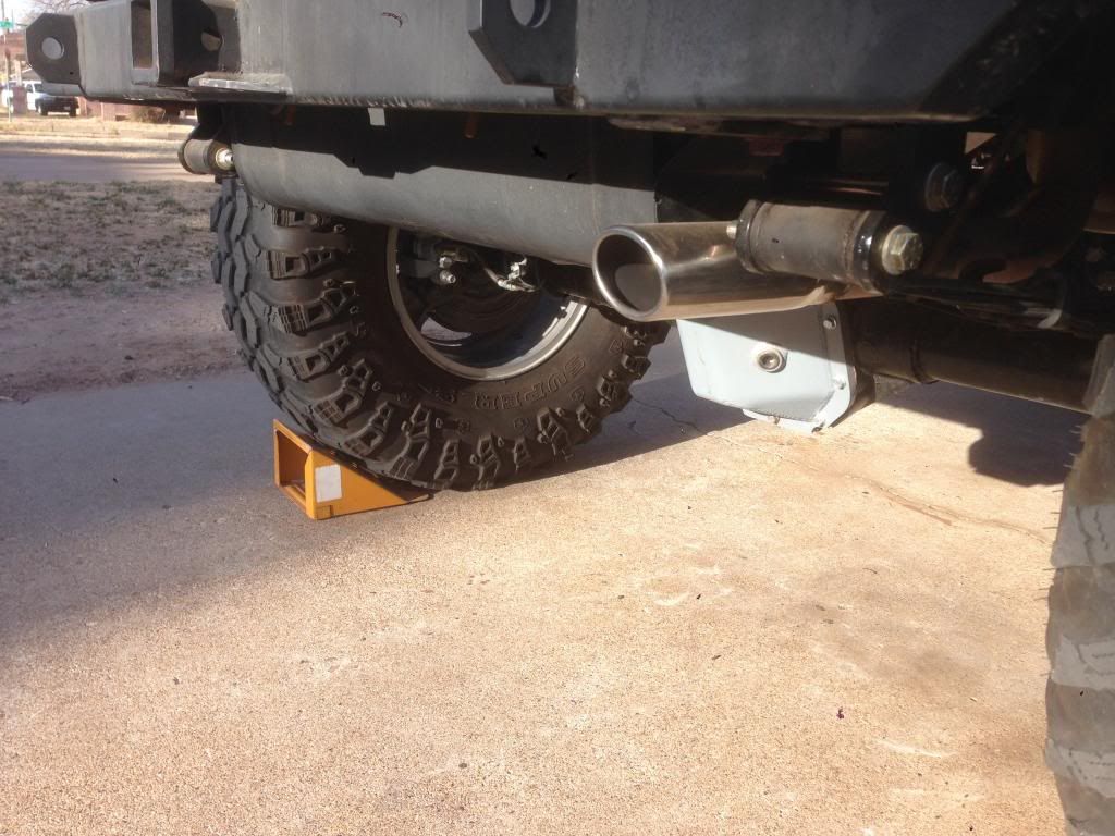

Replaced the exhaust with Magnaflow cat, muffler, and tip

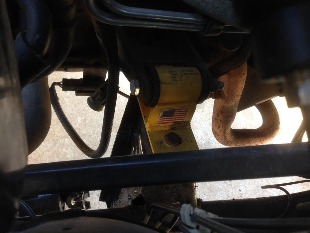

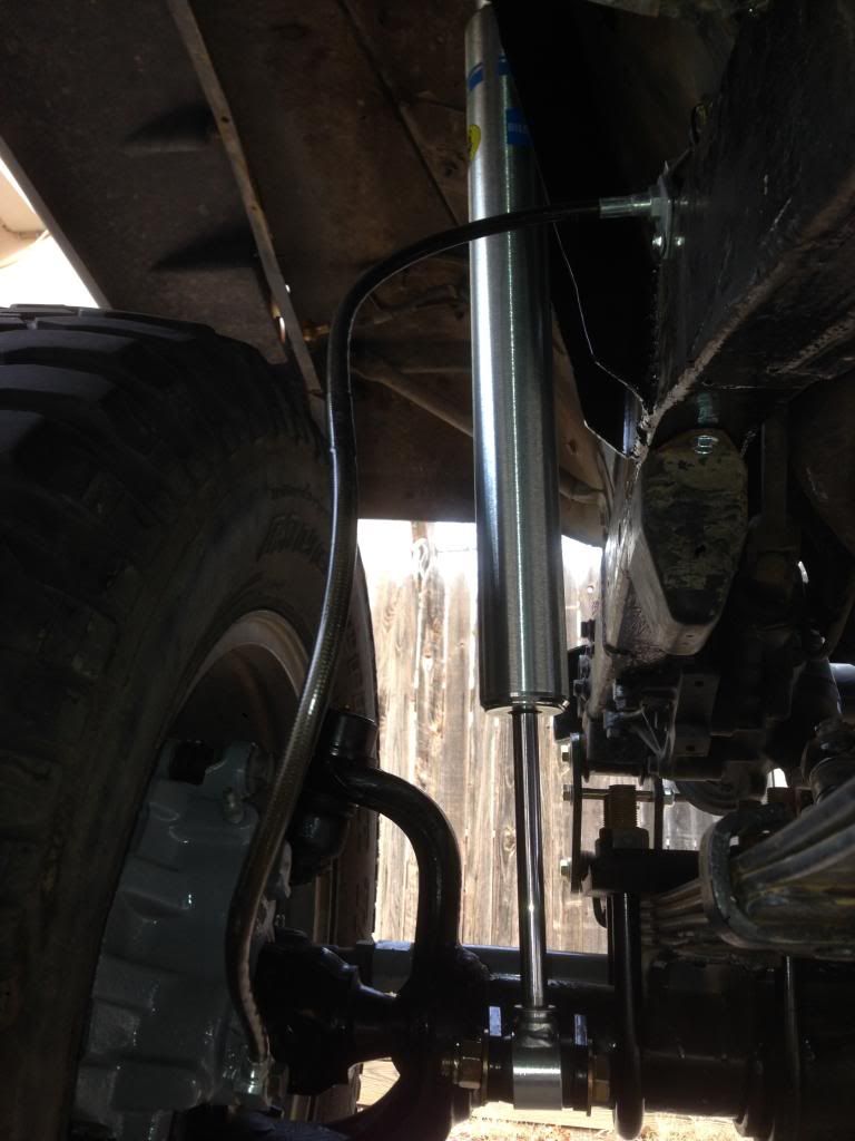

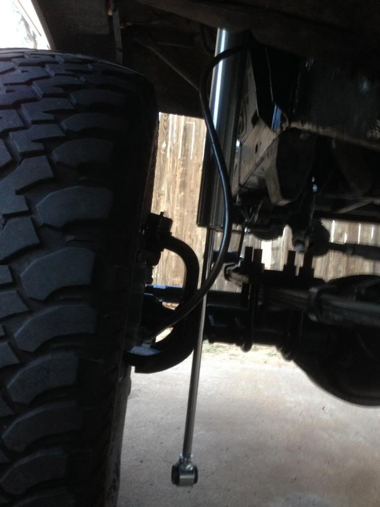

Bilstein 5125 shocks 14" travel front 10" travel rear with ford shock towers in the front and M.O.R.E shock extensions in the back
The ladder bar is from RuffStuff and the skid plate from Barnes4wd

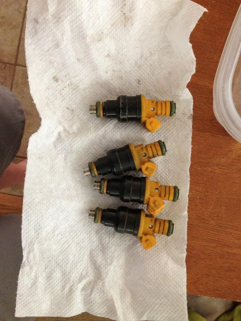

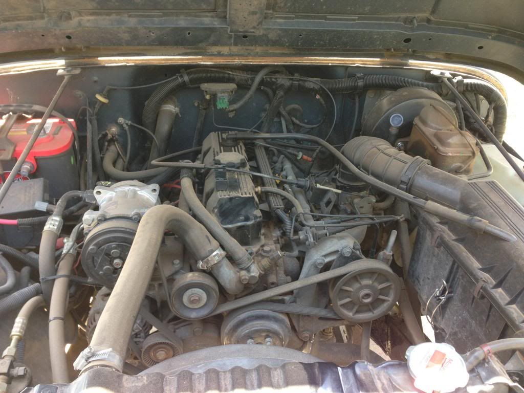

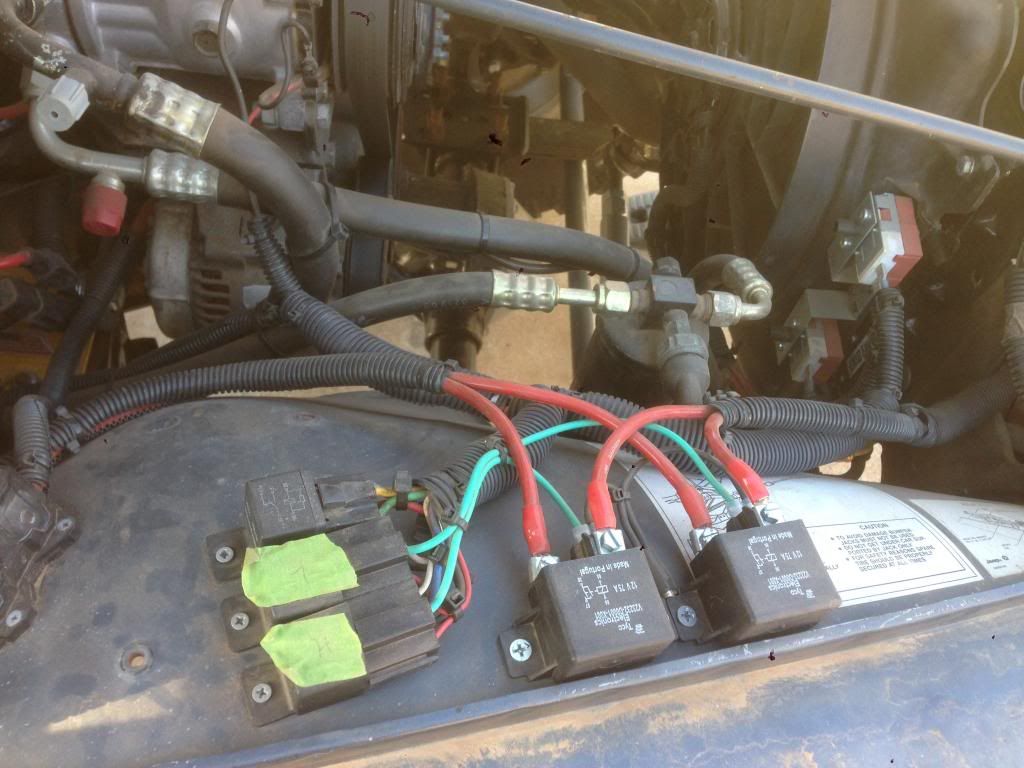

Along the way i did 19lb 4 pin injects, Tarus E-fan, 4.0 throttle body,136amp alternator, and brown dog motor mounts

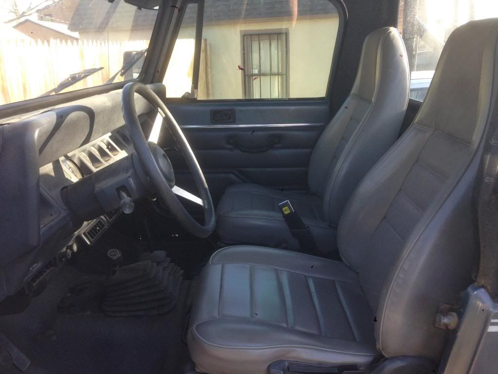

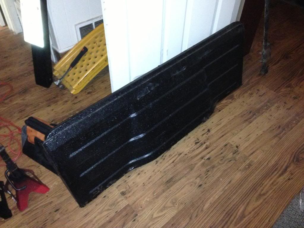

Interior is really clean. It was only nice part on the jeep when i bought it, however the bedliner inside i did

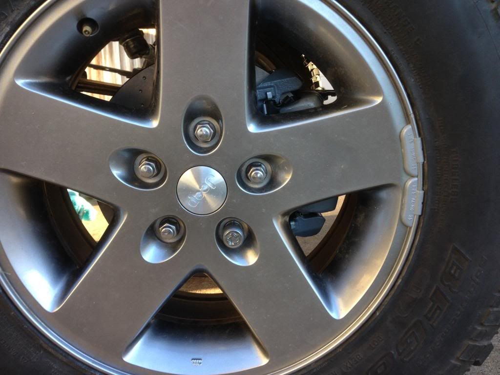

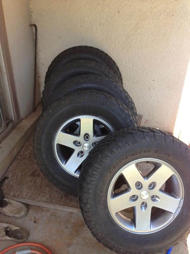

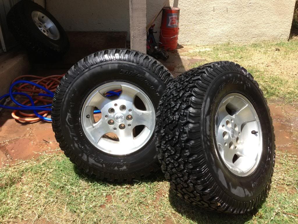

Original wheels

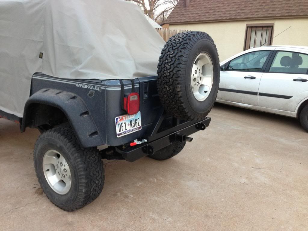

Bought a dirtworx tire carrier and got it powder coated.
JK Rubicon wheels
Fell in love with the scrambler top and drove 300 miles with it tied to the top of the daily driver. It came with the factory bulk head
Found a early CJ7 roll bar for the back

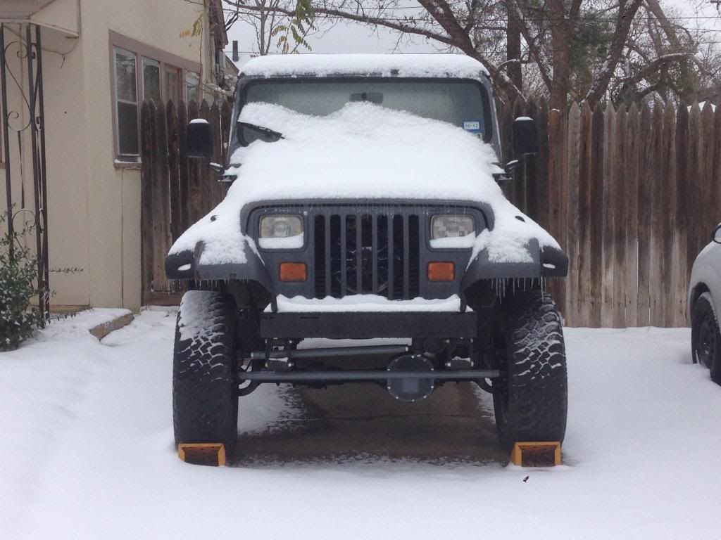

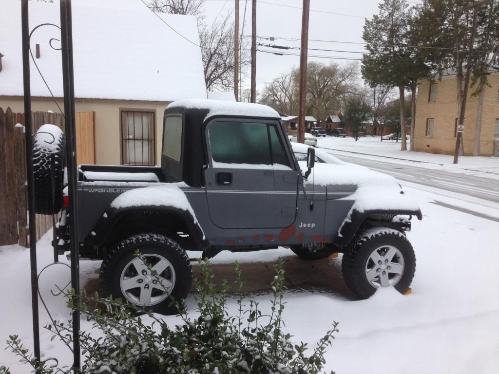

Got some 50% tread 37x12.5x17 Super Swamper Irok Radials on craigslist cheap

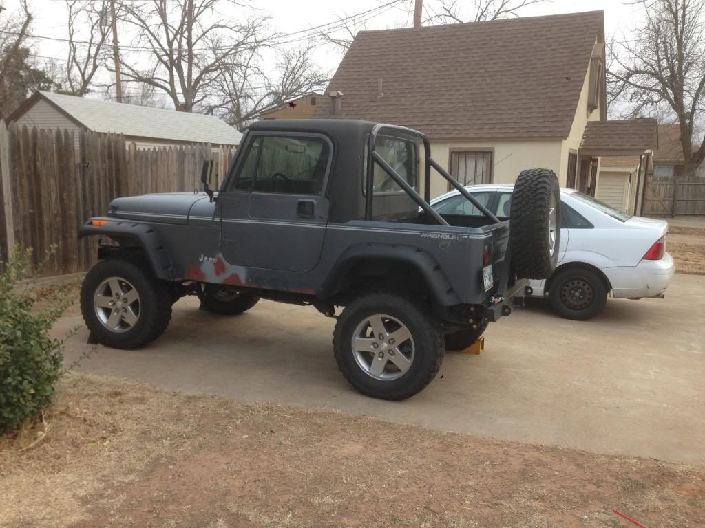

And that is how it currently sits. It is now running and driving for the first time in over a year. It is not register, inspected, or insured yet but i have been driving it around the neighborhood and gotten it up to 60mph with no vibes or issues. Well except the front tires will rub the leaf springs at full lock but that is not surprising.
And the pictures are over the last 2 years and are roughly in order but not exactly. I am now invested in this jeep about 5,000$ total counting the initial purchase and subtracting the sale of the hard top and sale of the wheels/tires.

Before
and After

What rims are those?
Machinist is offline
post #14 of 242 Old 02-28-2014, 02:58 PM Thread Starter
Bong_Holyeo
Bong_Holyeo's Avatar
Location: Houston
Posts: 519
The original ones on there were Jeep Canyon wheels, the ones on there now are Jeep JK Rubicon wheels.
