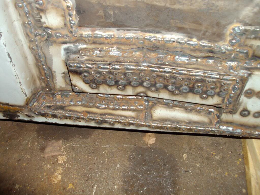

i had this piece welded up before, didnt get any welding done today but i did get a couple small pieces made up for it
its a rusty one

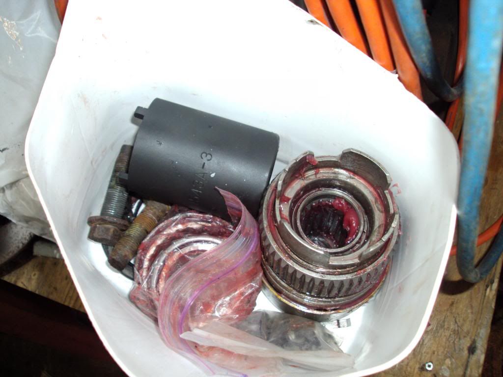

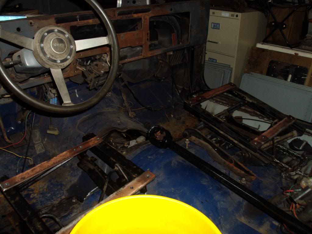

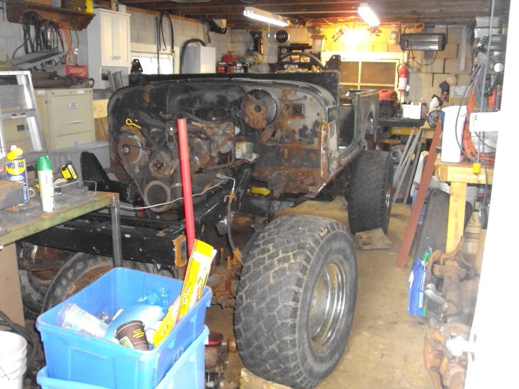

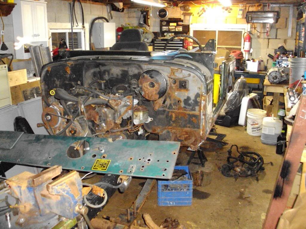

so i haven't gotten very much work done on the body, other then putting primer on the spots i have repaired so far and i sat the body on the frame for now, had to get the chassis out of the drive way for now, having a bbq soon for my dads retirement party
body is just sitting on the mounts for now, gonna pull the 4cyl out and start mocking up the new mounts for the 360
picked up a dana 44 from an 84 dodge, has the one piece axle shaft and auto locking hubs

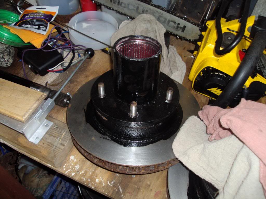

machined the rotors for now when i was at work, disassembled the hubs and cleaned and repacked everything, have to get new seals, ball joints, tie rods, u joints for it, im not gonna worry about getting new brakes until its at the point of being drive able, i think my brother in law still has a couple of 9" rear ends, if so i will be getting one for the rear, if not i will get what ever i can find, i have all the stock axles and drive line parts up for sale, so hopefully i can get some cash out of that for some new parts, since the new front axle is passenger drop i was thinking of getting a dana 300 with twin sticks for it

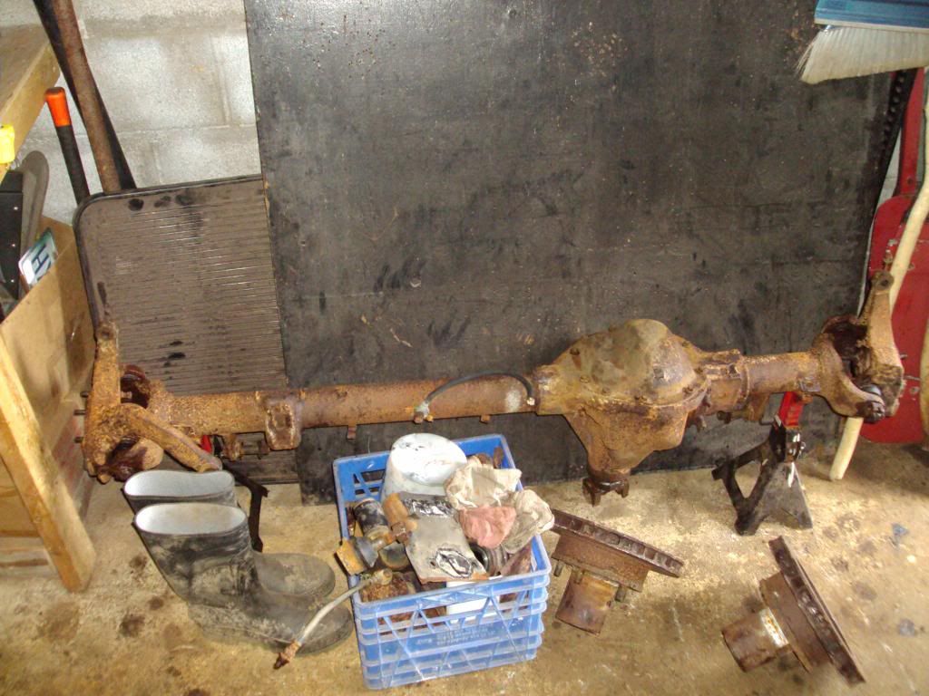

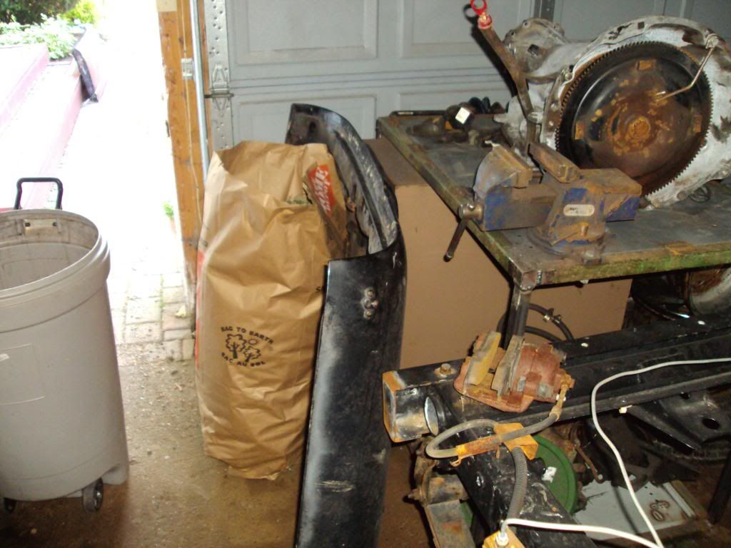

as it currently sits with out wheels again, at least its inside this time
sold the stock front and rear diffs, front dana 44 is some what in place for now, i will have to out board the springs before it will be properly in place, talked to my brother in law kevin and he has a 9inch ford rear end for me, i may have found a passenger drop transfer case for the jeep, hoping to sell some more stock parts so i can keep getting more stuff for the jeep

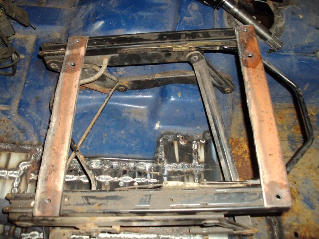

made a little progress after work today, started on some seat brackets, the mounting points on the cherokee seats im gonna use arnt as wide so im making a few brackets out of some 1/4 steel
and dont forget to measure twice and drill once, i may have forgotten that on one

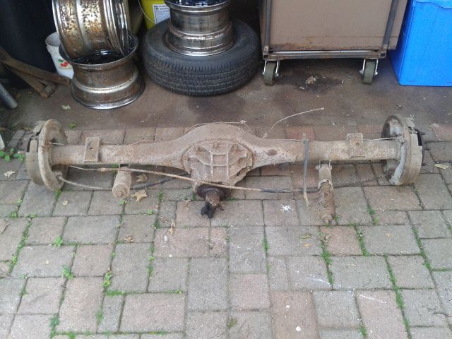

picked up a 9'' for the rear, dana 300 with twin sticks and a cj hood, will have pics soon
