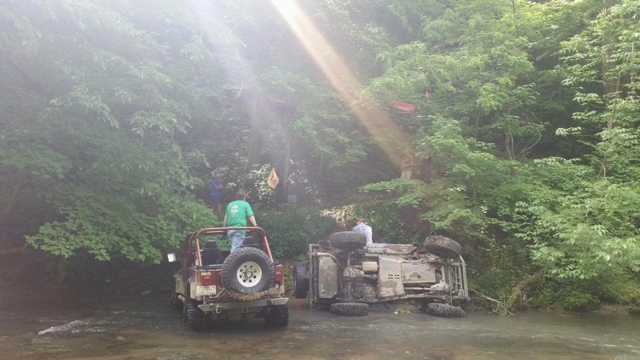

Back in June 2016, while pre-running for the Jeep Jamboree (JJUSA) - Badlands, in Attica, IN, my beloved 2002 TJ - "Minion" came to an end. The edge of a trail gave way, causing me to roll 2.5 times down an embankment, landing driver's side in a river.
When I returned home, this is the result:
So, contemplating my next move, we decided to put the time, energy, and $s into a new platform vs rebuilding the TJ. We always liked the LJs, esp seeing how well they do on the trials, and the increased cargo capacity.
