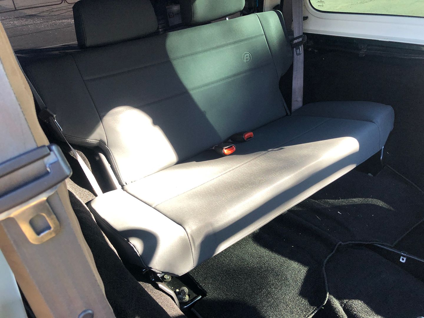

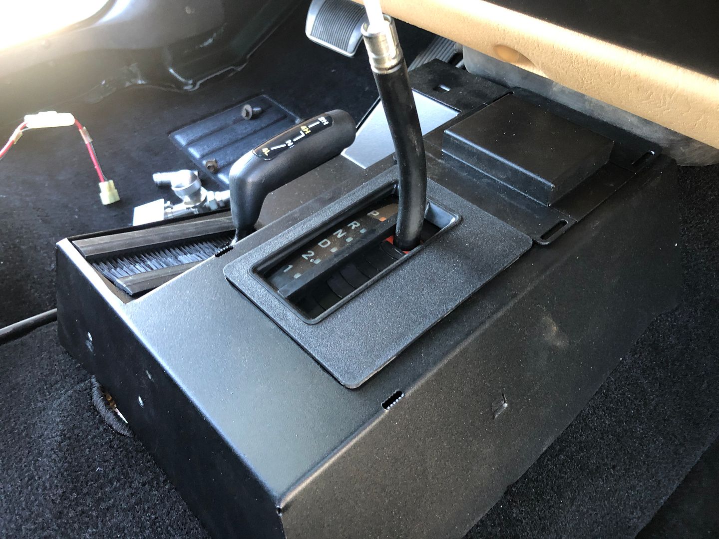

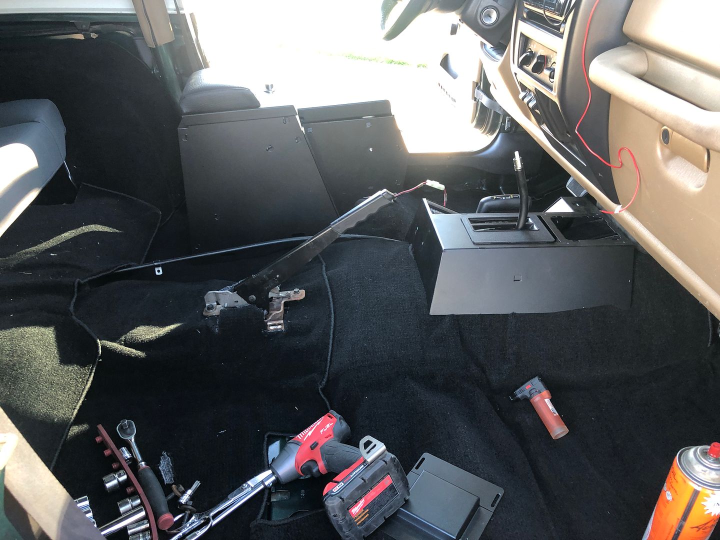

Carpet kit is in, center console was set in to fit test. All looks good. I plan to use the area that the airbag key went for a 12v receptacle and a USB port.
Day light pic of rear seat:
12vunlimited panel, it will go were the ashtray and rocker switches go.

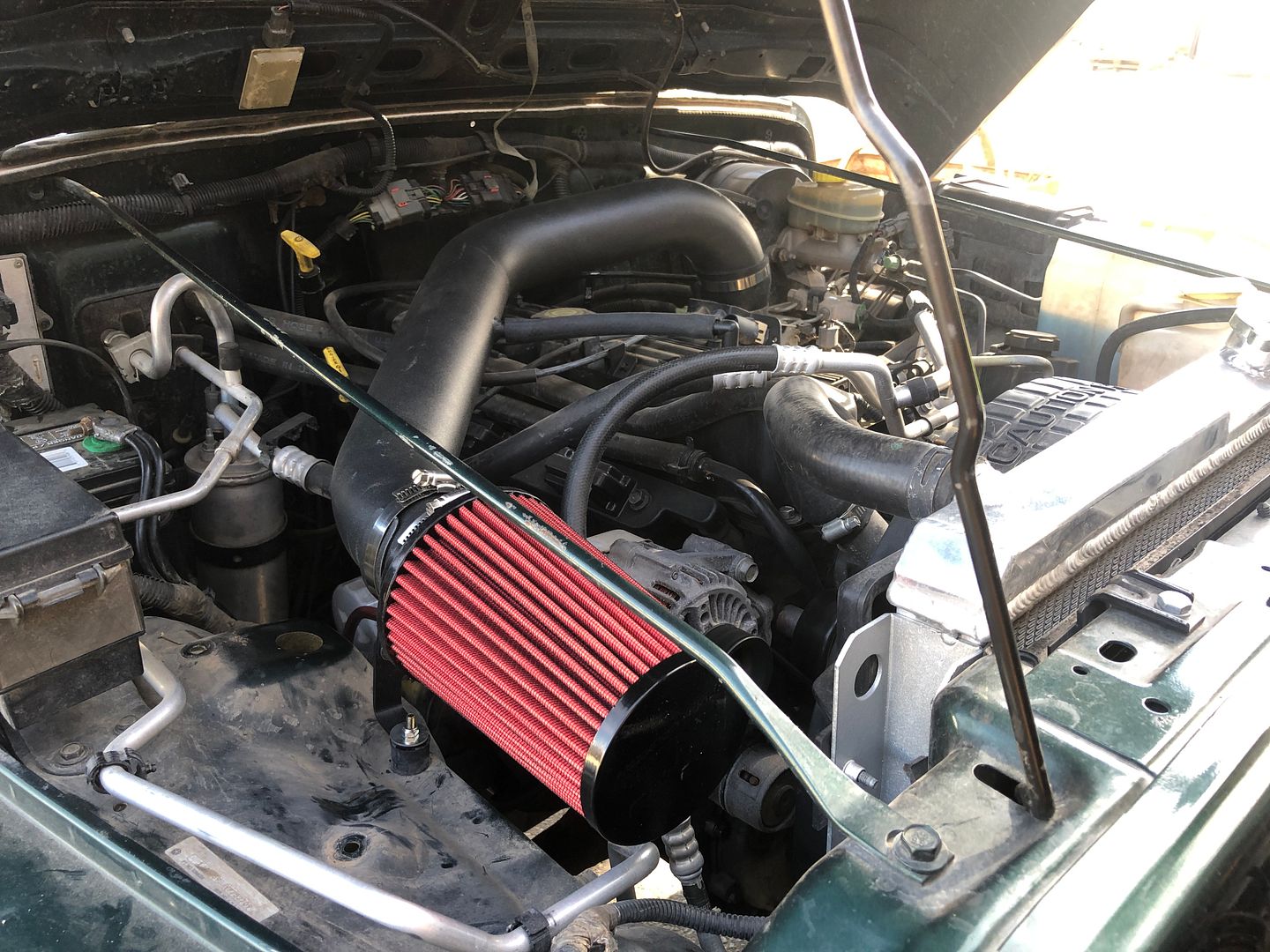

Got my re usable filter kit installed. looking forward to the rated 40hp gain!!!
It may only gain 35hp though as I left off one of the faster stickers.
Make a shield to go between the air filter and the engine to help cooler air getting to the intake.
Don't forget to put the sticker somewhere for that added 5HP.

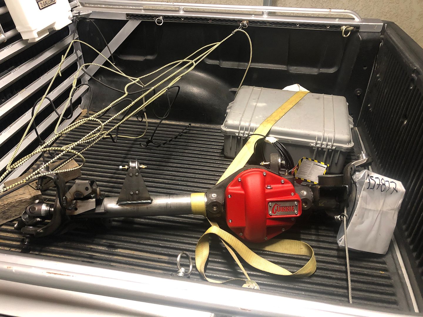

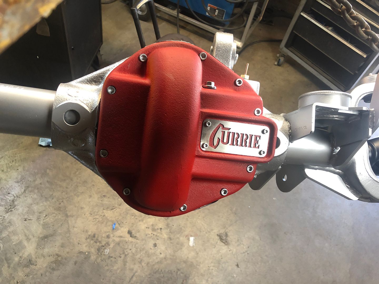

Picked up the Currie D44 today. Massive compared to my other 44's I've had
Basic specs are 4.56:1 with a yukon air locker and alloy axles out to the ends. I think they are JK style. I'll learn more as it goes together.
WSS
Okay I am jealous really really jealous. My HP44 didn't look like that when I was done building it. But I guess I built it so I should be happy.

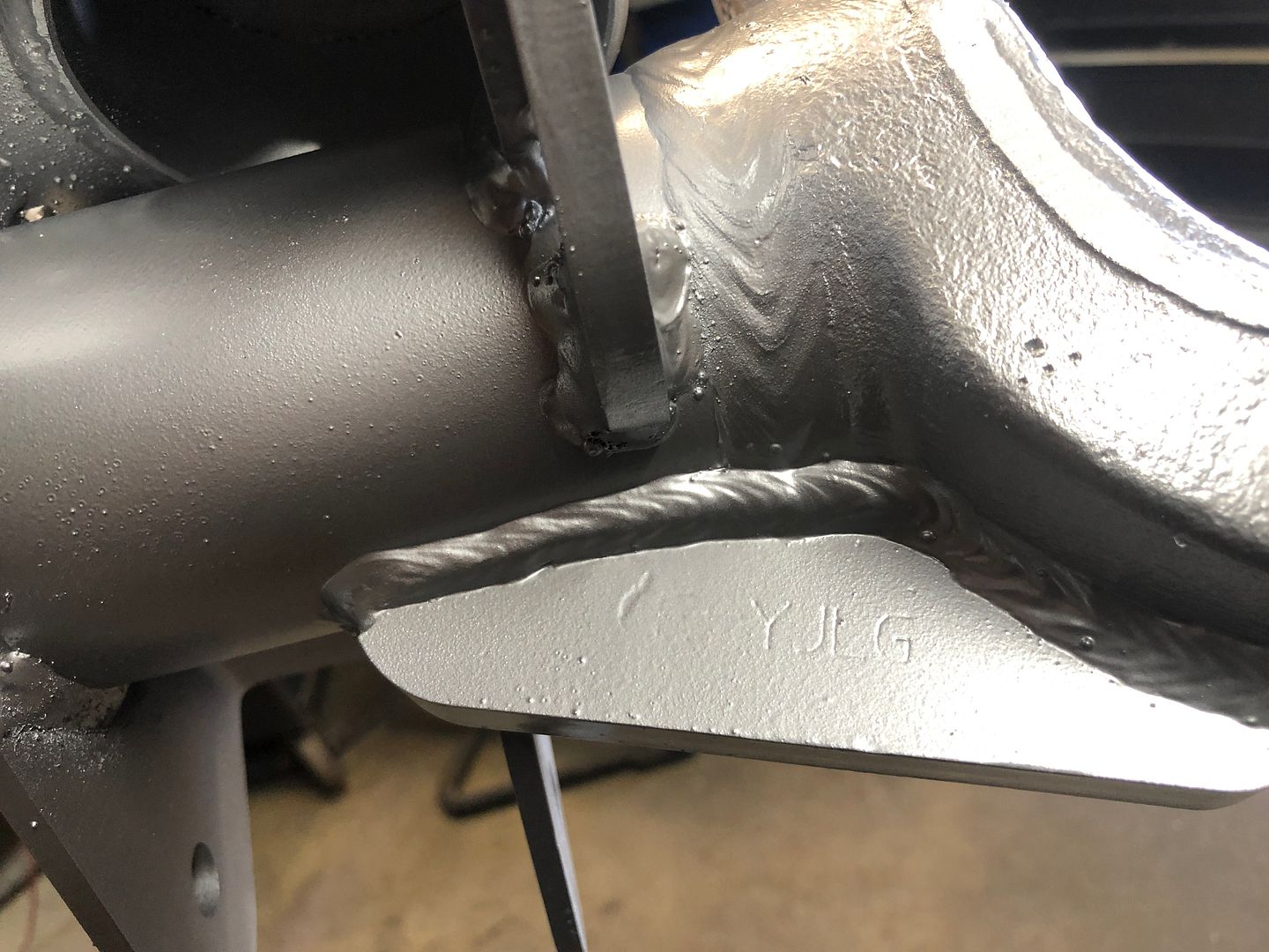

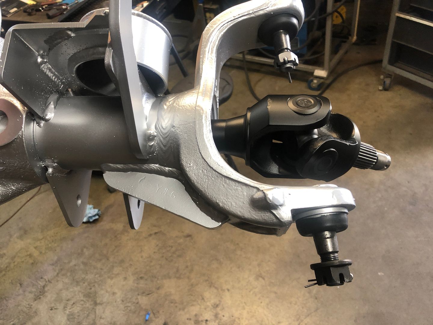

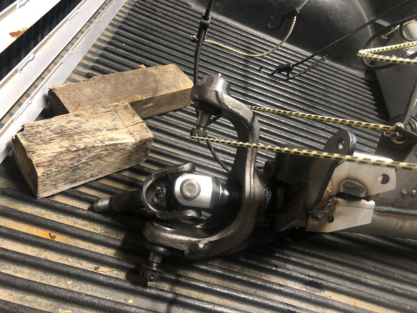

Did some painting today and some overall inspection today. I notice that there are no outboard bearings or seals. on the inner C's. Checked and this is the way we live now.
Very nice welds. I can see three distinct weld processes. Two look auto or at least positioner/semi Auto. The inner spring retainer is tigged on some sort of rotating jig.
The inner C to tube welds are Mig and rotated with a slight downhill side wire position, to perfection:
The hand mig welds were done by skilled welders. I am cofident this will be durable:

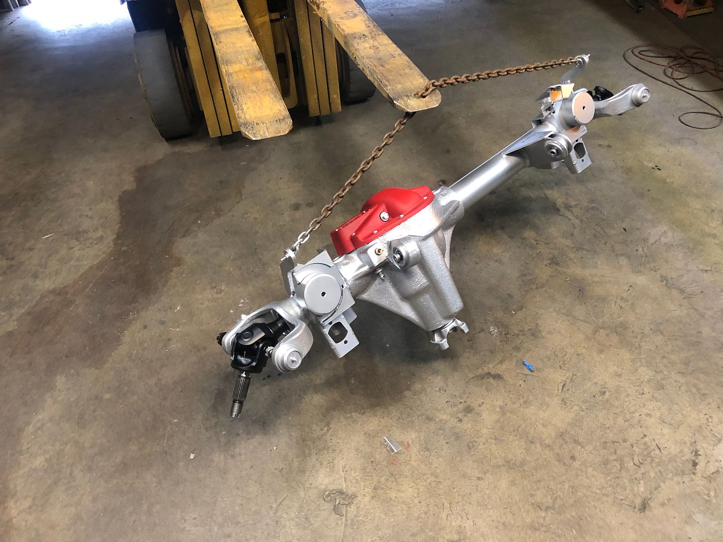

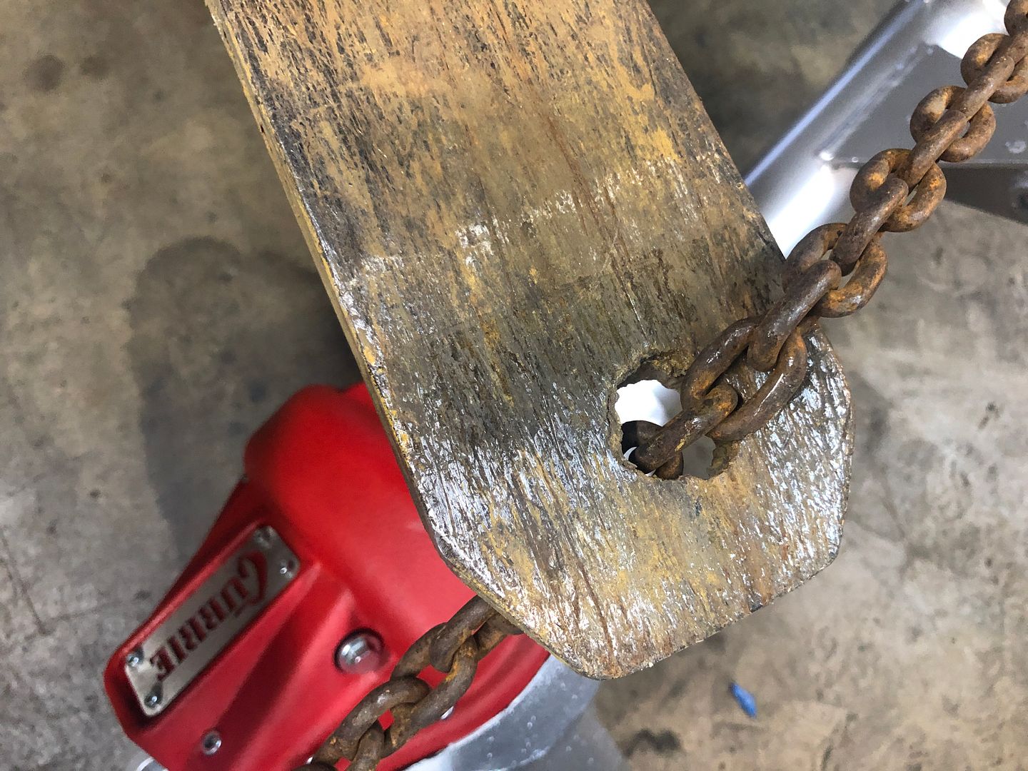

Finished up waiting for install
Note the D44 hanging hole in the fork, very custom.

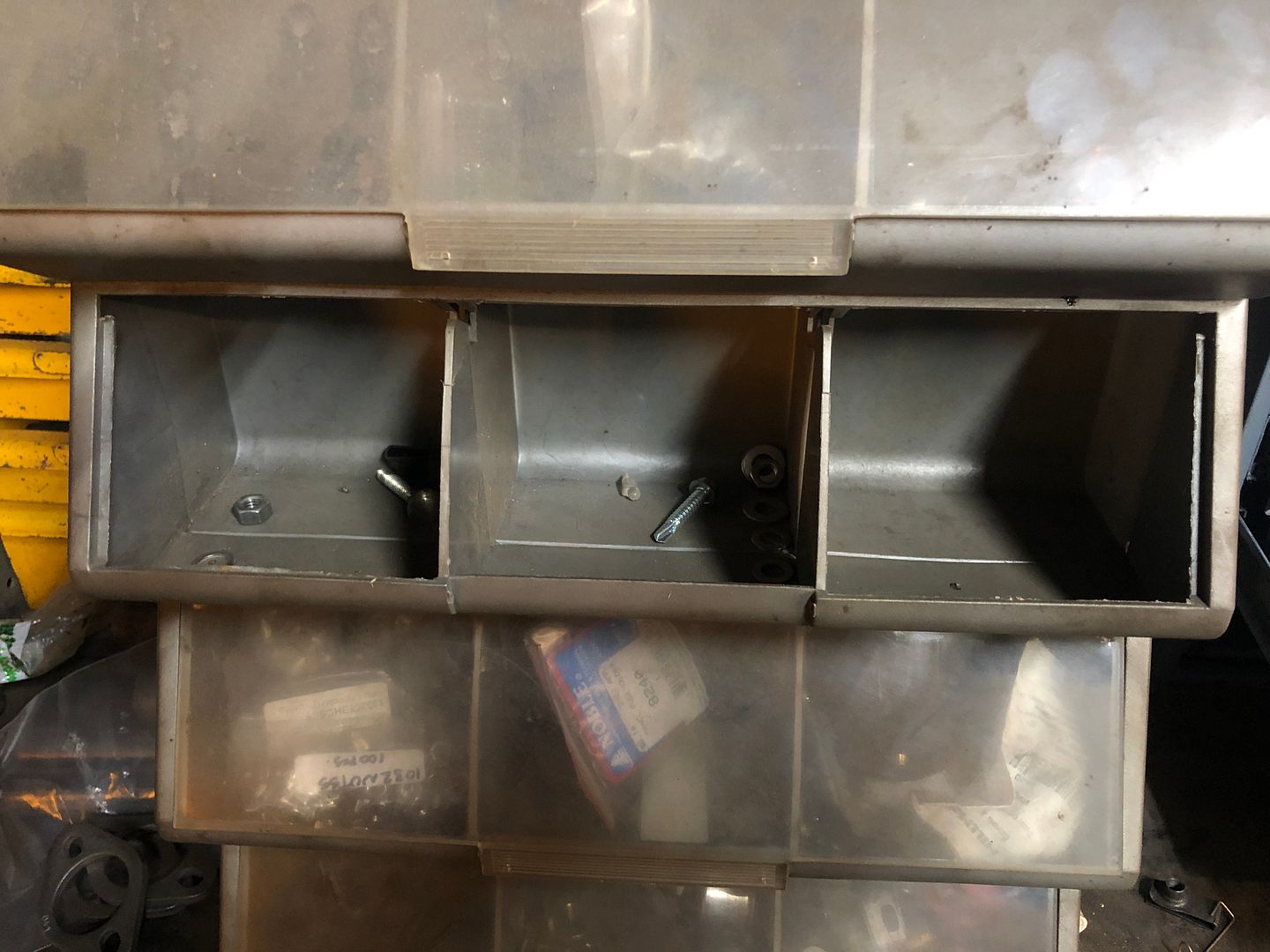

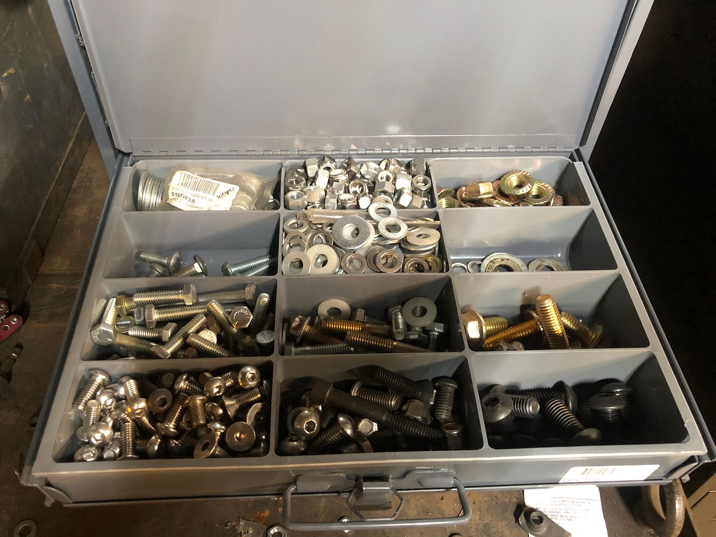

Also got some cool bolt organizing done today:
Old:
New:
I outgrew the old plastic bin and will slowly move over to the 4 drawer bin style. I have one of these in my basement shop for drills, taps, machine tools, etc. Keeps things handy and organized.
