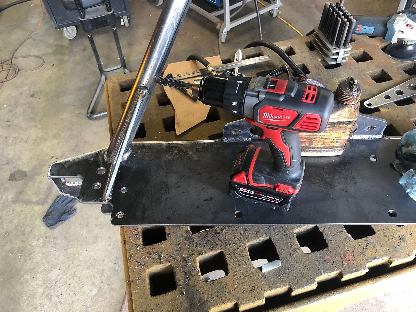

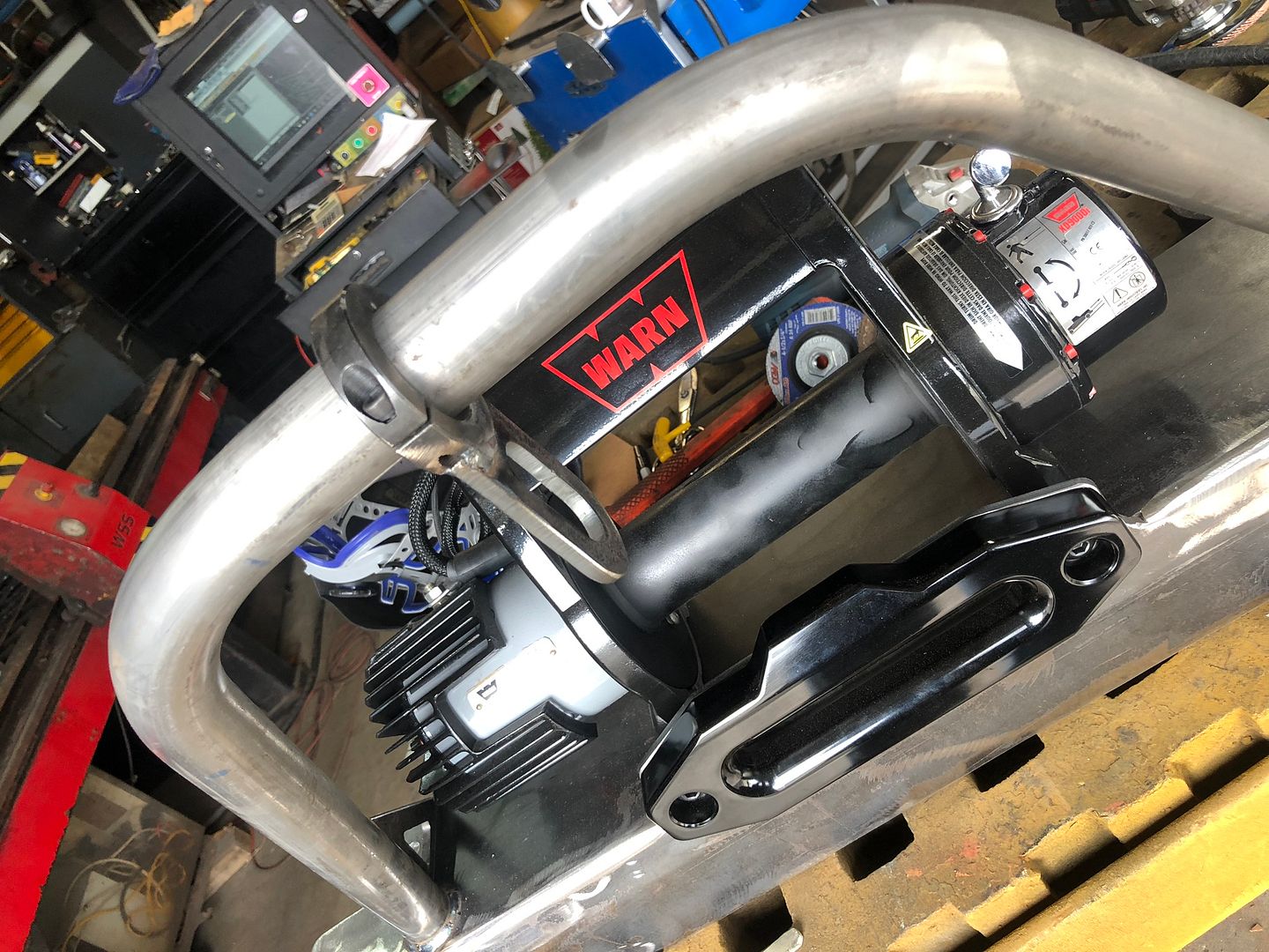

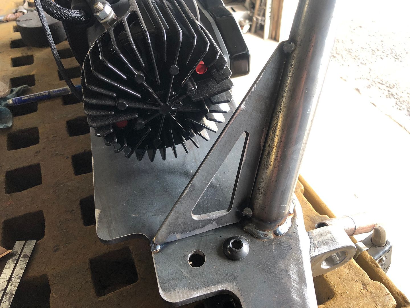

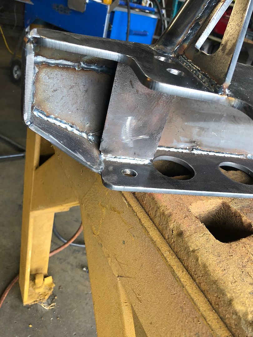

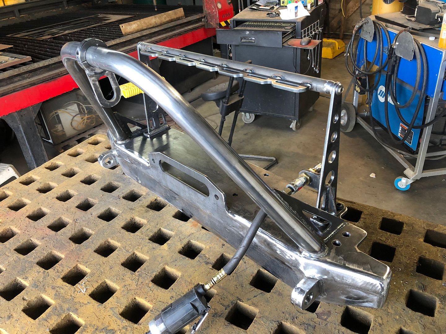

The bumper is ready for the powder coater.

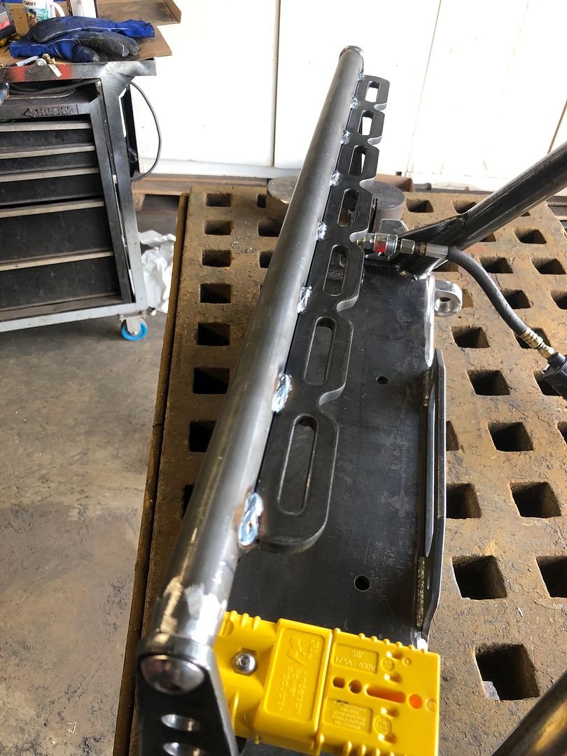

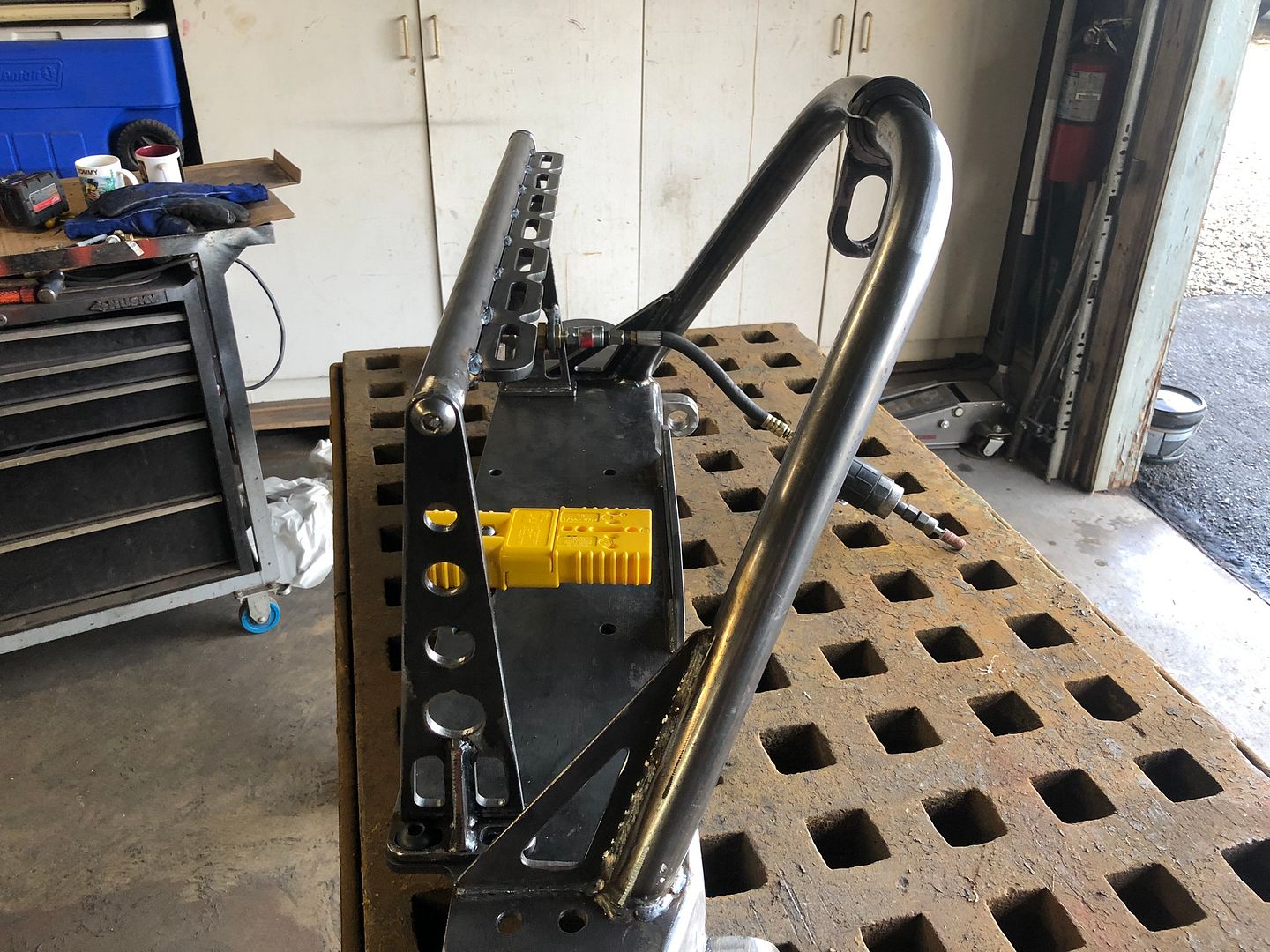

I finished up the hoop gussets and added a light rack that fits nice over the winch. I also used it to hold the air coupler and a anderson connector for my jumper cables.
Gussets line up right over inner frame rail, mucho strong:
Oh, a hook holder. I'm old school and like my hook LOL
Back side of bumper, leaves that tube thing open. Just in case I go with a antirock

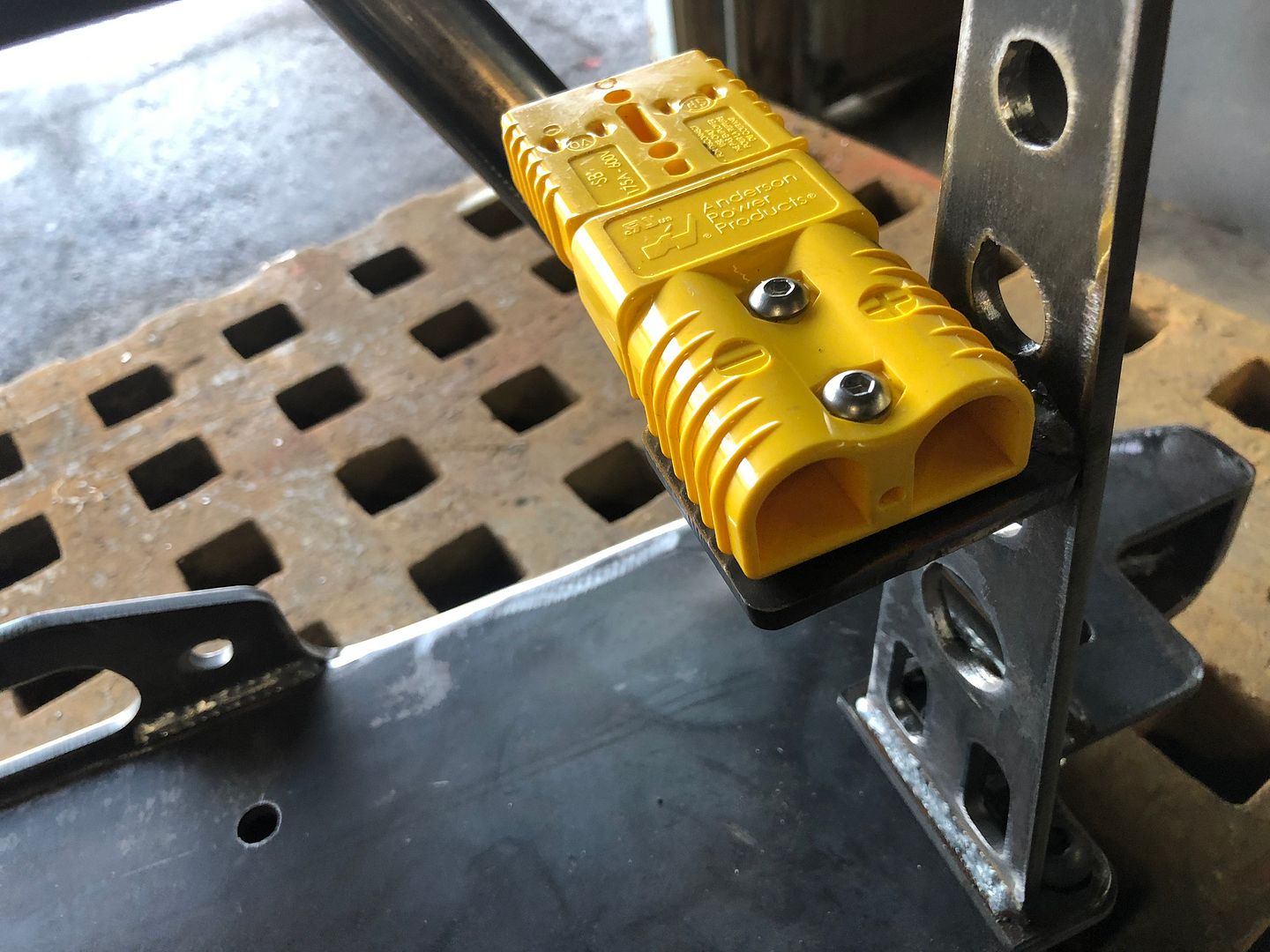

Light rack with bar and extras:
Anderson mount, great thing is this TJ already had a anderson connector out the front:
Light bar mount, 3/8" slotted holes for lights, I'll run a pair of cubes but have room to add or modify:

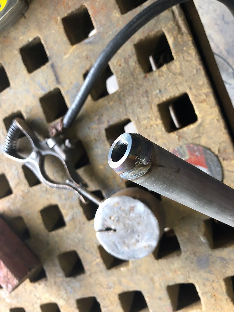

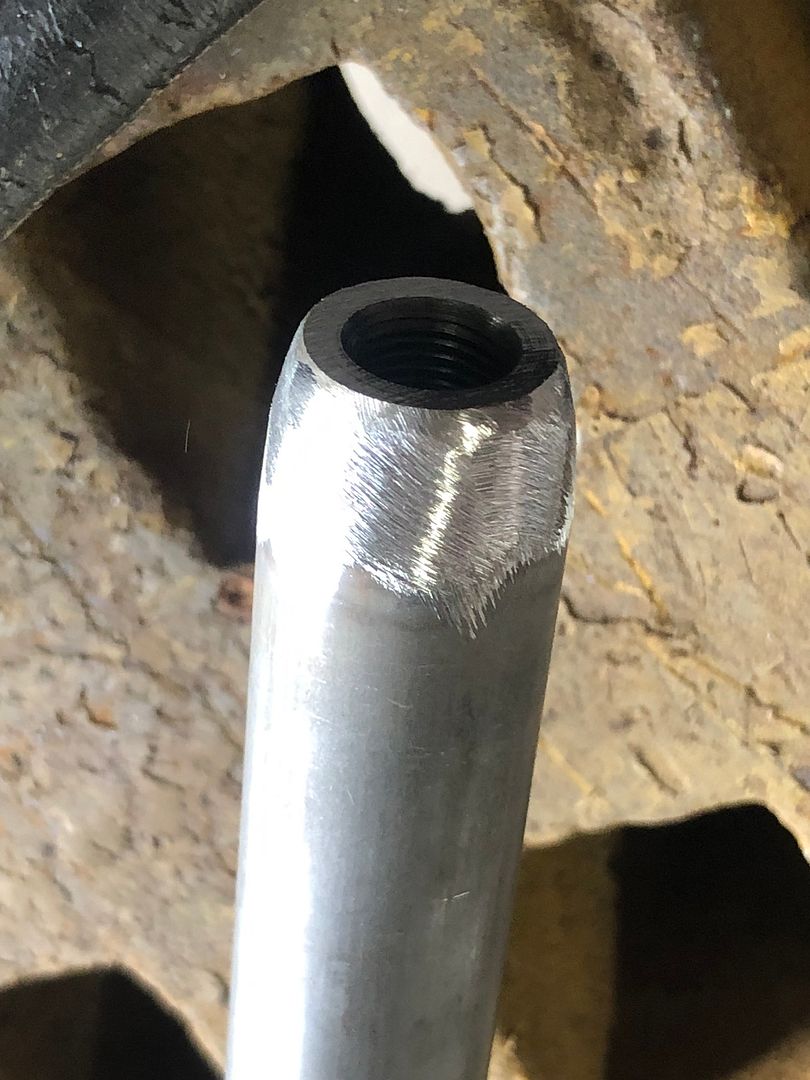

Light rack is removable and adjustable, 1/2"-13 tapped into winch plate"

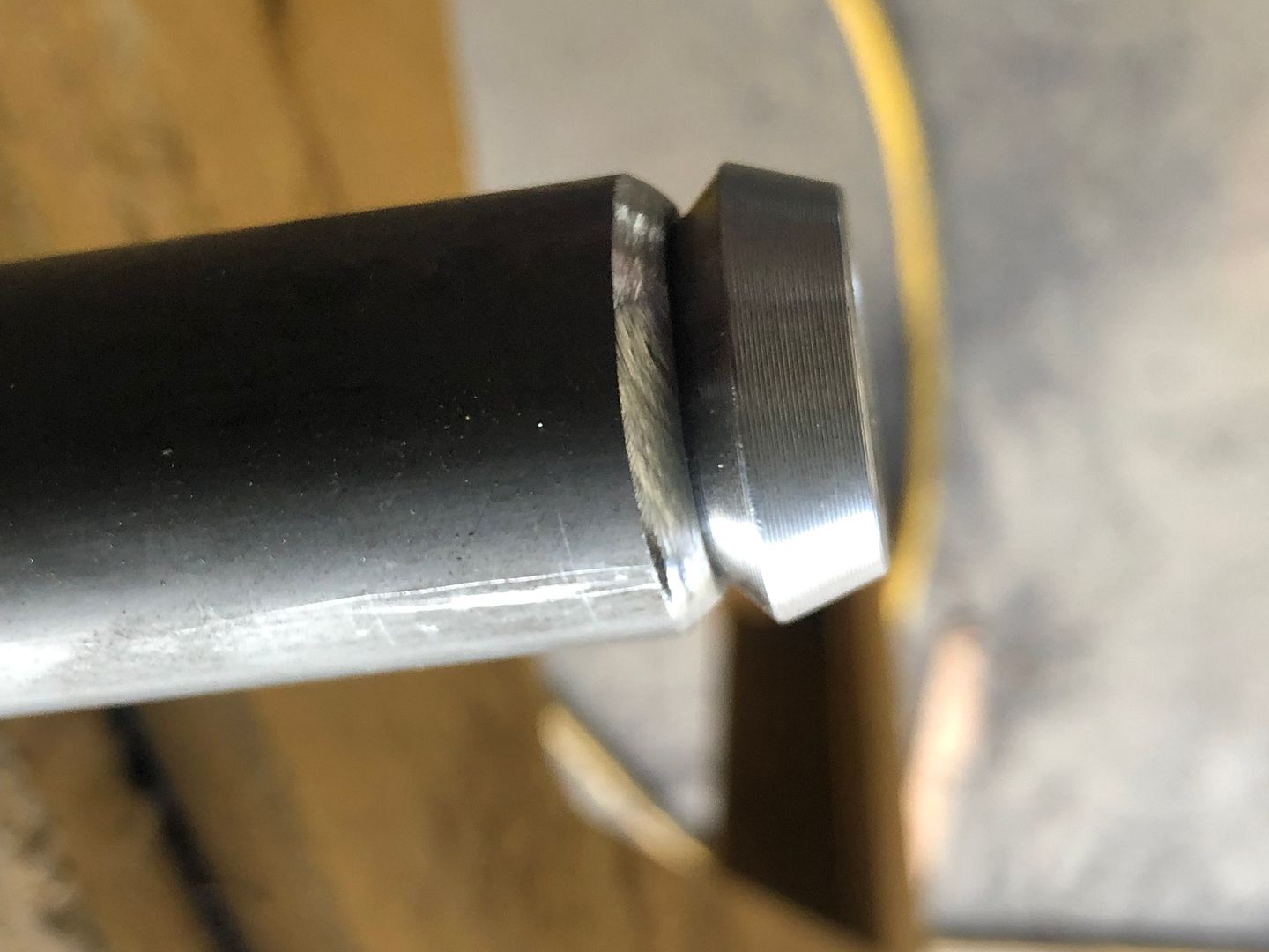

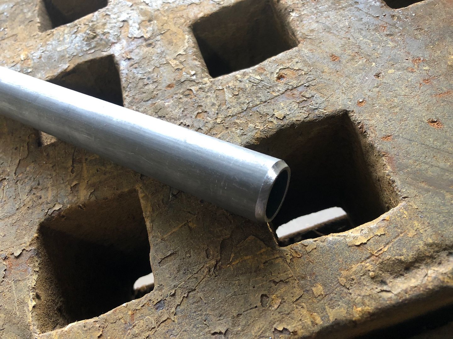

The bar is a 2' piece of 1" dom with some proto fab inserts in the end. I can adjust all the lights at once this way:

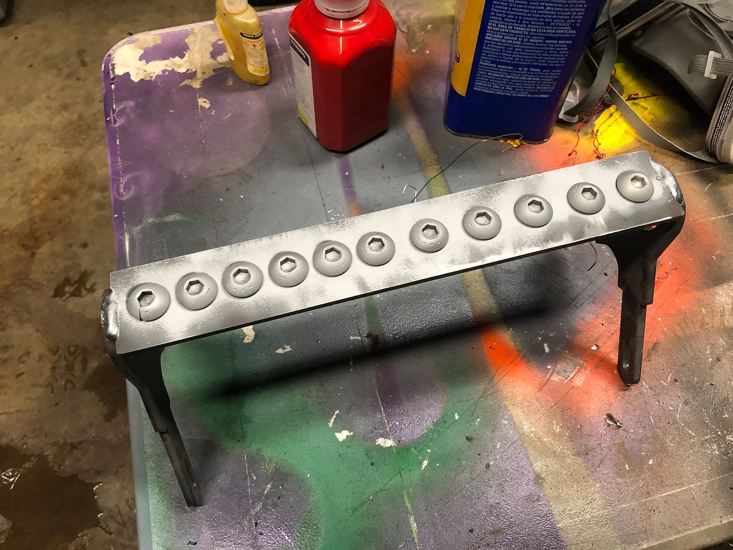

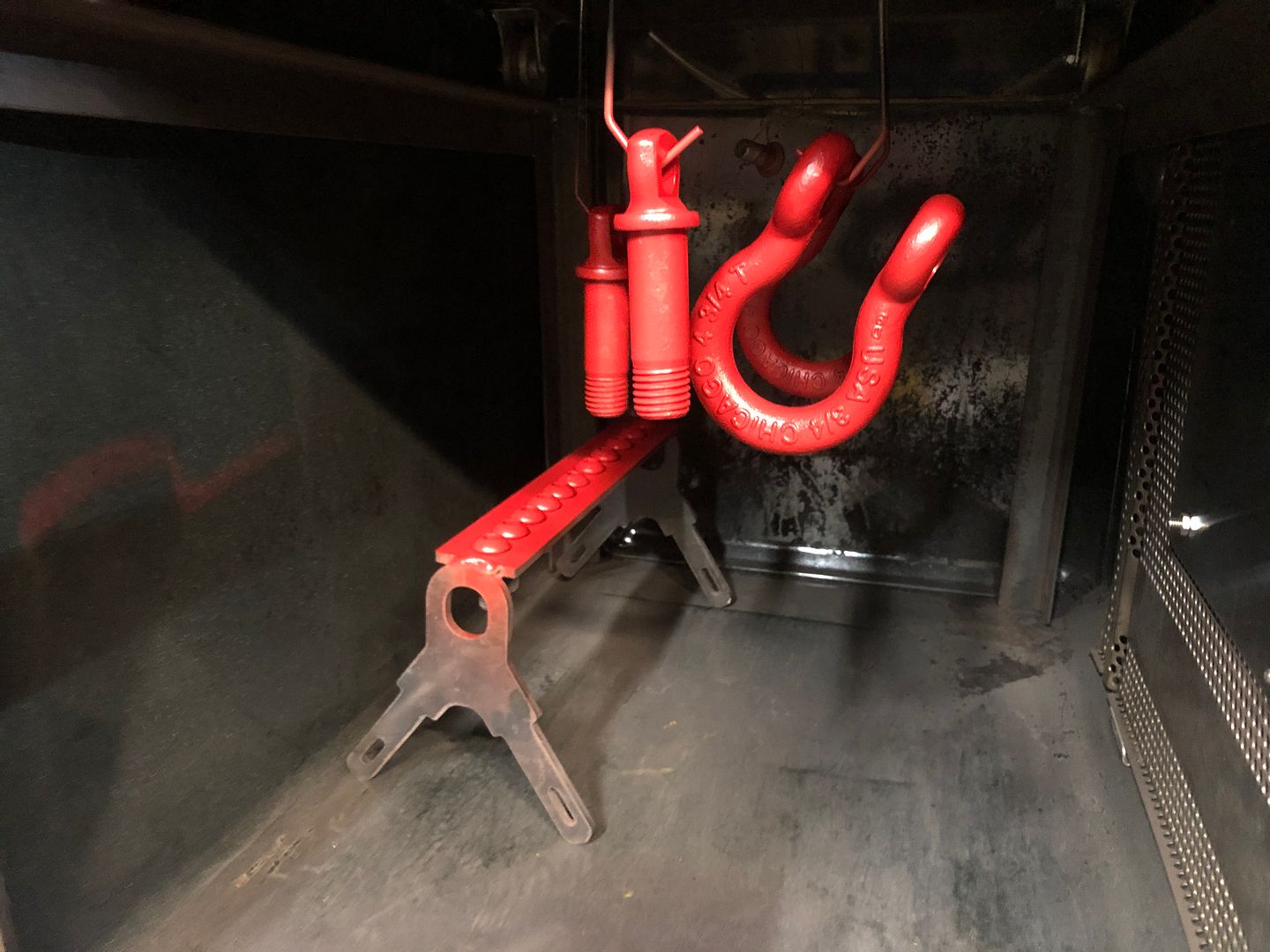

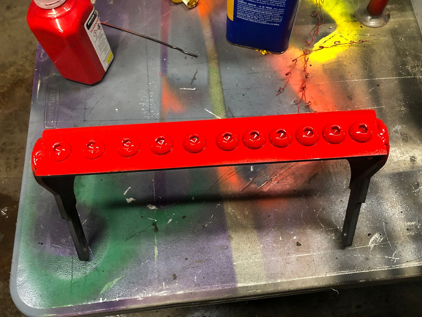

Not much progress the last week. Lots of rain here in So Cal. I pick up the front bumper tomorrow. In preparation, I have done some more Cerakoting to some bolts and a pair of U.S. made shackles. I made a bolt holder that can be used in the blast cabinet and the oven

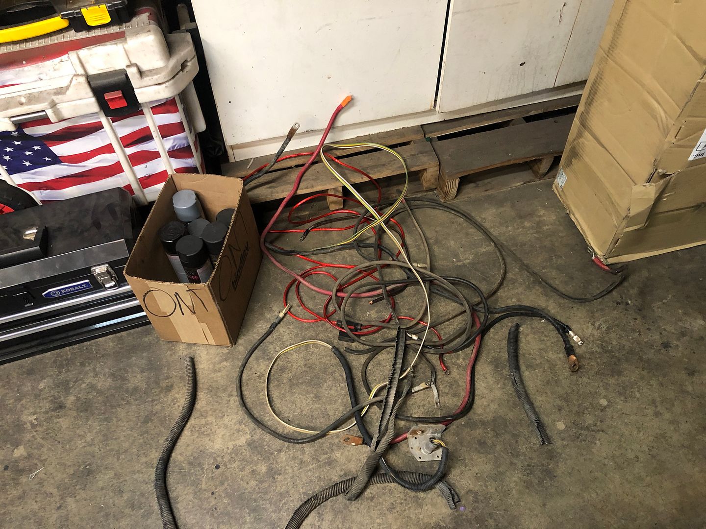

Today was the first day that I really crawled around on the TJ. I pulled a bunch of old wiring and most of the carpet out.
Today some interior parts arrived. A bestop rear trailmax II and a rugged ridge carpet kit. The water was not too bad, the Jeep is honestly rust free even with standing water.
