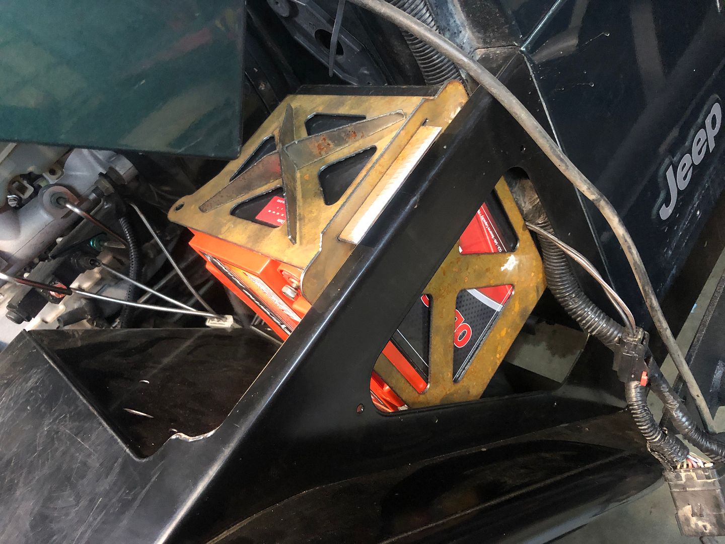

That is something that crossed my mind as I was working through this dual battery project.
A) it is built around TNT fenders, B) the Odyssey PC1200 is not a standard size, C) One is going were ABS "was"

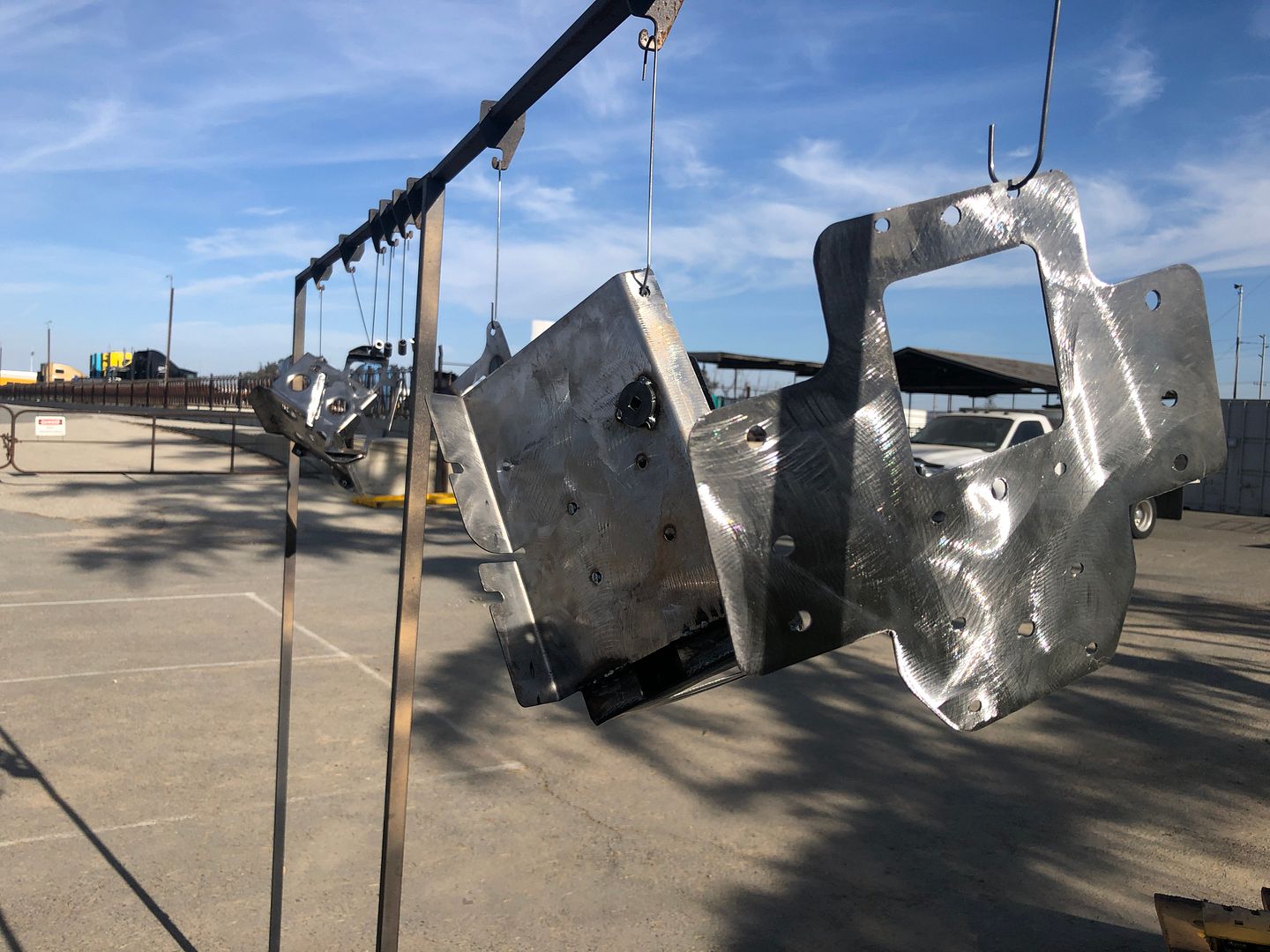

Before I sent off the fenders, I measured the spot for the aux battery and went ahead to make both sides identical as far as mounting. Well, when all bolted up tight, there were some issues. No matter how I tried to fit that monster, a 1/4" was missing. Very frustrating. I mulled over the idea of doing the stack again, but again, after a tightened up fender was on, it was short on dimensions. I ended up grinding some of the hood and fender to get a 1/4" gap all around. AND redraw and cut HALF the project, which really means double and then some as far as mounts. I would not recommend this route to any.
The part of the tab that is over top of fender gets cut after the bend in the brake. It is easier to get a clean break if that extra is there for the bend.

Getting a little done during the week. I have to sneak a moment or two.

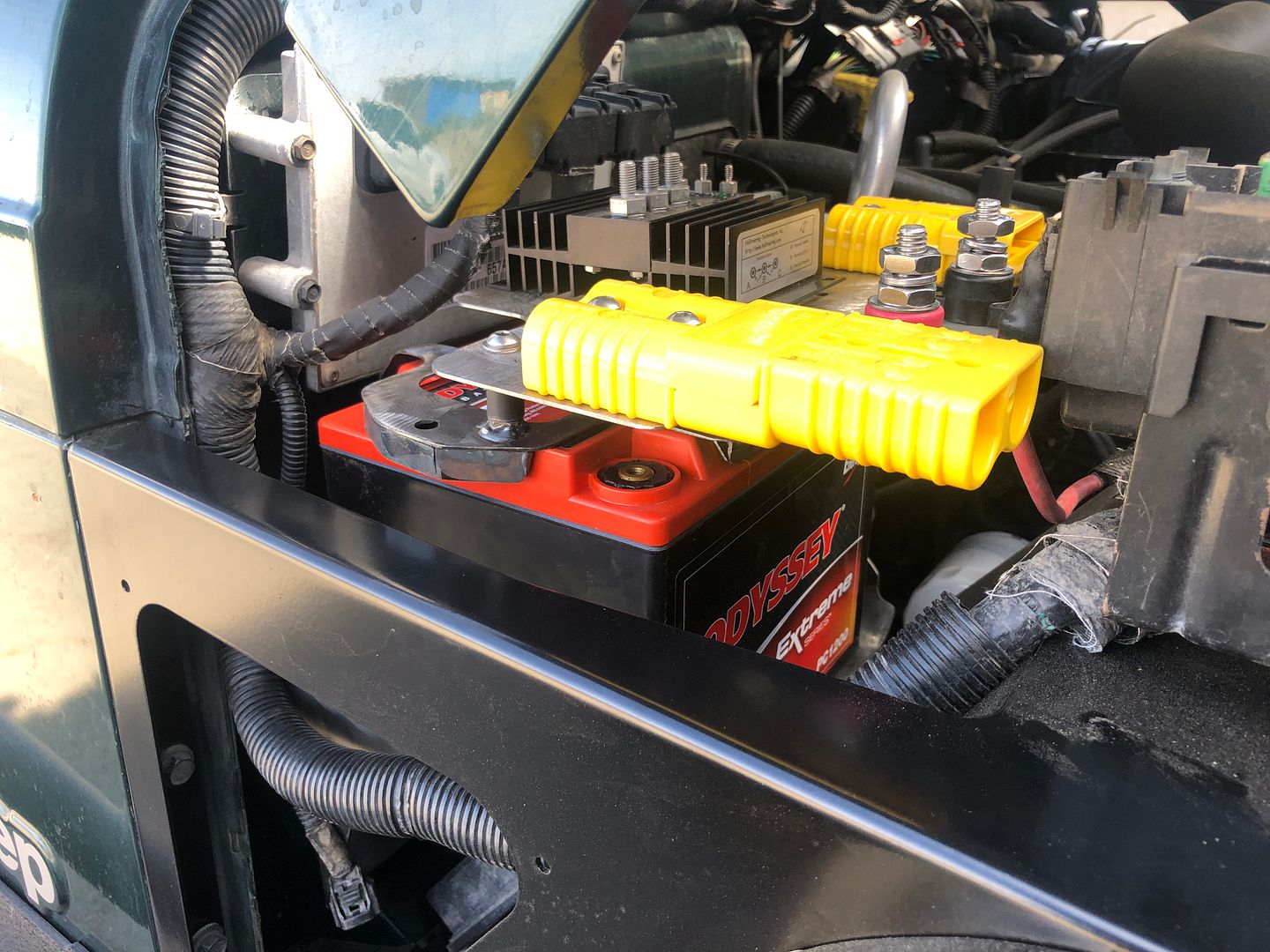

Here is the layout for the dual batt controller:
parts prepped and ready for paint:

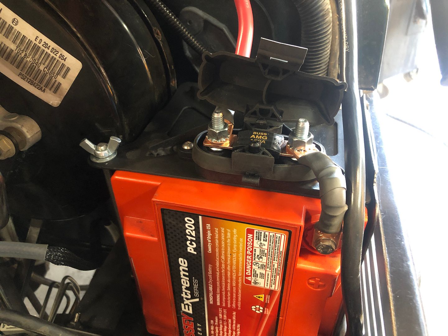

aux batt in place, I'm putting a AMG fuse inline from the aux batt:

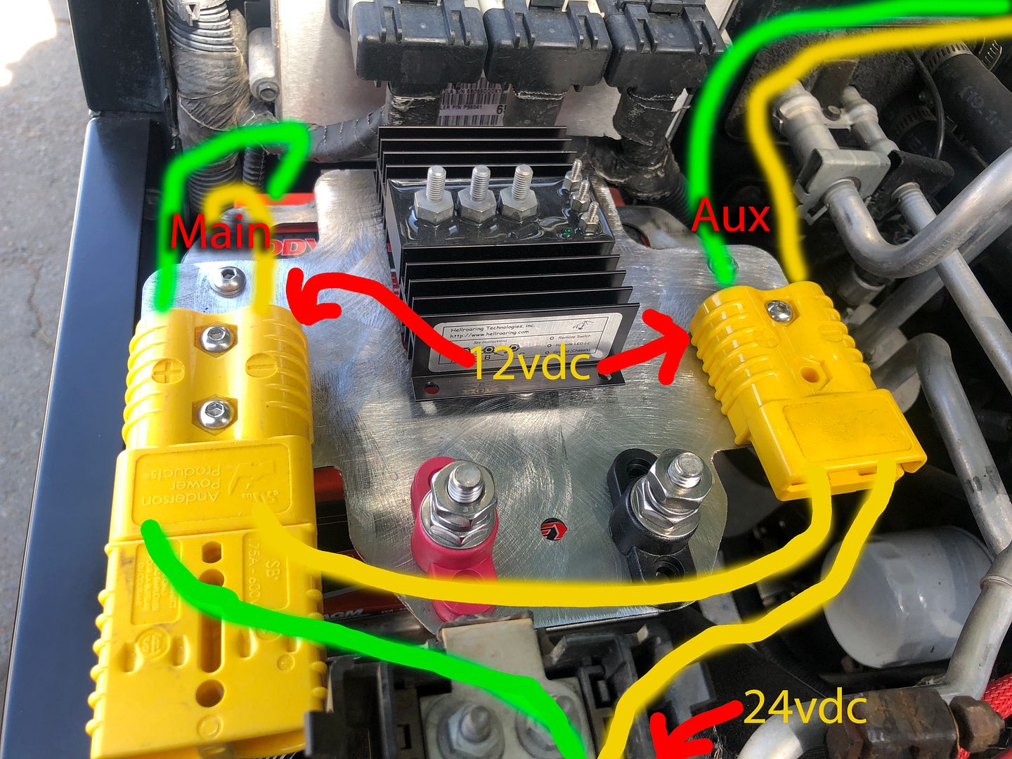

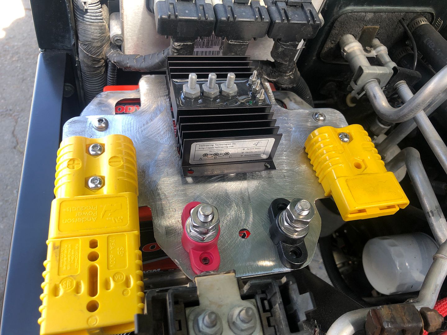

This is the idea:
The anderson connectors are key. Doing it this way, all the electronics are isolated and safe. the harness/yoke is direct to both batts, grounds disconnected.

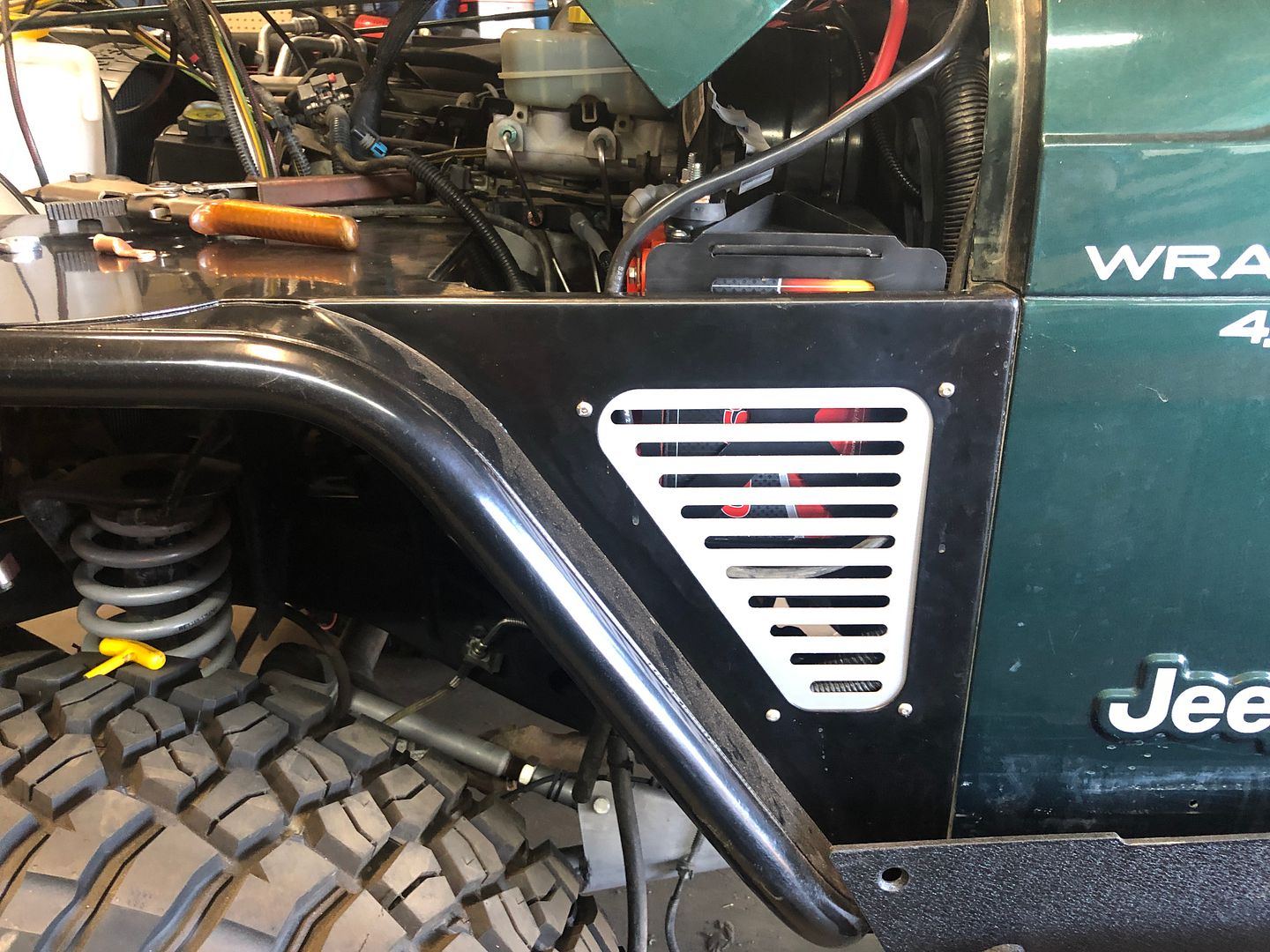

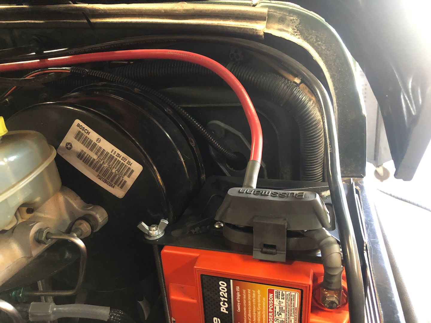

I realizes that I did not follow up with the fender/dual batt/isolator/air comp install!

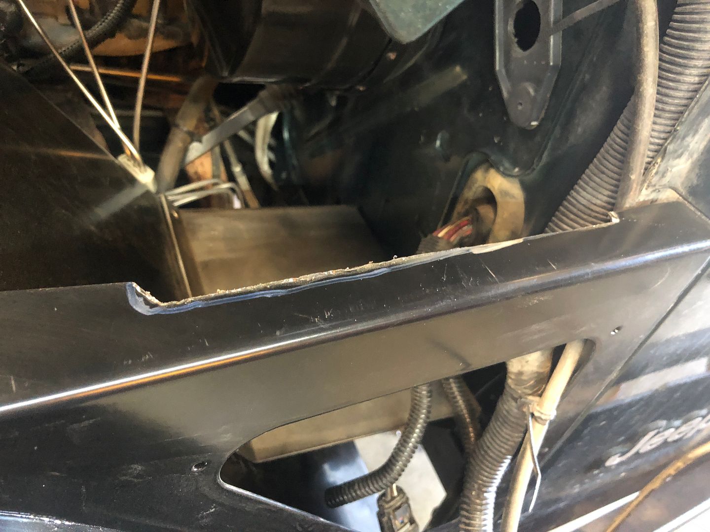

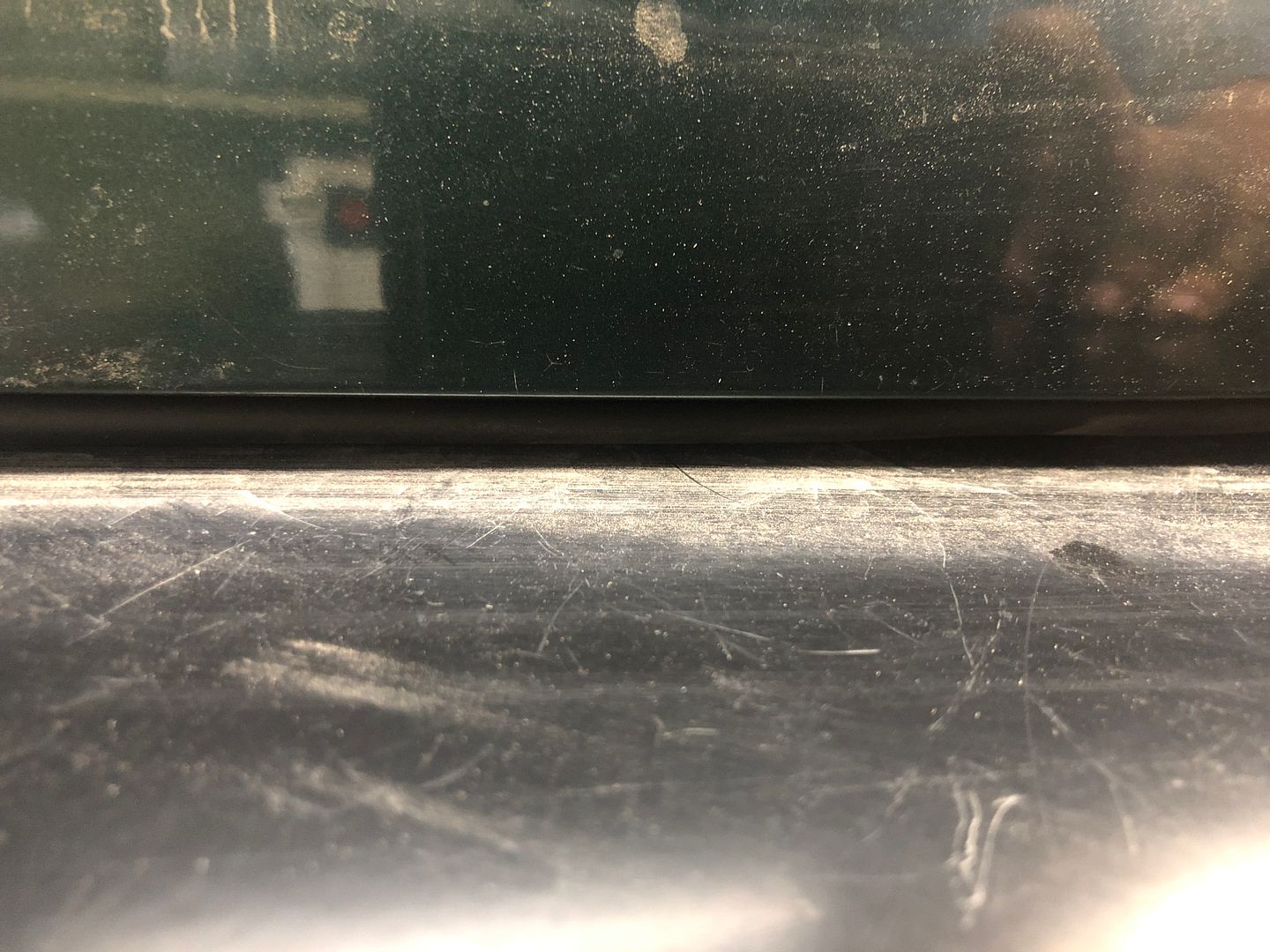

One item I found with the new fenders was a gap that showed the engine between hood and fender, I used some body molding to close the gap works great, hardly any compression and gap is sealed, it was considered 3/8" O type
installed on hood
[IMG]https://i1344.photobucket.com/albums/p659/WSS01/TJ%20build%20pics/IMG_2015_zpsxuflhvab.jpg[/IMG
hood closed
Loomed the cables across the firewall
air comp and new washer bottle in place
isolator and combiner
I was not entirely happy with the outcome, as it felt messy and rough, not like the last CJ I did. But it all works and will provide the required need.
