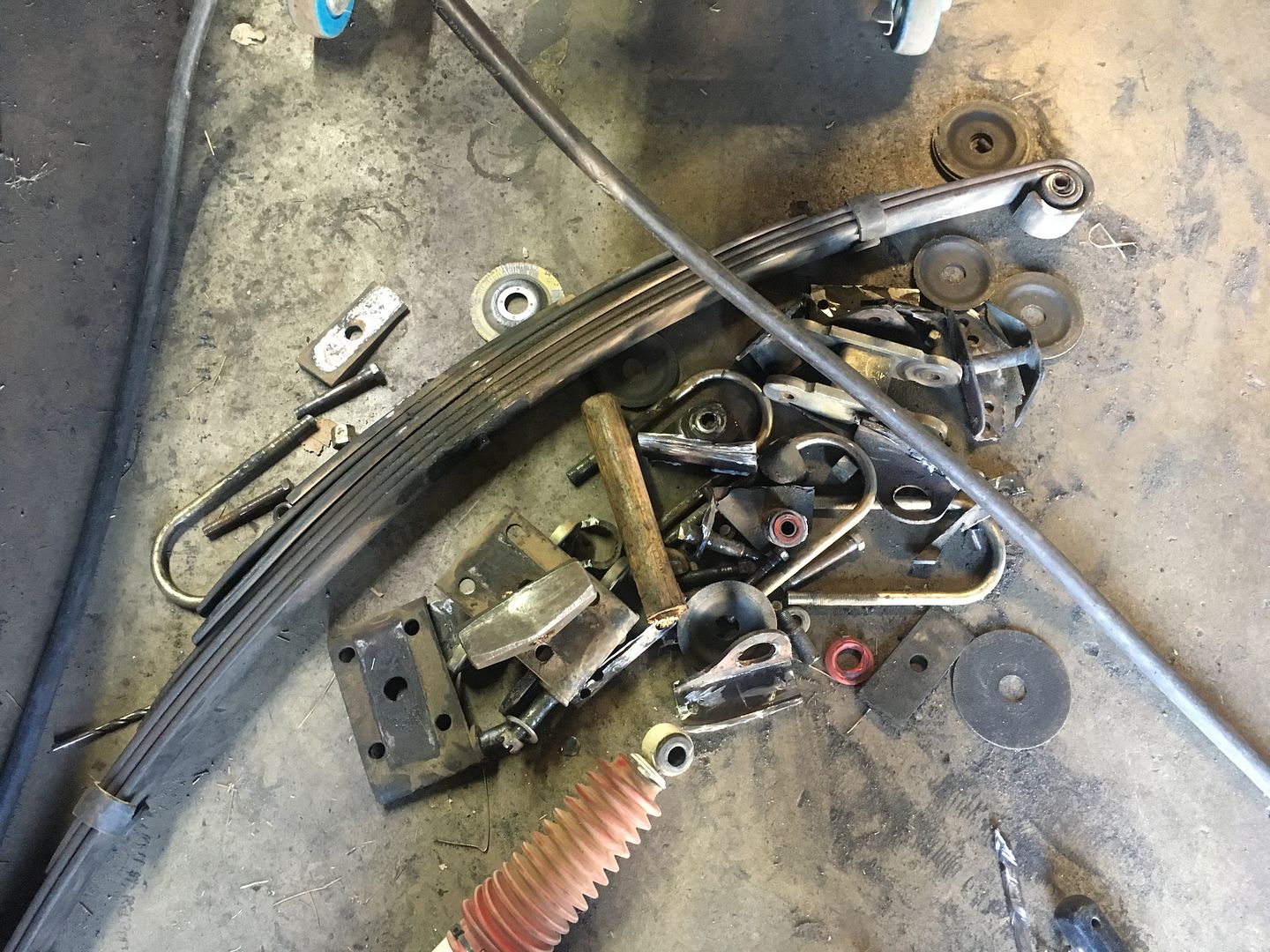

I'll post up some details later but right now I am tuning up the Warn XD9000i winch. I want it to look good for the front stubby bumper I'm building.
Happy New Year!
WSS

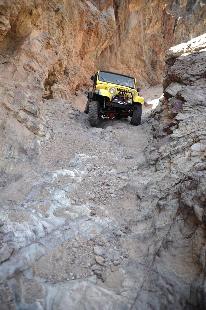

Here is a couple pics of our old CJ
projects like this were common:
Ben, SKT, Wojoe and 1 others like this.
