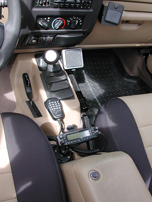

I have a Yaesu FT-8900 mounted in one of my cup holders using a RAM- A - CAN.
Here's a picture of it:
I have other pictures located here with a brief description of the rest of the mount.
http://otrattw.com/phpBB2/viewtopic.php?p=90#90
There is a closeup of the Diamond mount and antenna on the same page.
The main body of the radio is stored safely away in the trunk.
