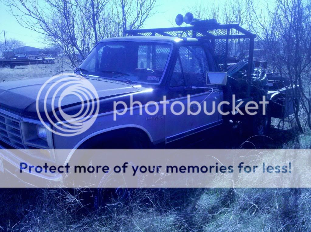

Took a little mini-vacation over the weekend. On the way I decided to stop and look at my donor pickup that I'm getting the axles from. Was supposed to be a 79 f350 and this is what I saw.
I was a little disappointed when I saw it. I was really disappointed when I looked underneath and saw this.
Did some calling around found another Ford with Dana 60's. Going next Monday to look at it and make sure it is what I want.
