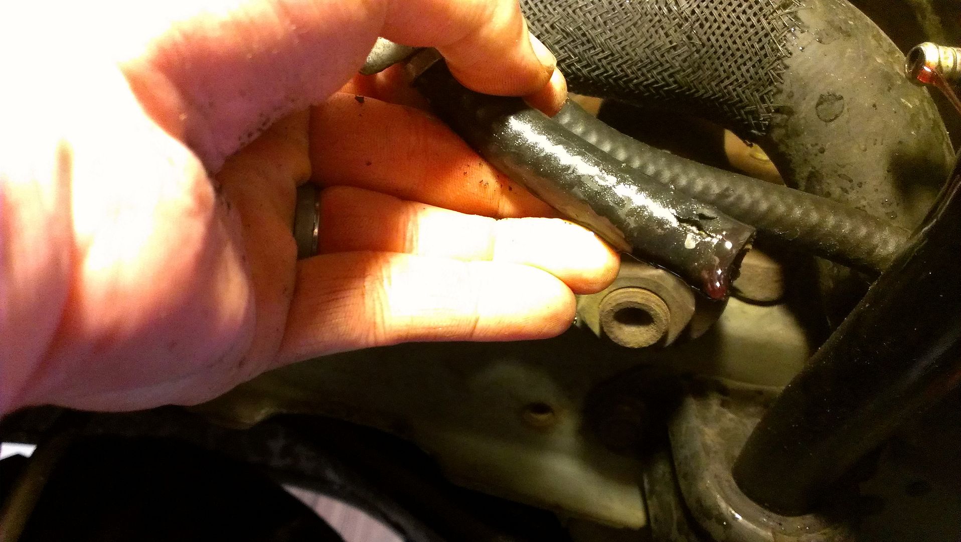

Took a look at all the PS fittings, dry.
A closer look revealed fluid on the radiator and the aux cooler. you can see the fluid stain, darker color, on the aux cooler.
You can see fluid film all on the AC condensor and Rad
So I start thinking I blew the aux cooler some how... not cool. Hah pun. Then I see this...
Must have popped the hose clamp and while wheeling trans must have gotten real hot and gotten past the hose and barb fitting... I hope that is the case and it is just an easy fix.
Got everywhere, on the support and melted the rubber hook gasket thing
Probably got INTO the air intake based on the leak location, air intake, and fluid around the joint...
Anyone have a reason why fluid snuck passed and didn't blow the line off. Or why it isn't leaking a whole lot currently?

You might have a pinhole leak where the clamp was. Over-tightened clamps can cut the rubber hoses. If you have enough hose, snip off the last 1" of the hose and throw a new clamp on there and see what happens.

Must have put one to many turns on it back in the day. Was thinking the same, cutting off a bit hose and then reclamping. Going to get some degreaser and hit the whole area so I can spot leaks if the re-occur. Probably should get fluid levels too. With the clamp broken, I'd say that has got to be where the fluid came from. Fingers crossed the cooler itself isn't broken.
I had a transmission hose do just that:

Yikes. I didn't see anything cut in my hose however, I slid more hose onto the barb and put the hose clamp further back to where the original clamp was. I wasn't able to pull the line off so I just slid it on more. I did not want to budge on or off. I would have to pull off the header panel or undo the lines at the original cooler barbs in order to yank out the aux cooler to get to a better spot to work on it. It is real tight between the header panel, etc. If it goes again, I'll put in new line and tear it all down... Fingers crossed that won't be needed.
